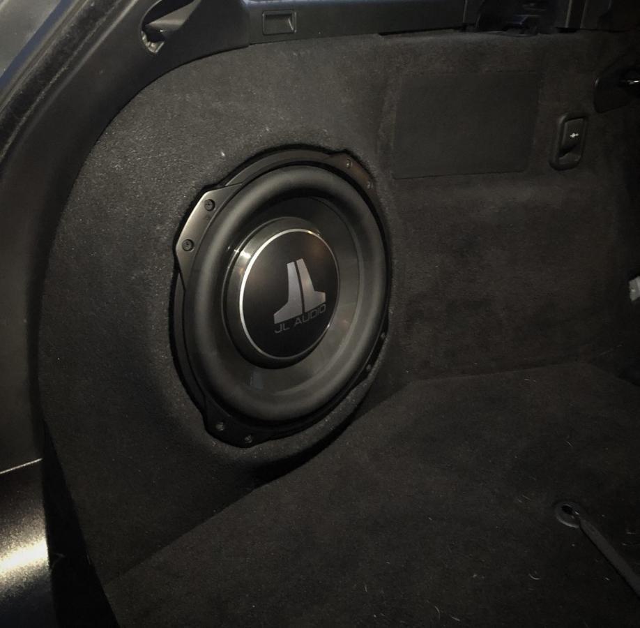

                  Yeah 100% agree won't need both the 6x9 and the sub. I need to figure out if I favor sound (bass) over form (hidden 6x9). I will definitely run one or the other but not both. We'll see if I'm satisfied with the limited bass out of the 6x9. I favor the single 10" over the two 6x9 BUT the only fitment I like is the custom fiberglass enclosure by Bimmerbox who no longer is in business. I can try and make one myself or have one made. Here's what I would prefer if I went single 10"
