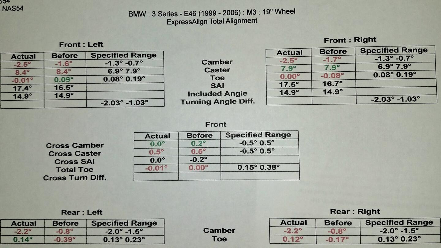

        After I was happy with everything and drove it a bit, I made an appt for an alignment at JMP in the valley here. Ride height (center cap to fender) is 13.375" Front & 13" Rear without me in it, but half tank.

        Looks like I did a very good job on my DIY camber adjustment (weighted string), so that's cool. I had set the camber plates for maximum caster, but you can see that it came out with a half degree disparity. It now pulls slightly to the right. The shop said they couldn't fix it because our strut towers' hole isn't big enough to access the 4 bolts. I wasn't going to pay another $120 for them to drop the struts and adjust (guesswork). I'll do it myself later. I'll mark the plates and tower in order to reach the same camber, but I'll bring the driver strut's caster forward a hair.

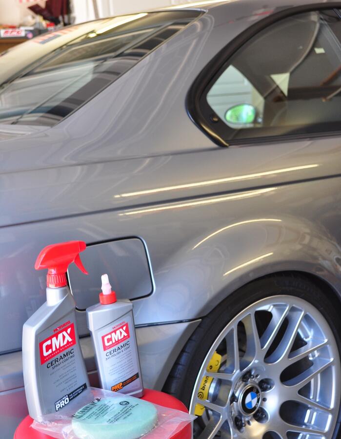

        I've been busy with the steelgrey car, and it's been a while since I detailed the car. I already have and used Mother's CMX coating spray (sio2/tio2) to very good effect on a tiag 128i. Fellow member and professional detailer here mentioned he liked Mother's CMX polish - it contains the sealant in it for a one step, and it promotes adhesion of other ceramic coatings or sprays after it cures 24hrs. I used a medium/light (green) LC CSS pad so that there'd be some cut, but a fine finish. (order is [softest] black [no cut], blue, green, white, orange)

        The polish/sealant is very nice to use. Pretty creamy, more like Griot's for longer work time. Doesn't nearly dry up and dust like Meg's 205. It's thicker too, not watery.

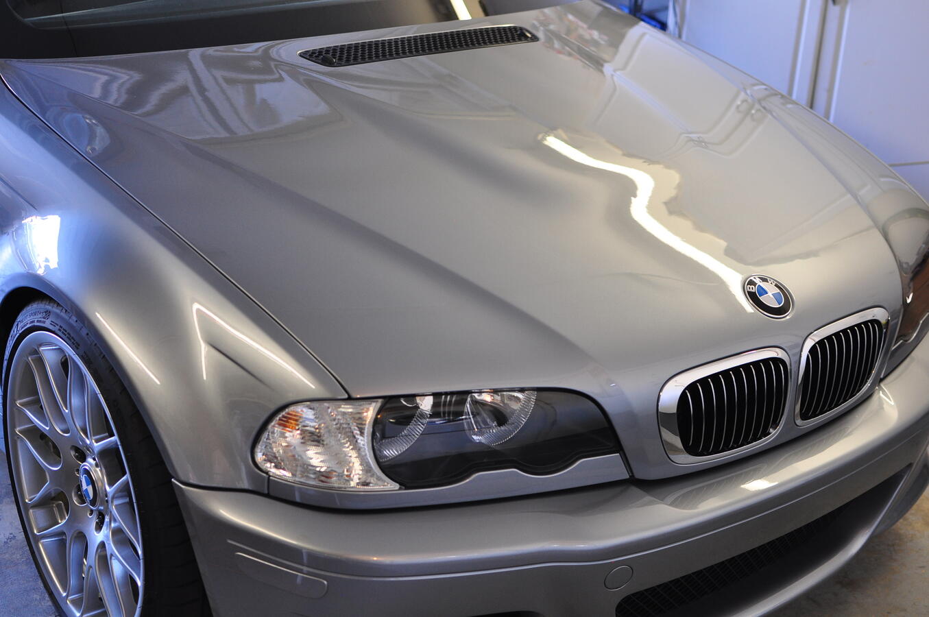

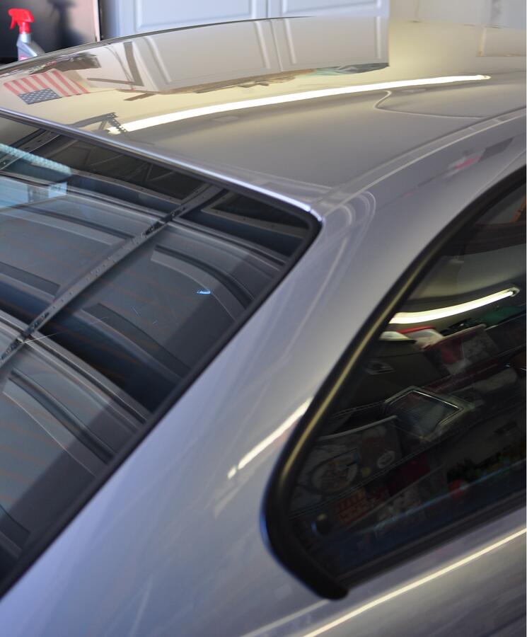

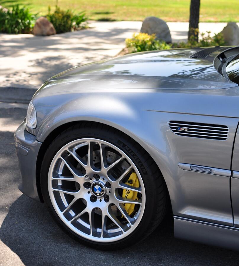

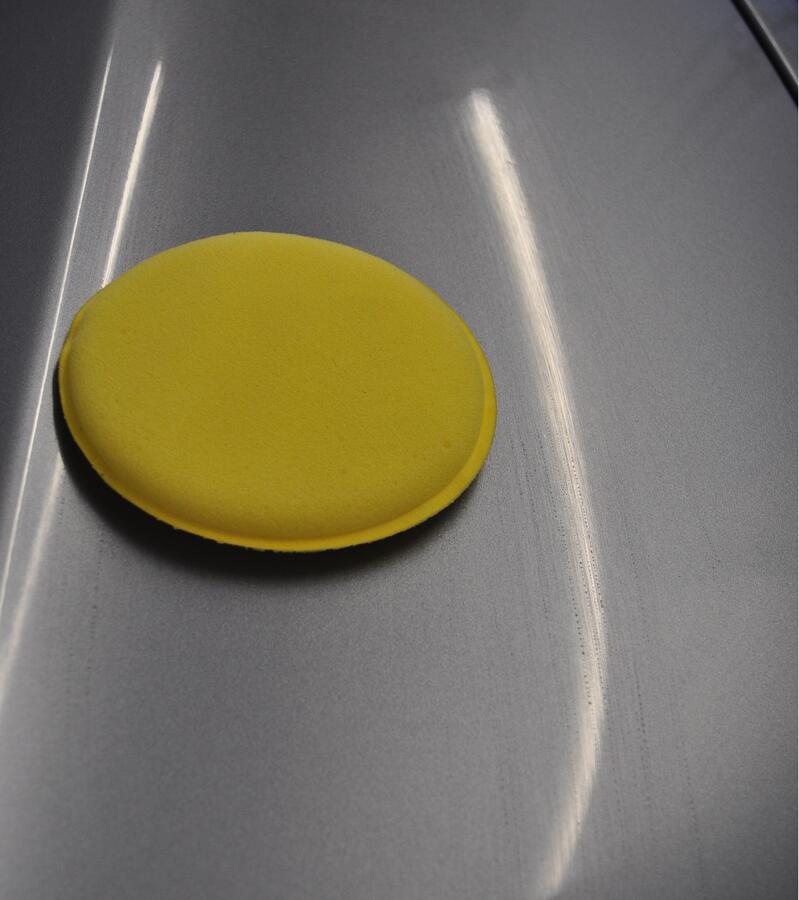

        I usually use a MF applicator to apply the CMX sealant spray, but had some cheap foam ones. They just smeared it around. When applied with MF, it sets up just like wax (hazy, not streaky), and wipes away just like wax (I love real wax). I'll never use these foam applicators again - junk.
        Never the less, the car came out great (the polish/pad is chiefly responsible for the gloss factor):
