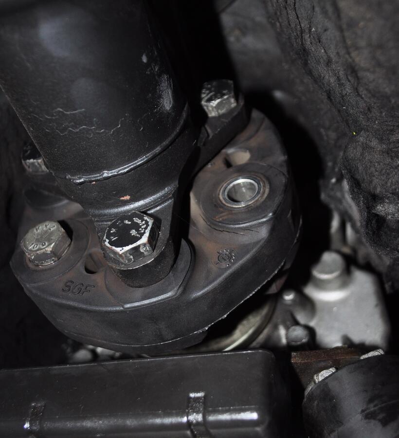

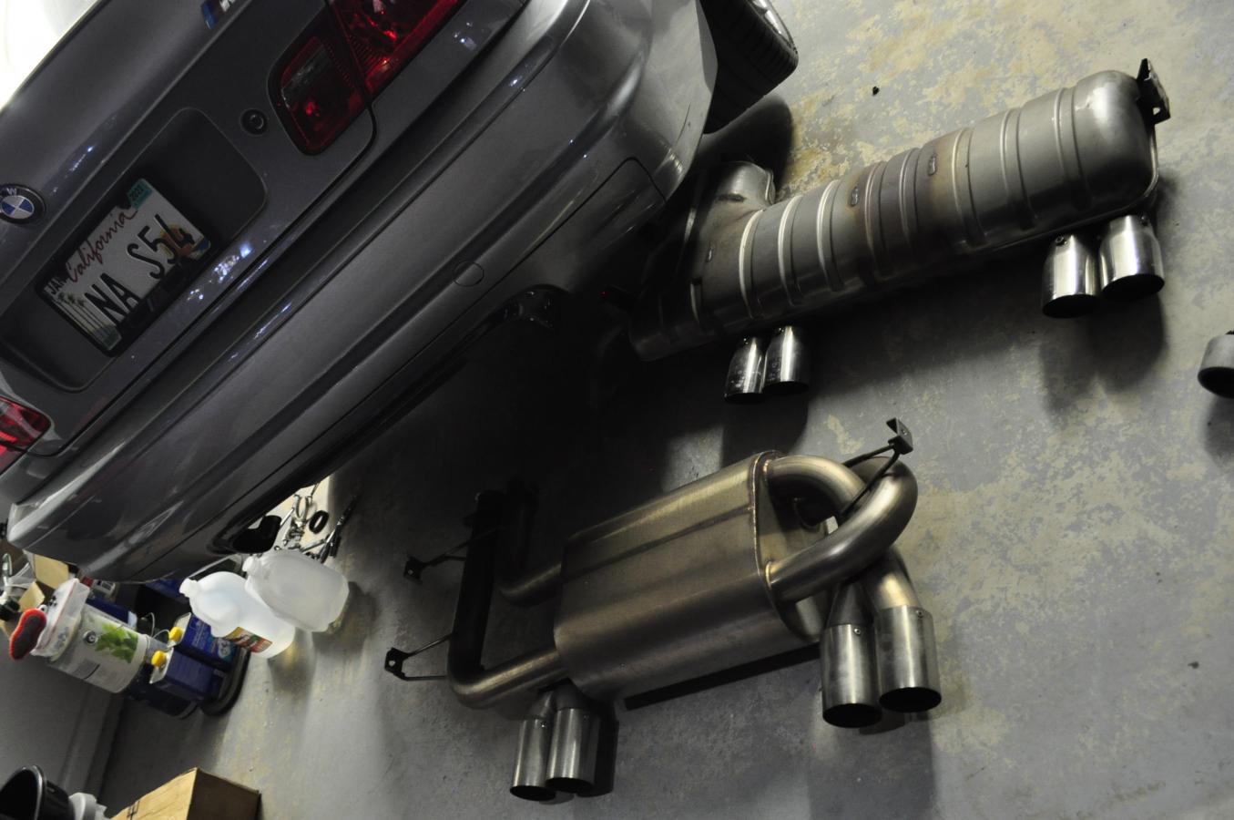

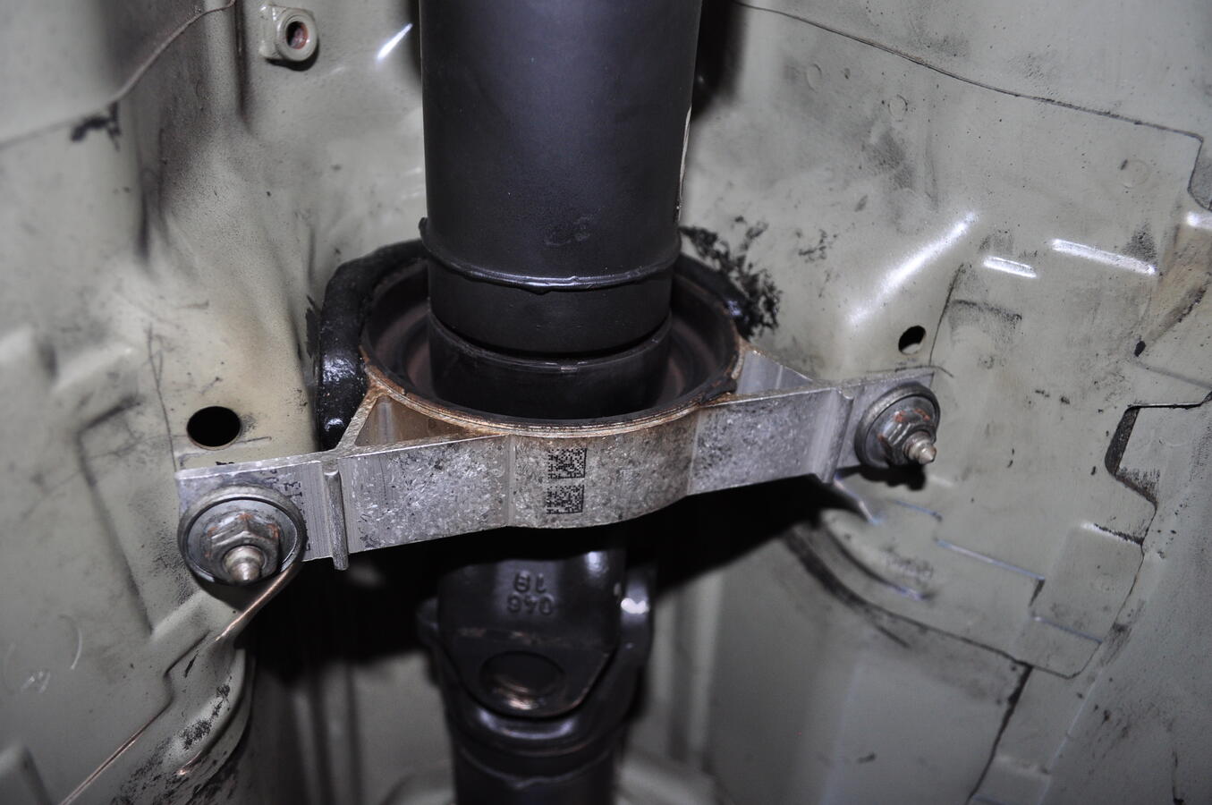

    Car up - I had noticed the giubo (OE, replaced in 2014-40k ago) had some new cracks forming, so I bought a new one (FCP warranty) ahead of time since you have to drop sect 1/2 to access D/S.
    SS "S" pipes out
    One of my other goals on this job, was to extend my muffler out a it more, especially (mostly) on the right side, to even the tips out. You can see how uneven it was, below. Yes, my tips are adjustable, but the factory metal piping that my tips attach to, are very short and there's no more room for me to bring the tips out further. (Only an issue with CSL diffuser)
    Next, dropped v-brace and sect 2
    Need to drop heatshield in order to reach CSB. Have to loosen CSB to push D/S back enough to get giubo out. You can access giubo without dropping sect 2 and heatshield, but then you're stuck.
    You can see cracks on the giubo. Made it almost 40k of hard driving.

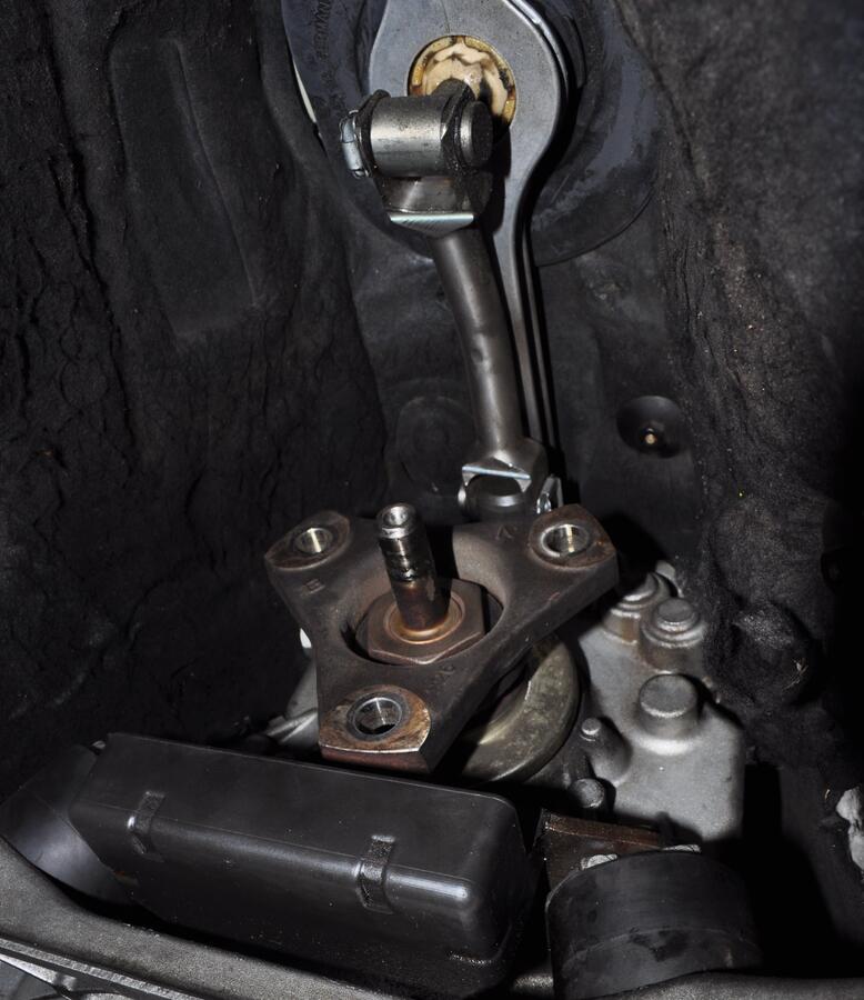

    Giubo removed. Inspected the shift linkage. I had done it all recently enough, though, so still well lubed and everything looking as it should. (pictured is UUC DSSR & RE tranny bushes)
    Click image for larger version  Name:	silvergHJSgiubo07.JPG Views:	0 Size:	77.6 KB ID:	147806

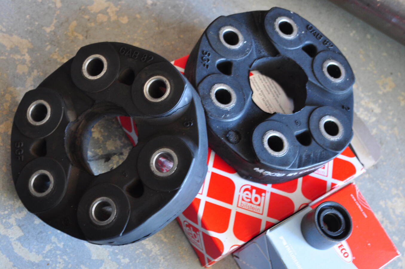

    40k giubo vs. new. You can buy the cheaper Febi brand, and in the package will be a factory SGF. Save yourself like $100. (also pictured is a factory corteco centering bush that wasn't actually needed [don't waste your time/$])

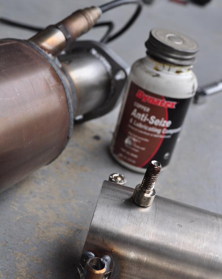

    Put copper paste on the new SS hardware and the O2s. O2s (post-cat) were replaced like 7 years ago for when I was passing smog with the euro headers/cat setup. Didn't use them with my v1s, so these are still pretty new.

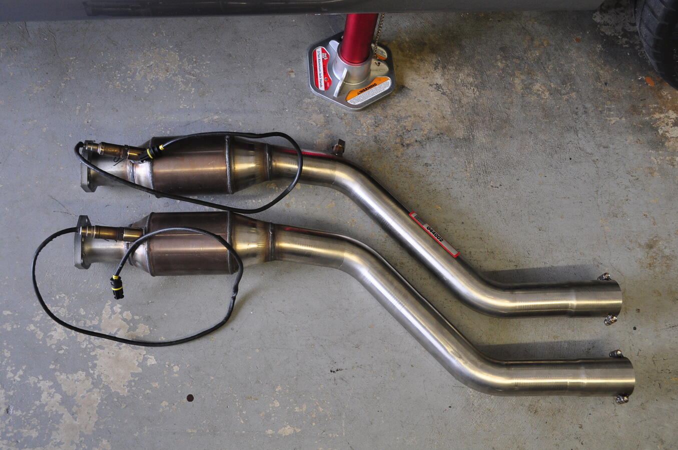

    New pipes ready to go in:
    Click image for larger version  Name:	silvergHJSgiubo11.JPG Views:	0 Size:	172.9 KB ID:	147813

    Before installing the sect 1, I routed the O2 plugs through a hole in the heatshield (made when I had euro cats) and run along the tunnel, driver side

    Once the pipes are installed, I pulled the O2 plus as far forward as possible, to meet the harnesses that need to be run behind the airbox and down tranny/clutch line area (already done in 2014). They'll reach a bit past the tranny brace. It's actually a good area for them to meet the harnesses as there are already some clips for the wiring of the tranny sensors.

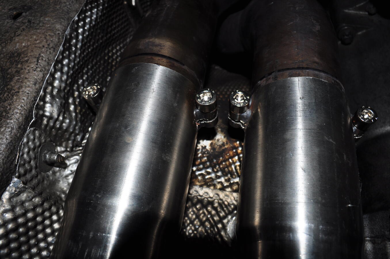

    Before removal, I had marked (sharpie) where the S pipes settle on the header outlets. I wanted to install the new pipes about 3/16-1/4" further back:
    Click image for larger version  Name:	silvergHJSgiubo16.JPG Views:	0 Size:	145.7 KB ID:	147816

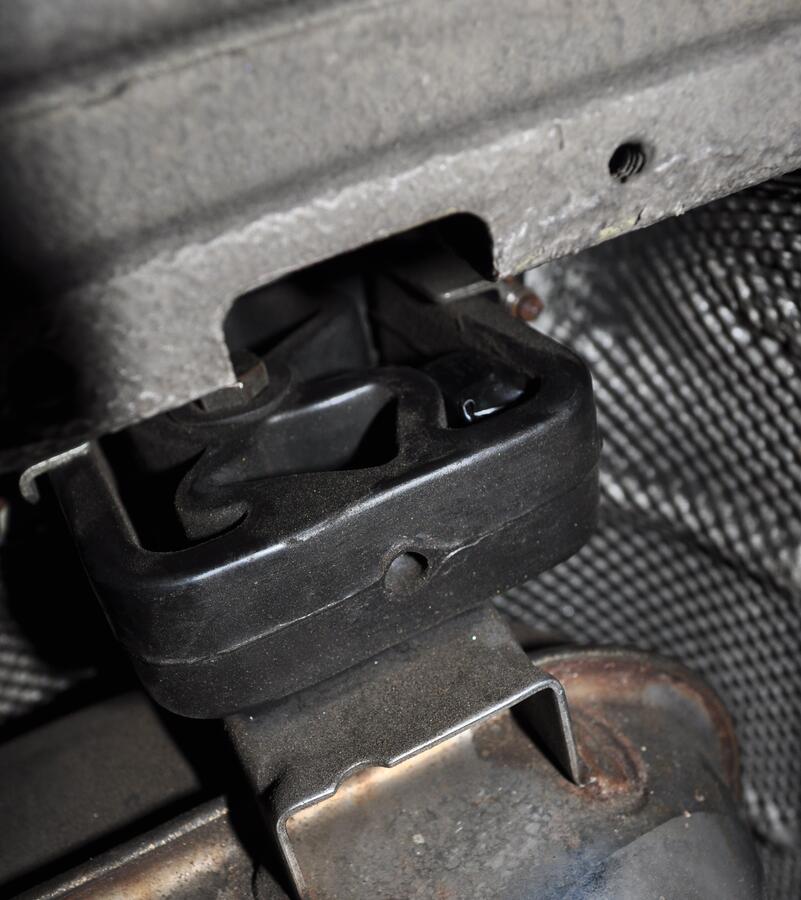

    I also shimmed the passenger side hanger with some rubber blocks. This helped push this side out a little more.

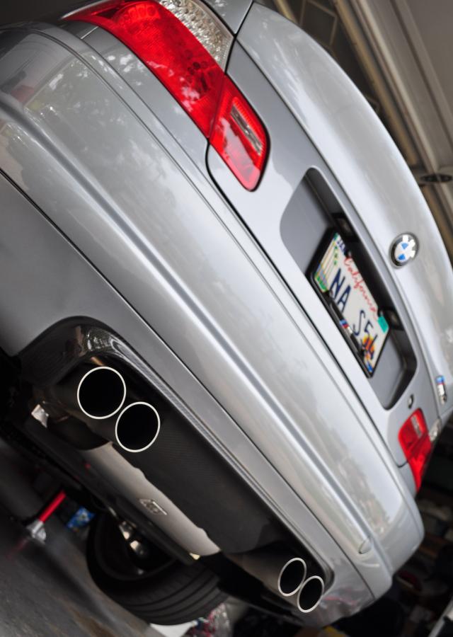

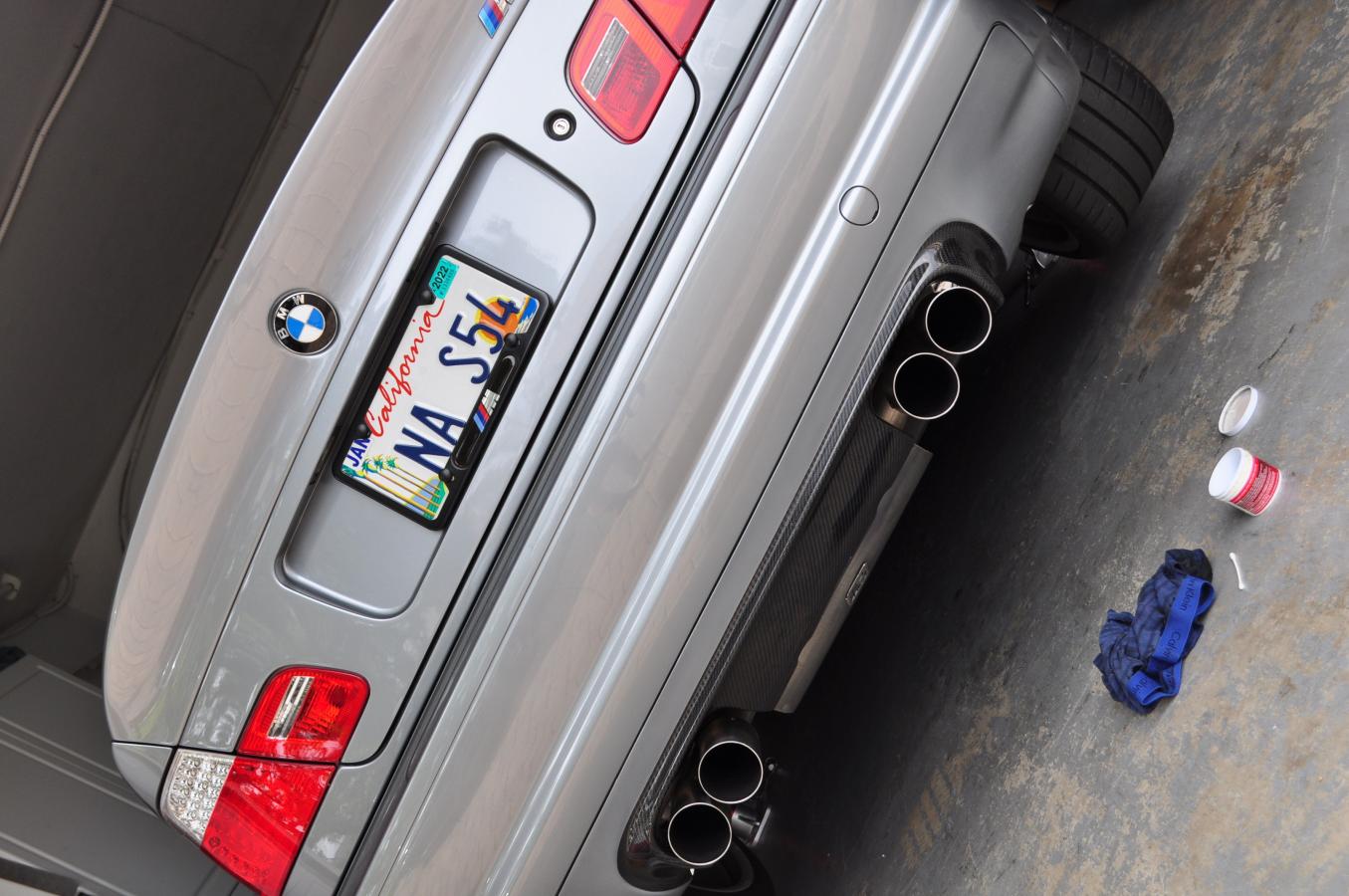

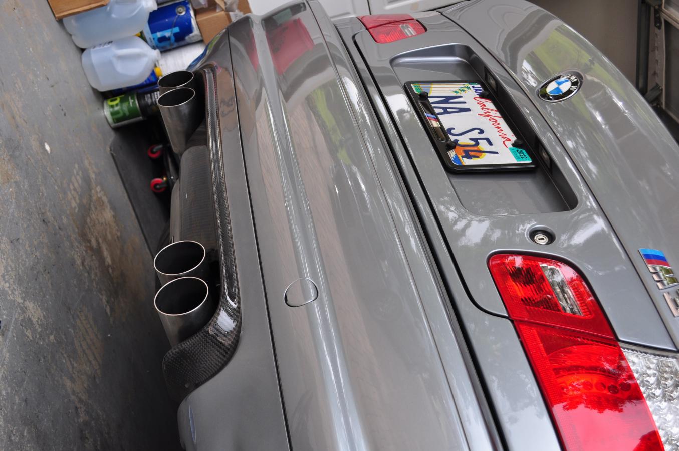

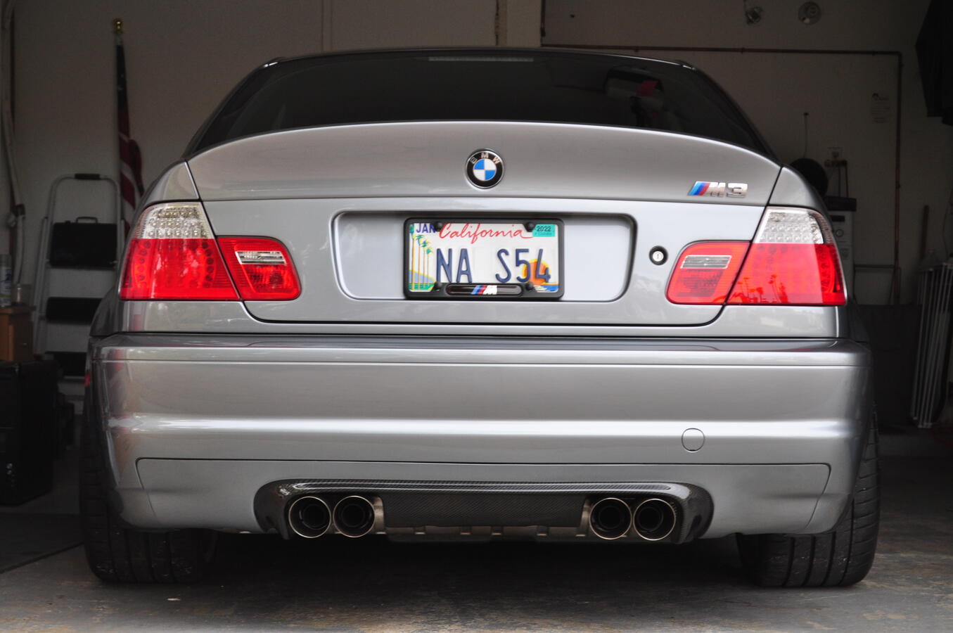

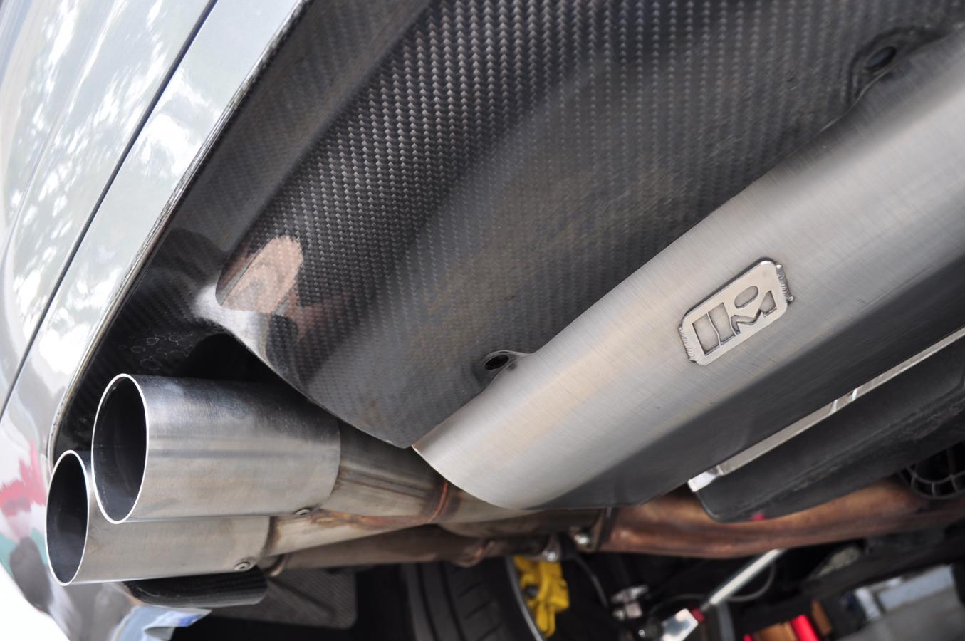

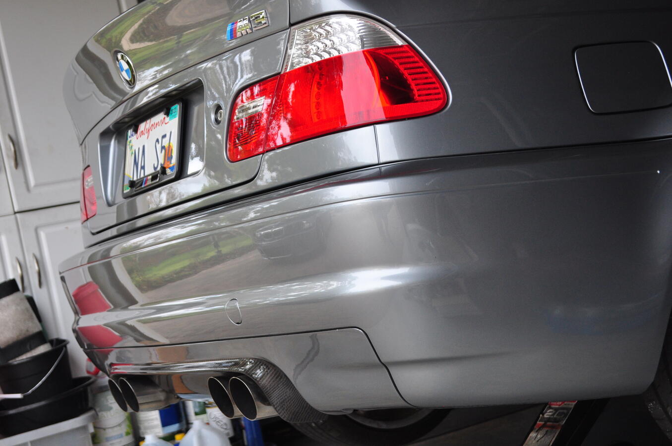

    Here's the end result:
    For me, this is perfect. While I miss having some more exhaust noise sometimes, I don't think I'll touch this setup now that I have it exactly how I want. I'll put a muffler on my other M3 to enjoy those sounds.

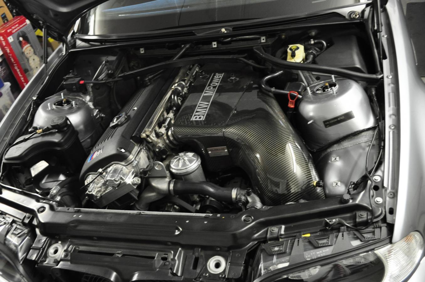

    Next up is swapping the airbox back to stock, stock tune, and getting a smog test. We'll see if the cat/o2 monitors go green

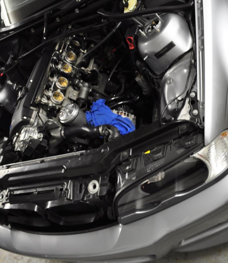

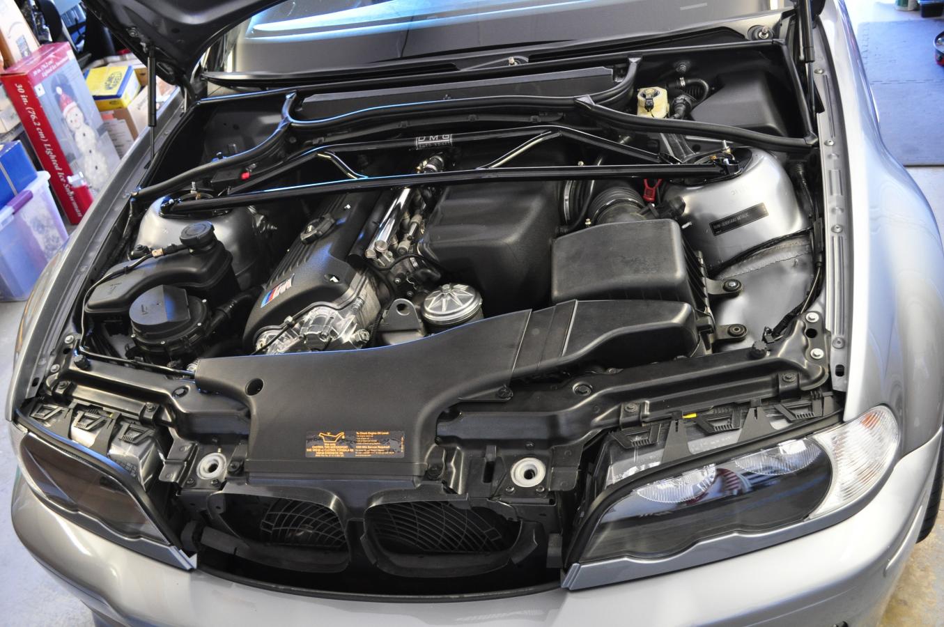

            As you saw, I put quality cats into sect 1, partly for smell, but mostly so that the car would be pretty smog ready at any given time. Now all I have to do is swap out the airbox and ECU tune, and I'm ready to test after.
            Unfortunately, the entire strut bar must be removed, so keep the car on the ground and fixed so that alignment (camber) isn't lost. Though, I did mark my camber on my towers since I just got an alignment.

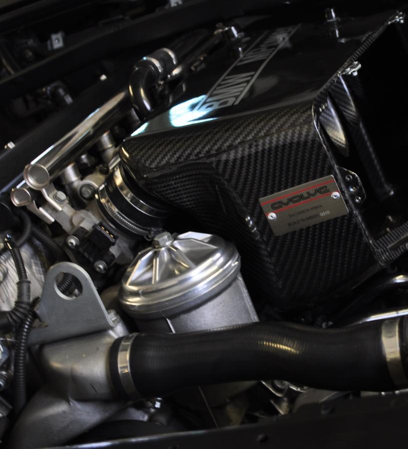

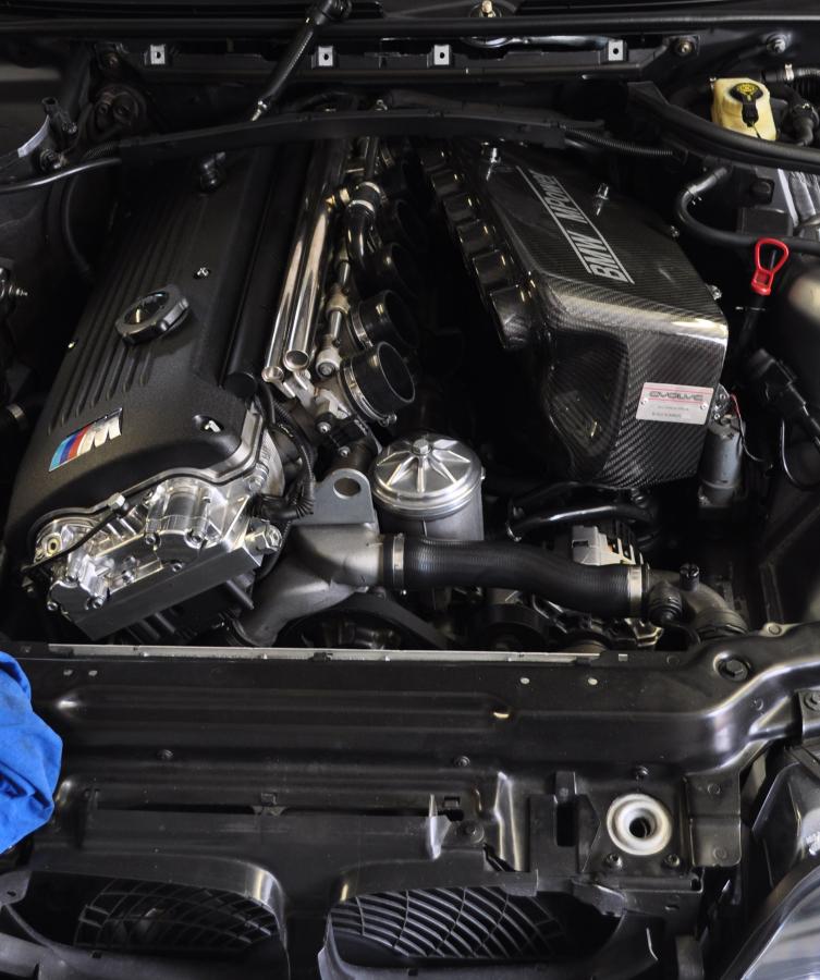

            Airbox off
            Looks stock to meeeee

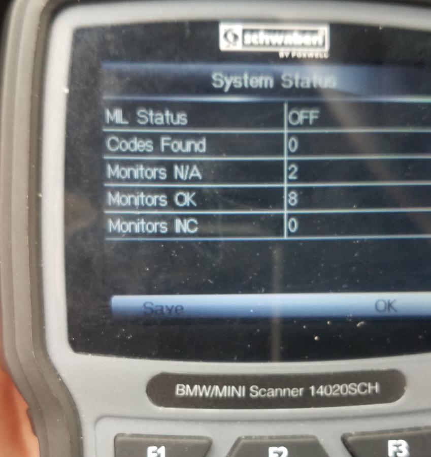

            After stock tune, I'm able to get monitors to pass pretty quickly. The HJS cats ain't slackin.

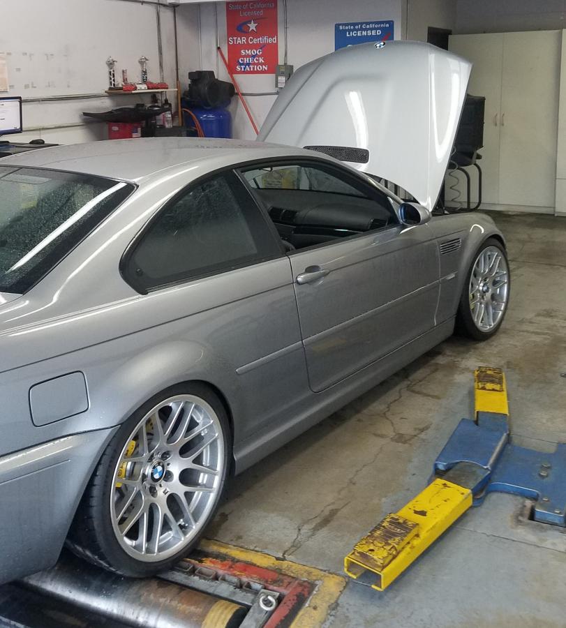

            Passed with ease. My guy does a quick look in the engine bay, makes sure I've used my scanner to confirm readiness so we don't waste each other's time, and he's done in 5 minutes. With the HJS, there's no smell, so there's no thought that the car isn't stock underneath either.
