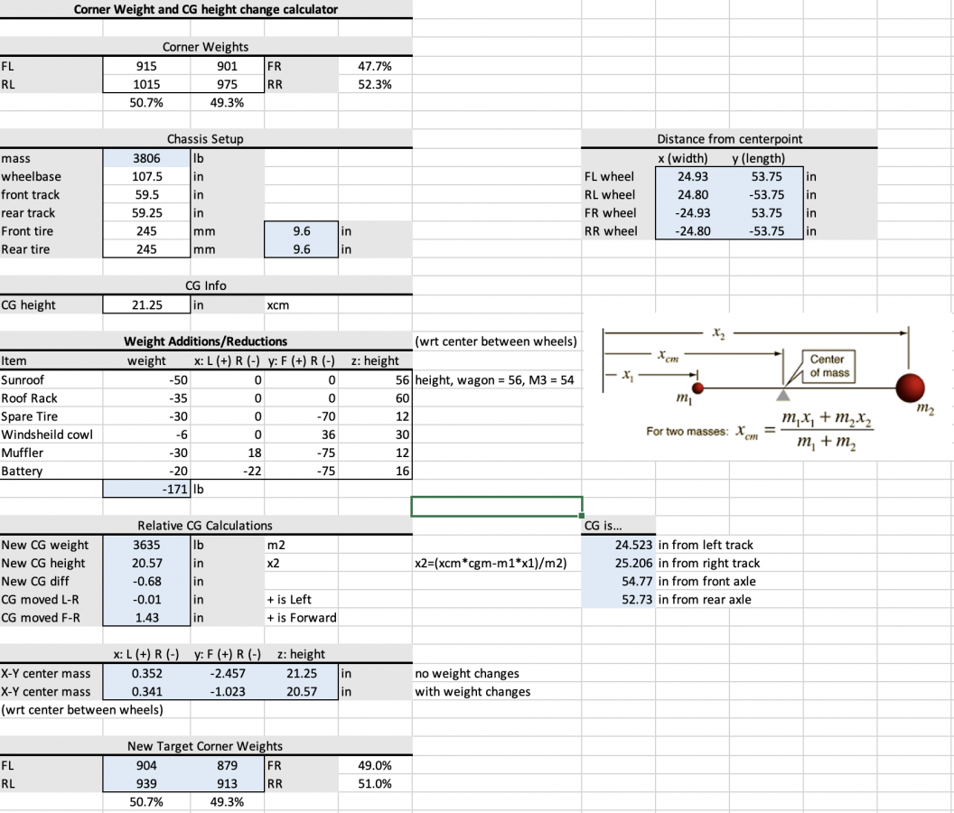

          Now that I've got the corner weights and CG height, I was able to calculate my exact CG location. And not to put this information to waste, I built a spreadsheet to track changes to corner weight and CG location (incl. height) for any given modification. I just have to enter the x, y, and z coordinates (relative to the center X of the 4 wheels, on the ground) and the weight added or removed and I'll have new numbers generated automagically.
          This spreadsheet technically works for any e46 (make sure your track and tire widths are correct) so I'm sharing it here in the case anyone else finds it useful. Enjoy!

              Well, I'm on to Rev 2 of the CG location change sheet. Really just wanted to nail this thing..
              Click image for larger version  Name:	CG location tool image.png Views:	0 Size:	643.5 KB ID:	204449

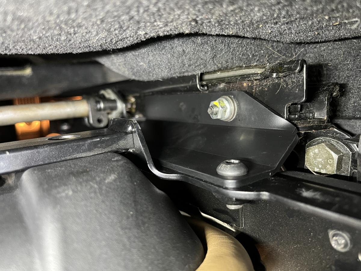

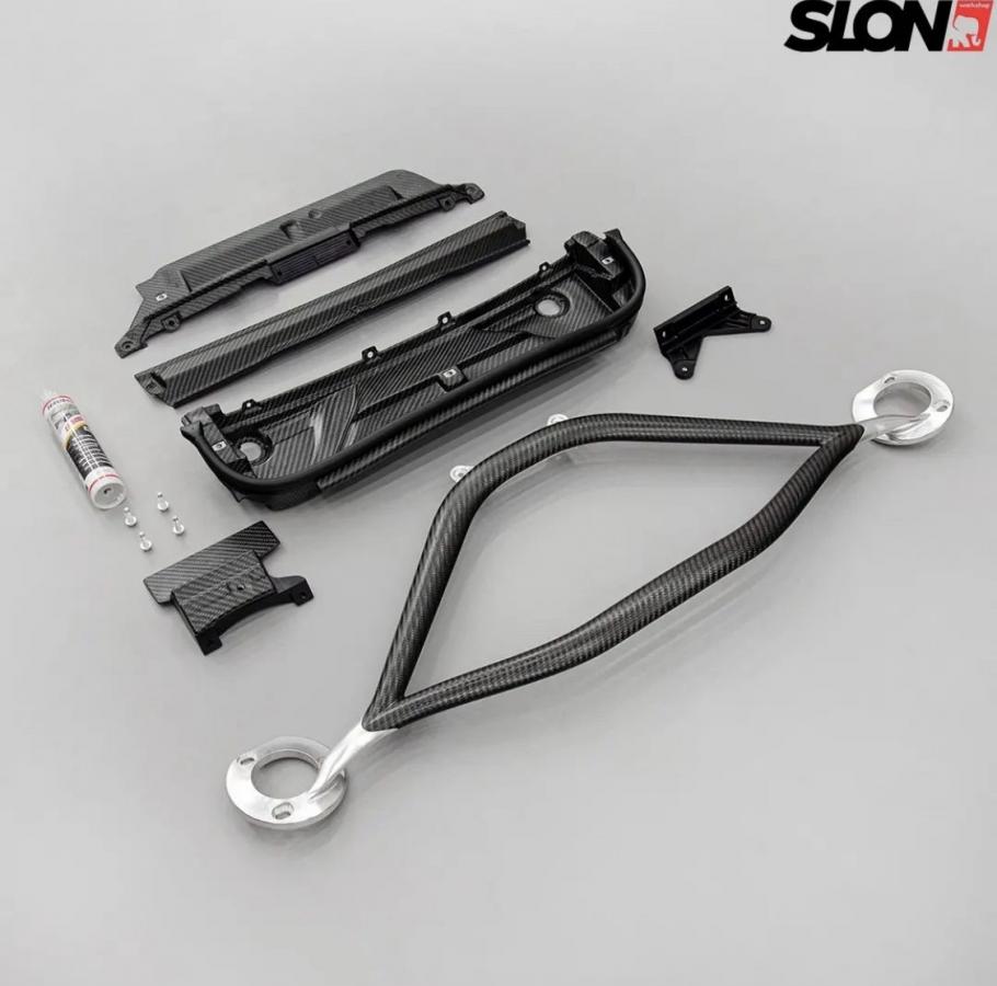

              And last but not least, for the record, slon tested the M3 v-brace at a 12% increase in torsional stiffness, with the strut brace at 20% - combining the two gets you 34%!
              Factory tourings were already a bit more rigid due to the bonded rear glass and maybe the floor.
              Assuming they are additive, this puts it at:
              BMW E46 Sedan (w/o folding seats) - 18,000 Nm/deg
              BMW E46 Sedan (w/folding seats) - 13,000 Nm/deg
              BMW E46 Wagon (w/folding seats) - 14,000 Nm/deg
              BMW E46 Coupe (w/folding seats) - 12,500 Nm/deg
              BMW E46 Convertible - 10,500 Nm/deg
              Slon stock M3 - 14,200 Nm/deg
              Slon M3 with rear seat wall - 18,176 Nm/deg
              Bryson 332iT - 18,760 Nm/deg​

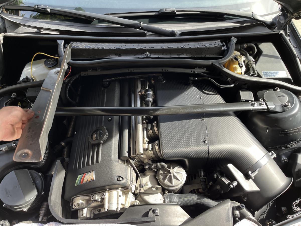

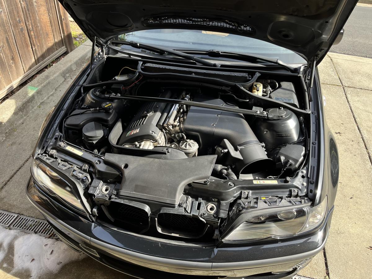

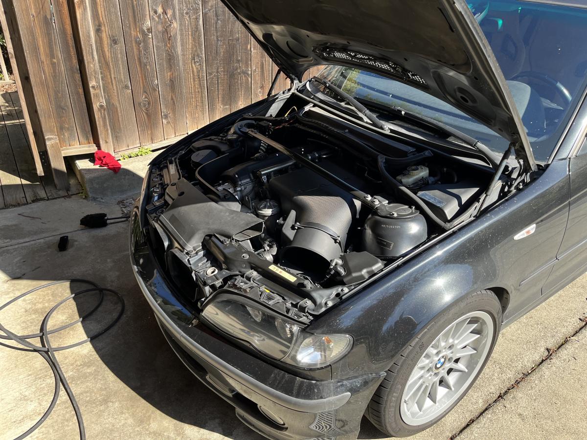

                Low key couple of weeks. Took the time today to trim the intake duct a la M3 CSL along with a car wash and vacuum as it was getting pretty messy. Excuse the power wire that’s connected to my wideband for datalogging purposes (did my own WOT tune using Tunerpro). I also received the missing heat shield that keeps the AC working well. Gotta add a few nutserts to the frame rail and get that thing installed. The right time to do this is when the engine is out..
                I also caved and ordered a Wavetrac and 3 new CV joints (diff from diffsonline). I loved the Torsen in my old 6-speed Z3 coupe and the diff in this M3 is tired. Goodbye m-clunk! Thanks in advance heinzboehmer and/or Trent for the extra hands.
                Click image for larger version  Name:	185CE6A3-EF6D-4BBA-B40F-6165701163F5.jpg Views:	0 Size:	216.3 KB ID:	206229 Click image for larger version  Name:	7BD7B8E6-7203-40C6-B1A8-B5F7C204FA2E.jpg Views:	0 Size:	213.5 KB ID:	206230 Click image for larger version  Name:	7641BE56-3026-4848-A191-3B8B49C9D883.jpg Views:	0 Size:	171.3 KB ID:	206232 Click image for larger version  Name:	F16E83D9-5C71-4CFC-9918-6A6ED2E2E283.jpg Views:	0 Size:	237.1 KB ID:	206231 Click image for larger version  Name:	8B8CBC94-F0D9-437C-B1BF-6A05E2E7F7F8.jpg Views:	0 Size:	270.0 KB ID:	206234 Click image for larger version  Name:	0CAD0059-E3E8-4797-9D06-DF7484F1541B.jpg Views:	0 Size:	244.1 KB ID:	206233

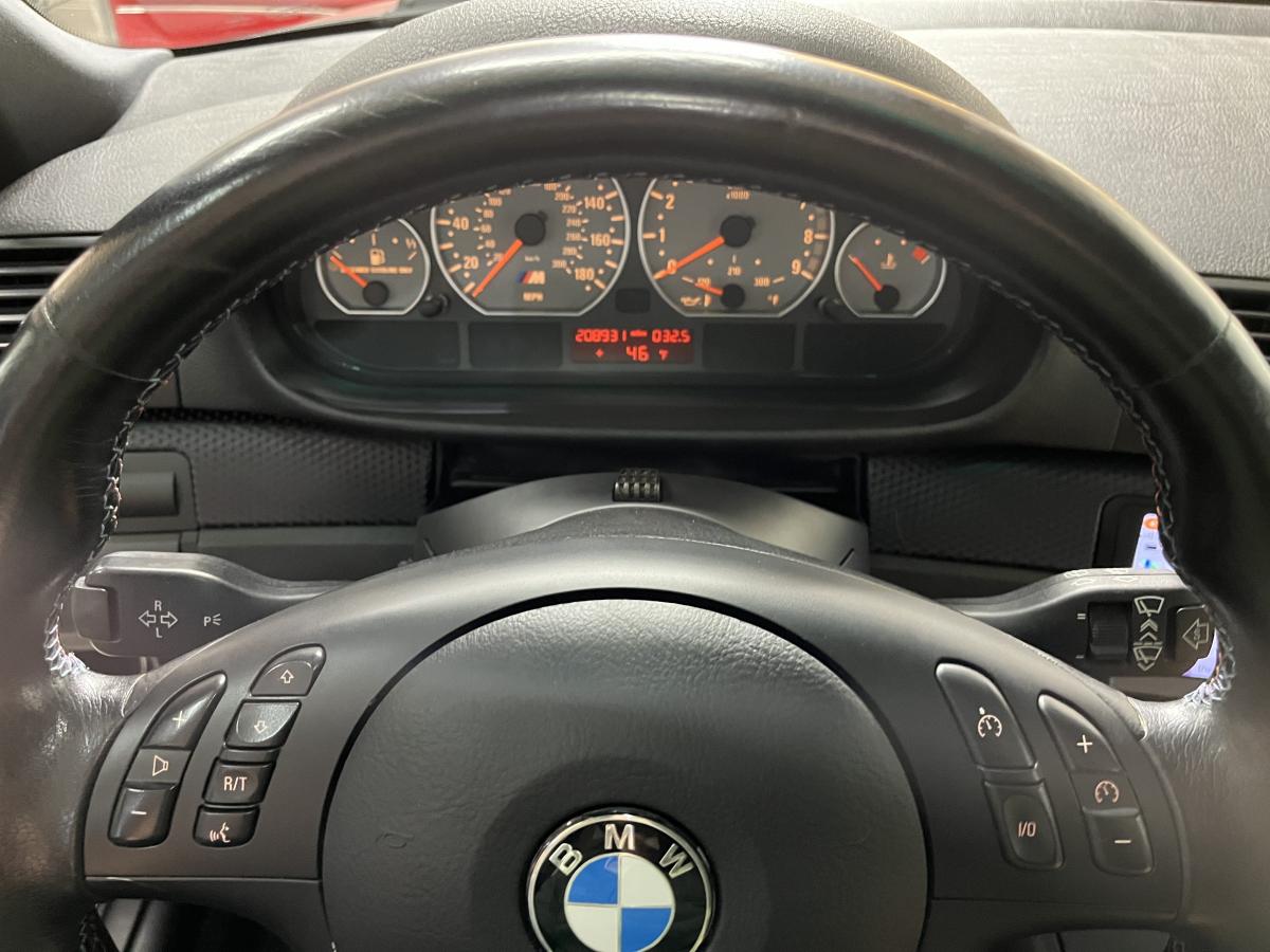

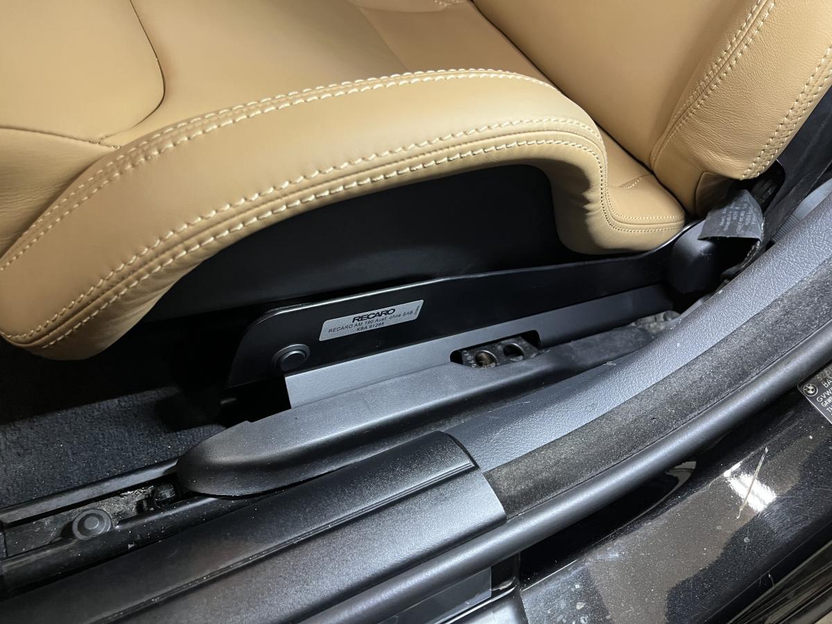

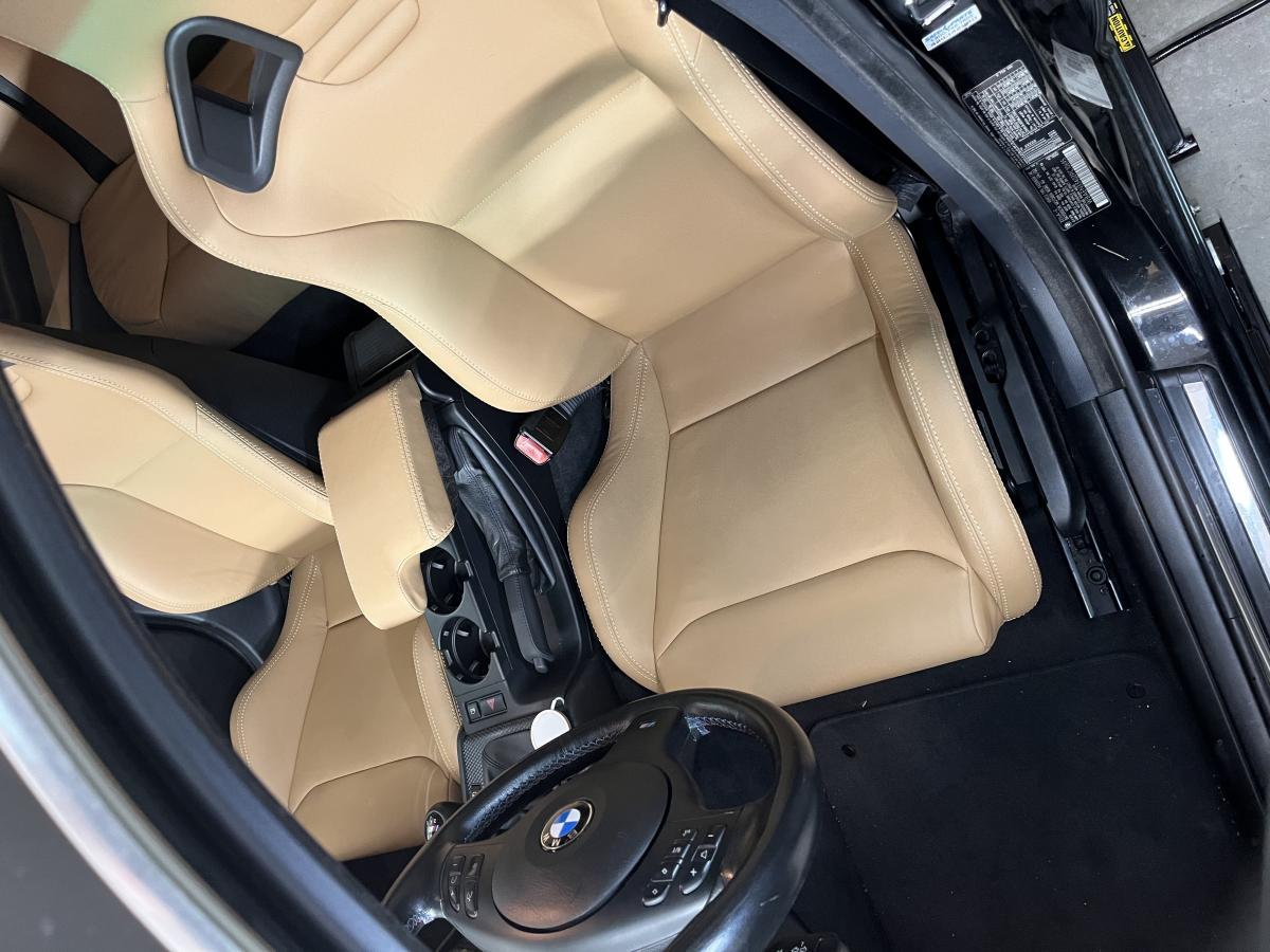

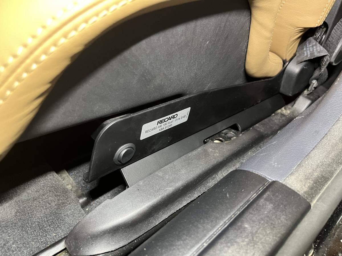

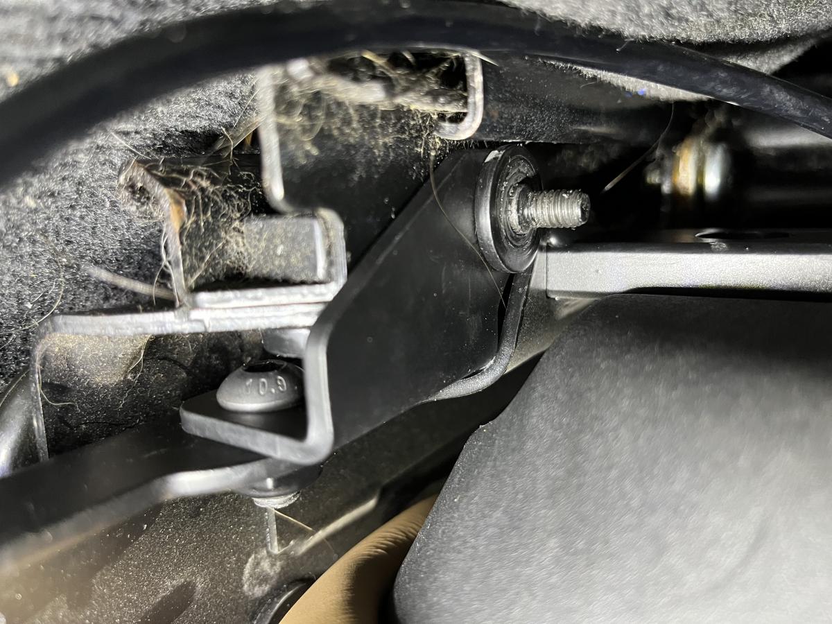

                  The v2 recaro brackets showed up, powder coated and all and I was able to get them in today. They’re millimeter perfect fitment in every dimension, and I’m very happy with the finish. Thank you sendcutsend!
                  Link to CAD, if you're inclined to recreate these: https://cad.onshape.com/documents/c4...d0507e4eaa81d3
                  Final bracket version installed:
                  Click image for larger version Name:	DCC6AA21-88E6-44E1-B9ED-E705C5B0CCAC.jpg Views:	0 Size:	129.2 KB ID:	200708 Click image for larger version Name:	58CB2AB4-0954-4B4E-AB5D-3412CE2A9B81.jpg Views:	0 Size:	148.0 KB ID:	200709 Click image for larger version Name:	47EDCE44-6BD4-4D3B-BF70-6C3669B78063.jpg Views:	0 Size:	155.8 KB ID:	200707 Click image for larger version Name:	4E514BFF-2291-4502-9EFE-6C1761904254.jpg Views:	0 Size:	166.3 KB ID:	200710 Click image for larger version Name:	BE981538-C3B5-4941-A848-718E402EE8A6.jpg Views:	0 Size:	181.5 KB ID:	200711

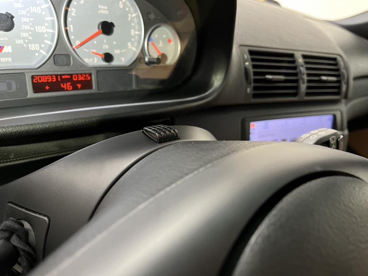

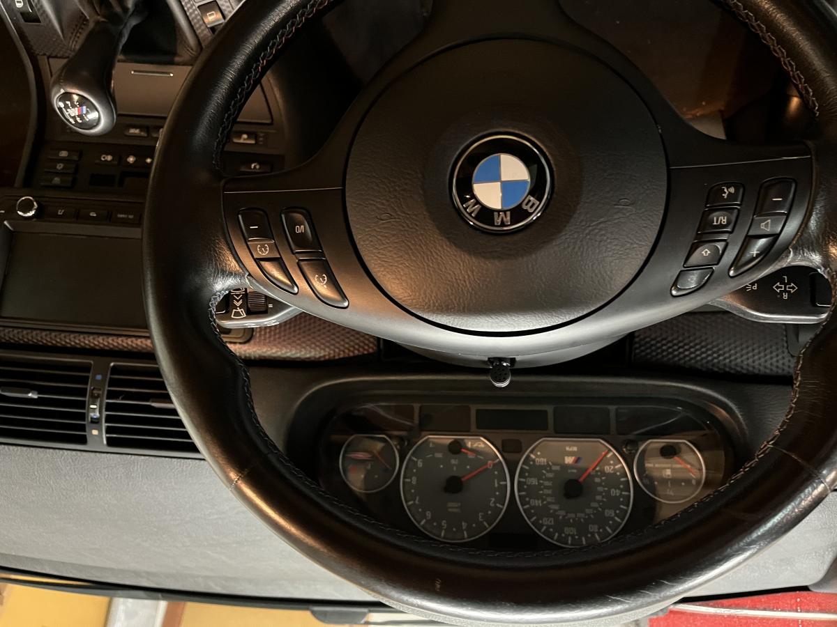

                  I also installed the upper steering column trim from a late cabrio (still waiting on the OEM mic, just wired my existing one in for now) and swapped out the steering shaft flex disc. No pics of the flex disc but here’s the cabrio column trim:
                  Click image for larger version Name:	8C008CCB-A8EE-444B-8375-039CDCD4F3AB.jpg Views:	28 Size:	124.6 KB ID:	200712 Click image for larger version Name:	19E645E3-E405-4E89-B5EC-19AEB1C36292.jpg Views:	26 Size:	104.3 KB ID:	200713 Click image for larger version Name:	1FA80416-0FE5-4176-8902-30A0025C55AE.jpg Views:	26 Size:	106.6 KB ID:	200714
                  Great thread and amazing build.
                  Love the idea of using the cabrio steering wheel trim to fit the microphone. Any additional information you can share on this? Have you finished installing it yet?
                  Is the factory mic plug and play with the AVIN radio? Or did it require some work to get it functioning properly.
                  ​​​​​​​TIA!

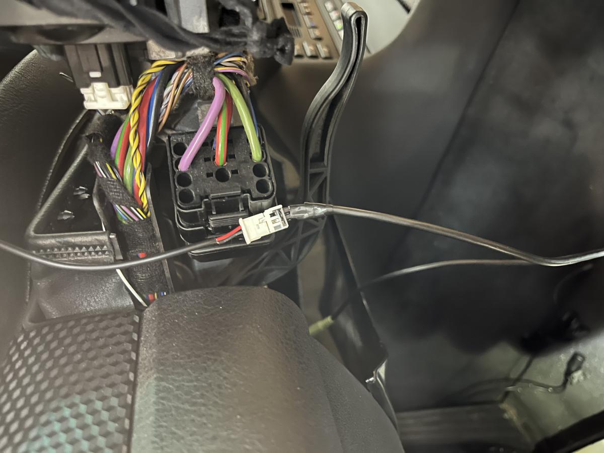

                    Thank you! I did finish wiring it up to the factory mic, but alas, the cheapness of the Avin engineering shines bright. The mic input is connected through the Avin’s Bluetooth module directly, and as I use CarPlay the Avin does not use the mic plug from the back, but uses the built in mic on the front of the panel at all times. Callers on the other end of your CarPlay phone calls will report no difference in audio quality whether a mic is plugged in or not, and in fact folks on the other end of my calls heard a sawtooth like interference noise. Undoubtedly due to crappy layout of the traces on the board that lead to the microphone input. I opened the Avin unit up, disconnected the internal mic, and under no circumstance did any audio come through from my end.
                    When using the factory mic with the Avin unit over Bluetooth (which means no CarPlay), sound is clear but quiet, and unfortunately I never did test the original mic in its place.
                    At some point in the future, next time the dash is apart, I’m going to have to take apart the Avin unit, trace the circuit and hard wire this mic in place of the front panel one. Probably by bypassing as much of the board traces as possible..
                    Eventually, I’ll get this one right as I’m really tired of putting headphones in when I get a call.

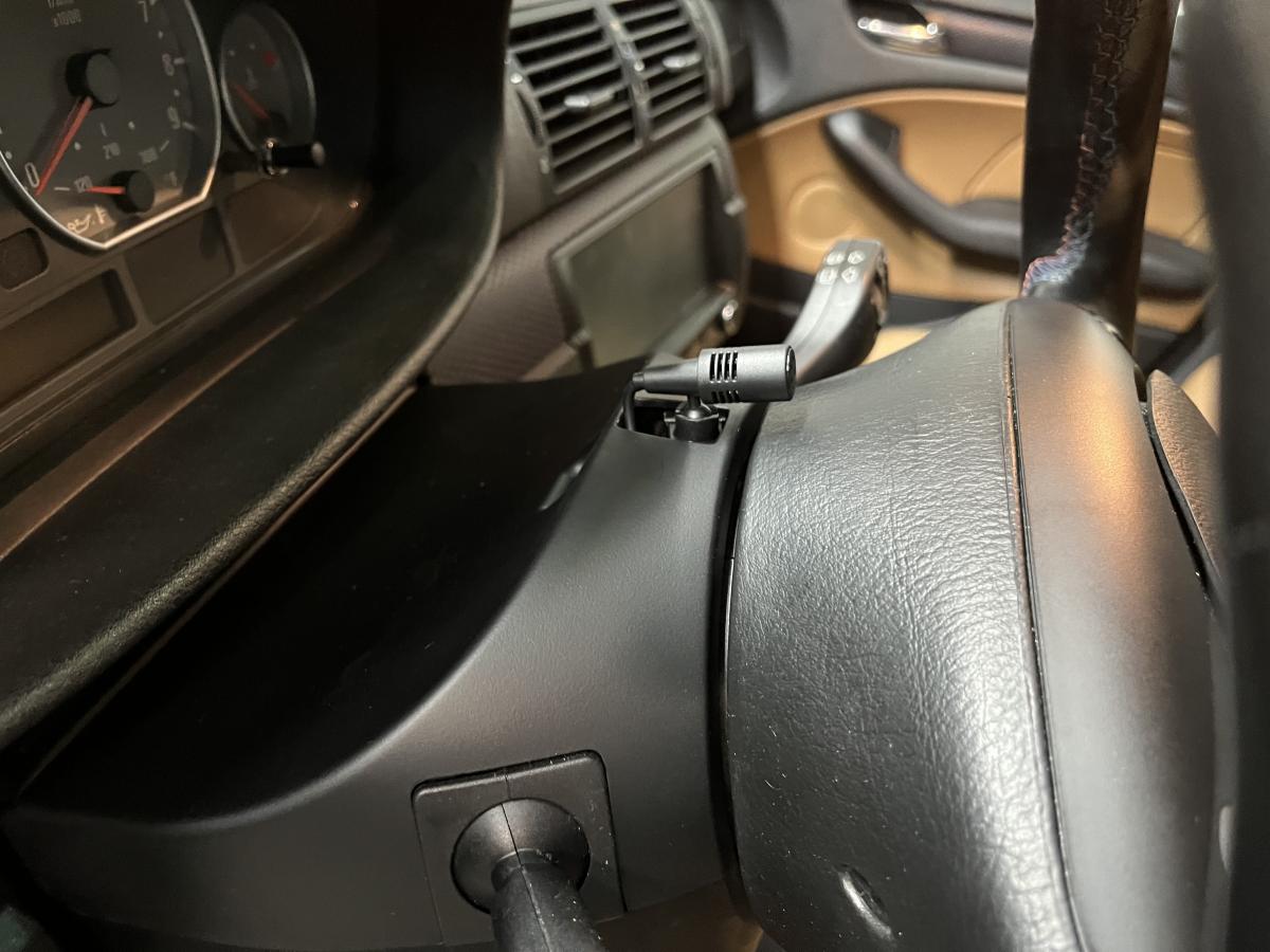

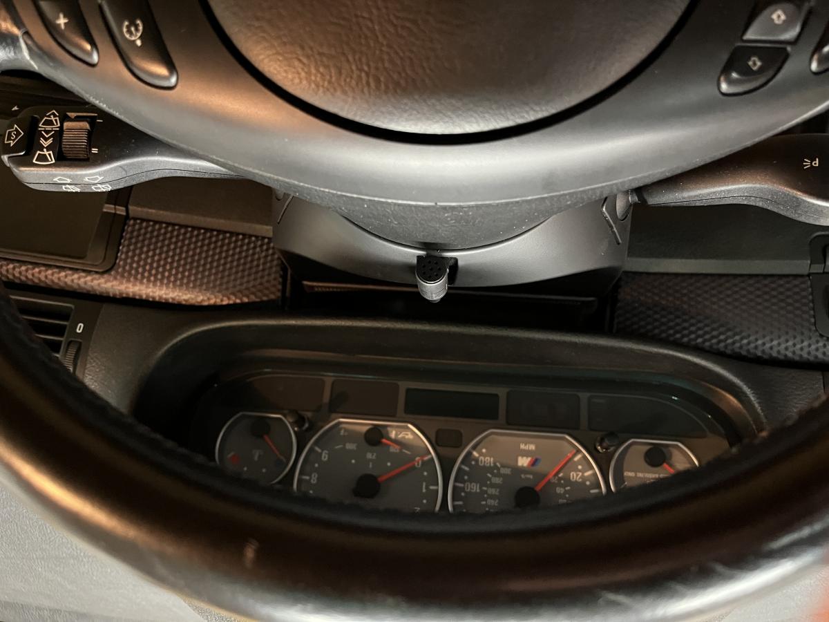

                    A couple photos of the cab mic. If anyone knows the part numbers for the mating plug and contacts, I’m interested!
