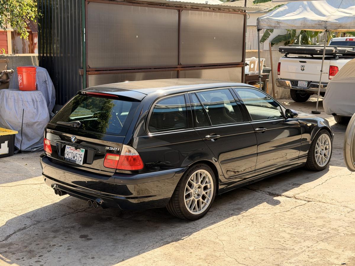

    I picked it up in May this year as a black/grey swapped touring, lowered on soft springs (mostly bump stops) and it needed a significant amount of work to make it proper. Many invested hours later, it's now black/natural brown and has been completely gone through and drives about as close to a new e46 as any I've driven since I worked on them when they were new. It's my DD, so it must be smooth and quiet.
    Some details:
    2002 Sapphire black/natural brown/black cube 332iT
    206k miles (time of post)

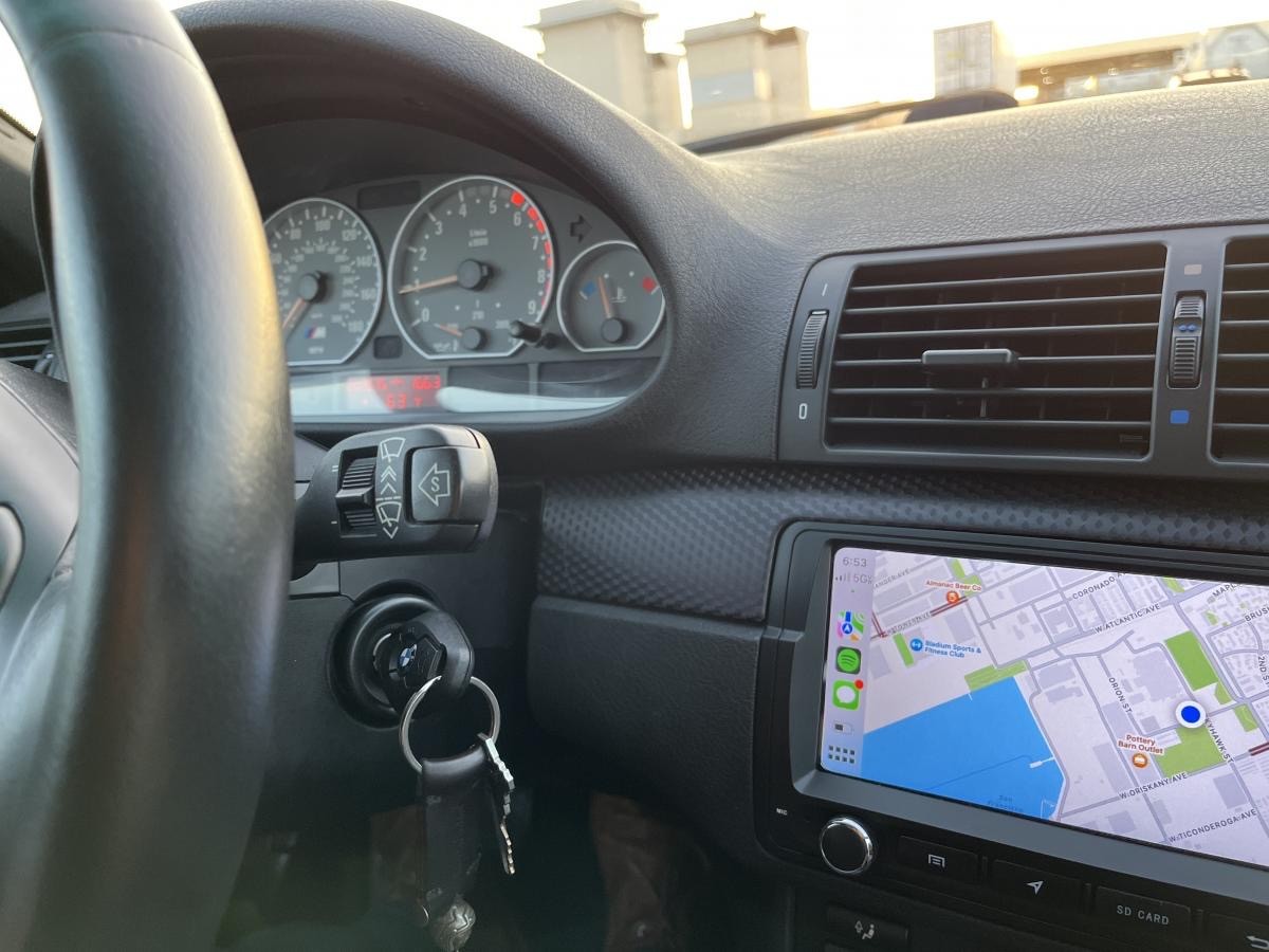

    M-track mode, DSC button wired to wiper stalk "S" intensive wash button
    TPMS and sport button both function correctly (all console buttons I guess)
    Recaro sportster CS seats, trimmed in natural brown with OEM compatible heating and electric fore/aft + memory, mounted low on custom frames
    Retrofitted auto headlights & wipers + quad blink turn signals
    XTRONS Android/CarPlay head unit

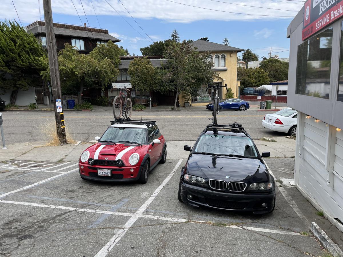

    Low profile roof rack with two mountain bike capable bike racks [since removed]

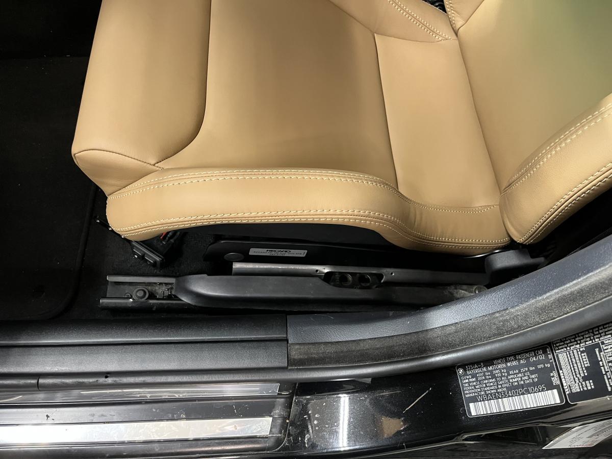

      Thanks, yeah the seats really worked out. I ended up having to modify the EEPROM data in the switching console to get all the heat levels to be the correct temp, but it's all gravy now.

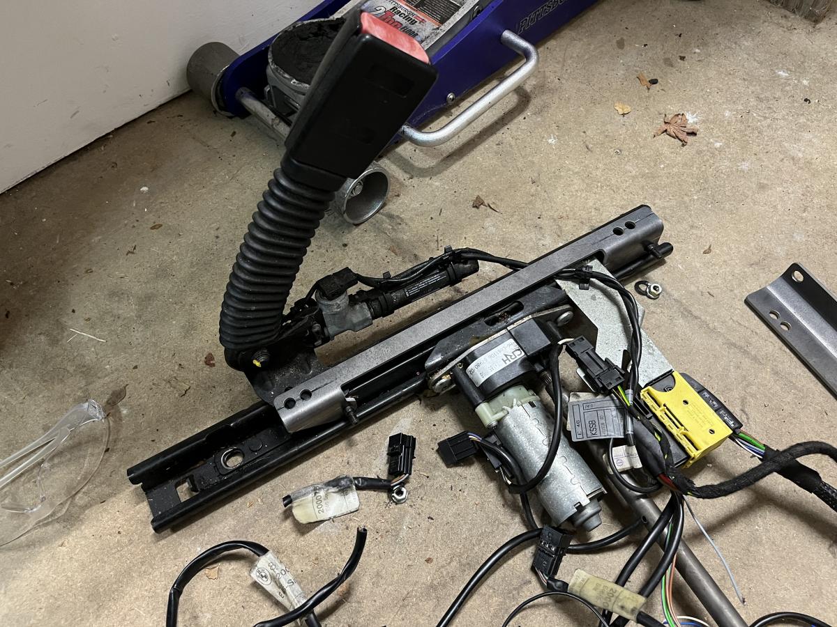

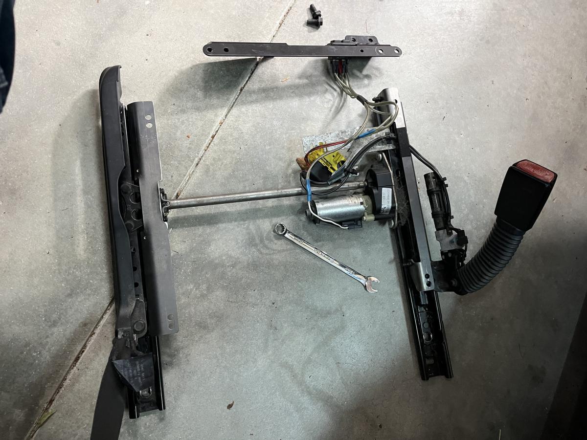

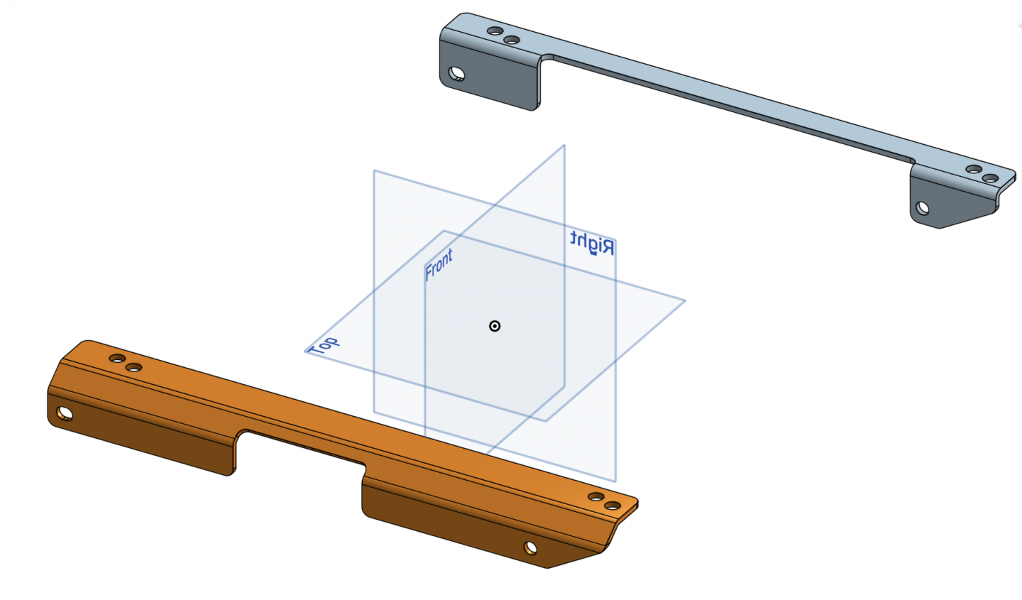

            I was feeling motivated last night, so I finally signed up for OnShape and designed up some seat mount brackets for the recaros that still use the OEM electric sliders. There are a couple really tight clearances under there so I added two different mounting options. I'm hoping that one of them clears as I'd love to sit just a little bit lower (~3/4").
            One option is biased to the center of the car like stock, but my legs max out the slider travel in this position. The other trades clearance to the bottom of the recaros by bringing the seats 4mm toward the door but gives me a half inch of extra rearward travel. Hopefully I'll get some time in the shop this weekend to knock these out, otherwise it'll be a while before I have free time.

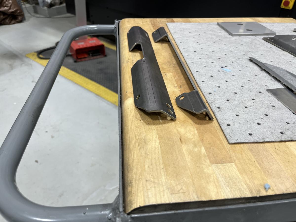

                Got some time on the machines, first articles are done. Test fit to come this weekend, these will be as low as possible with the OEM sliders.

                  Nice, those look great. What did you make them out of?

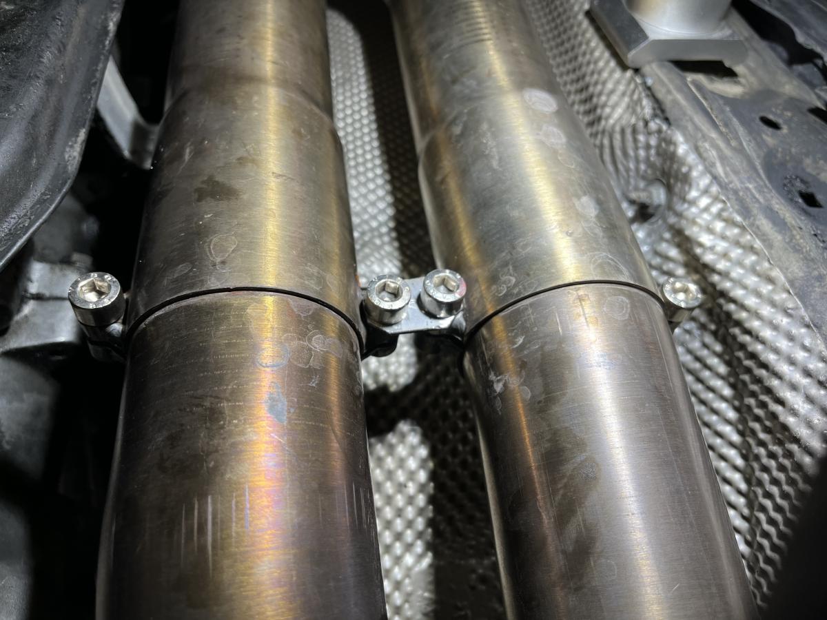

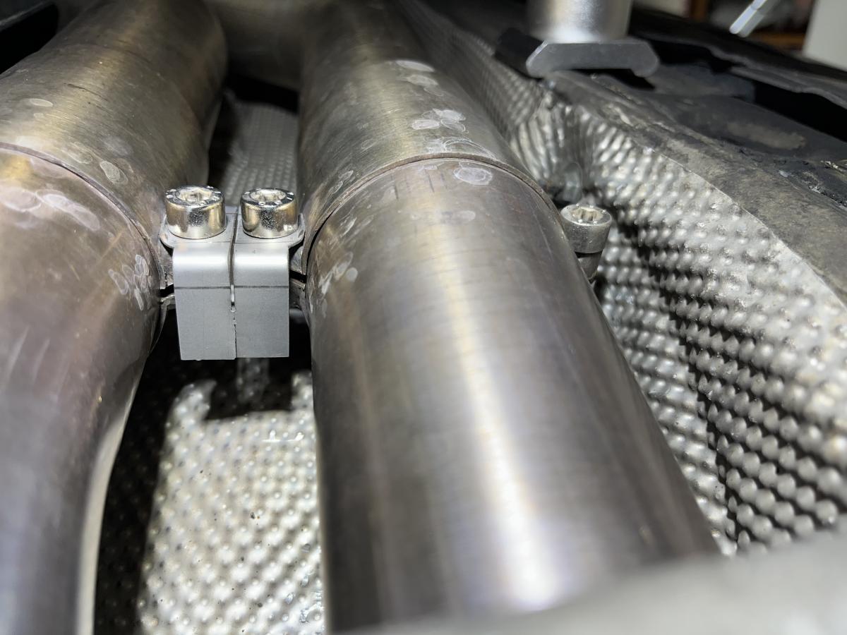

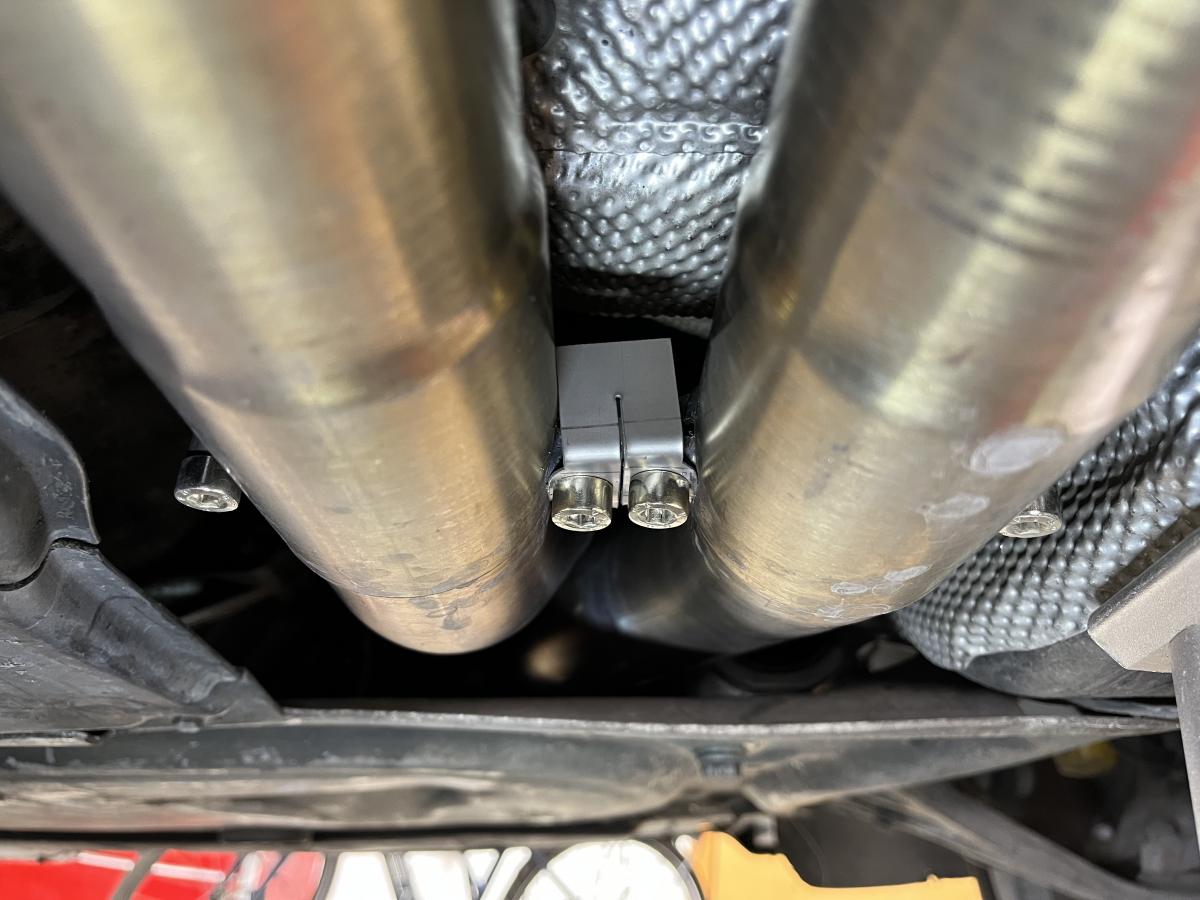

                    SS V1 headers + catted section 1 (joined both pipes together to keep the tubes from resonating/vibrating at idle)
                    Have any pics of this? Curious how you joined section 1.

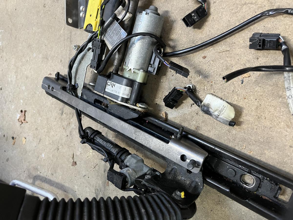

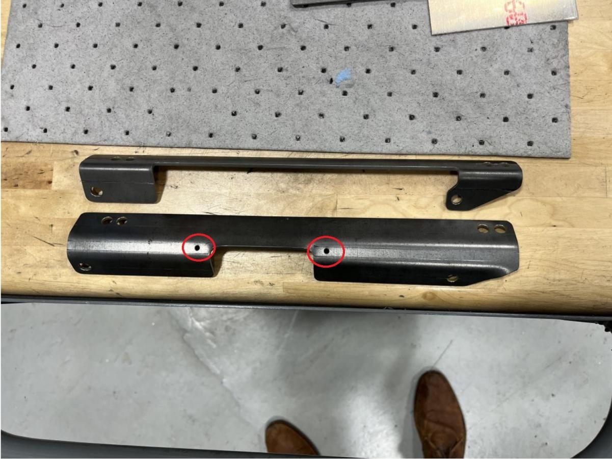

                    This pic below - what are the small holes for? For a x-mas tree clips to secure wiring or do they have another function? Those Recaros look spot on in the car, BTW.
Name:	Recaro brackets.jpg
                      Went with 11ga A36 steel. Easy to bend, not a lot of spring back, cheap and plenty strong.
                      Click image for larger version  Name:	Recaro brackets.jpg Views:	4 Size:	132.9 KB ID:	196536

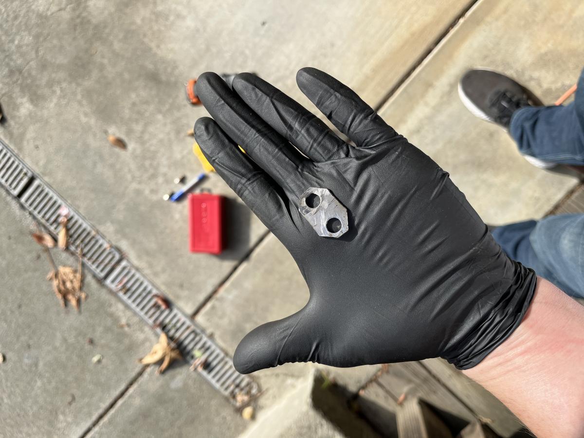

                      Version 1 of the SSv1 bracket, which didn’t pass the fatigue test after 1 week of driving (.032 titanium):
                      Click image for larger version  Name:	7540E299-AE5B-4979-8B31-B105209F9A78.jpg Views:	0 Size:	108.4 KB ID:	196560 Click image for larger version  Name:	7D7D032D-FA76-41E3-A8CB-9A4DD43114EB.jpg Views:	0 Size:	106.1 KB ID:	196561
                      Version 2, which has been going strong for several weeks now, dead simple, and I’m confident it’s good (.063” stainless):
                      Click image for larger version  Name:	20F377B9-CDBB-4B2C-AA4D-6F39B30A6827.jpg Views:	0 Size:	129.1 KB ID:	196562 Click image for larger version  Name:	6DB4ADF4-1BB8-42DD-9126-1F7ED0A1C40B.jpg Views:	0 Size:	130.1 KB ID:	196563
                      Nice eye. The small holes are for the yet to be designed Mount for the fwd/aft seat motor switch. I haven’t really decided if that’ll be sheet metal or 3D printed yet.
                          Wow, that is MUCH simpler than I envisioned, lol.

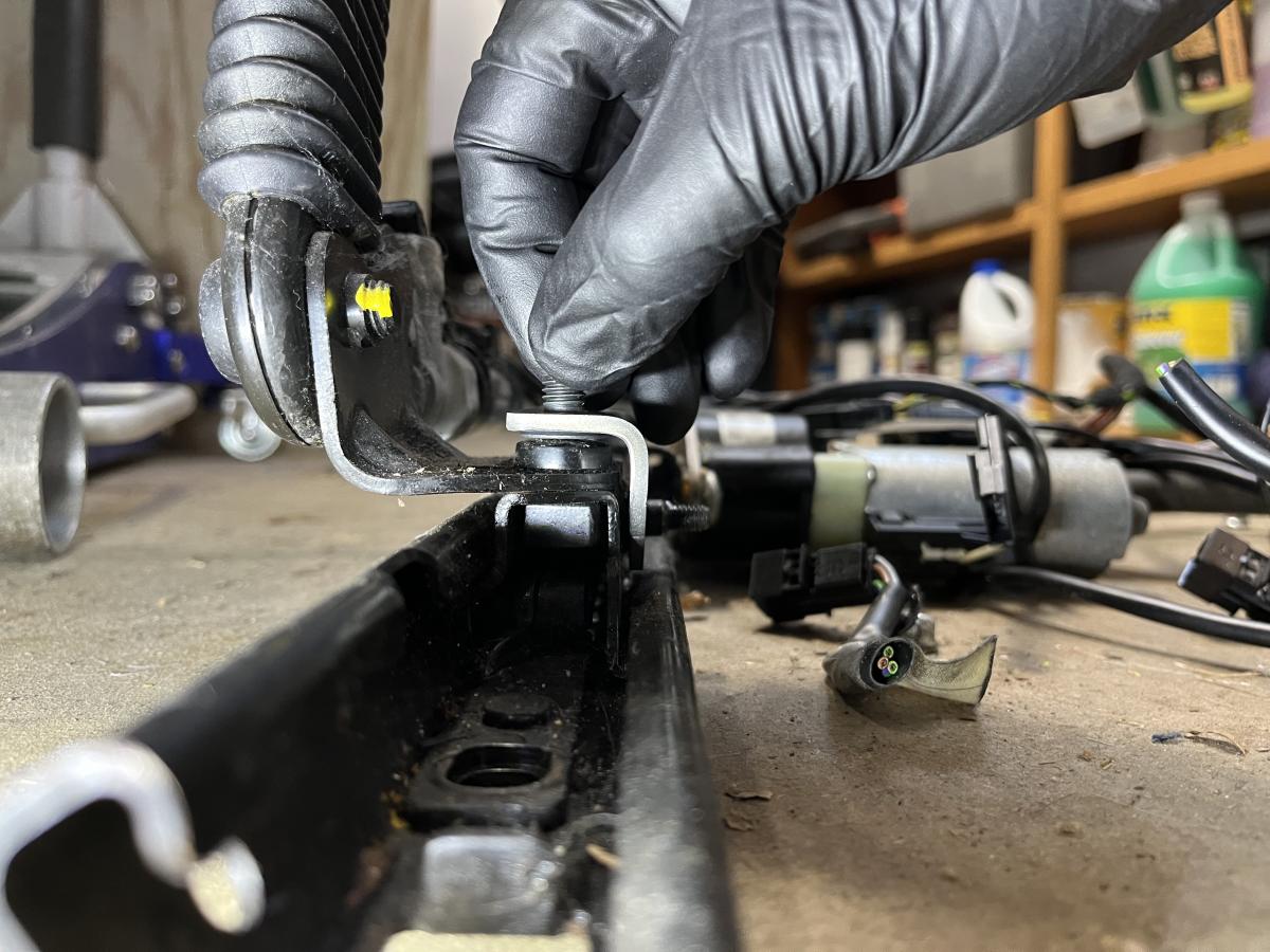

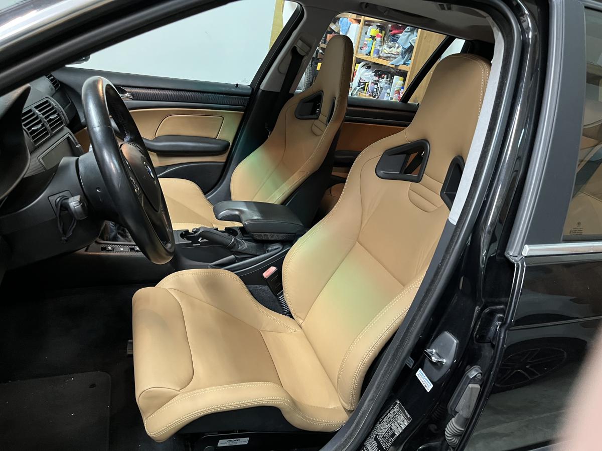

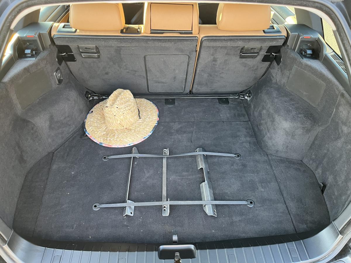

                              Got a chance to install the driver's side bracket today, and learned everything I needed to learn. Next version will be 4mm higher, 8mm to the center of the car (same as Brey Krause), and I've figured out a better way to do the fwd/aft electric motion, so I'll delete those little mounting holes.
                              As measured, I'm currently sitting 18.5 (~3/4") lower than the Grey Krause mounts, which was exactly my target. I'm pretty stoked. V2 will be coming in soon

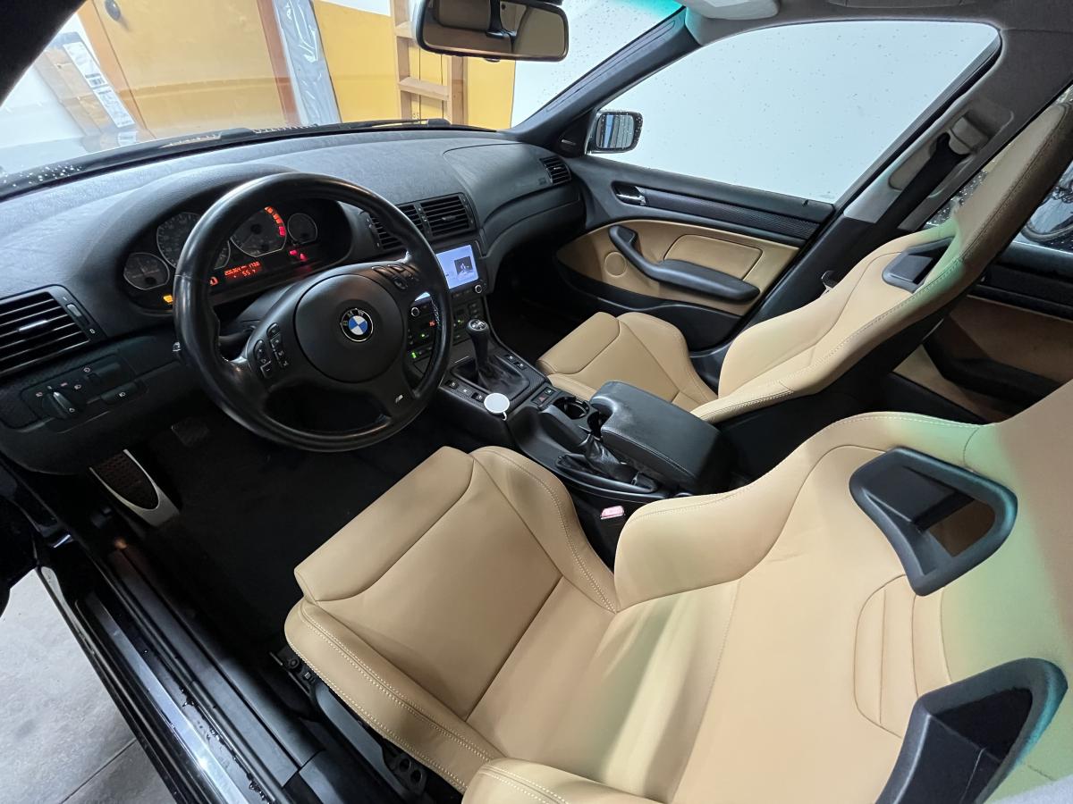

                              Also, I caught the car in really good light and snapped a photo of the interior front/rear seat color match. Photos always show up looking so much nicer on my phone..
                              Click image for larger version  Name:	IMG_3366.jpg Views:	0 Size:	140.8 KB ID:	196600
                              Click image for larger version  Name:	IMG_3365.jpg Views:	0 Size:	205.3 KB ID:	196596 Click image for larger version  Name:	IMG_3370.jpg Views:	0 Size:	160.9 KB ID:	196597 Click image for larger version  Name:	IMG_3381.jpg Views:	0 Size:	130.5 KB ID:	196601 Click image for larger version  Name:	IMG_3362.jpg Views:	0 Size:	177.0 KB ID:	196598 Click image for larger version  Name:	IMG_3359.jpg Views:	0 Size:	249.9 KB ID:	196599
