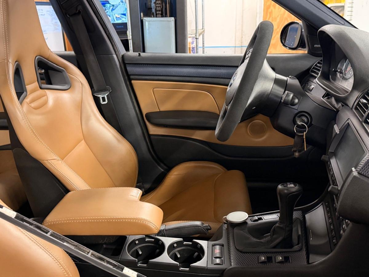

    I went with the factory BMW performance shift lever (25-11-7-528-881) which feels just a hair shorter than the stock M3 shifter did. I liked the M3 throw but I’m not complaining because man this gearbox shifts well in comparison. The lever is positioned just slightly forward and to the right of the M3.
    On to gearbox feel, it sort of ‘snaps’ into gear like the more modern Porsches (my target) and there is near as zero slop or imprecision in or between the gates. This is all with factory NVH isolating parts too. Really nice, actually changes the character of the car. It doesn’t feel as beefy as the getrag in a way, which is hard to describe, but you don’t need to muscle it into gear at all, it just happily pulls right into the next gate. We’ll see how I feel after a redline 1-2 shift, but I’m hoping that the M3 transmission mounts will help with that.

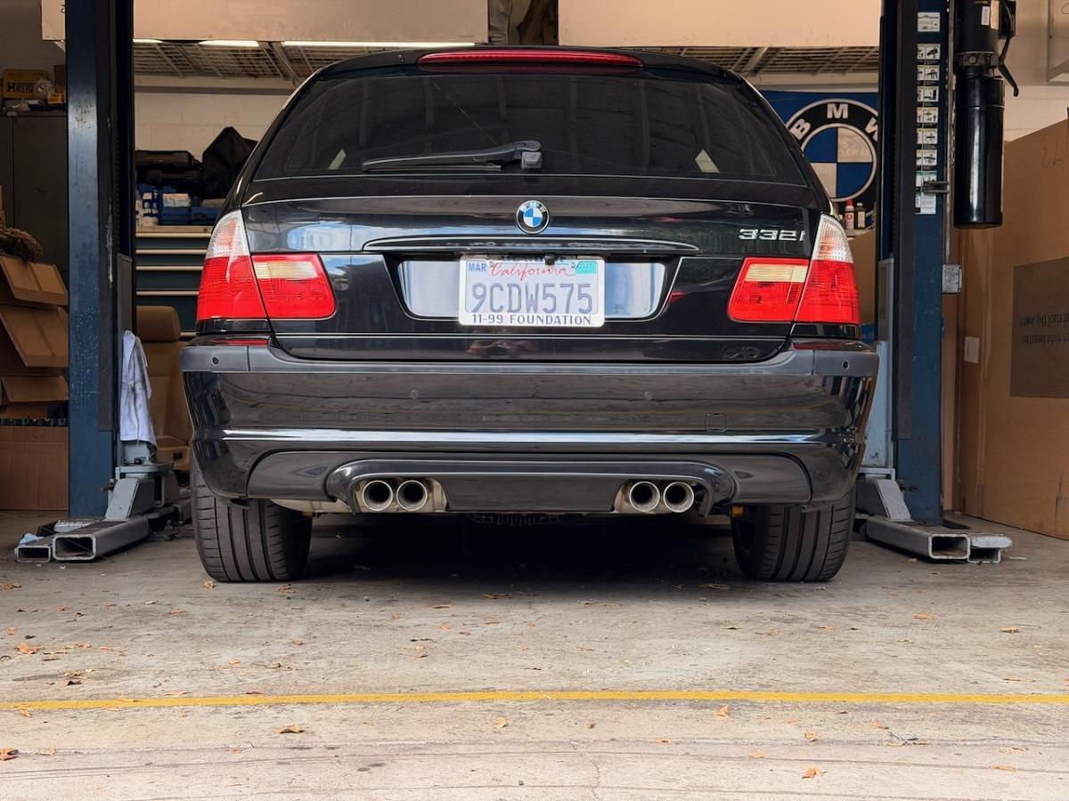

            Uncanny to see the rear tail pipes on a narrowbody. Like a sleeper tease. lol

              And call me crazy (twice in a row?) but I prefer the stock twin pipes on the narrow body, but I agree the quad pipes on the narrow body really highlight what’s there for those who know. All about the sleeper

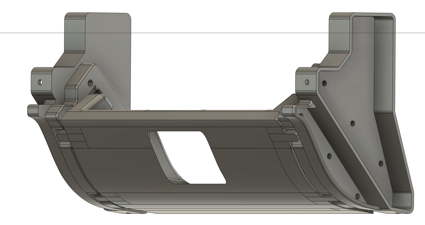

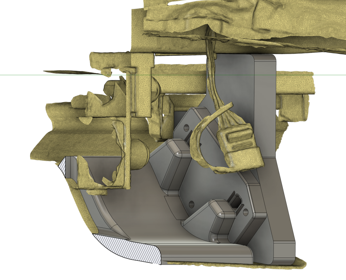

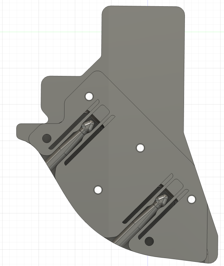

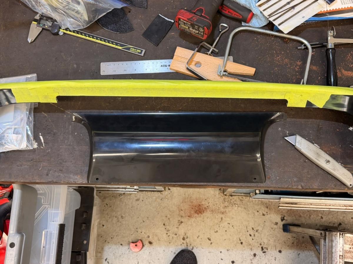

                I promised earlier that we'd get back to the trailer hitch - that time is now. Starting with the scan we took while the trunk floor was out, built up some CAD to create a mechanism to make a tool-free trailer hitch hatch. It pulls out and installs at a 45 degree angle to the ground and is retained using 8 plastic 3D printed springs integral to the mounting parts. The mounting parts, on either side, bolt to the plastic bumper and the hitch bumper bar. The whole center section of the valance is then bonded to a 3D printed hitch hatch so the center section drops out all as one. And there are bosses printed proud such that the whole hitch hatch rests on the bosses and none of the visible plastic has to touch any surface when removed. Because OCD.
                So here's the CAD we started with:​
                Click image for larger version  Name:	Screenshot 2026-09-05 at 2.24.25 PM.png Views:	0 Size:	875.0 KB ID:	366248
                Click image for larger version  Name:	Screenshot 2026-09-05 at 2.24.48 PM.png Views:	0 Size:	264.8 KB ID:	366240
                Click image for larger version  Name:	Screenshot 2026-09-05 at 2.56.25 PM.png Views:	0 Size:	122.5 KB ID:	366236
                Then a photo of what it looks like with the trimmed section removed. If you're curious, I scored the plastic about 30 times with a sharp utility blade then cleanly broke the two parts apart. This worked quite well actually.

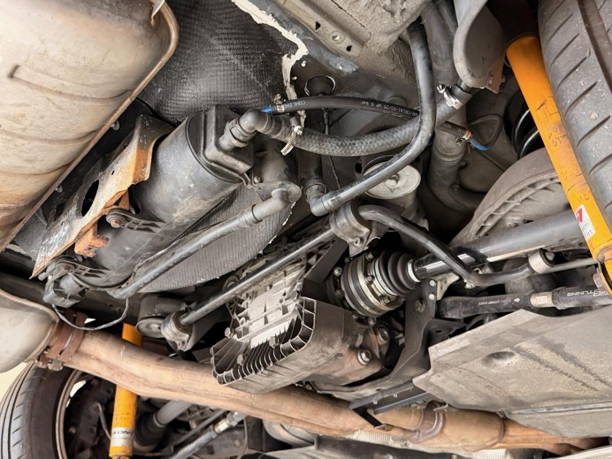

                In that photo you can also see how I totally jerry rigged the non-m EVAP hoses to connect in the M3 location, more detail of that temporary move to make the car safe(r):
                Click image for larger version  Name:	IMG_0253.jpg Views:	0 Size:	169.6 KB ID:	366245

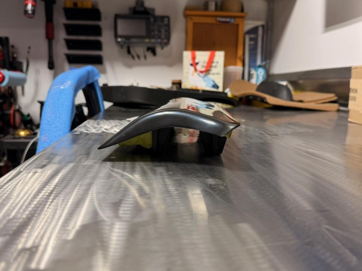

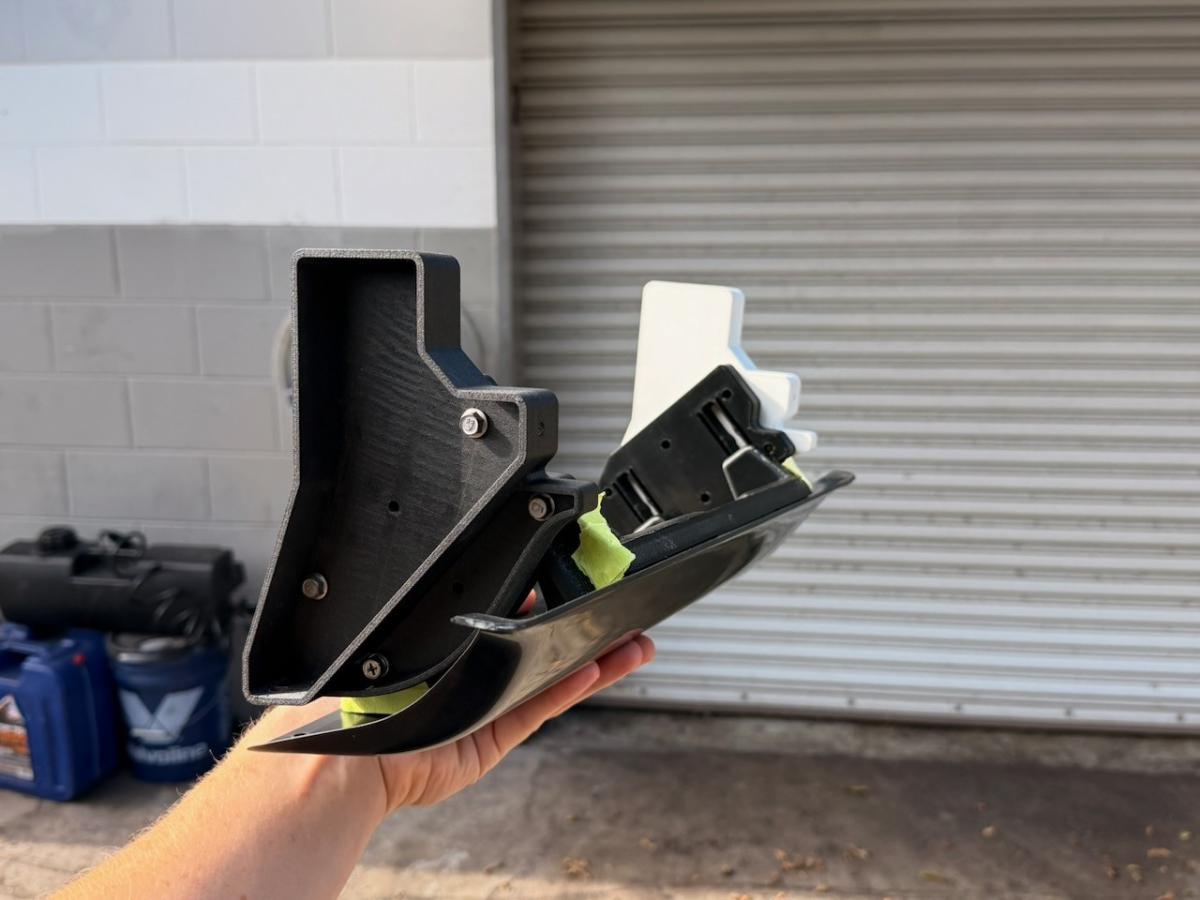

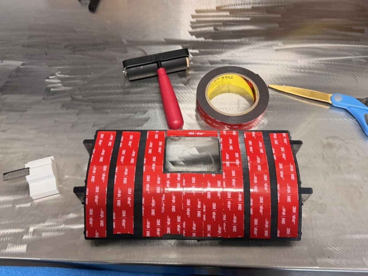

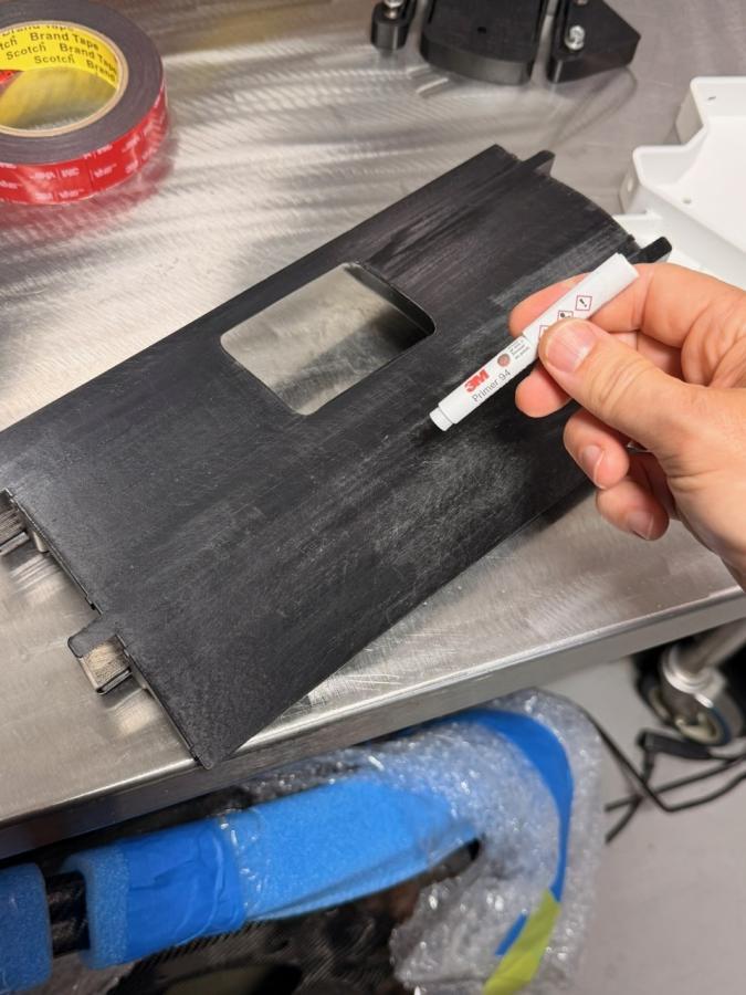

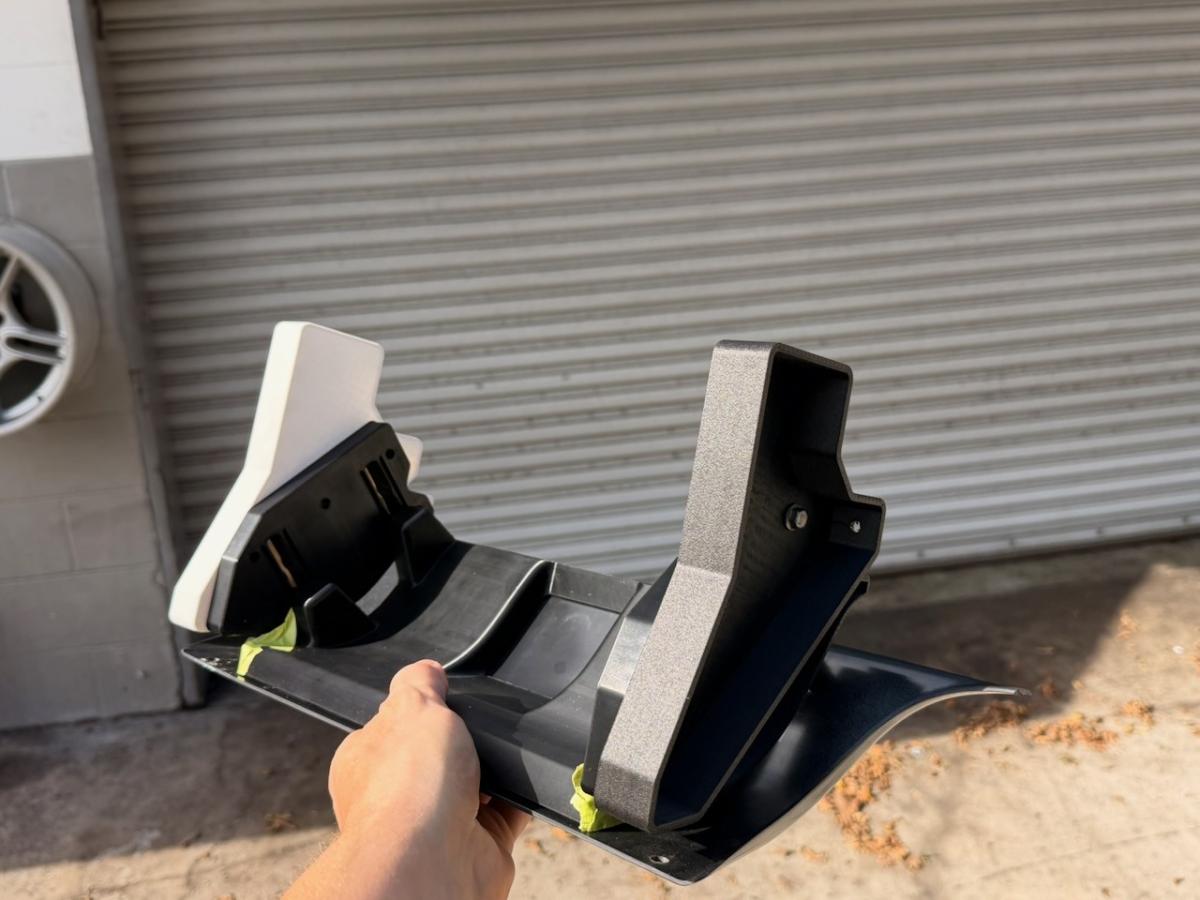

                Back to the hitch hatch, The main printed part got sanded, IPA wiped and bond prepped with 3M Primer 94 before adhering the 5952 VHB tape
                Click image for larger version  Name:	IMG_0258.jpg Views:	0 Size:	77.0 KB ID:	366243
                Click image for larger version  Name:	IMG_0260.jpg Views:	0 Size:	132.2 KB ID:	366244
                Then we bond the removed section of the quad tailpipe valance to the VHB by using positioning holes in the mounting brackets, carefully located to match the mounting holes in the valance. This also means that by putting BMW plastic clips into those holes, we can 'lock' the hitch hatch permanently closed, if that was ever useful.
                In any case, here's what it looks like bonded together and half-way installed into the mounting brackets, then final cleaned up, and in its horizontal resting position.​

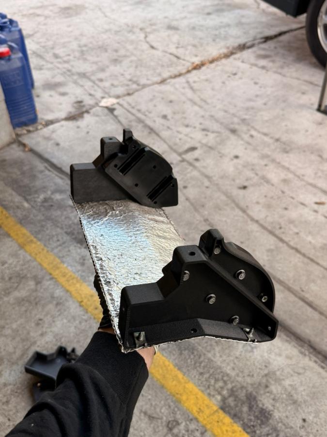

                I've also made a heat shield (made from the non-m muffler shield) to protect my hands from the hot center section of the muffler. This will all get permanently installed next time we drop the muffler to install the heat shield above it. Tomorrow we add reverse switch and GPS bypass wiring, then do some mocking up of the parts designed for bracing the exhaust to the gearbox. But at least it's drivable for short stints.

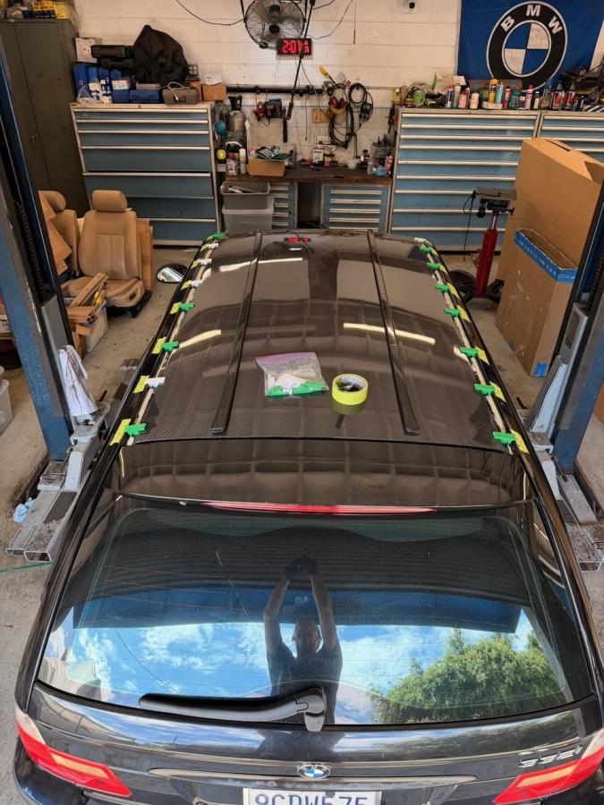

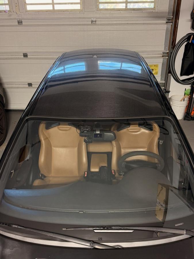

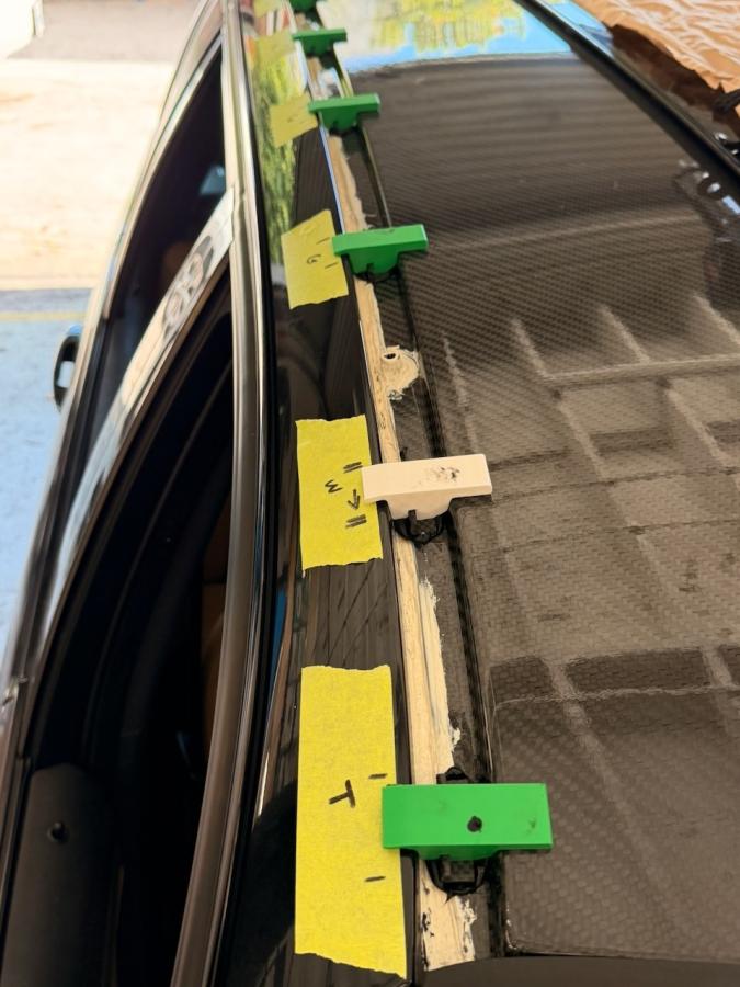

                    This afternoon was aesthetic things. First, bonding the roof rail clips to the roof with windshield urethane as the VHB did not do the trick
                    Click image for larger version  Name:	IMG_0282.jpg Views:	5 Size:	111.4 KB ID:	366447
                    Click image for larger version  Name:	IMG_0284.jpg Views:	6 Size:	76.7 KB ID:	366445
                    I had to do lots of urethane cleanup - don't use an electric gun if you're doing this at home - but otherwise the printed clip locators seemed to work pretty well. I'll snap the roof rails back on tomorrow.

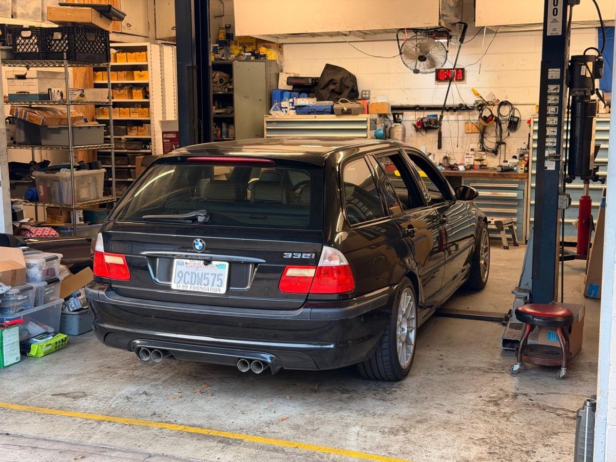

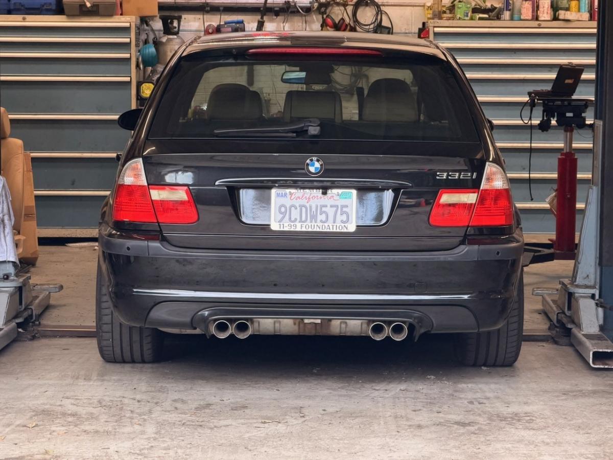

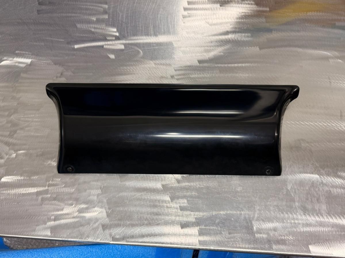

                    Then quickly mounted up the hitch hatch and got the bumper looking complete again - happy to see that the cut is invisible even when real close to the ground!​

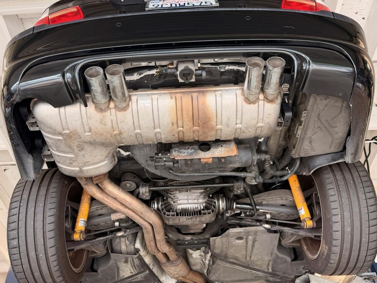

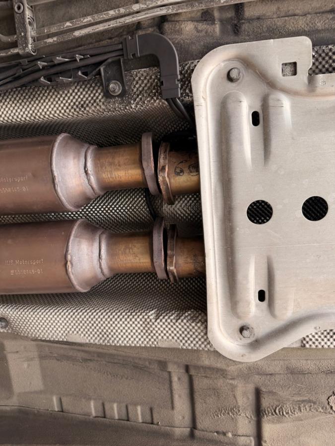

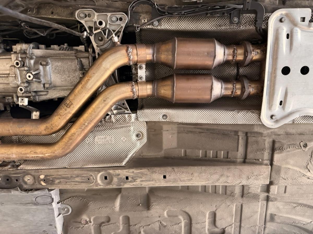

                        This evening I decided to do something about the super sprint pipes that I love to hate. They were off center by 1" and 3/4" and the faces were angled sufficiently far off that I had 3-4mm of free space when the flanges were touching at the opposing side. Once I wrenched them down, the pipes would get sucked down to the point that they nearly touched the cross brace/section 2 support and they nearly touched the side of the heat shield. Absolutely awful.
                        Before:
                        Click image for larger version  Name:	IMG_0296.jpg Views:	0 Size:	95.9 KB ID:	366622
                        4 Booger welds later:
                        Click image for larger version  Name:	IMG_0300.jpg Views:	0 Size:	181.6 KB ID:	366623
                        Glorious, fits just like it should now - 1/4"+ of clearance to the cross brace, centered in the tunnel and all fasteners just seat right into place. Man, I can't believe how badly these things fit for the price.
                        While the car was up, I swapped out the ABS-GF hatch supports with PA-CF that'll handle higher temps and trialed the metal heat shield. Well there's only 3/8" clearance to the back of the muffler, and the whole exhaust grows when it's hot so that's not gonna do. I'll have to take a crack at finding another 5/8" of space or so.
                        Click image for larger version  Name:	IMG_0303.jpg Views:	0 Size:	72.6 KB ID:	366620

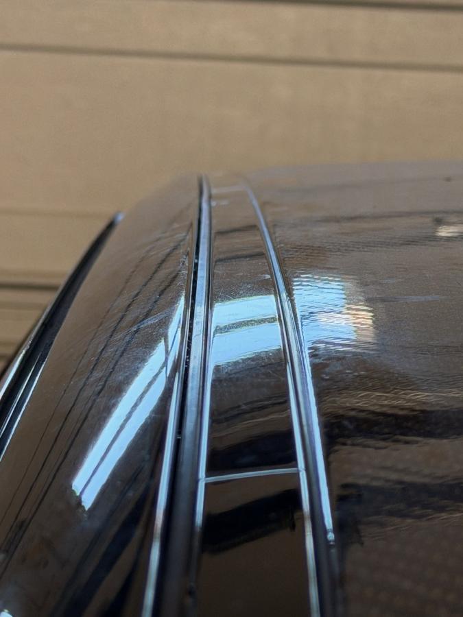

                        And last, the roof rail clip positioning prints worked quite well. I was off by 0.5mm though I can live with that, as it's biased in the direction that you can't see from the side of the car.
                        Click image for larger version  Name:	IMG_0294.jpg Views:	0 Size:	74.0 KB ID:	366621
                        Click image for larger version  Name:	IMG_0295.jpg Views:	0 Size:	57.0 KB ID:	366619
                          About the SS exhaust parts that are not fitting for you i think maybe they got damaged in shipping? Did you ever contact SS or their US importer to claim warranty?
                            They were definitely not damaged in shipping, just manufactured poorly
                              It’s perfect.
                                No warranty coverage?
