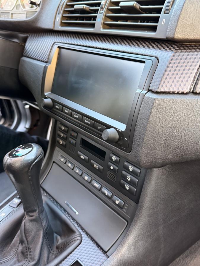

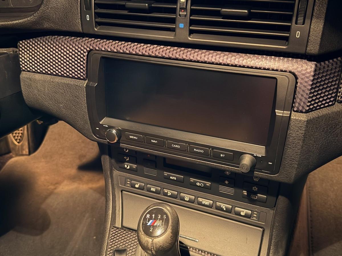

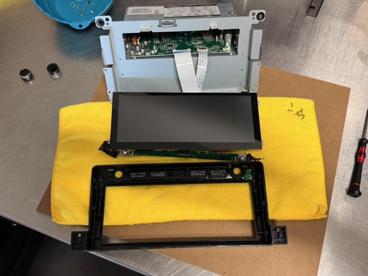

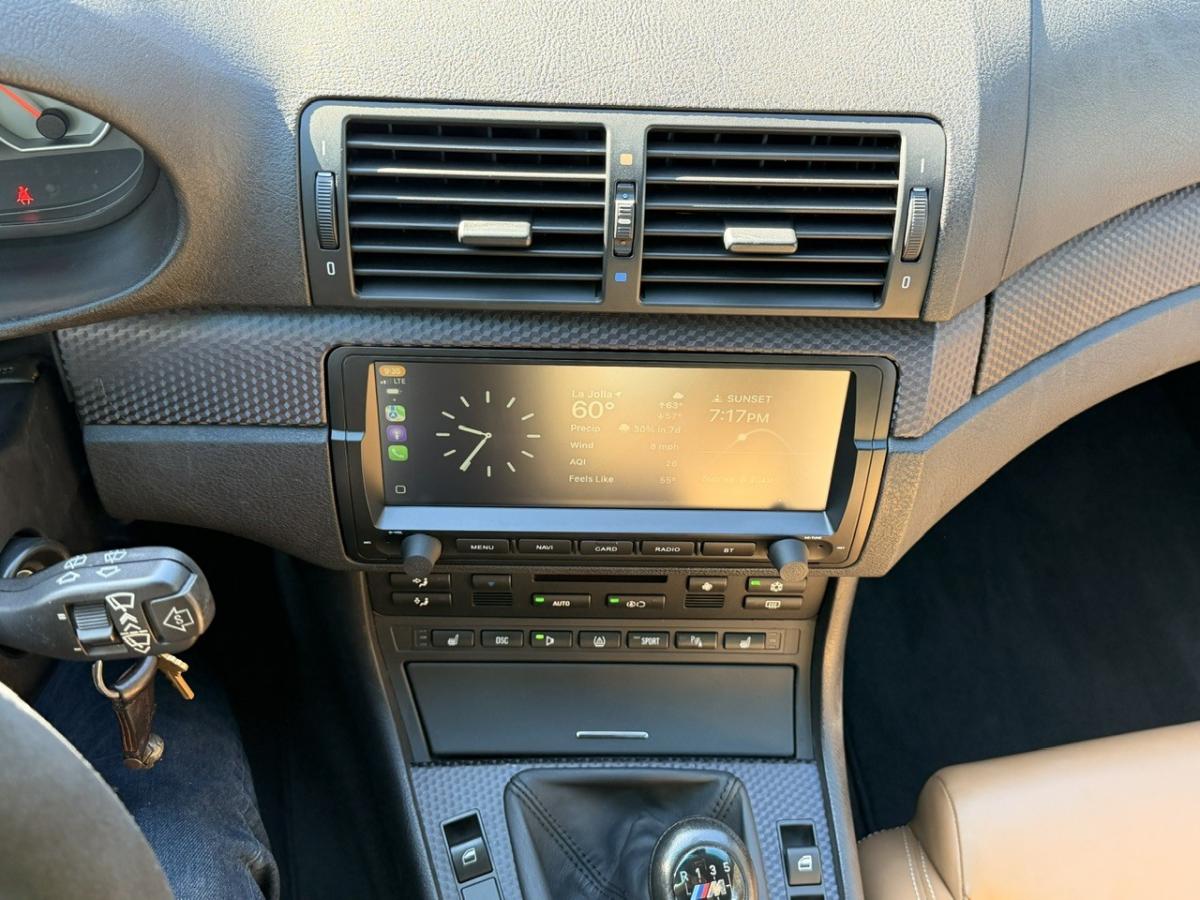

    Borrowing from karter16's method, I decided to re-do the screen protector on my XTRONS head unit so that it's continuous and the seam hidden under the bezel. I managed to do it without braking any of the electrical connectors which were potted into place.

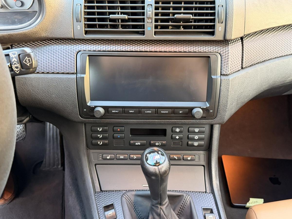

    Here's how it started:
    Click image for larger version  Name:	IMG_8367.jpg Views:	3 Size:	119.5 KB ID:	351463

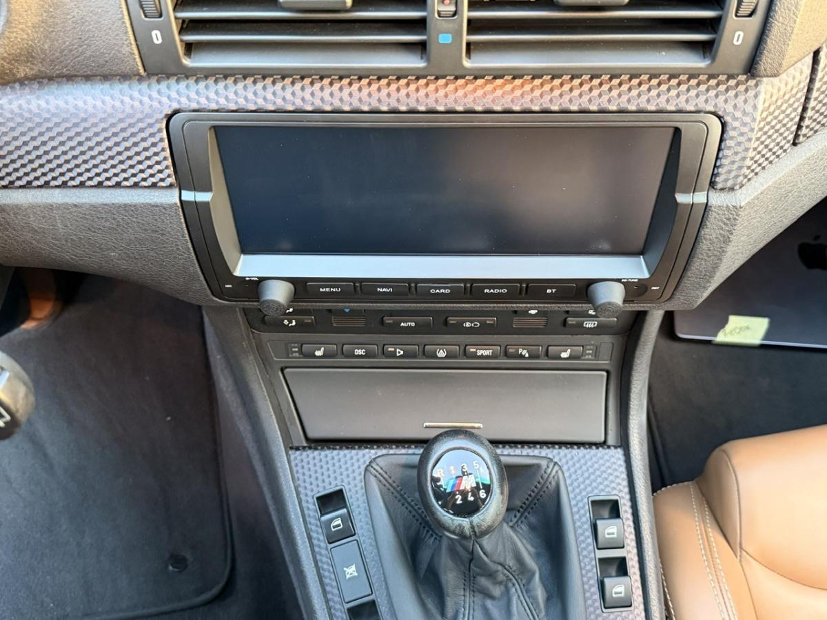

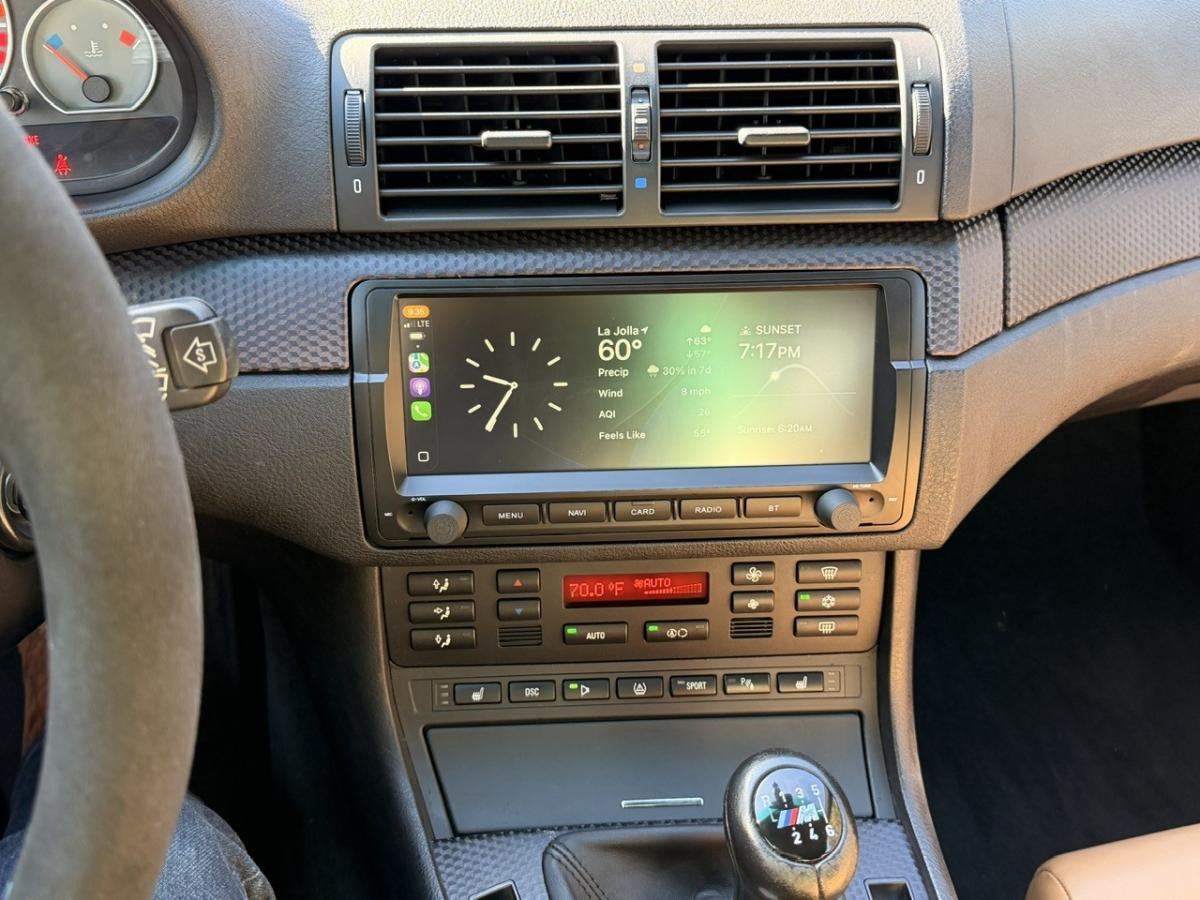

    And the closest thing I got to a finished photo:
    Click image for larger version  Name:	IMG_8368.jpg Views:	3 Size:	73.9 KB ID:	351464

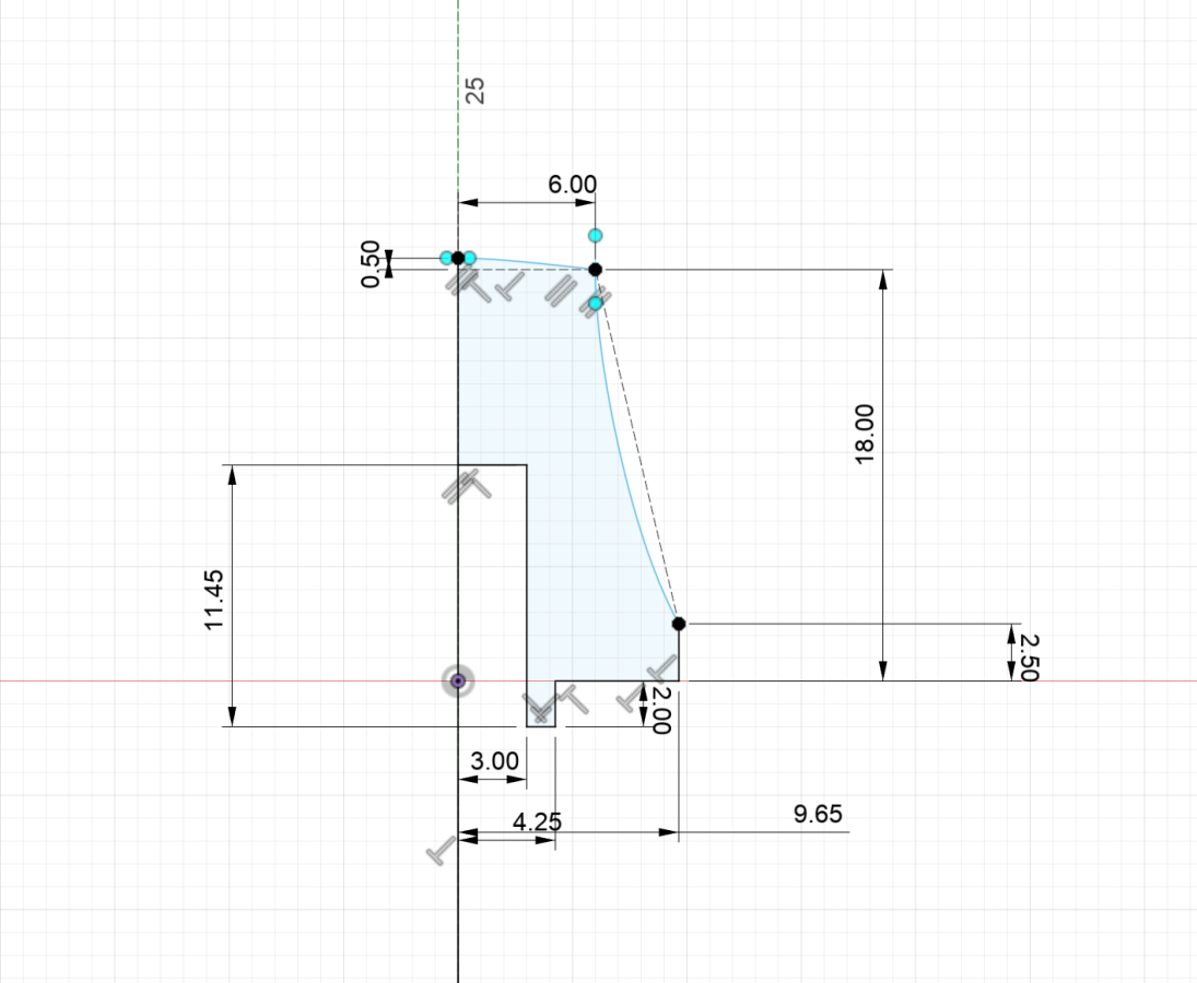

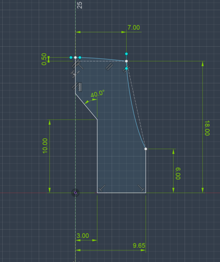

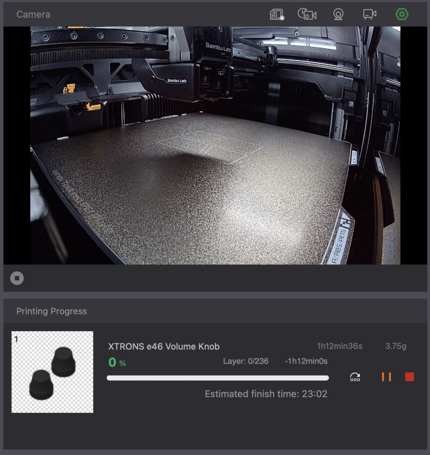

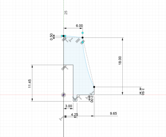

    After that, I decided that I hate these chrome knobs enough to finally eliminate them. The plan is to 3D print (first one will be done in 45 mins) some knobs similar to the CD53 and factory nav head units. If I like this geometry, then I'll break this into two parts: A plastic inner structure and an SLA elastomer/resin or an SLS TPU grippy surface. This is probably the easiest way for me to mimic the stock knobs with a fun little project that also means trying out a new print process.
    Click image for larger version  Name:	Screenshot 2026-04-12 at 7.04.26 PM.png Views:	3 Size:	102.3 KB ID:	351462 Click image for larger version  Name:	Screenshot 2026-04-12 at 8.08.43 PM.png Views:	3 Size:	436.3 KB ID:	351465

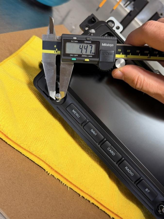

        Alright not super happy with v1, it's a little long and it repeats a problem that XTRONS themselves designed in where the button underlaps the fascia at the bottom:

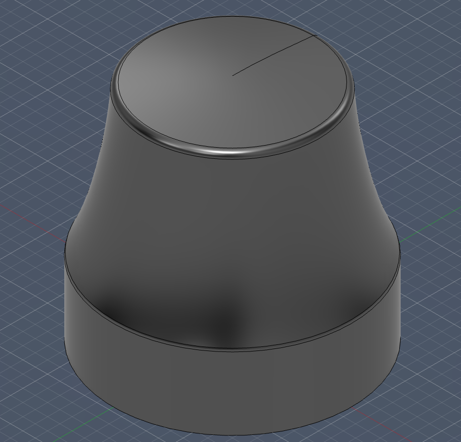

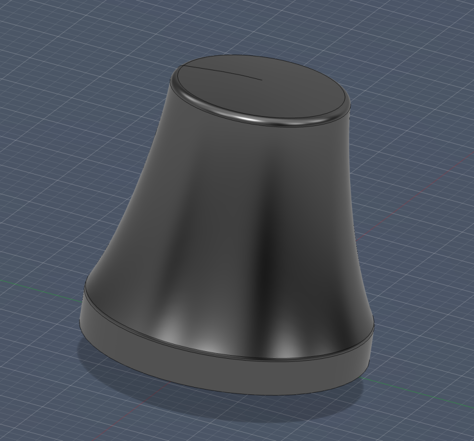

        v2 in the printer now, the button itself is 3.5mm shorter and 1mm larger OD at the tip transition. Also easier to print as a bonus:

          V2 is looking much better

            Alright I’m happy with V3. Just 1mm shorter than V2 and feels right. Time to figure out SLA printing​

              that looks really good! great job!
                Wow, I'm surprised at how different V3 looks to V2 after such a small change. Agreed that V3 is the way to go.

                  Farm out is the plan. Looks like they're about $30 a piece or so. Am I crazy for considering just printing the whole thing in 60A rubber-like-resin?
                    Just don't park the car in the sun! lol
                      Oof, thanks for sparing me the pain of that mistake. Now I'm trying to convince myself that this ABS plastic is good enough

                        Those look great
                          Single data point, but my phone holder is printed in ABS and has seen many, many hours of direct sun. No warping or deformation that I can see.
