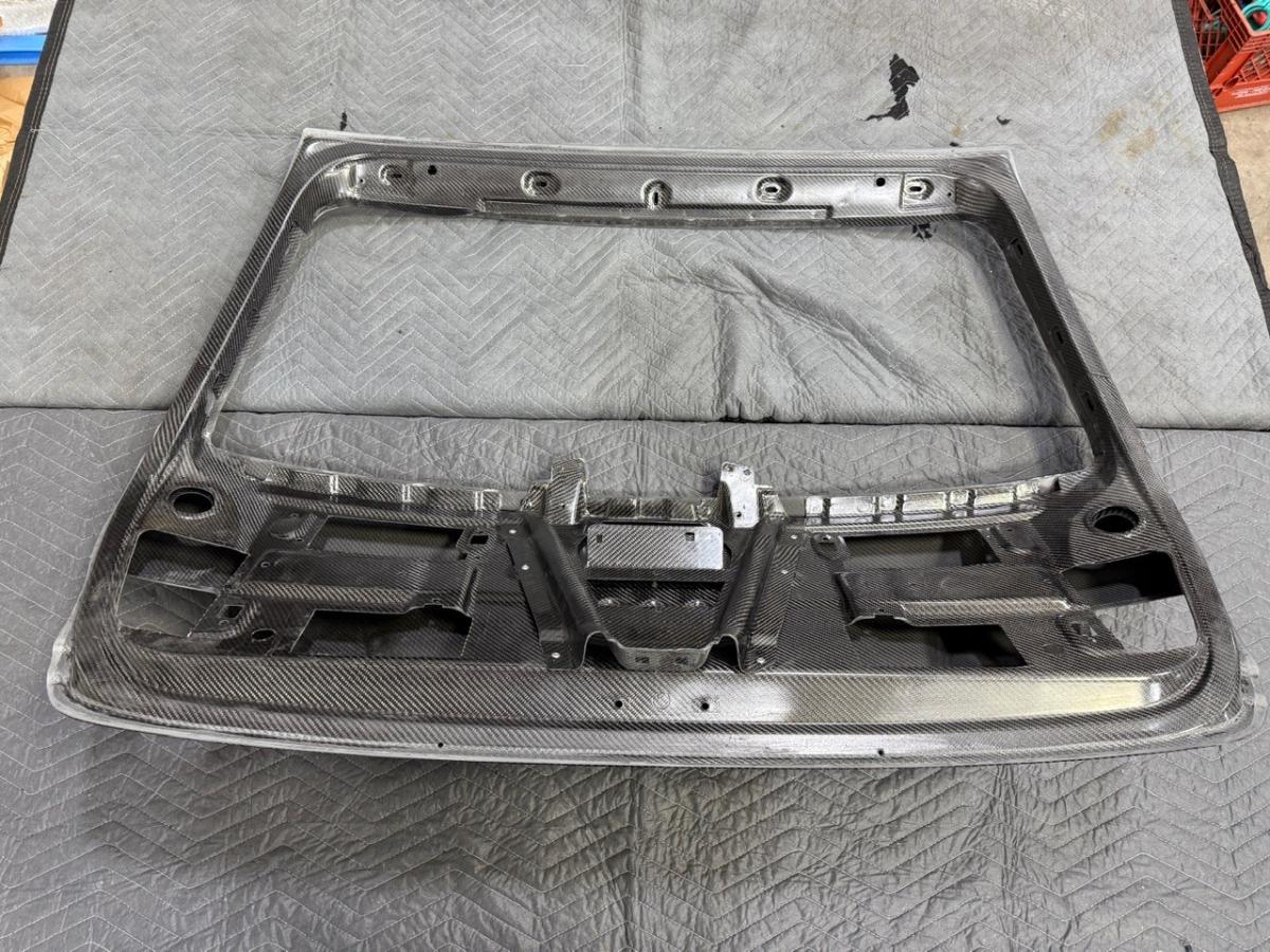

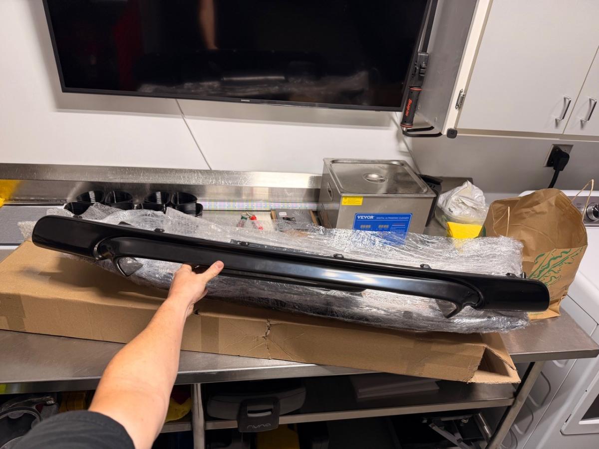

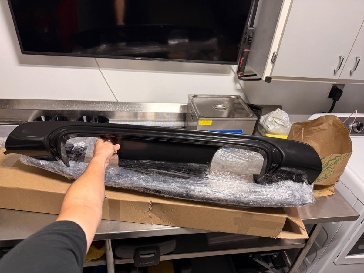

        Well, I guess we’re getting to the body work portion of this build finally.
        These ZHP bumper inserts for the M3 muffler arrived from Ukraine:​

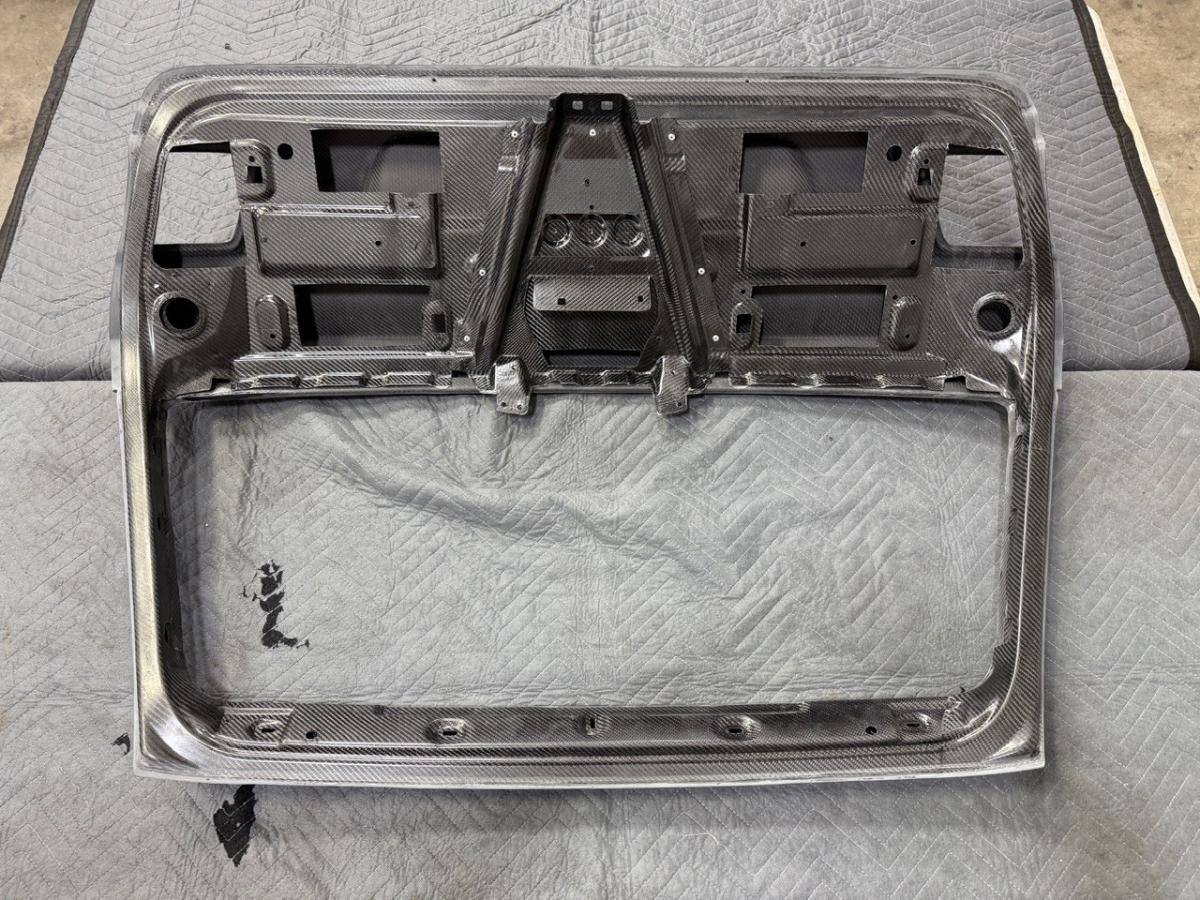

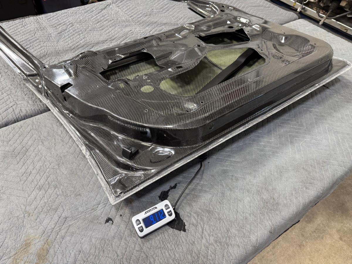

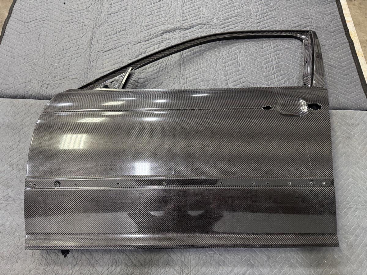

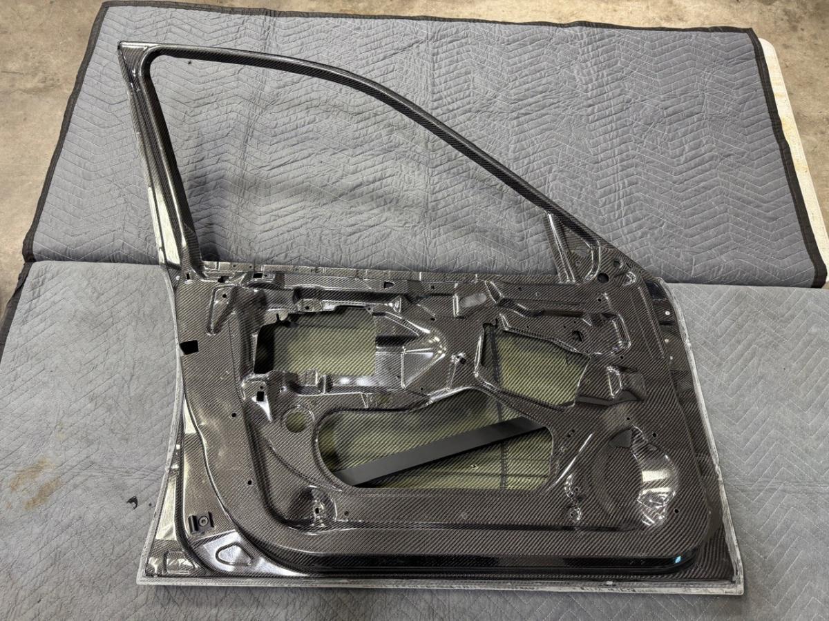

        And these arrived (and are waiting at George’s shop, along with my carbon roof. Thanks George) also from Eastern Europe:

        All told that’s 110lb weight savings​ and 6% body roll reduction.

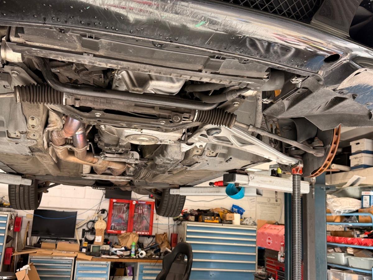

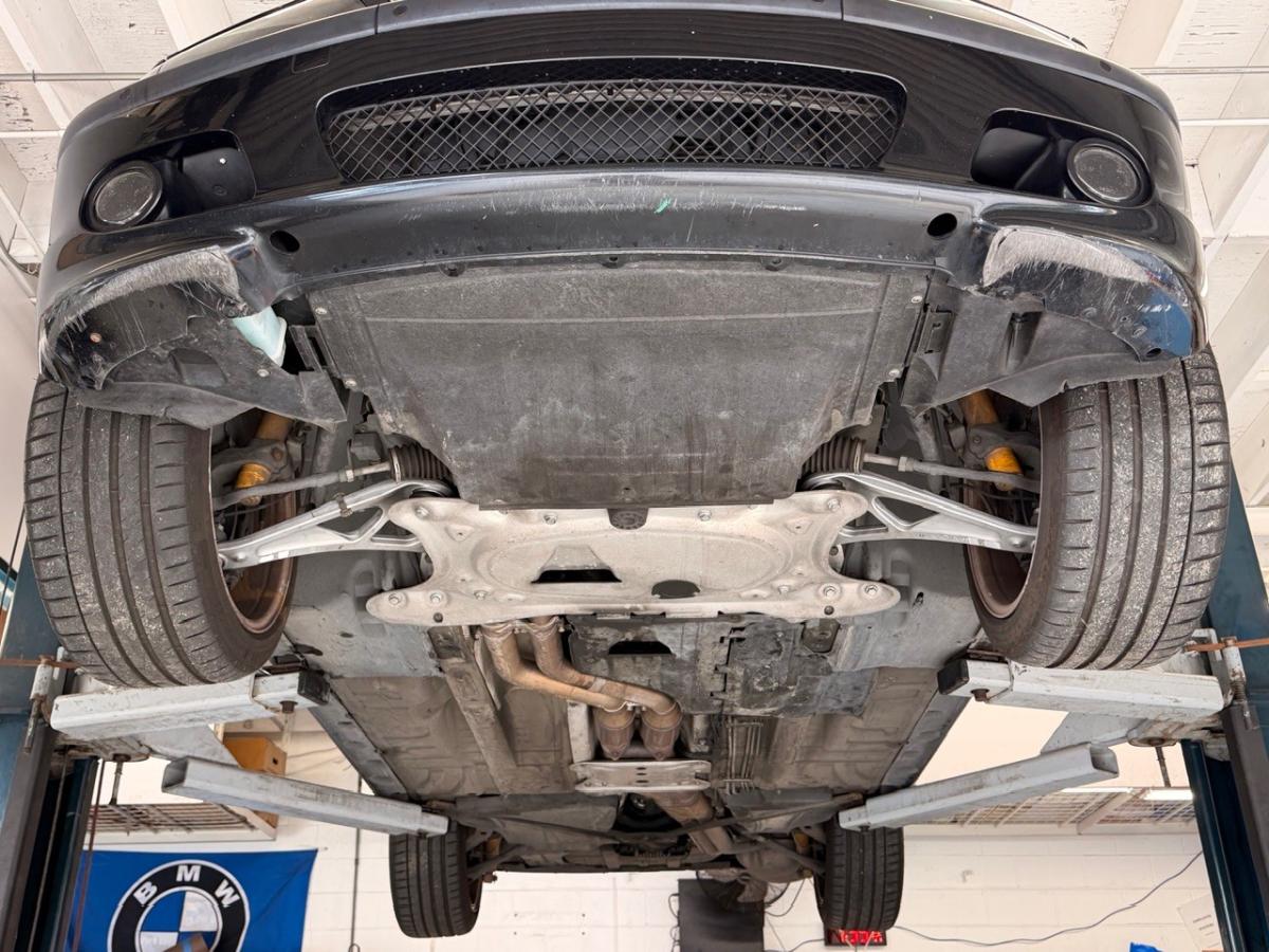

            Got the car up on the lift today to do control arms and bushings. These things are getting expensive at almost $900! This set appears to have lasted 200k miles and was juuust developing a little outer ball joint play. Since the rest of the car is dialed in, you could feel this in the wheel and it needed fixing. Decided not to wait for the super knuckle to be finished.

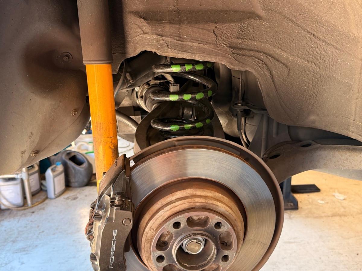

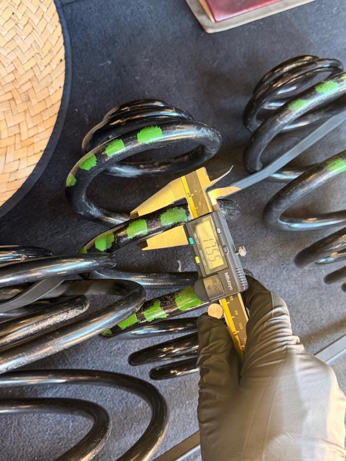

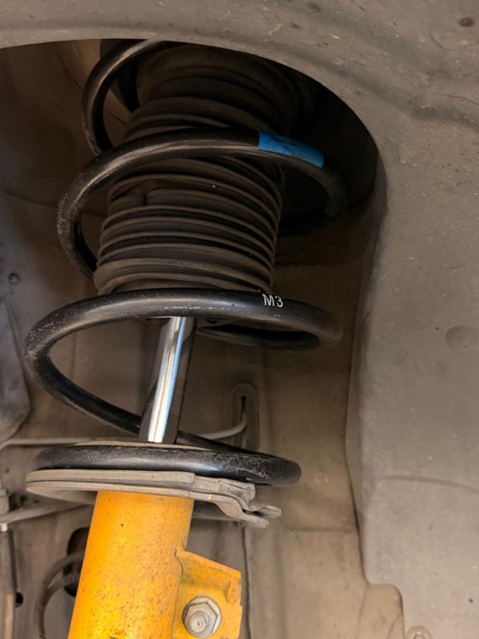

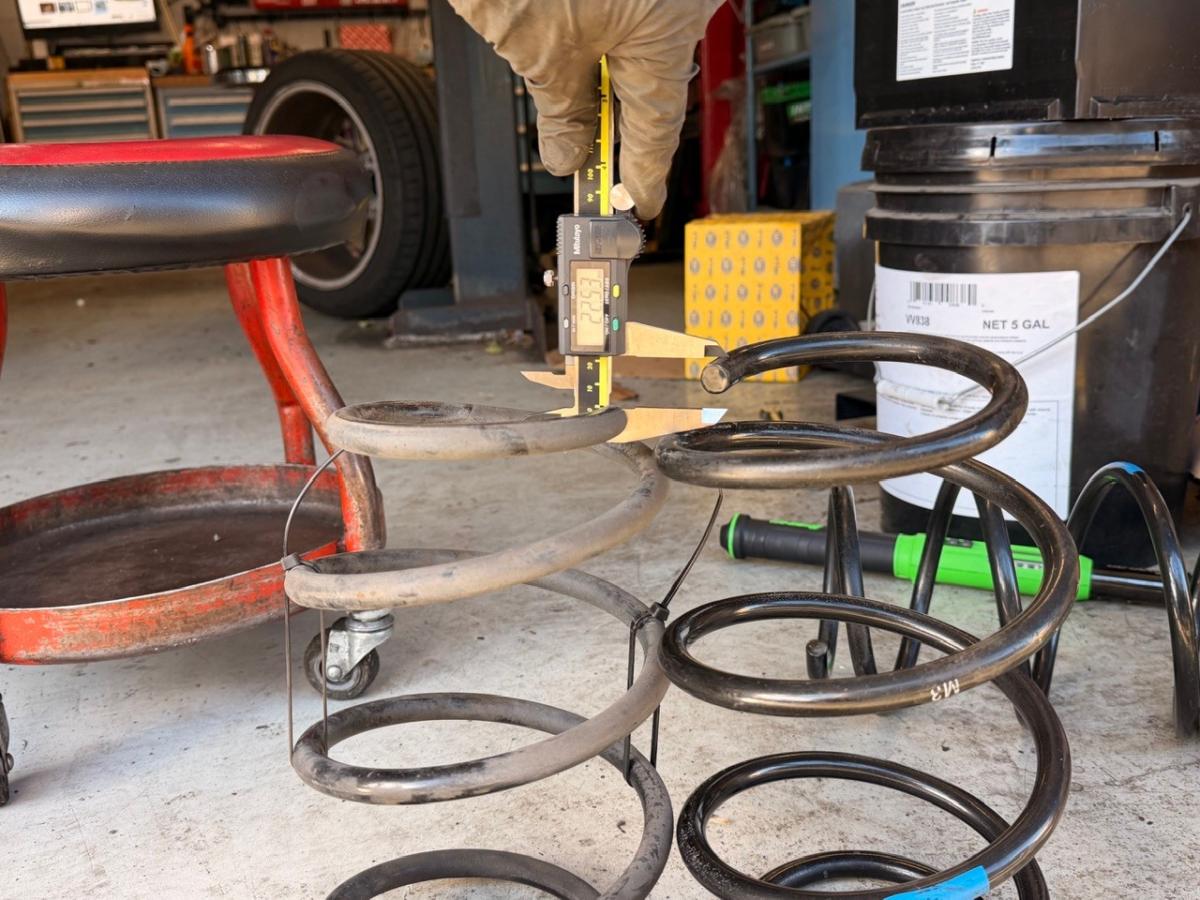

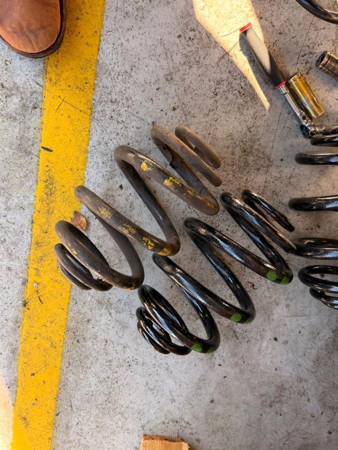

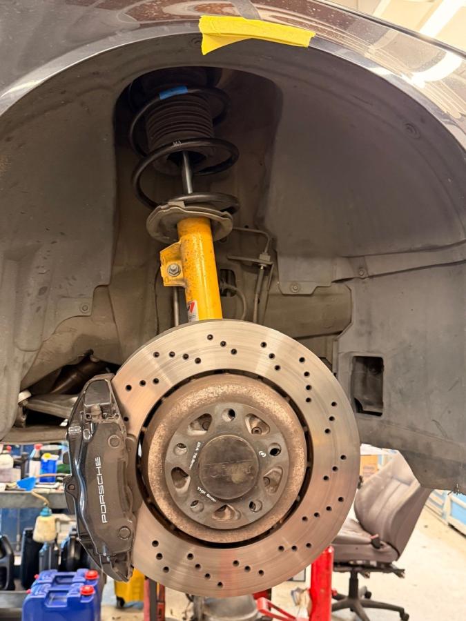

                            In the meantime, the car has been absolutely fantastic, suspension and is super quick and tight. A few years back I removed aftermarket springs to put on Heinz’s original M3 springs from his early model car (thanks man!) but they were pretty rusty in the rear and I’d always heard that late models sat higher. Since I like me some ground clearance, I installed 6mm front spacers to raise the height with the stock early M3 springs.
                            So today I replaced those springs with a set of late model ones from a ZCP car. Early springs have 1/4 yellow stripes F/R and late model springs have 1 blue front and 4 green rear. Caliper measurements had them within .5mm diameter of each other (honestly within margin of error and powdercoat thickness) and the same coil count. So on first blush it looks like the springs are the same rate. The front springs free length are about 20mm taller on the late model, and I forgot to measure the rears.
                            Because they measured taller, I took a chance by removing my 6mm spring spacers. After removing the spacers and installing the late model springs, I’m measuring 2mm higher in front and 9mm higher in rear. From this I can conclude that at least in this instance, the late model springs are 8mm taller in front and 9mm taller in rear. Glad to have swapped them out!​

                              Agreed the late model cars got higher— but didn’t the specific springs vary by car spec?
                                Allegedly, although I’ve only been able to find two different colors in my Internet sleuthing - convertible v coupe.
