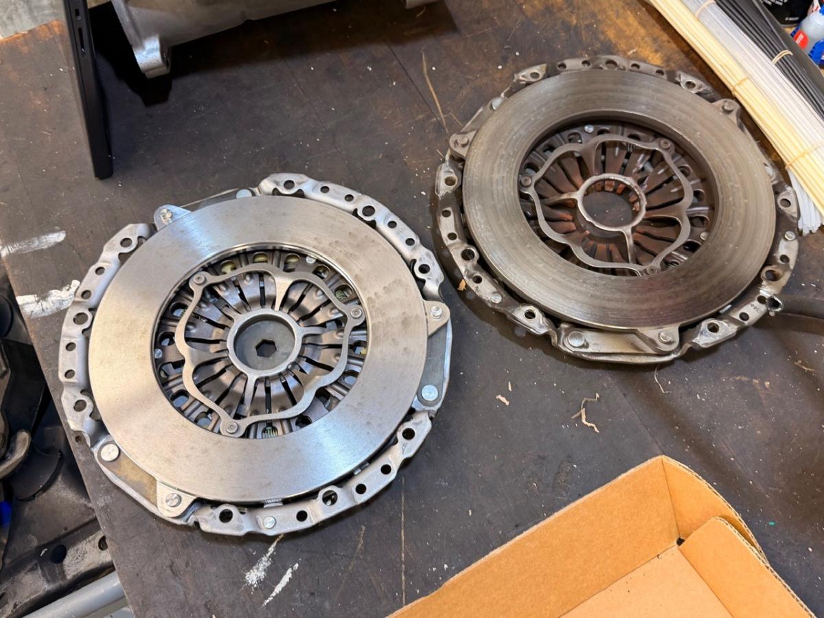

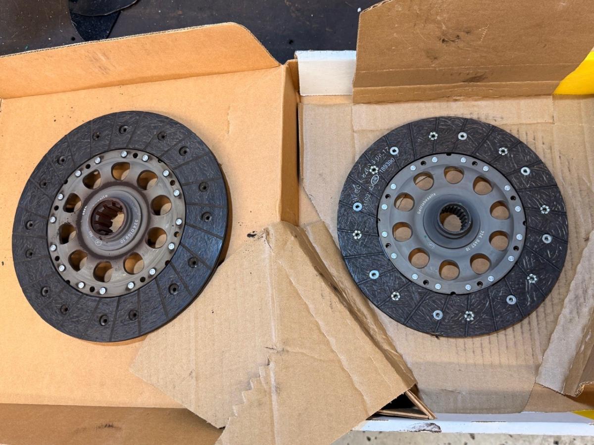

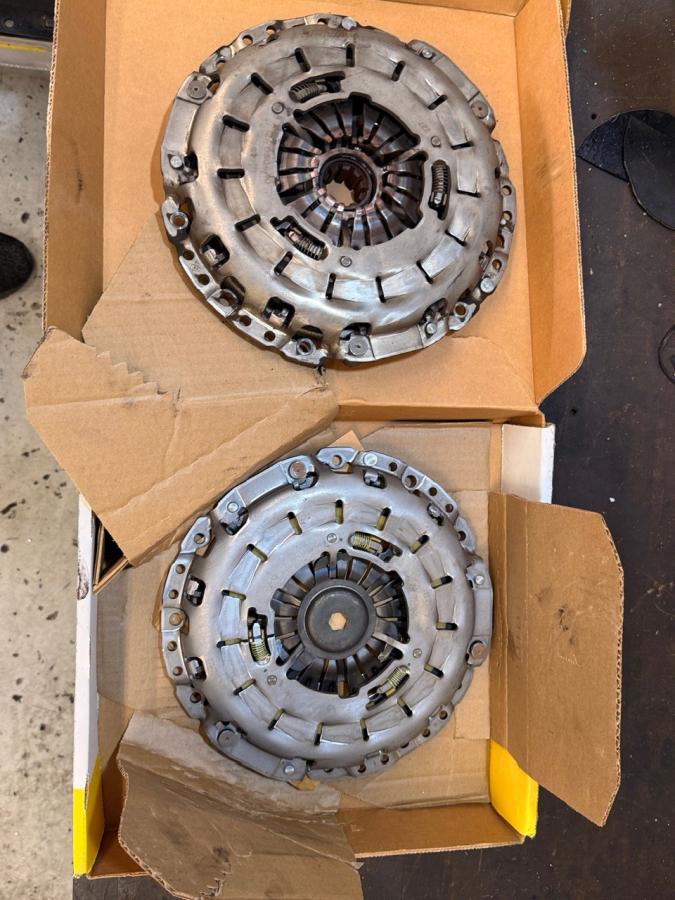

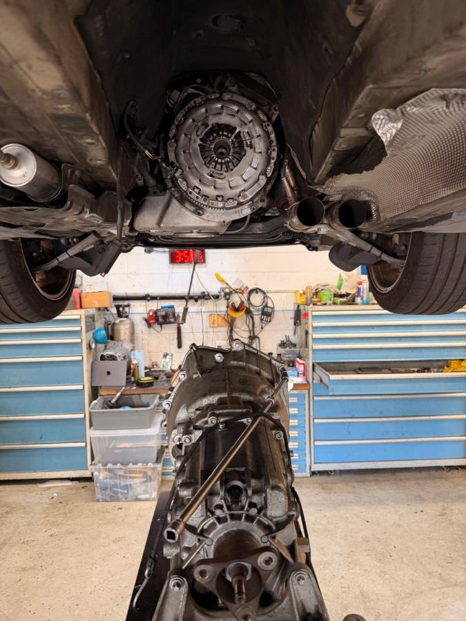

          Okay, yesterday the clutch arrived. The Z4M and e46 M3 pressure plates are laser engraved with the same part number (and the slave cylinders are the same PN). This confirms that the clutch force should be the same between the two. The disc is of course a different part number due to spline count, but @George Hill will be comparing the disc PN with the 330i clutch to see if it’s the same. If so, this makes a strong argument for the 330i flywheel/clutch/gearbox combo working just fine behind the s54.​
          Click image for larger version  Name:	IMG_0118.jpg Views:	0 Size:	101.1 KB ID:	365690
          Click image for larger version  Name:	IMG_0121.jpg Views:	0 Size:	158.1 KB ID:	365693
          Click image for larger version  Name:	IMG_0122.jpg Views:	0 Size:	160.0 KB ID:	365695

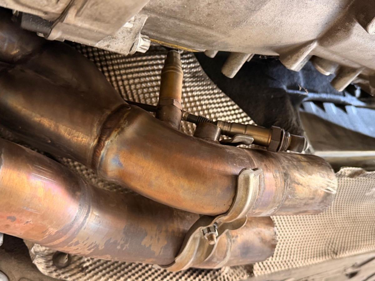

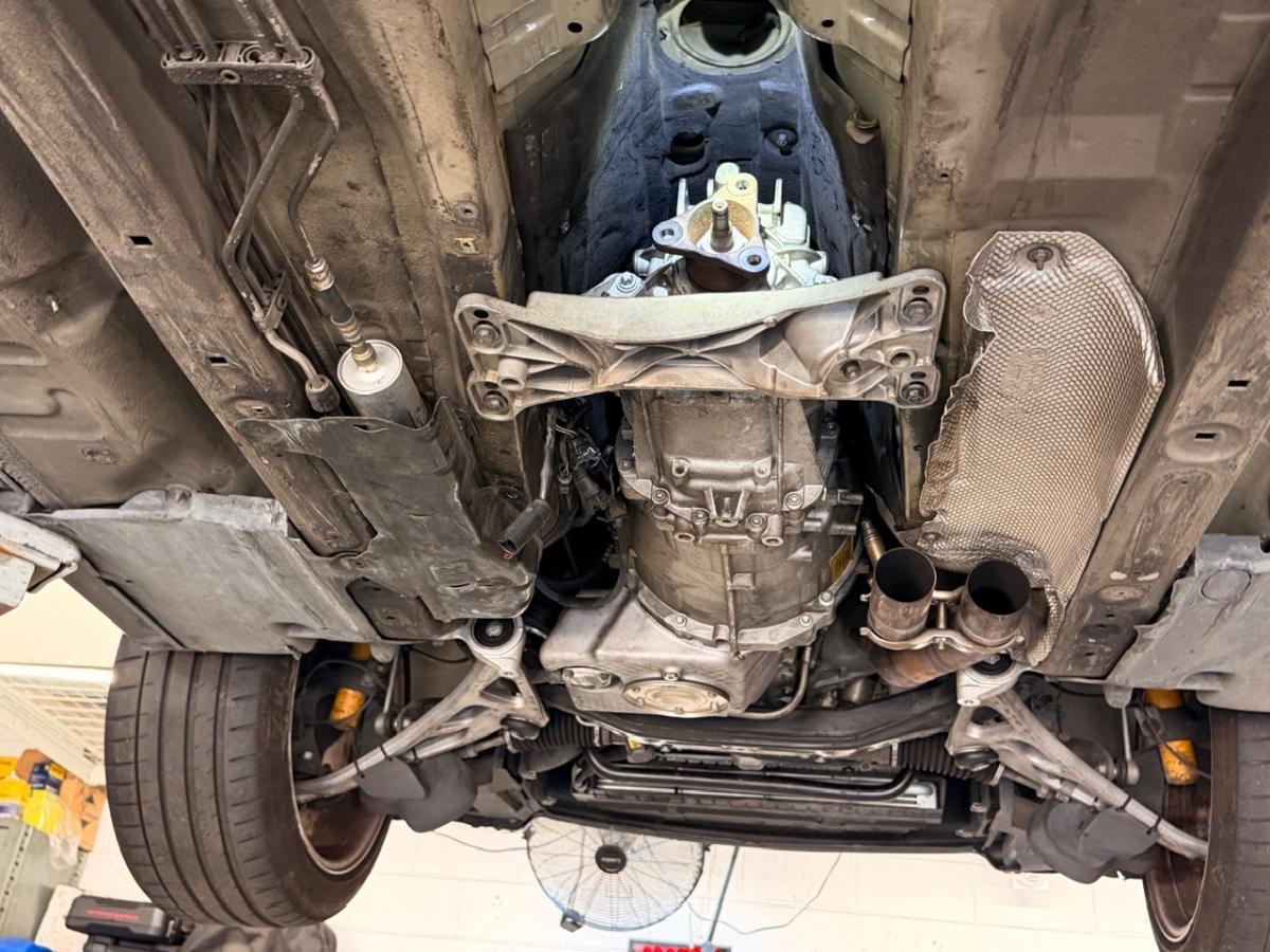

          Gearbox went in just fine after moving my wideband O2 sensor to the other bank. An O2 sensor in this bung will foul on a mounting boss on the bell housing. For install, I ended up reusing my M3 transmission mounts as they felt considerably firmer than the Z4M/330i new and used parts. The M3 ones fit without modification, just have a longer stud on top.

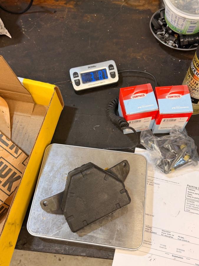

          Here is the sum total of weight saved from the transmission swap - the mass damper on the back of the getrag - 3.5lb​

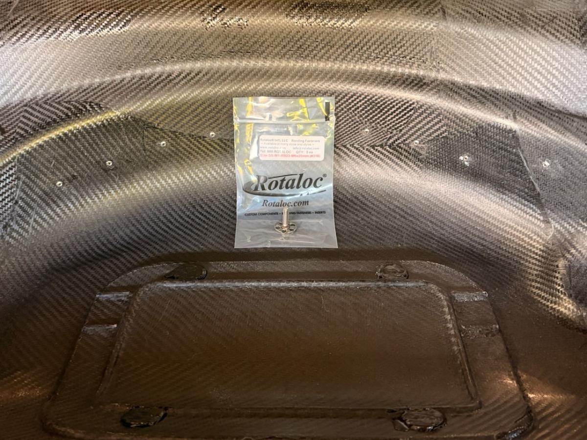

          I’ve been doing more homework on windshield urethane for bonding carbon as well - do not do this! The urethane is typically made black with carbon, which is conductive. Because carbon fiber is higher on the nobility scale than mild steel, the windshield urethane can electrically connect them and cause galvanic corrosion between the carbon and steel in wet, humid, moist or salty environments. The result will be the chassis steel being slowly eaten away over time. So for the trunk floor I’ll be using more white 2K urethane that we used on the roof, along with paint over the steel, and using sealed stainless rivets. Stainless is in between mild steel and carbon on the nobility scale, so I figure this is a good compromise. We did the same for the two rivets we used on the roof. Word to the wise!​

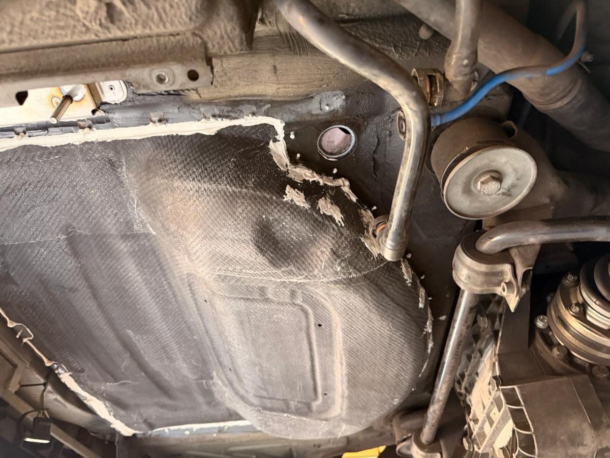

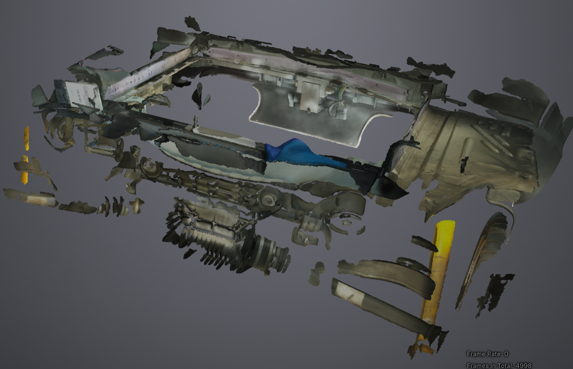

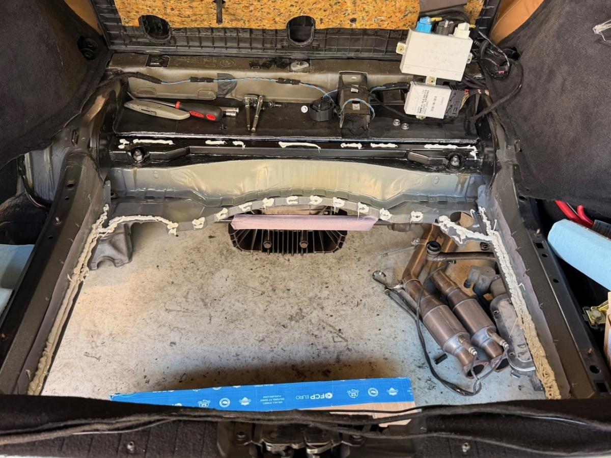

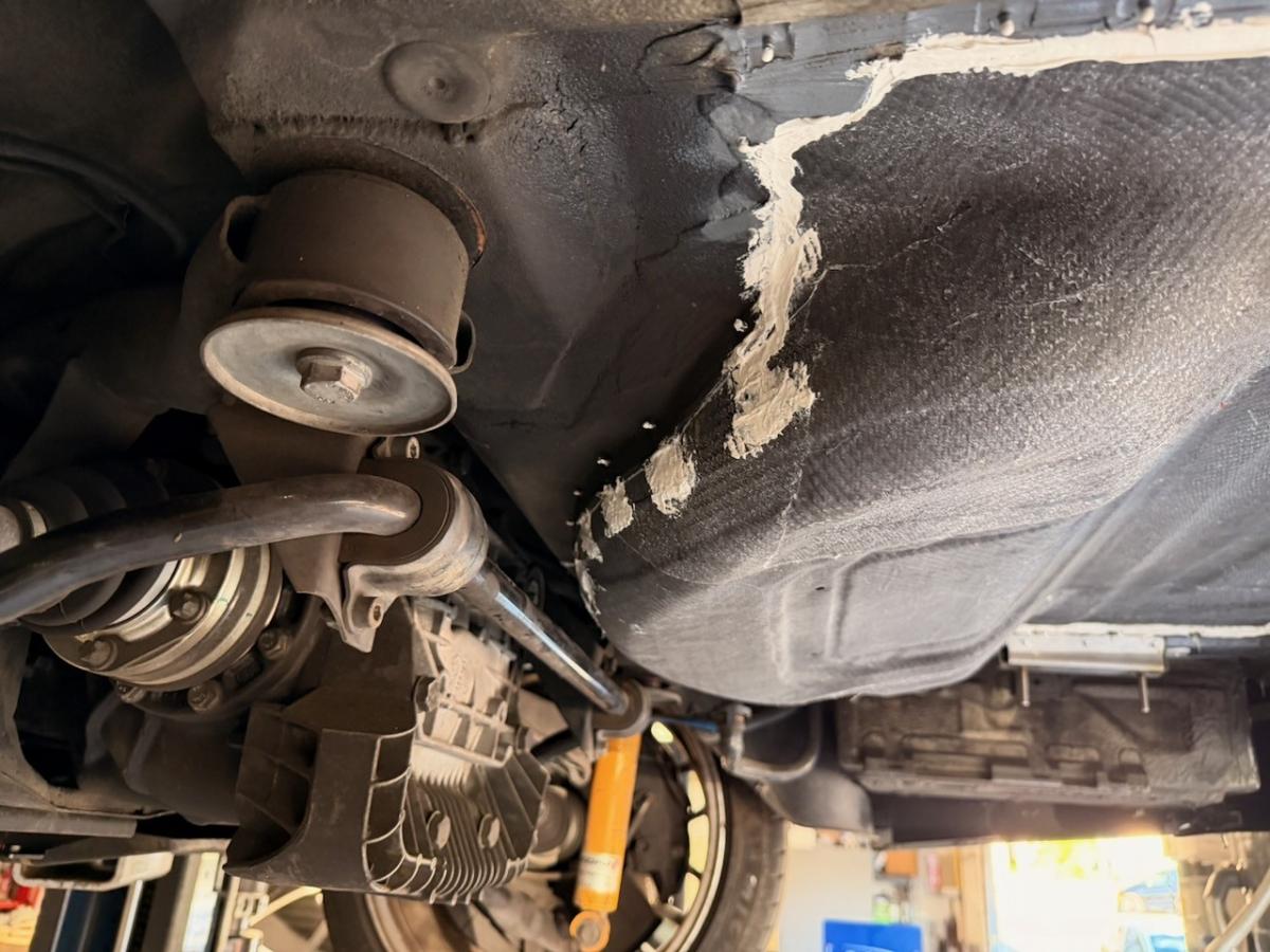

            Alright, here we go! First off, let's start with a scan of the area while we have good access, as I'm going to need to design a bracket to support the center section of the valance, and also a method for easily popping off the center to get access to the trailer hitch, which I am most certainly keeping.

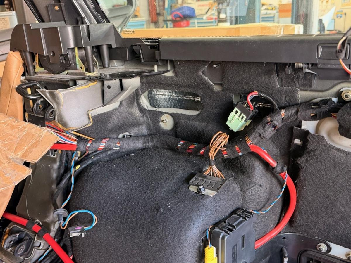

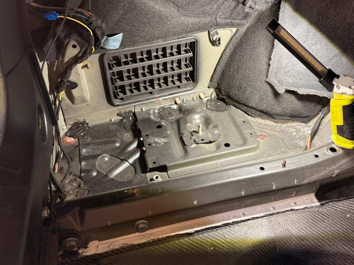

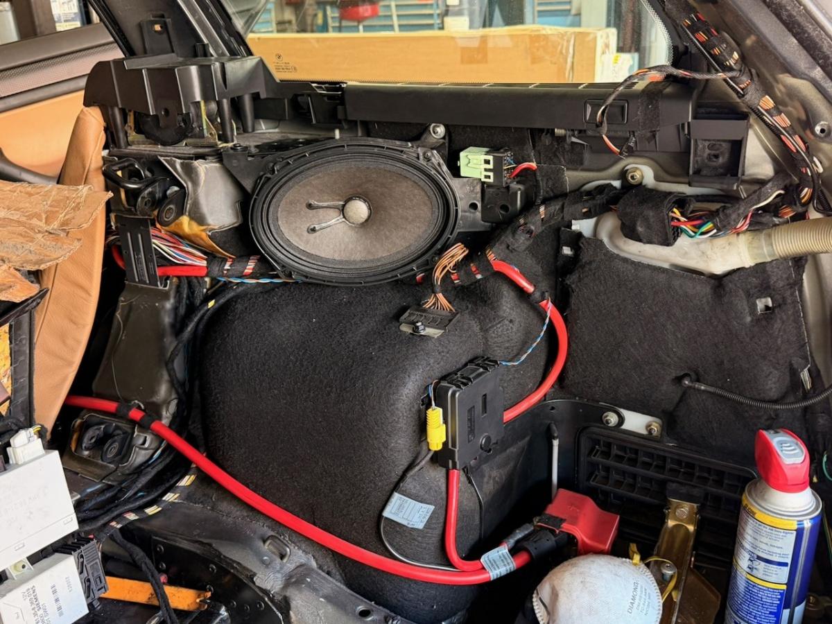

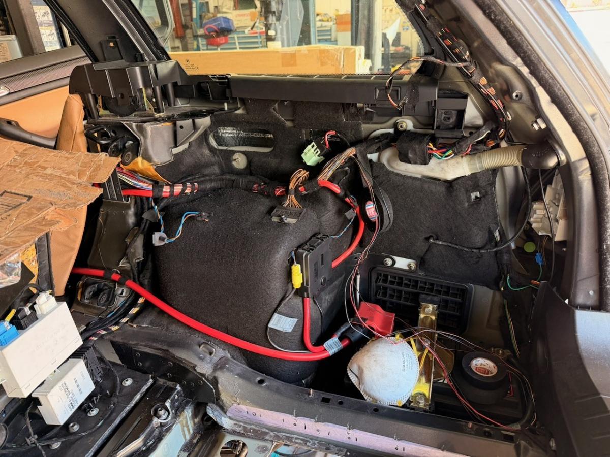

            Then we get to pulling that evap wiring back through the loom so we can run it through the trunk floor like the M3. Always an absolute sticky mess.
            Click image for larger version  Name:	IMG_0132.jpg Views:	0 Size:	186.0 KB ID:	365753

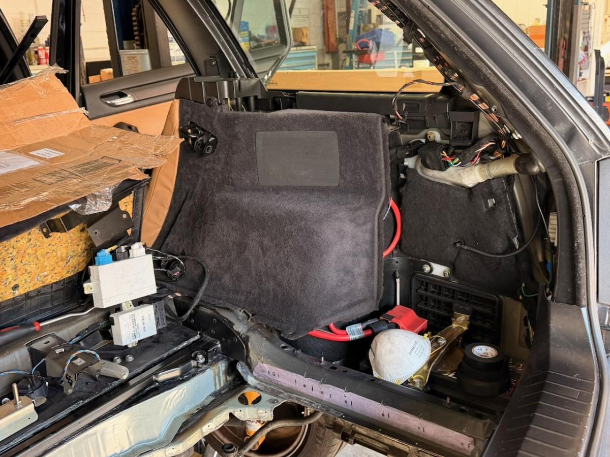

            Tidying it back up
            Click image for larger version  Name:	IMG_0135.jpg Views:	0 Size:	190.5 KB ID:	365750
            Click image for larger version  Name:	IMG_0136.jpg Views:	0 Size:	182.0 KB ID:	365747
            Click image for larger version  Name:	IMG_0137.jpg Views:	0 Size:	183.1 KB ID:	365751

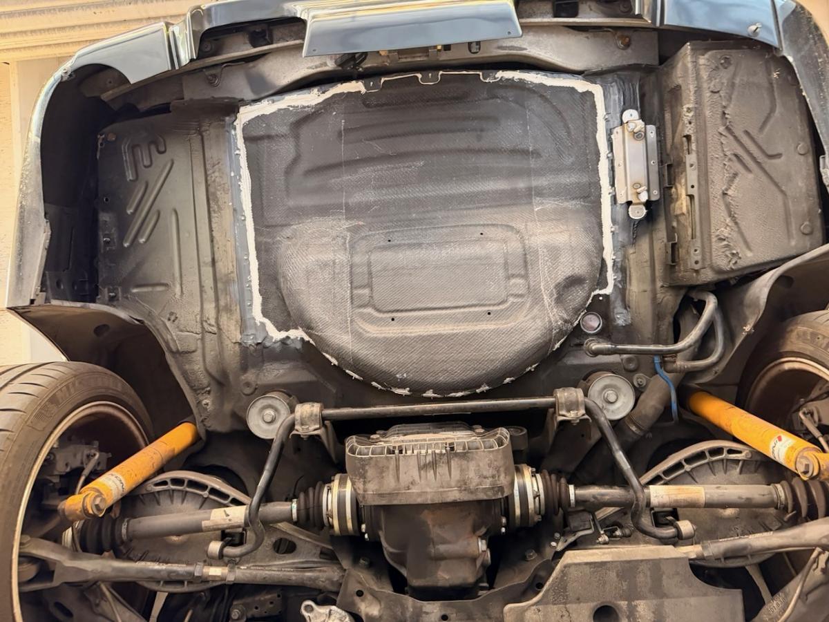

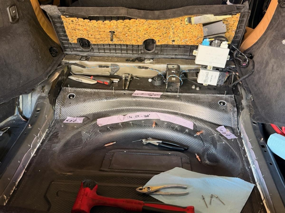

            Now let's slap some paint on all that bare metal. Of course I got overspray on the valance where the tailpipes exit in the process.
            Click image for larger version  Name:	IMG_0138.jpg Views:	0 Size:	139.5 KB ID:	365740

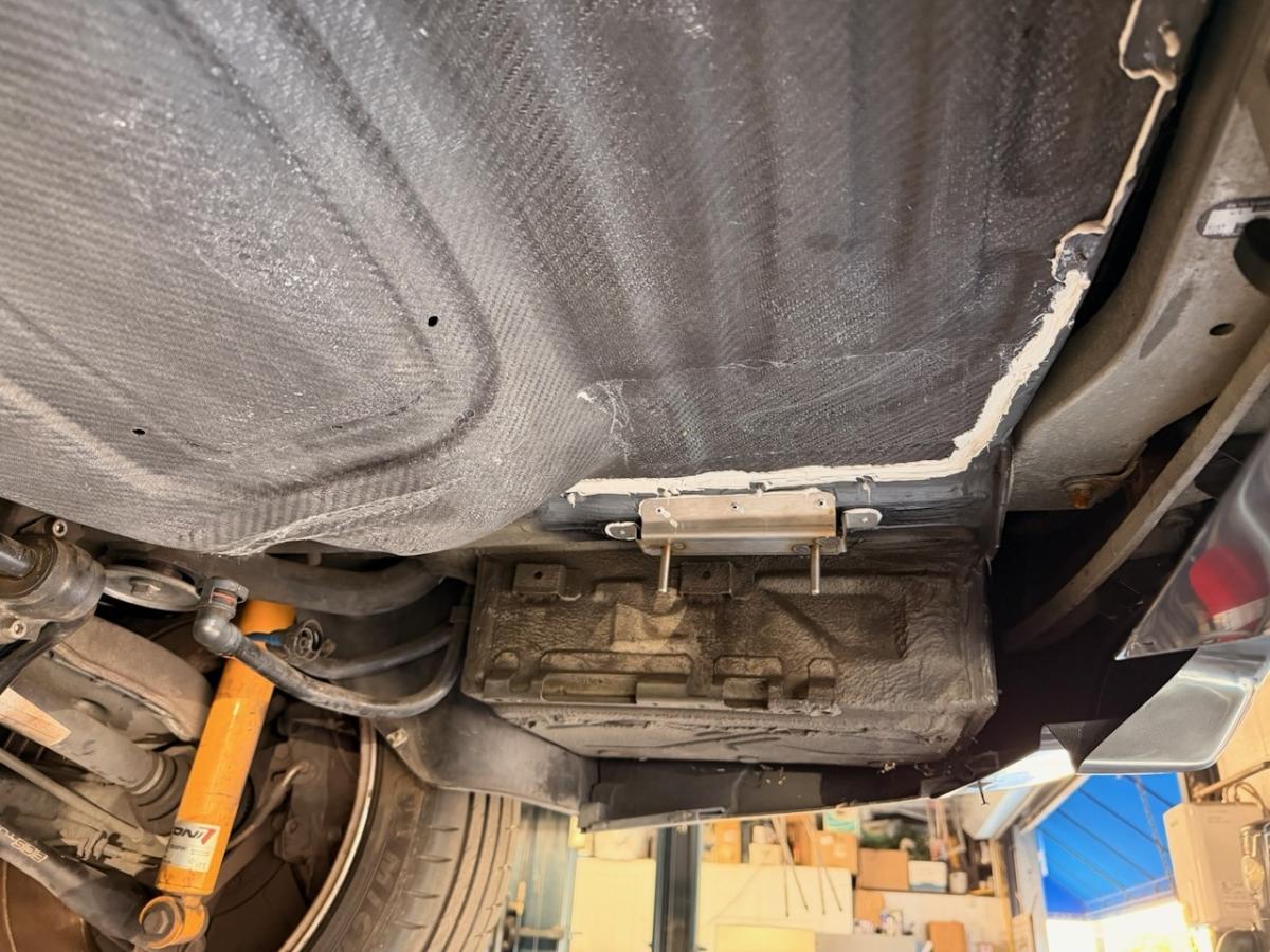

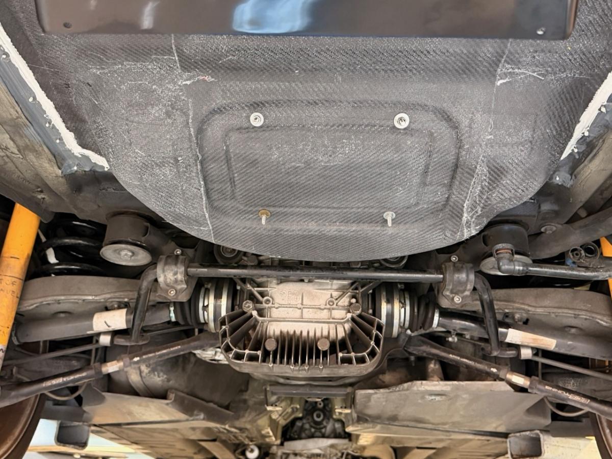

            Then let's start the bond+rivet process with a copious application of 2K (non-conductive) urethane and a couple different grips of stainless sealed rivets. Not pictured is me welding bolts to the inside of the passenger side muffler bracket, both things are stainless. It was about this time that I realized the donor for the trunk mold had a good sized dent in it -_- far too late to change course and we'll just have to see how we get along with the evap canister.​
            Click image for larger version  Name:	IMG_0146.jpg Views:	0 Size:	172.2 KB ID:	365744
            Click image for larger version  Name:	IMG_0147.jpg Views:	0 Size:	174.3 KB ID:	365748
            Click image for larger version  Name:	IMG_0148.jpg Views:	0 Size:	168.2 KB ID:	365742
            Click image for larger version  Name:	IMG_0151.jpg Views:	0 Size:	164.2 KB ID:	365754
            Click image for larger version  Name:	IMG_0152.jpg Views:	0 Size:	140.8 KB ID:	365745
            Click image for larger version  Name:	IMG_0153.jpg Views:	0 Size:	155.9 KB ID:	365743

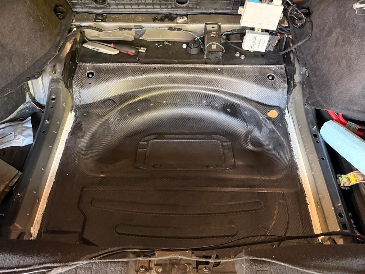

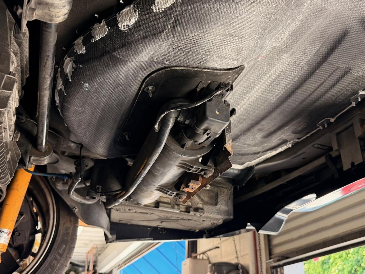

            And since we can't use the metal stud mounts for the evap canister with this trunk floor, let's bond some fancy studs in using 2 part epoxy
            Click image for larger version  Name:	IMG_0158.jpg Views:	0 Size:	184.3 KB ID:	365749
            Click image for larger version  Name:	IMG_0160.jpg Views:	0 Size:	170.5 KB ID:	365746

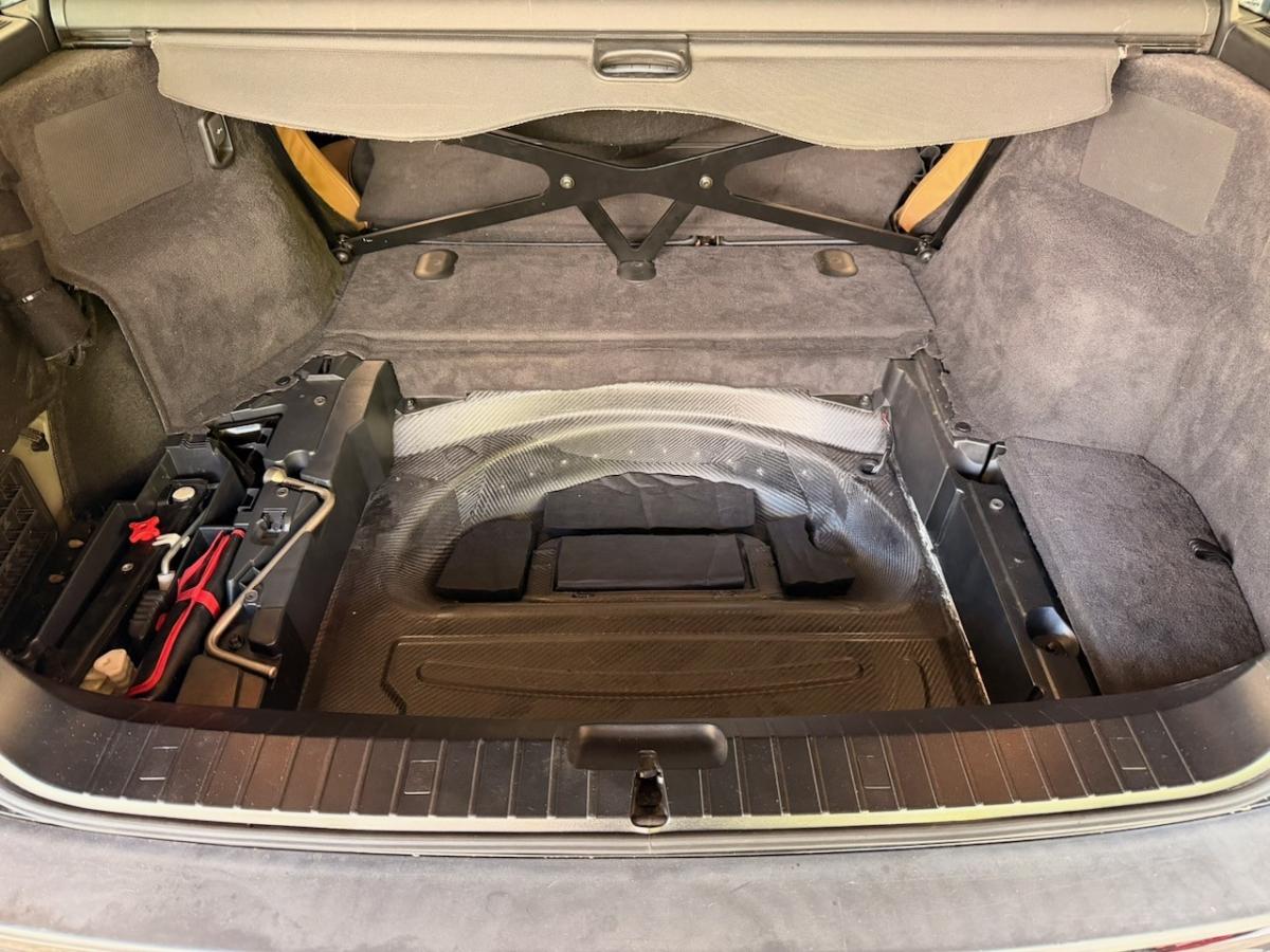

            And here's the finished product, looks like an M3, just more expensive!
            Click image for larger version  Name:	IMG_0161.jpg Views:	0 Size:	169.6 KB ID:	365752
            And a bit more tidied up, now looking like an M3 touring. It looks like I'll even be able to manage to retain the felt floor liner from the touring as an extra stash cubby, more on that later
            Click image for larger version  Name:	IMG_0163.jpg Views:	0 Size:	140.5 KB ID:	365741

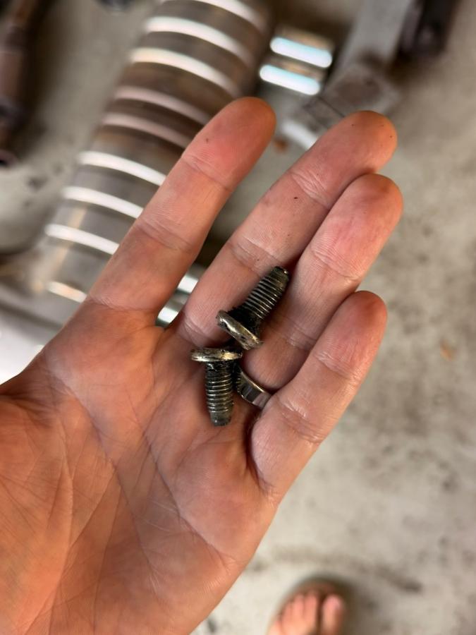

            All that's left is driver's side exhaust studs - two are easy, two are complicated - and waiting on remaining parts to button it up

                  Driver’s side of the trunk floor. You can see it in the shot of the fancy studs. I wish I thought it was that one!
                    Can you circle it in the pic? I see one small dent in the tub area in the mold. Not sure if that's what you're referring to.
                      That’s the one - it’s right near where the mounting stud for the evap cover will go

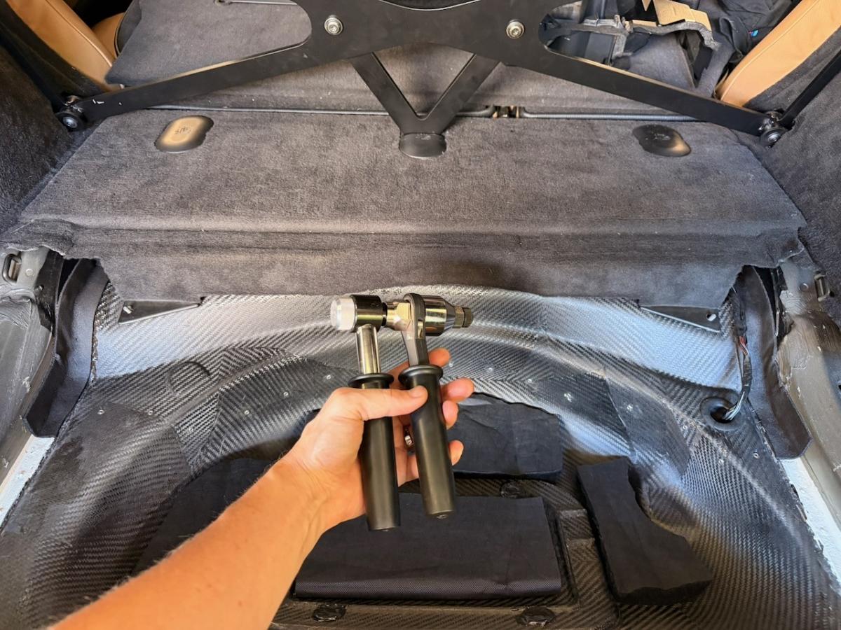

                        Some ups, some downs today. First, added some light insulation to the floor and used @George Hill's sweet stud puller tool to install factory coarse threaded riv-studs for the trunk floor support. I'll use these same studs from underneath the car to add the mounting points for the evap system cover once I have that in hand.​

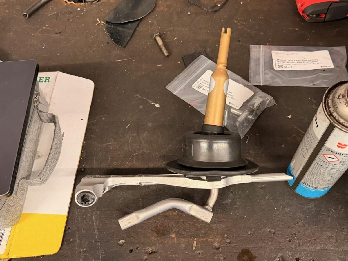

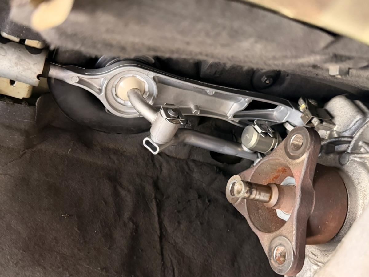

                        Then we moved along to the shift components - something doesn't look right here..
                        Click image for larger version  Name:	IMG_0182.jpg Views:	0 Size:	130.9 KB ID:	365857
                        Click image for larger version  Name:	IMG_0193.jpg Views:	0 Size:	108.4 KB ID:	365859
                        Click image for larger version  Name:	IMG_0192.jpg Views:	0 Size:	83.3 KB ID:	365858
                        I was sent a 330d shift selector shaft in a bag labeled with the 330i selector shaft part number! That'll prevent the driveshaft from going in and getting the car rollable - carbon or otherwise.
                        Then I hung some really damaged evap parts to test fit the stud placement. Fortunately that all worked out great and the harness is the right length without needing extension or shortening. Pretty slick.​

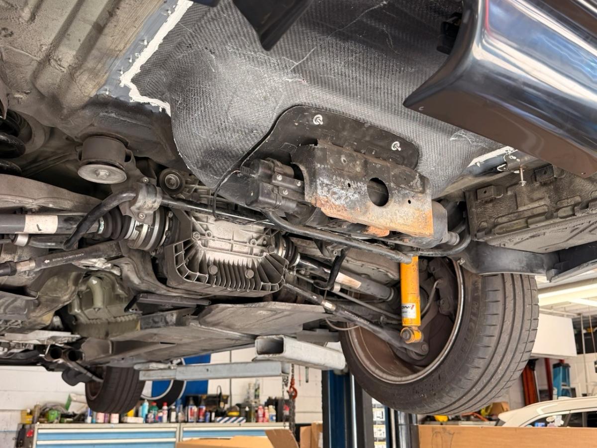

                        Next up I ground out the existing non-m muffler mount studs (they're too short for M3 hangers) and installed some larger M8 bond-in studs similar to the evap studs.
                        Click image for larger version  Name:	IMG_0201.jpg Views:	0 Size:	52.4 KB ID:	365856
                        Click image for larger version  Name:	IMG_0200.jpg Views:	0 Size:	174.8 KB ID:	365861
                        While that was curing, hung the muffler for a final test fit and reinstalled the trunk plastics. Really happy with the placement of the muffler with the brackets and drill templates that all came from scans! And it's starting to look like a car again.
                        Click image for larger version  Name:	IMG_0203.jpg Views:	0 Size:	173.6 KB ID:	365860
                        Click image for larger version  Name:	IMG_0206.jpg Views:	0 Size:	155.6 KB ID:	365863

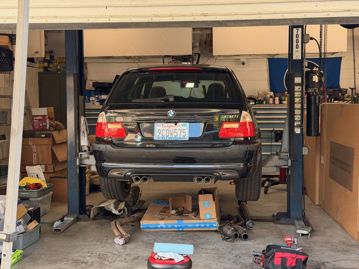

                            Today I logged a couple evening hours before dinner.

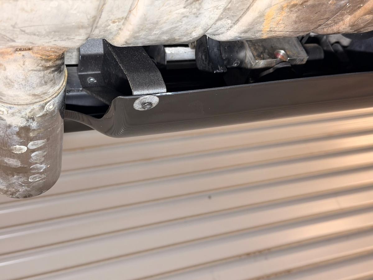

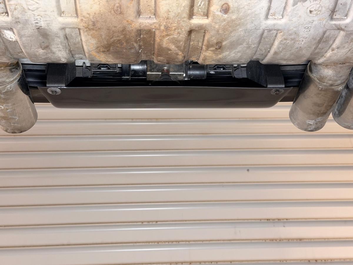

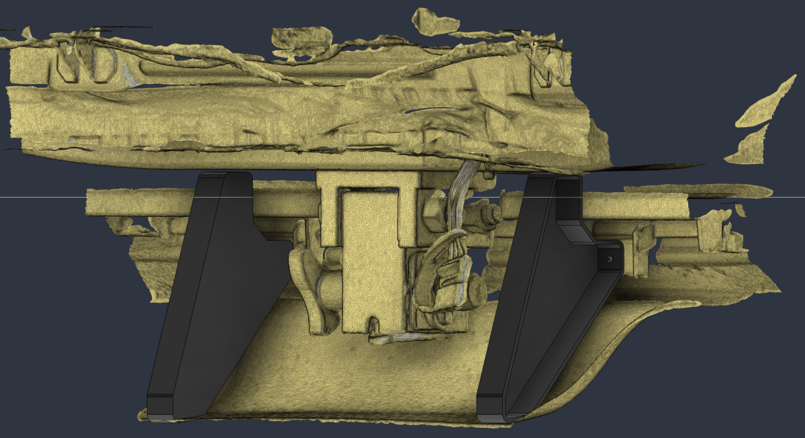

                            First, test fit the valance support brackets that printed while I slept last night​

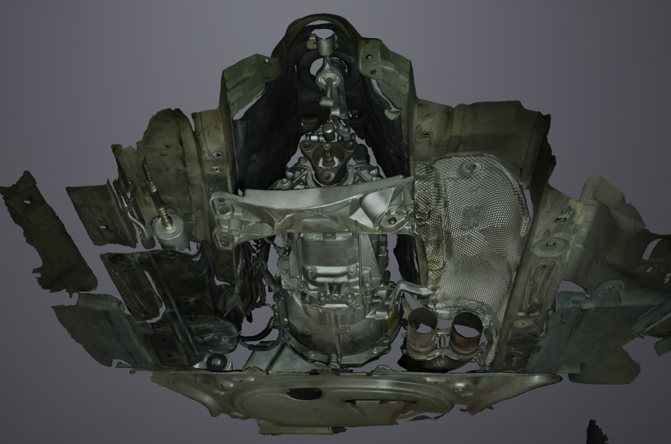

                            Then grabbed a good scan of the gearbox and shear plate installed for the header, or any other future, project:
                            https://s.digital3dcloud.com/space/f...3-ceb742a4a44c (downloadable)​
Name:	Screenshot 2026-09-04 at 9.33.57 PM.png

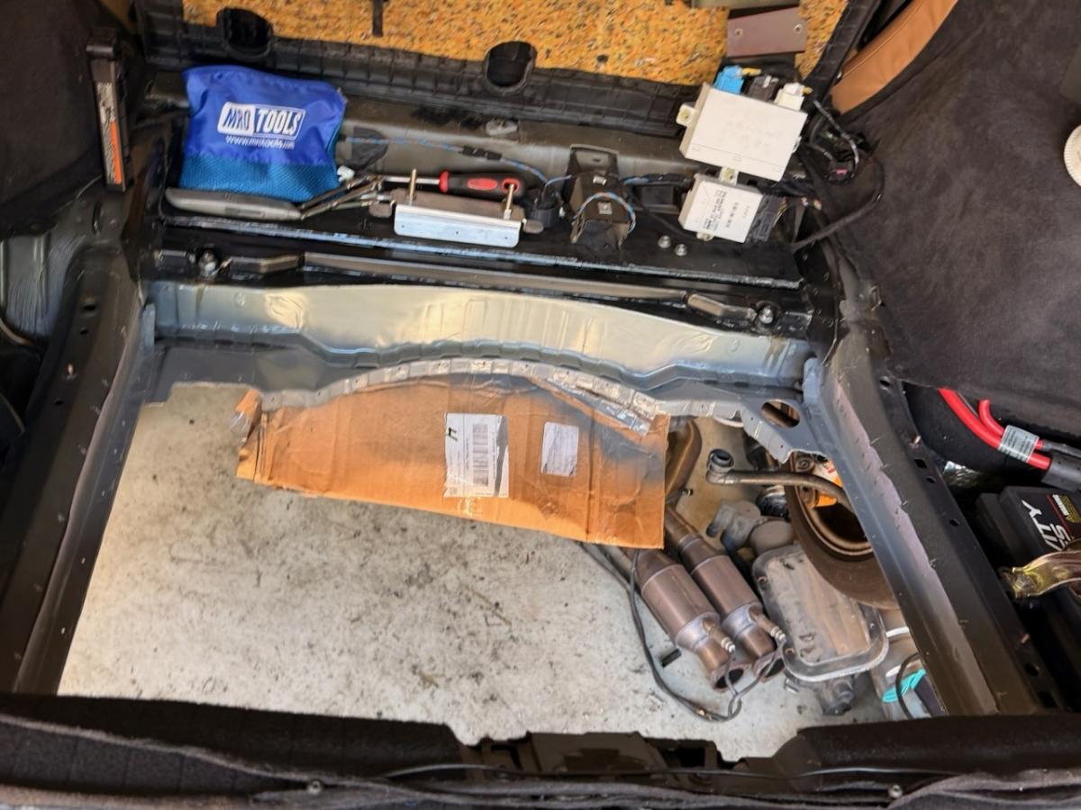

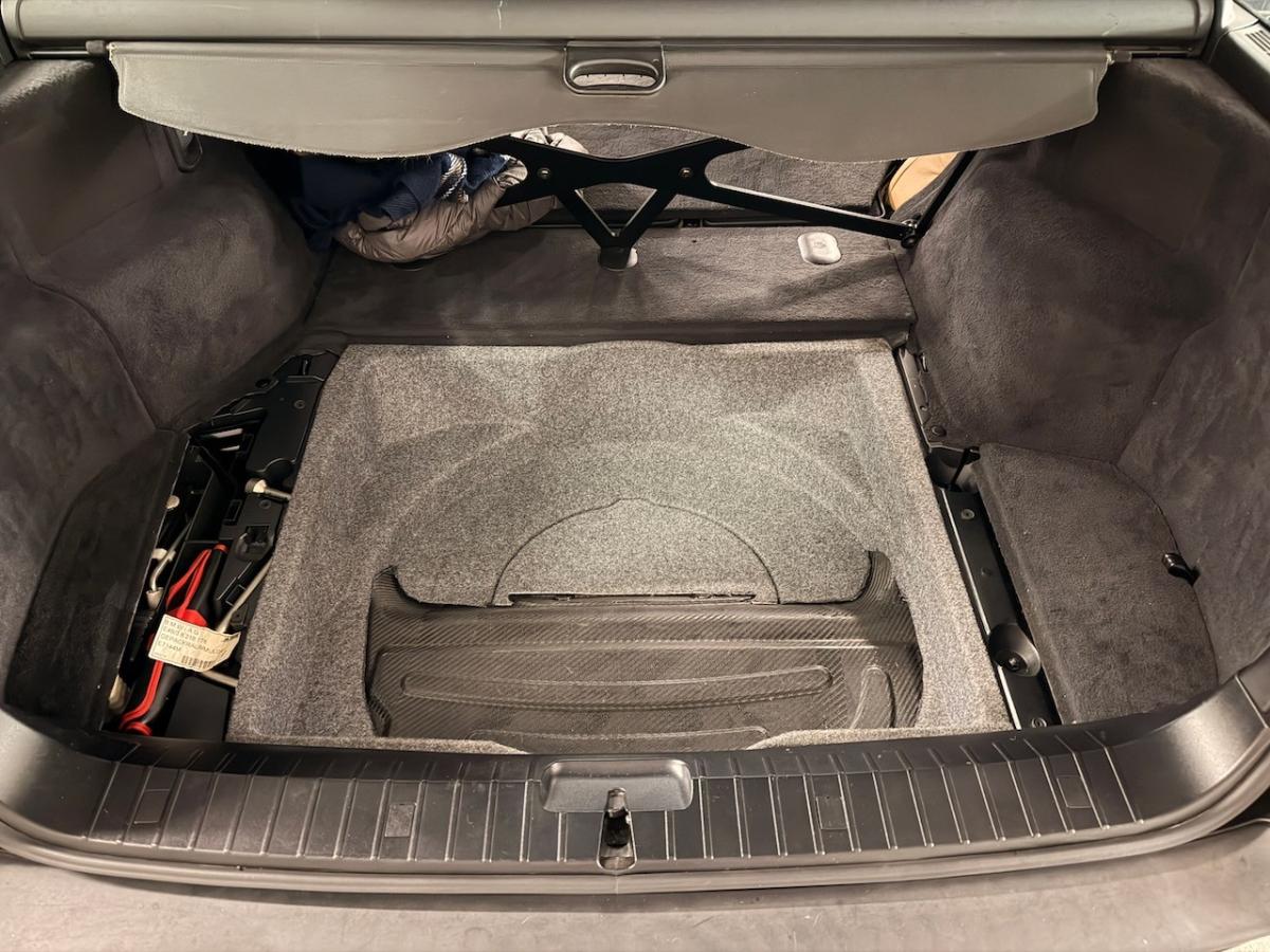

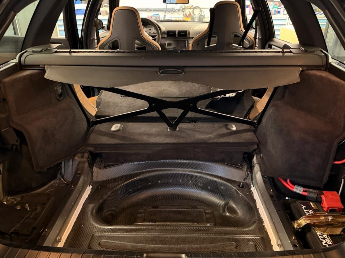

                            Then spent some time trimming the trunk storage tray to work with the M3 floor

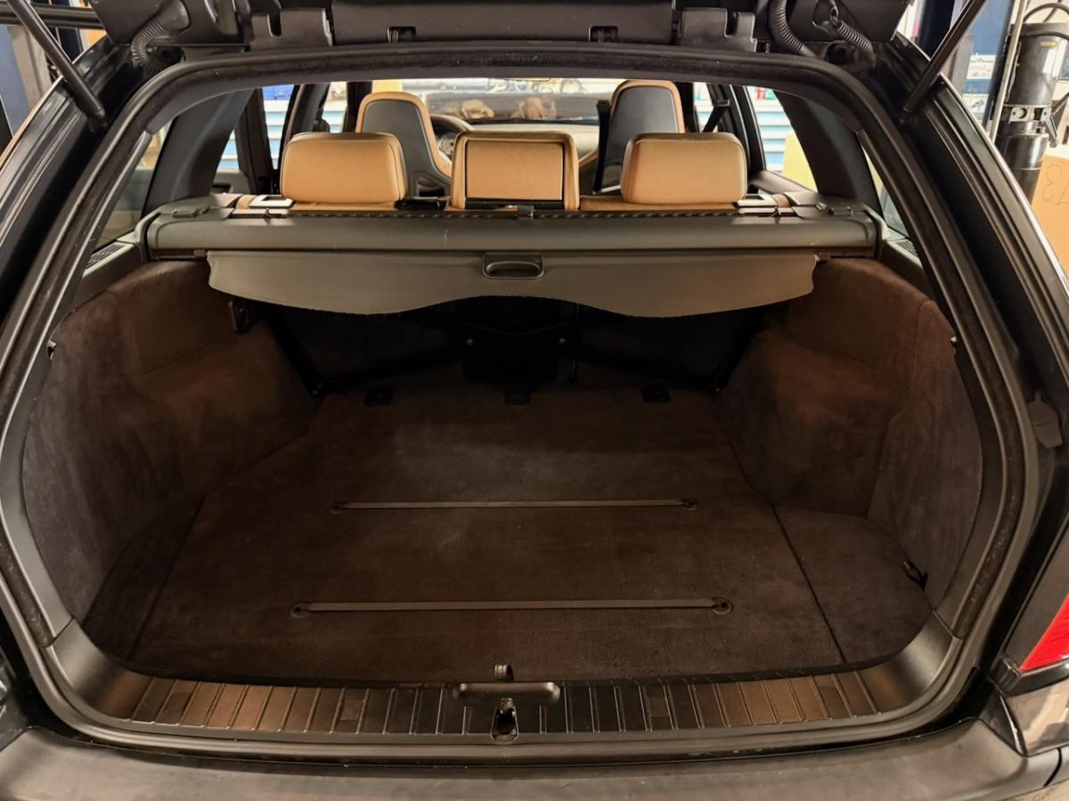

                            And finally buttoned up the trunk!
                              Almost buttoned up. I'd argue it's not fully done until the hat has been reinstalled
                                Hahaha hilarious. But you’re right, that’ll be the sign of completion. The hat currently resides in the jag
