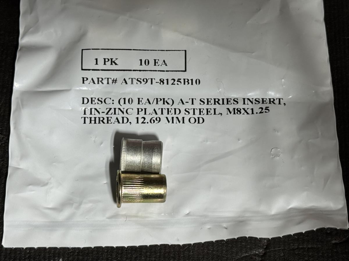

        I think I used M8x1.25 x 16mm button (and e-torx, because why not make it complicated) head screws, I will have to double check length. Then just M8x1.25 rivet nuts with 2mm ground off the nose so that they’d fully seat into the subframe before hitting the upper wall. Installed wet with POR-15 to prevent rust just in case.
        edit: I ordered some of these to test grip range. Will report back: Low-Profile Rivet Nuts, Tin-Zinc-Plated Steel, M8x1.25 Internal Thread, 15.2mm Long
          https://www.mcmaster.com/91230A011​
          Ok this is definitely the right part for this application. Should fit in the available space and installs into a .500” hole

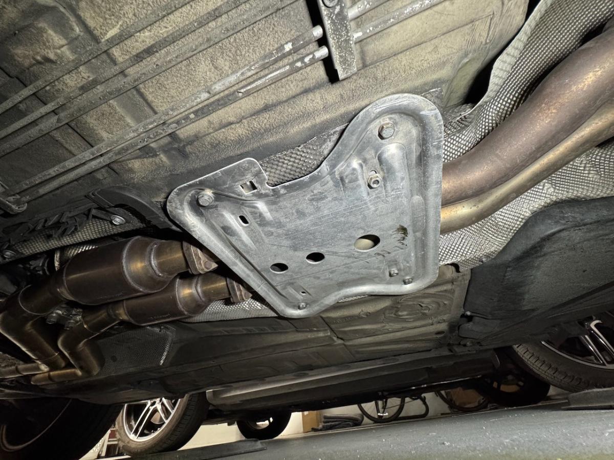

                            This evening I decided to install the first version of the v-subframe-brace.
                            As a recap, the hypothesis is that:
                            1) The remaining rear bump oscillations I felt after installing the X-brace are related to a lack of fore-aft/bending stiffness
                            2) The subframe can rock forward aft, sort of 'around' the axle axis, under throttle application, related to subframe mount failure, and the stock v-brace is not enough to constrain this movement
                            3, unstated so far) The m-clunk is related to 2) and additionally, the subframe floor acts as a bit of a speaker, amplifying the clunk​

                            I wasn't thinking for a bit and ended up installing M6 rivet nuts instead of M8 rivet nuts, probably because I decided to do this on jack stands instead of driving the 2 miles down the street and getting on the lift. At some point I may try to remove the M6 guys and go to M8 as the design intended, but we'll see how we get along for now.
                            Early days and not a whole lot of seat time but I can say reasonably confidently that the hypothesis has been validated, and this brace mitigates a lot of that flexibility.
                            Response and oscillations following bumps are much tighter, and throttle applications are more 'instant' and don't have that coil-up feeling that the e46 has. You can be a bit rougher with throttle application and removal and it doesn't feel as rough on the chassis, it just follows your foot.
                            I've only got a handful of miles on the car, attempting to provoke it of course, but so far I haven't been able to get it to m-clunk. You can for sure get it to cluck by going on/off/on/off throttle very quickly, but this is true even on the newer G80 cars. Shifting feels a little smoother? Not so much in the lever, but in the car itself. Definitely need more miles to validate this.
                            On top of that, it does seem to be even more torsionally rigid when exiting extreme driveway angles. I can tell again that the front is less rigid than the rear. I wonder if recreating the e30 cabrio front strut mount gusseting would be useful. I'm really going to have to do those control arms and a new set of bushings now.
                            Anyway, pleased with this! The car has really transformed a generation or two in ride feel in the past few weeks.​
