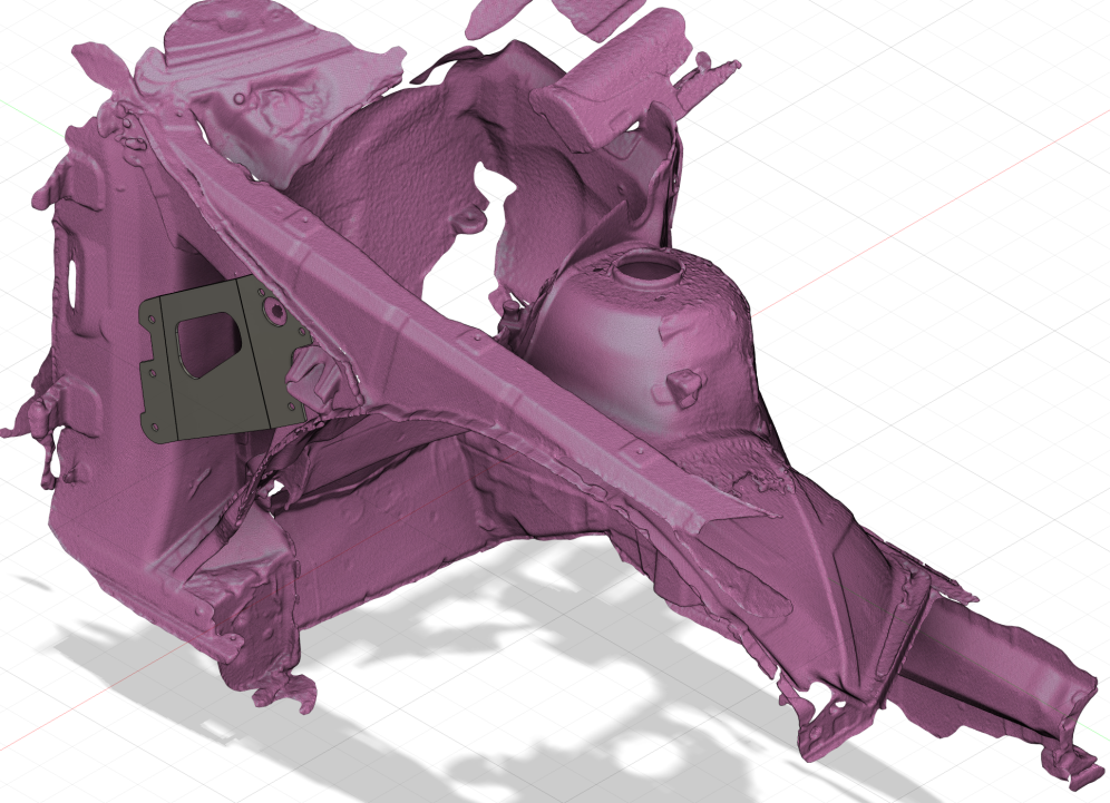

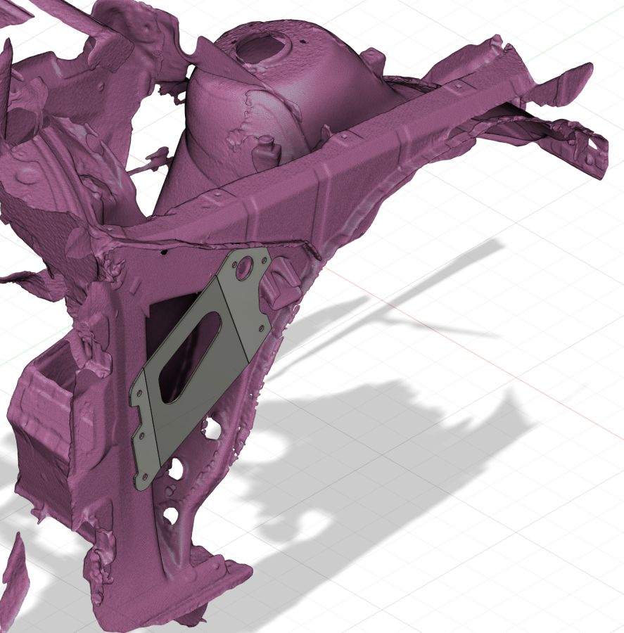

      So we took some scans, including of the other side which had a pothole damaged tower, and I’m going to design some gusseting that will live invisibly under the fender to stiffen the front suspension up nicely.

        Got some work done on the flight!
Name:	Screenshot 2025-06-14 at 2.12.24 PM.png
Name:	Screenshot 2025-06-14 at 2.12.37 PM.png
ID:	308592 Click image for larger version
Name:	Screenshot 2025-06-14 at 2.12.44 PM.png
          Oh man - that's huge! Well done - very impressive to have figured that out! The E46 is going to be like a platform that's 10 years younger by the time you're done with it!
