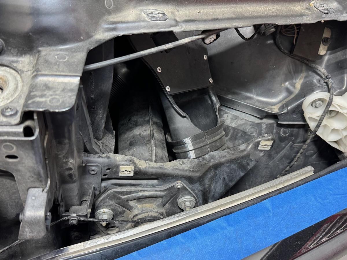

    3) I got to installing the fender brace with these awesome new rivet nuts (definitely recommend).
    I wonder if there would be additional benefit to be gained by epoxy bonding these? (3M 73333, etc.) I'm not really sure if there's any risk of movement over time around the bolt holes?
      From a stiffness performance perspective, technically yes although I’d wager you’re capturing 99.9% of the value with just fasteners. I think on balance you could make an epoxy/rubber joint a little lighter though. Given that I don’t actually know the loads here, tough to say!
        Wow, thanks for your contribution Bry5on, great read and development! I know there's a guy in europe selling a brace that bolts the shock tower and fender rail. Do you think that would add even more rigidity?

            Fits great! Rough math says that the 4 cabrio fasteners will see about 60% of the load of the original 8, and this brace will certainly be stiffer inherently. So an upgrade on paper. No real noticeable change, but it's definitely not less stiff. It's getting hard to do the driveway test as the car isn't making much creaking in the door sills unless it's pretty extreme.

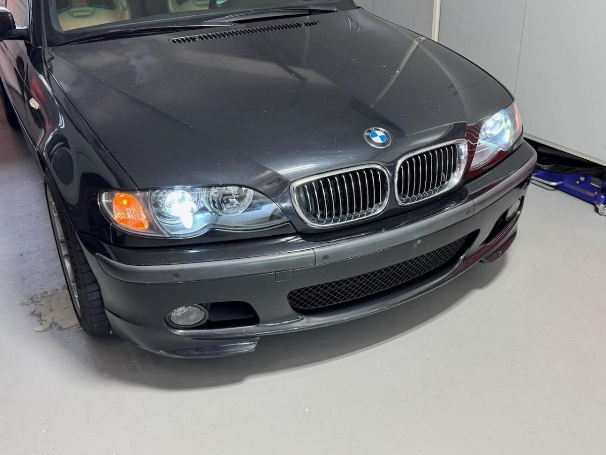

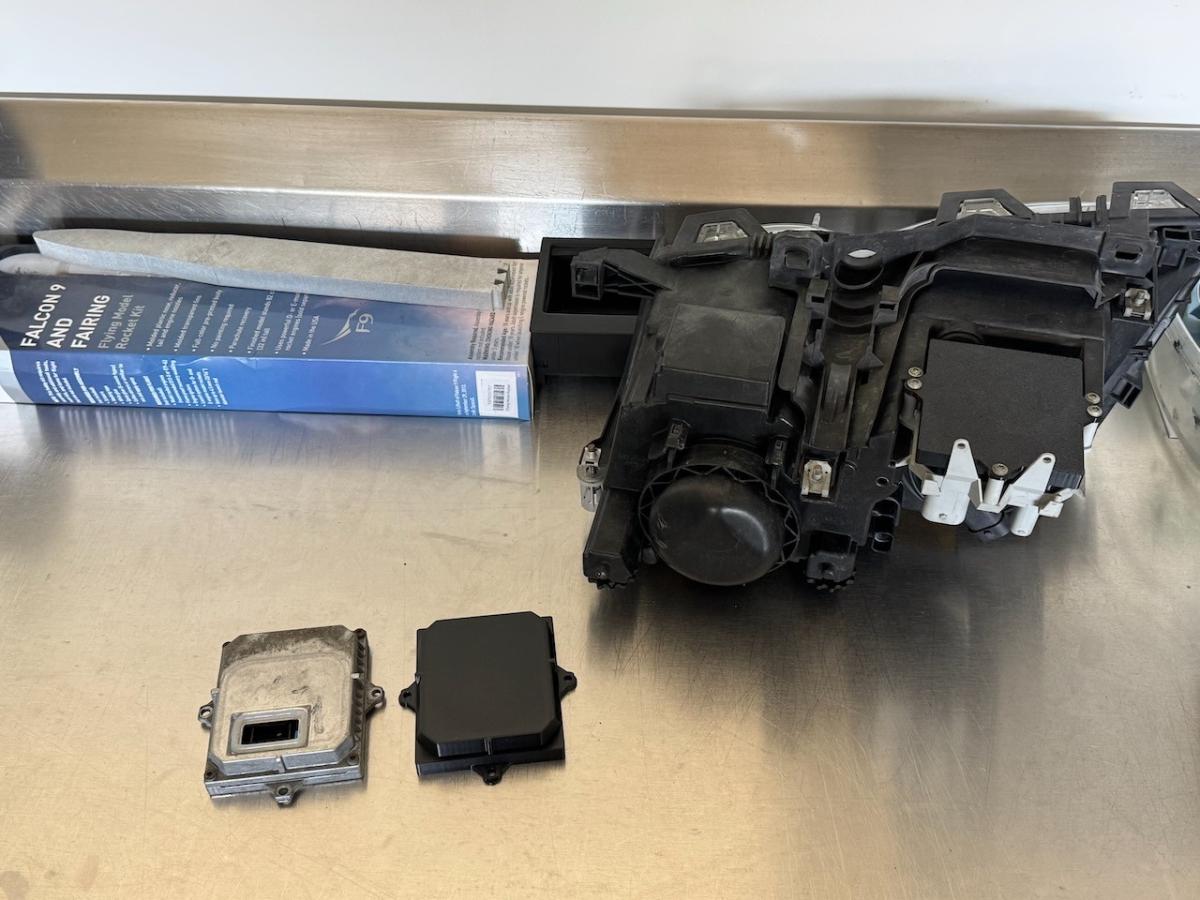

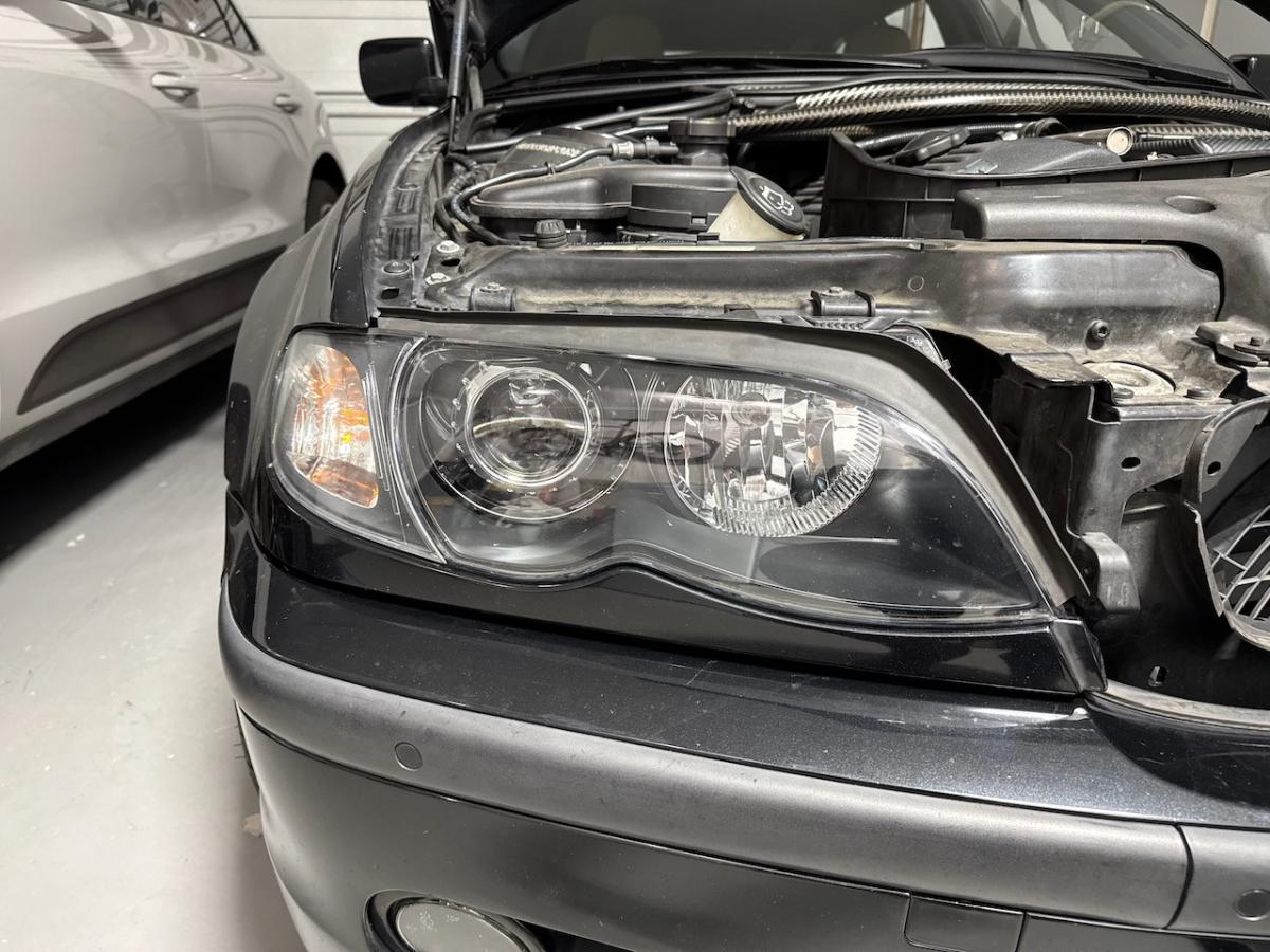

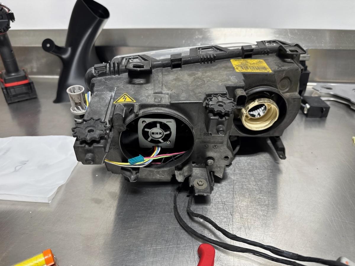

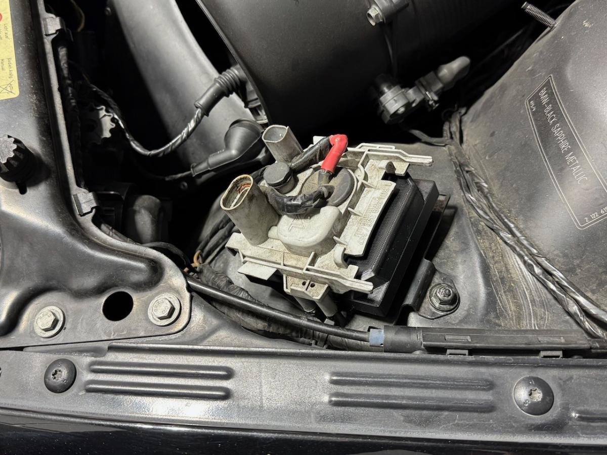

                  Second, I've had a broken-mount passenger headlight for as long as I've owned the car. I finally picked up a replacement and decided to do the NHK LED headlight conversion using nextelbuddy's great DIY video (thank you!) with some minor tweaks. The two tweaks:
                  1) Doubled up the wiring to the low beams (red+green to positive, black doubled-up to negative) as the wire gauge in the BMW wiring is not quite large enough for the LED headlight wattage. It's fine in the HIDs because the bulb itself runs at higher voltage and therefore lower current.
                  2) I 3D printed plastic ballast replacements to drop the dead weight that would otherwise be sitting there. Overall I think I dropped 3lbs off the nose.
                  Honest opinion, I'm not in love with these lights. Yes they're WAY brighter but the color temp is bluer, so they seem less effective with the light output to me. The cutoff is also super weird - it's like a step _| instead of a ramp _/. Not super into it. Not so much that it's worth removing them, but I wouldn't do it again. The stock headlights were pretty damn good.

                    Sounds like those are crap, because the stock headlights are not very good
                    Glad to hear the review, though, as I've been debating LED conversion to take weight off the nose.
                      How's the glare with those LEDs?
                      Having tried a good range of color temps for headlights, I think my favorite color temp range is something like 3500-3700 K. Above that, I feel like I start losing more to glare than I gain in resolution.
                      Automotive xenons are generally what, low-to-mid 4000s K? That's pretty much the highest I'll go for.
                      2008 E90 M3 6MT
                      2011 E90 328i 6MT
                      RWD, slicktop, no iDrive
                        I’m not exactly a headlight expert, but glare might be the right word to describe it. They’re so damn bright, but the brightness is a little jarring, especially when combined with the cutoff that you CANNOT get into a good spot. The light coming off of reflective signs is very intense, and generally the light coming off of other objects is also intense. I tried a few level adjustments and either you’re blinding cars in front of you, or the cutoff is dropping into the road because of the height of the step in the cutoff. They’d be worlds better if the cutoff was just flat.
                        My wife’s and my prior Porsches both have/had LED headlights and didn’t experience either of these issues, so I was unpleasantly surprised. These are just as bright, if not brighter, but the execution isn’t fantastic.
                        Also note that I have non-m headlights, so mine don’t suffer from the toasted marshmallow reflector issues that the M3s had. Both reflectors came out looking perfect with 240k miles on them.
                          See my note above about your marshmallow headlights.
                          Worth noting that almost all of the weight reduction is from replacing the ballasts with 3D printed ones. If you’re targeting weight reduction, eliminating them entirely and wiring direct would be the best move. What I did is sort of an 80/20 solution that preserves the factory looking engine bay but drops at least 80% of the weight. The LED headlight itself is about the same weight as the HID+igniter.
