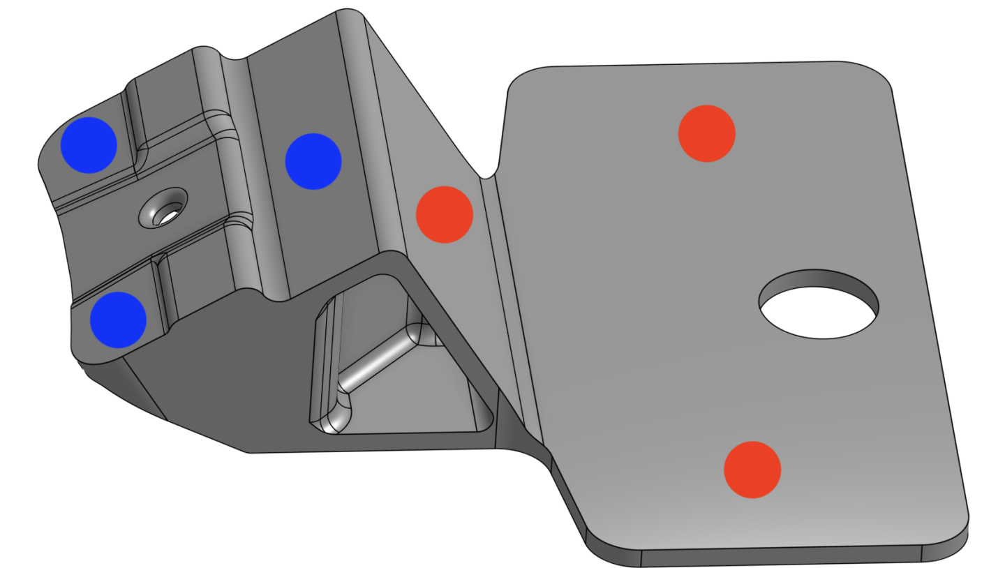

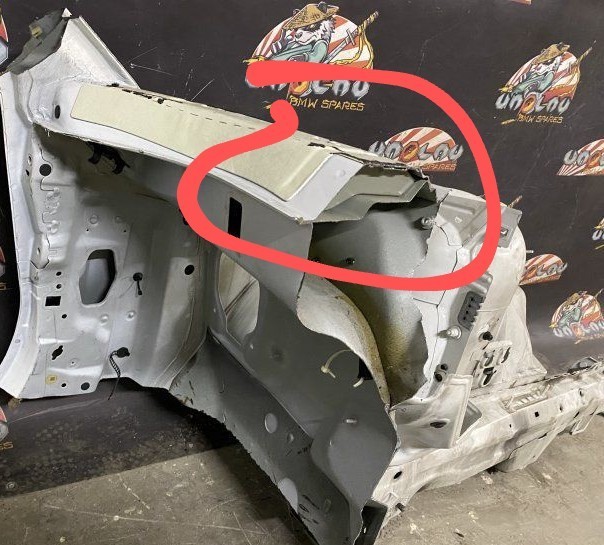

    What do you think the manufacturing costs and easability would be for a bolt on piece?
    I can have a heater case out of an E46 in under 1.5hrs 👀

      I wasn't sure if the bracket would need to be redesigned for a bolted method, but I guess as long as its bolted through something solid it should be fine.

        +1. Just add some holes and run some bolts through.
        All of the red locations look like they'd be fair game in the sense that the bolts wouldn't run into anything in the chassis:

        Blue spots would land under the cowl, like Bryson said. Maybe some (big) rivets in these spots would be low profile enough to not interfere with the cowl? You definitely want fasteners up front though, that's the part of the mount that most wants to peel away from the chassis.

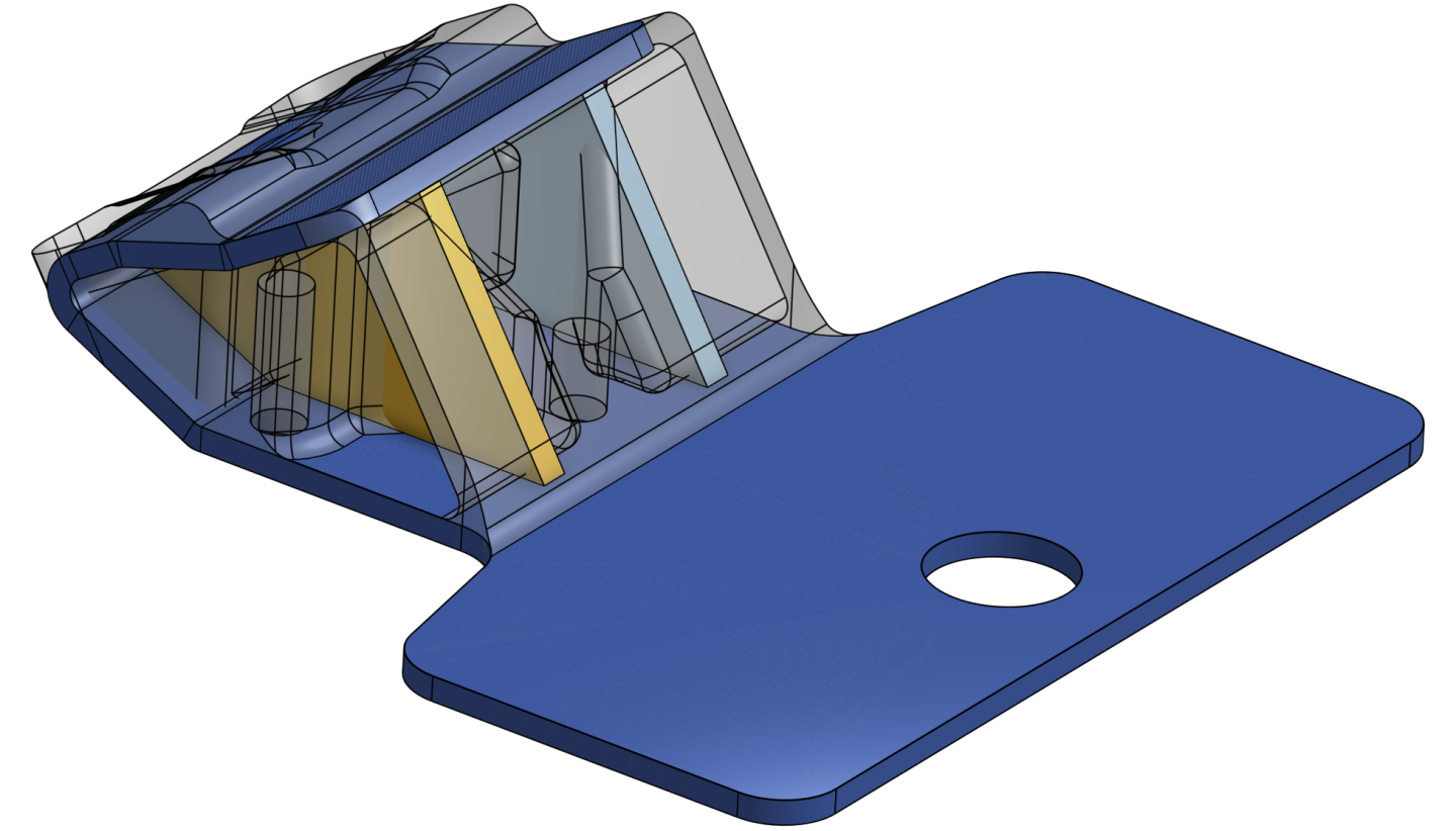

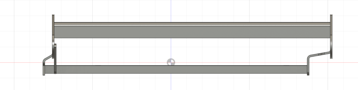

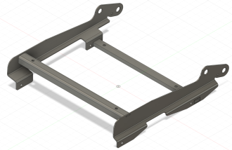

        If you're going through the effort of redesigning for bolting, I would be inclined to attempt a sheet metal version. You don't need material along the top if you're not bonding, so a "sideways J"-shaped piece might work (maybe add a couple weld-on ribs for extra strength). The resulting parts is probably gonna be similar weight, but should be much cheaper to produce.
        Give me a sec, let me draft up something real quick, just to explain the idea better.
        Edit: Super rough, but something like this:
        Click image for larger version  Name:	Screenshot 2026-04-15 at 4.41.21 PM.png Views:	0 Size:	207.9 KB ID:	352002
        Maybe rotate the ribs inwards a bit to have them be more in line with the loads.
        Here's the machined version overlaid, for reference:
        Click image for larger version  Name:	Screenshot 2026-04-15 at 4.40.58 PM.png Views:	0 Size:	430.6 KB ID:	352003

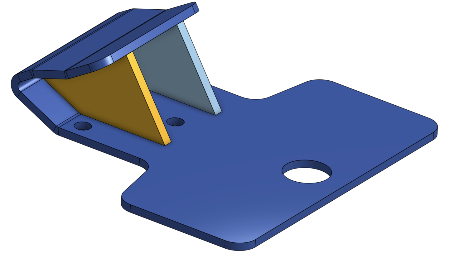

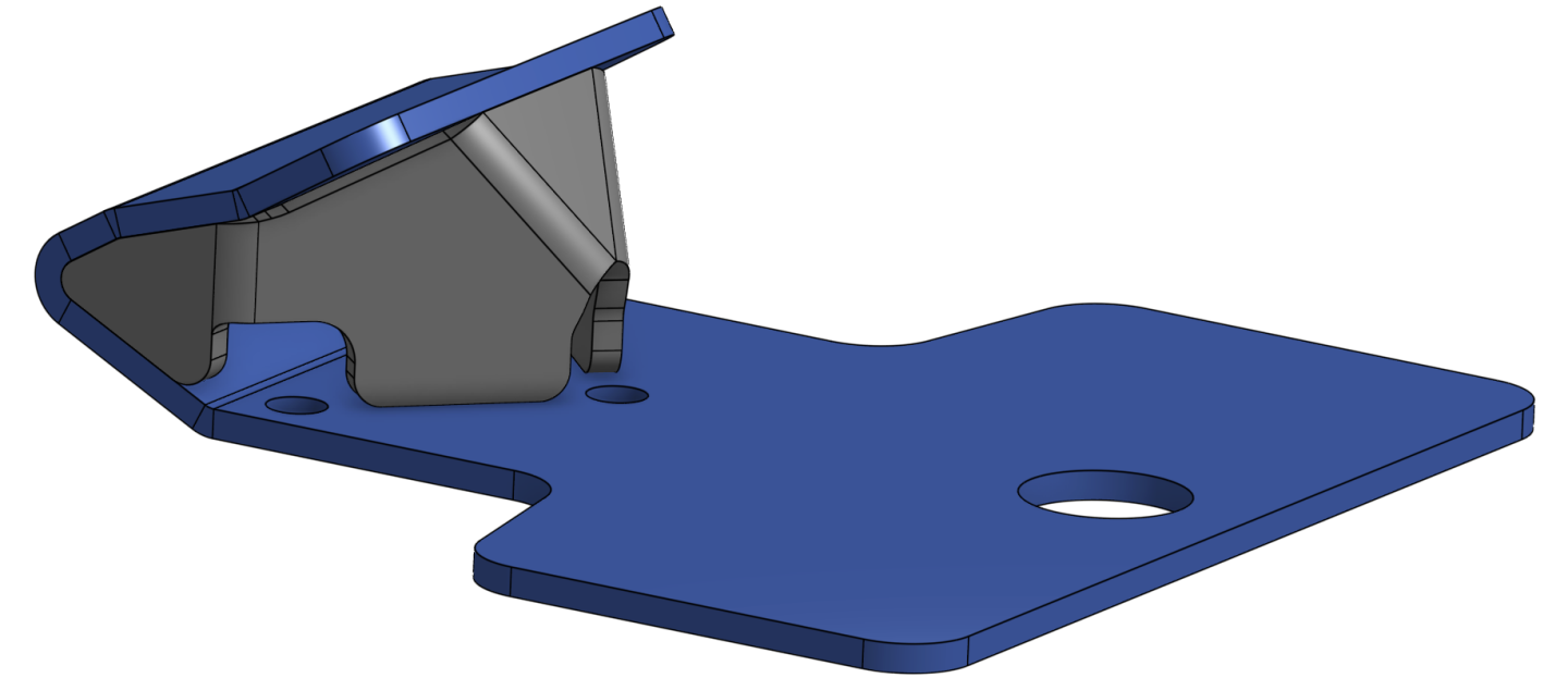

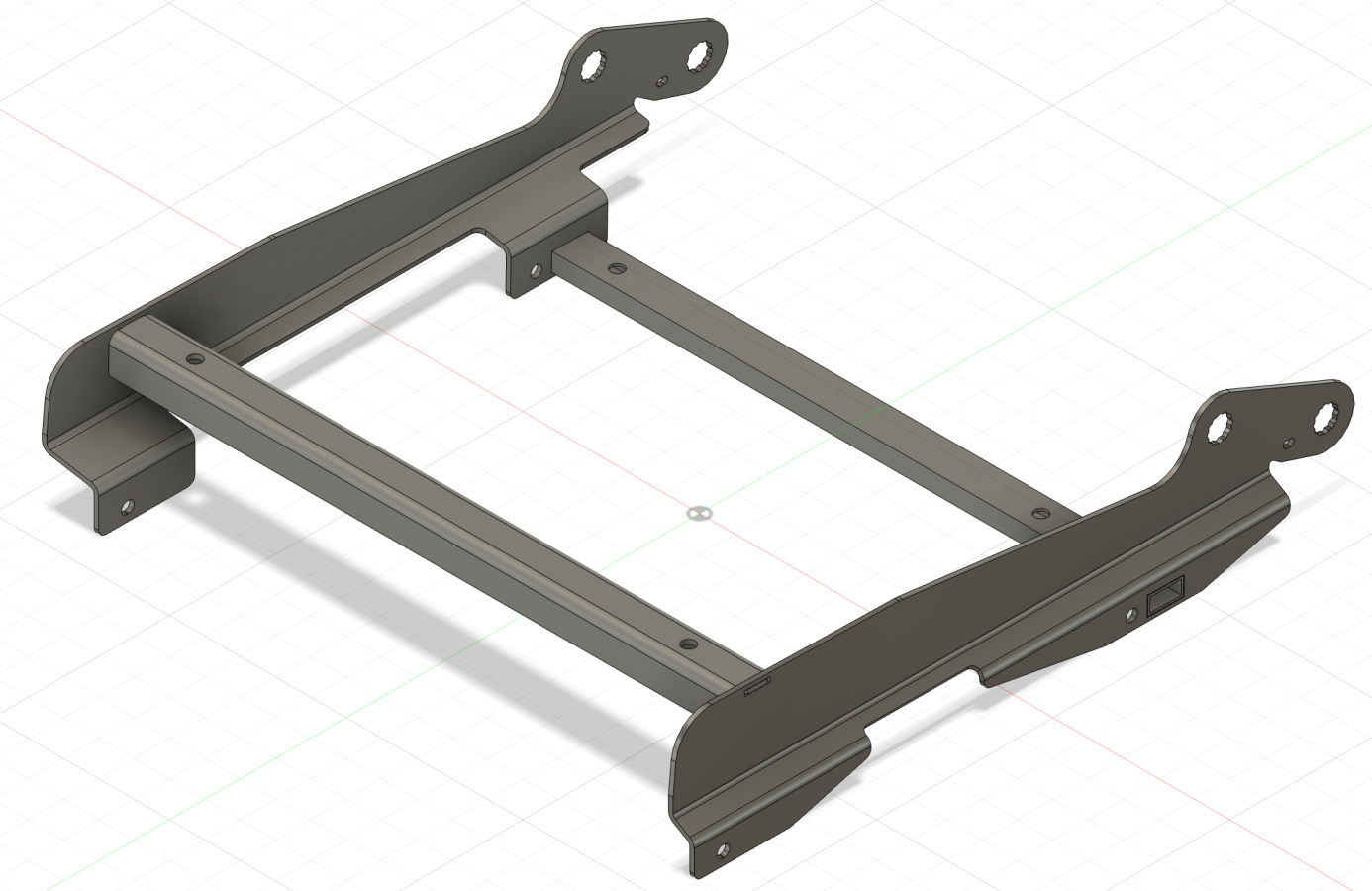

          This looks way better:
          Click image for larger version  Name:	Screenshot 2026-04-15 at 6.11.42 PM.png Views:	0 Size:	143.7 KB ID:	352022
          Ribs in line with loads and has space for fasteners in the corners of the topmost + frontmost surfaces.
          The above parts should weigh ~300g if made of 7075. Add in weight of welds + rivnuts and you're getting awfully close to the 428g weight of the machined part. So yeah, really only worth exploring this route if you want to drive cost down. Otherwise, I'd stick with the proven machined design.

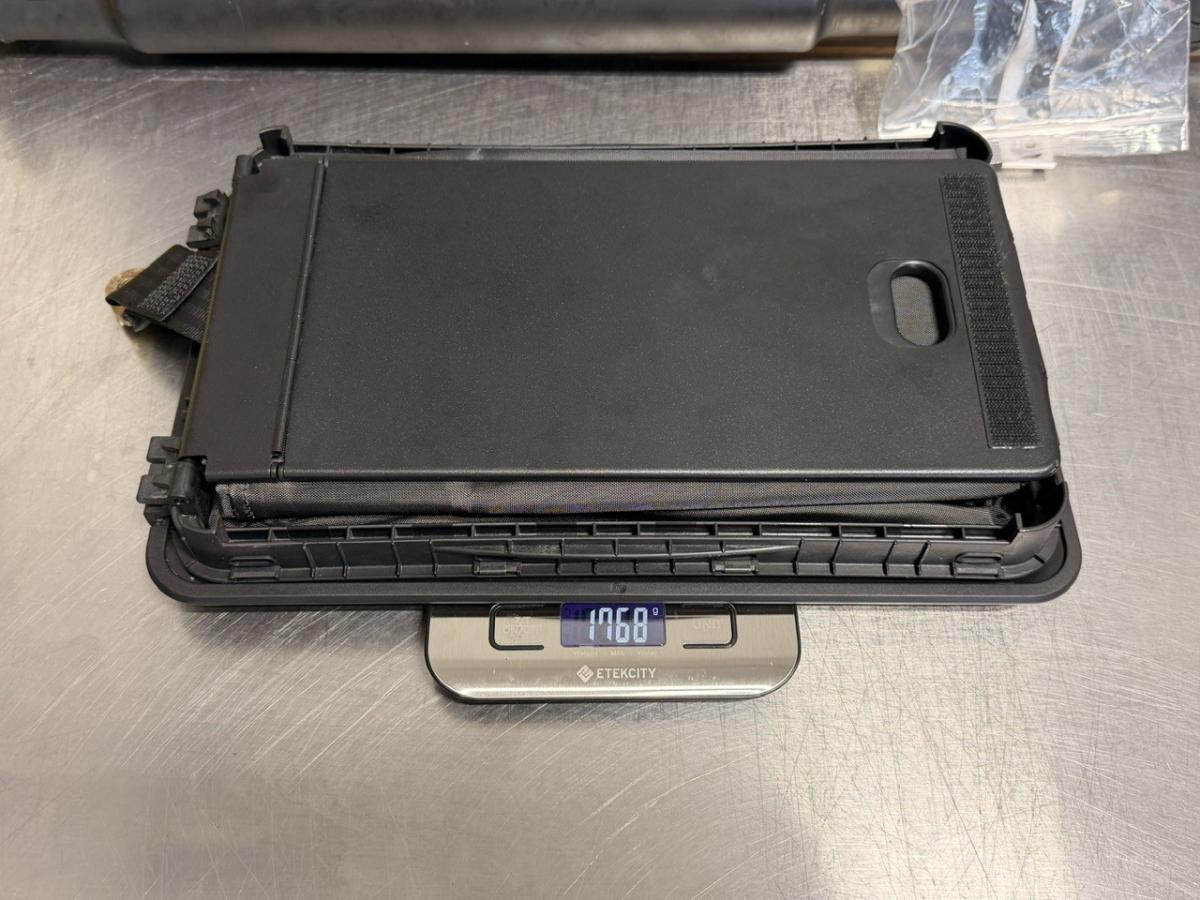

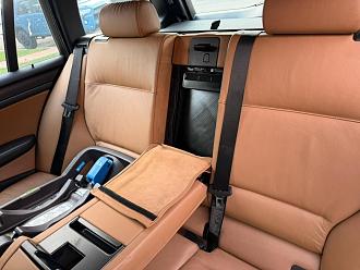

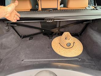

            Quick and easy 4lb weight savings by removing the ski pass:

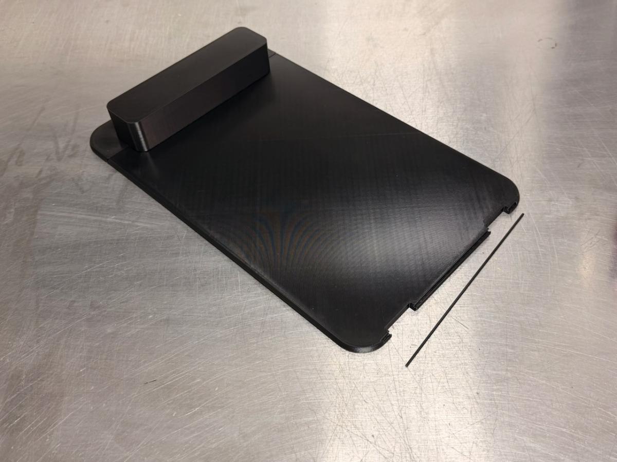

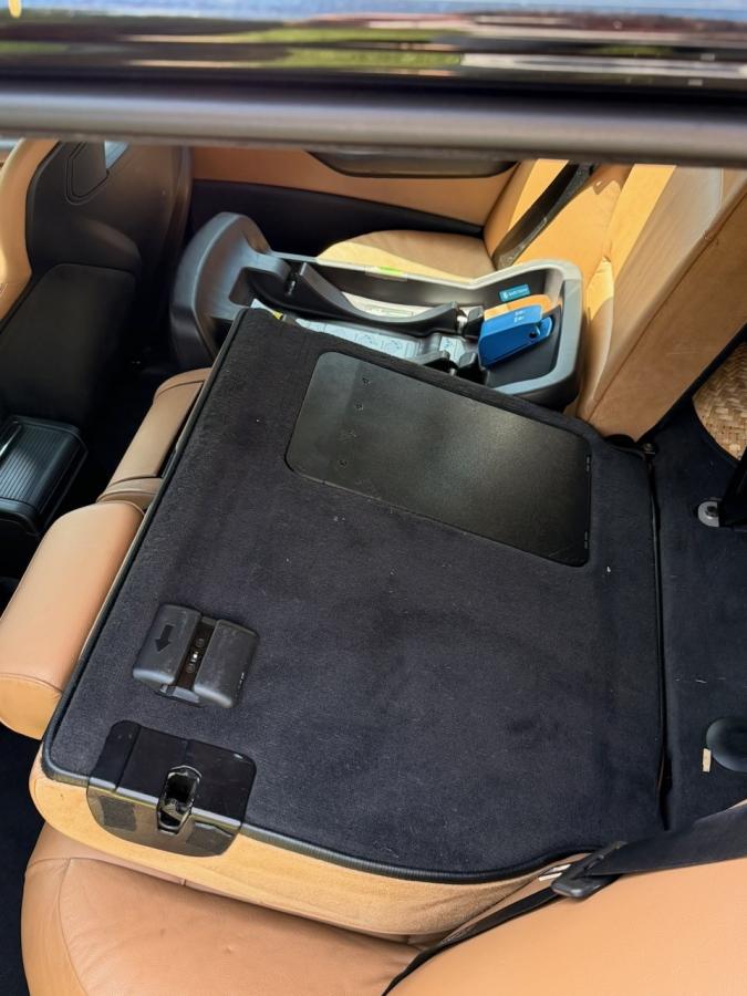

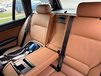

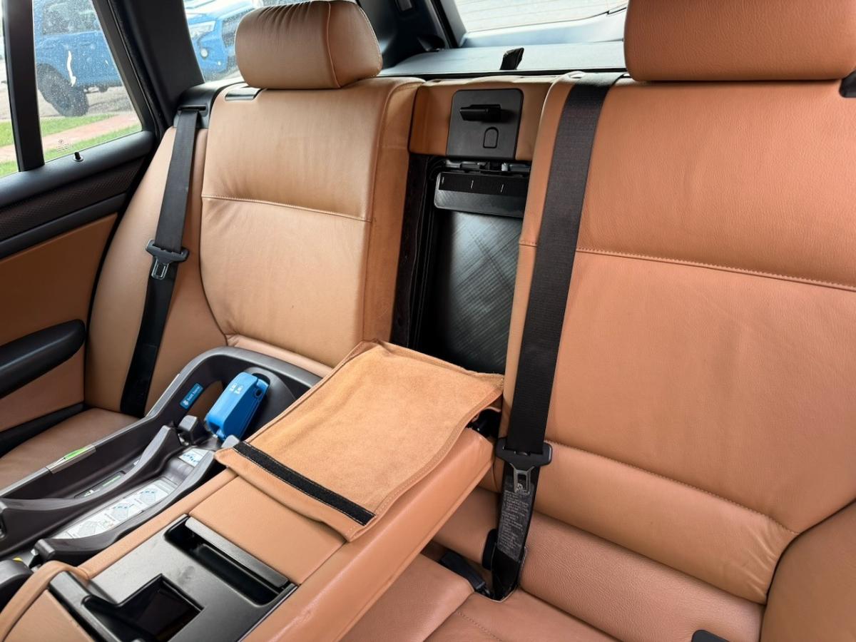

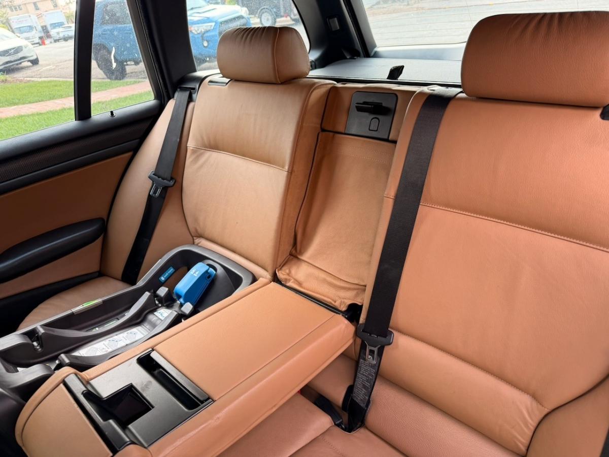

              Okay, seeing natural brown from the trunk and not having a spot to velcro the leather to was bothering me. So I added back a half pound:
ID:	354047 Click image for larger version
ID:	354046 Click image for larger version
ID:	354049 Click image for larger version
ID:	354045 Click image for larger version

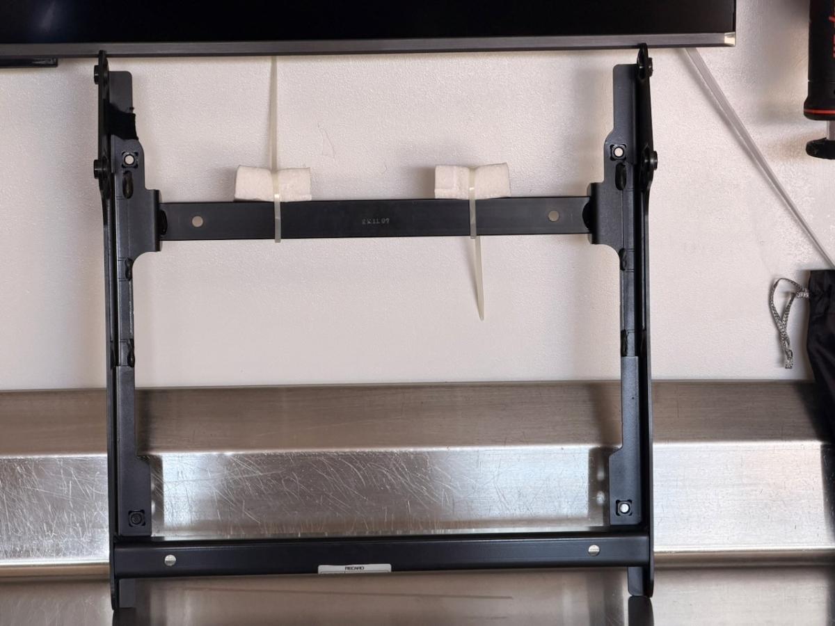

                Factory part for measurements:
                Click image for larger version  Name:	IMG_8819.jpg Views:	3 Size:	108.6 KB ID:	356192

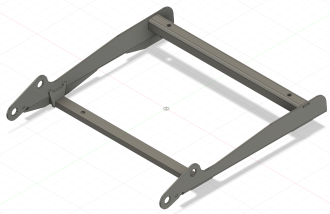

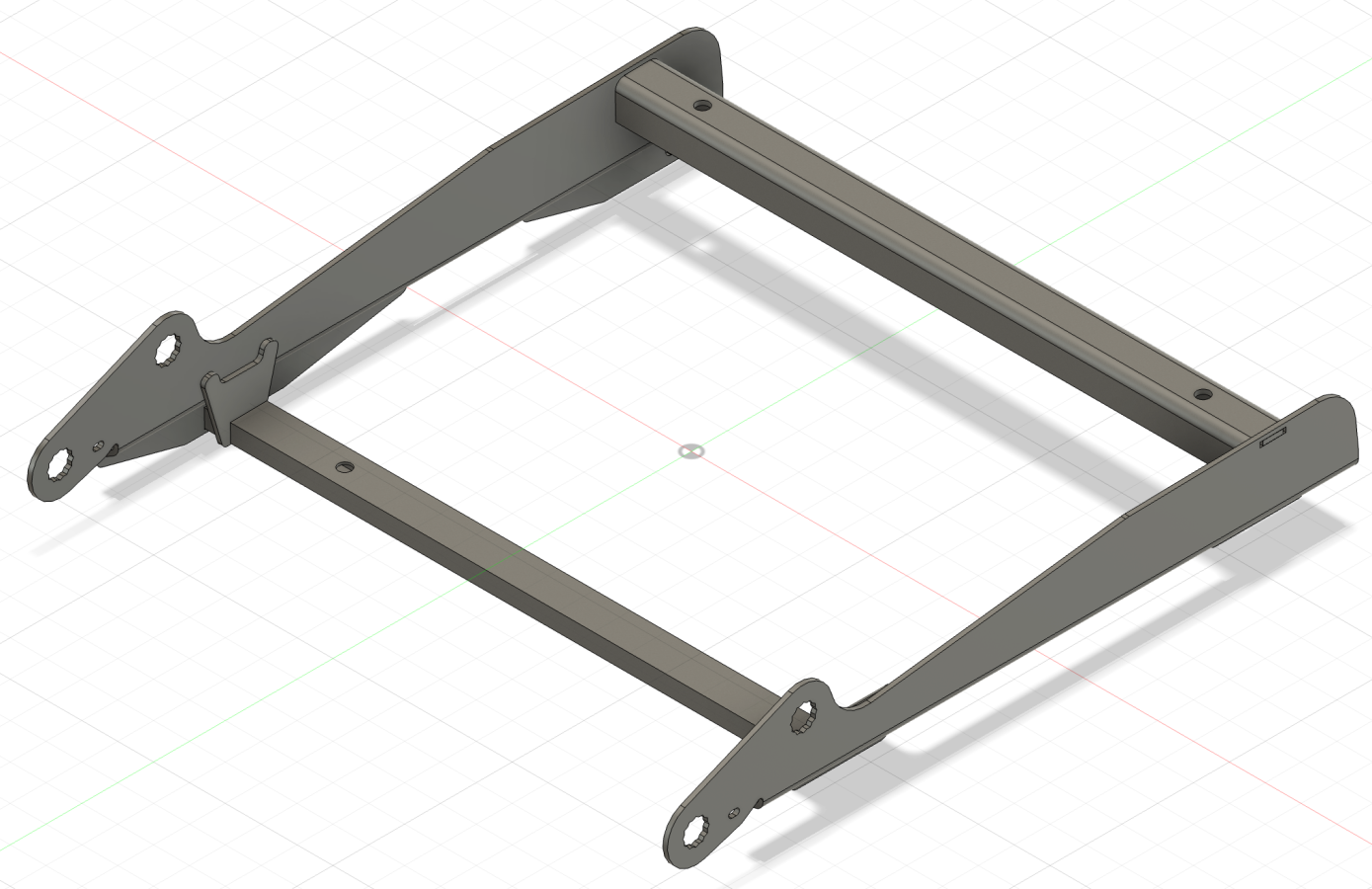

                And some shots of CAD. Will keep you all posted on how it goes:
                Click image for larger version  Name:	Screenshot 2026-05-22 at 2.47.49 PM.png Views:	3 Size:	528.1 KB ID:	356194 Click image for larger version  Name:	Screenshot 2026-05-22 at 2.48.04 PM.png Views:	3 Size:	475.5 KB ID:	356193 Click image for larger version  Name:	Screenshot 2026-05-22 at 2.48.16 PM.png Views:	3 Size:	104.8 KB ID:	356191

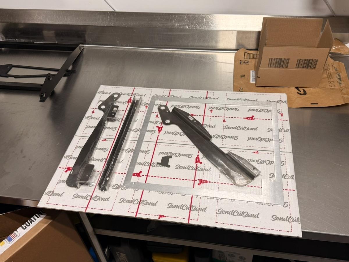

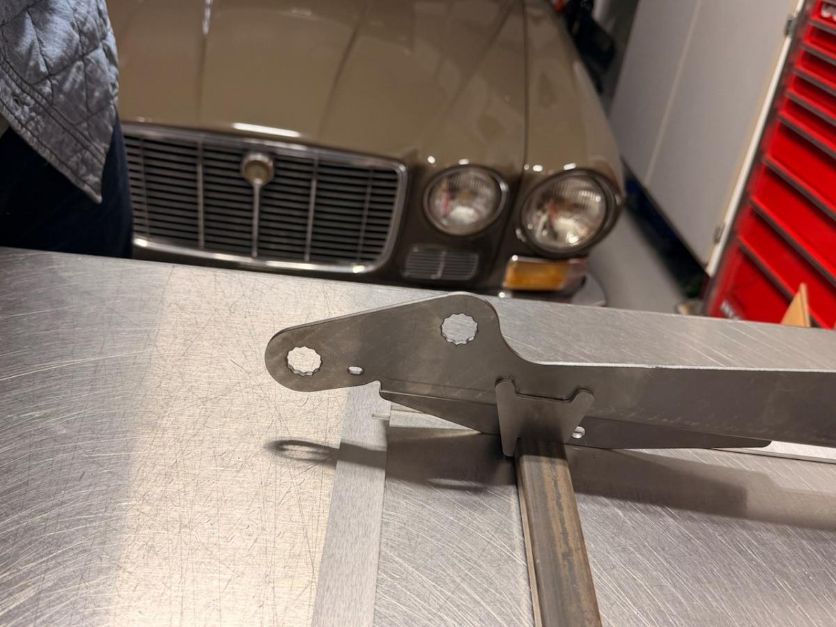

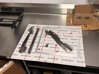

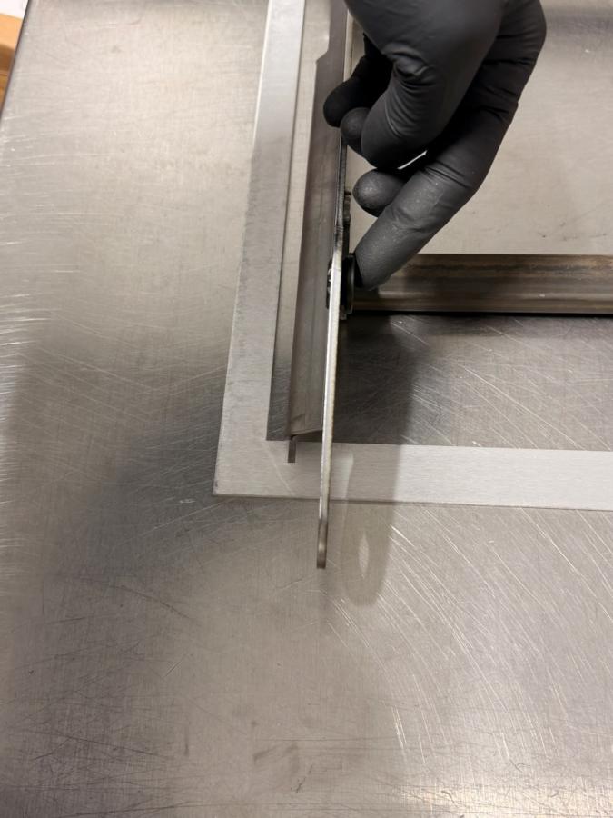

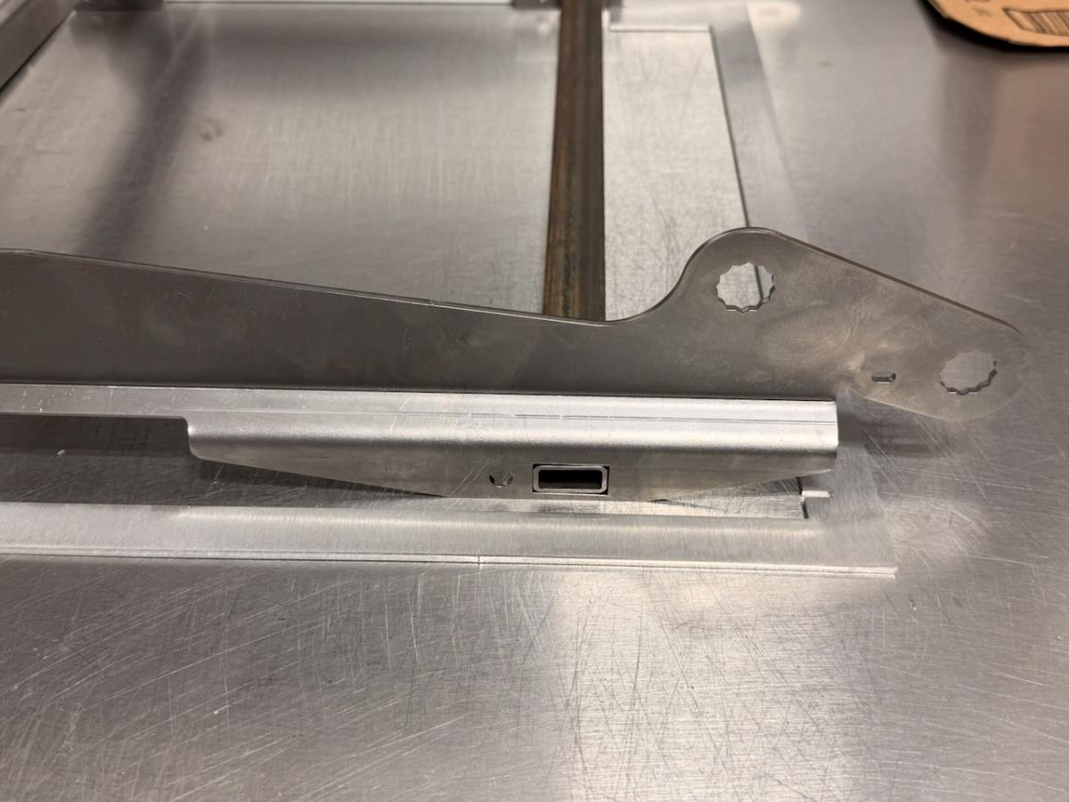

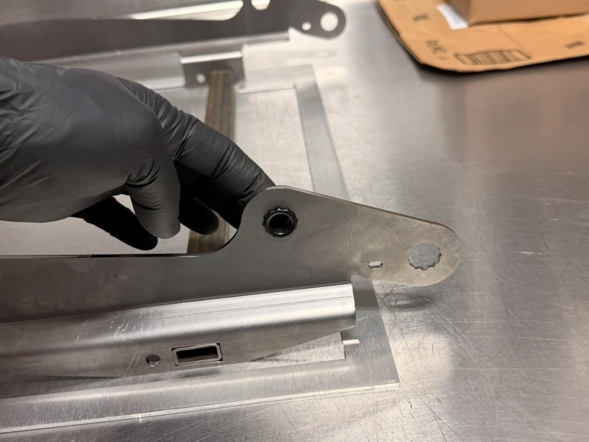

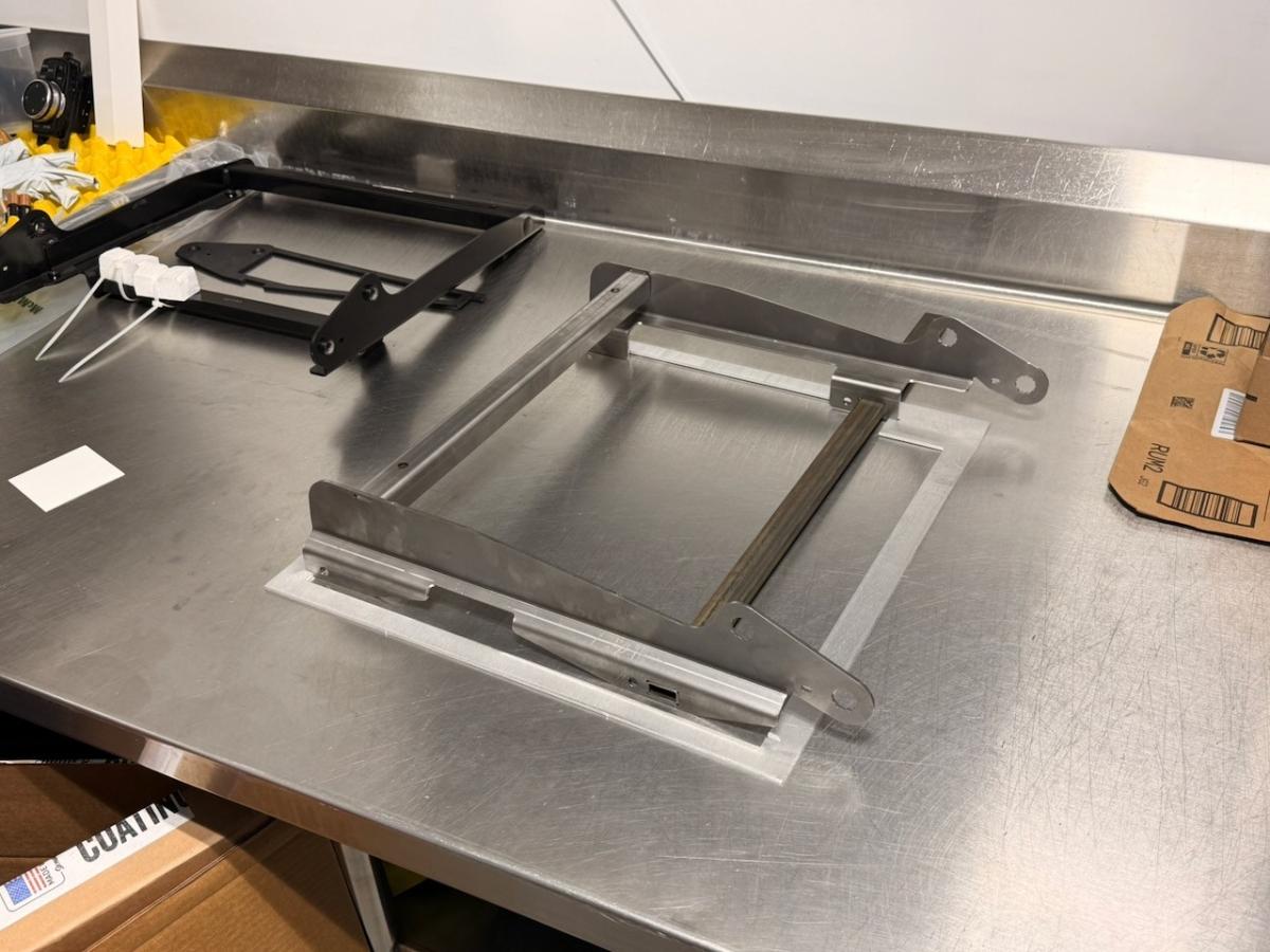

                        Quick photo drop while I'm short on time. All the parts arrived for the seat base weldment, including the weld fixture:
ID:	357045 Click image for larger version
ID:	357042 Click image for larger version
ID:	357047 Click image for larger version
ID:	357046 Click image for larger version
ID:	357048 Click image for larger version
ID:	357044 Click image for larger version

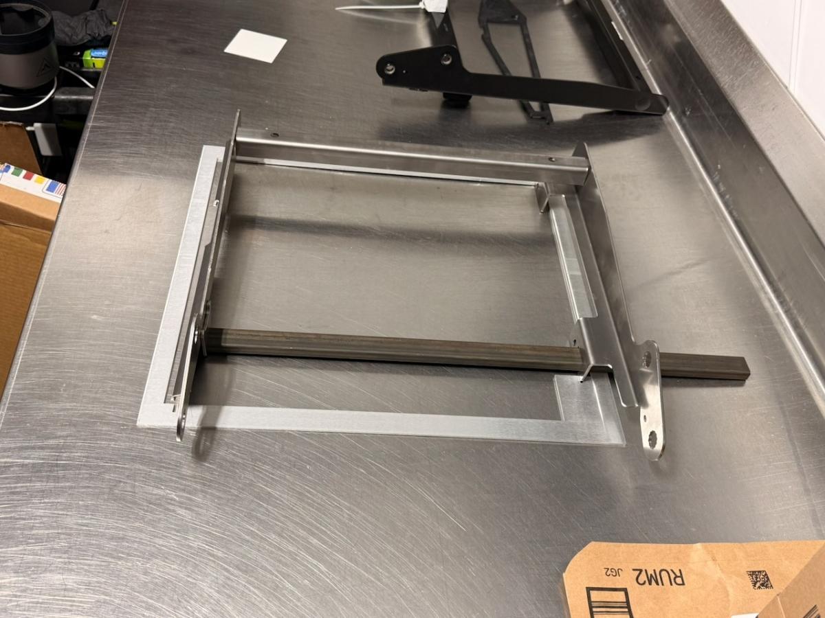

                                Okay, we have a resounding success. The brackets bolted in as planned and fit perfectly. There's about 1mm clearance to the seat motor, a few millimeters clearance to the closest factory mounting nut, seatbelt position is perfect, no contact with anything that shouldn't have contact and the seat is absolutely as low as it can go with the factory sliders. And it's the perfect height for me (6'2-3" depending on time of day). This seat is a full 1.5" lower than the Brey Krause adapters, and almost 3/4" lower than my prior version. On to some pictures to share the process..
                                First, we laser cut a fixture template, printed some fixturing tools, printed a drill template for the lower bar to locate the mounting holes, then fit everything up for welding:​
ID:	357486 Click image for larger version
ID:	357488 Click image for larger version
ID:	357493 Click image for larger version
ID:	357489 Click image for larger version
