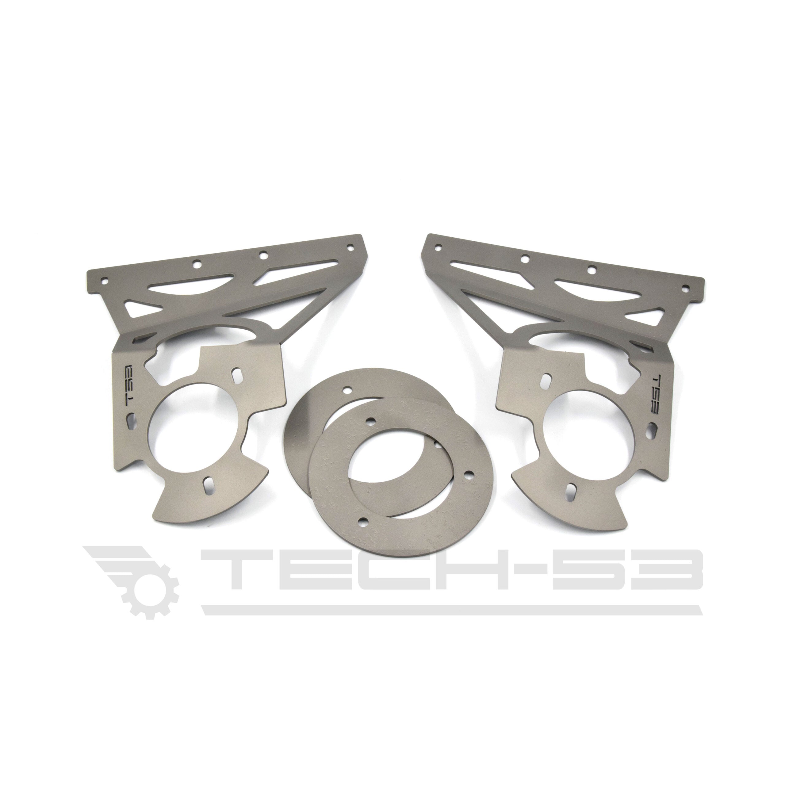

        Wow, thanks for your contribution Bry5on, great read and development! I know there's a guy in europe selling a brace that bolts the shock tower and fender rail. Do you think that would add even more rigidity?
          https://drifthq.com/products/tech-53-bmw-e46-bolt-on-strut-tower-reinforcement-kit?pr_prod_strat=e5_desc&pr_rec_id=64e6463eb&pr_r ec_pid=8087369875643&pr_ref_pid=8006405423291&pr_s eq=uniform
          Funny, this is actually what I started on, which led me to the project I chose instead! I went to visit George to grab a scan of that area to design a brace just like that.
          It just so happened that the car I was scanning had hit a big pothole on one side so I could see exactly how the metal deformed. Once I’d given that a good look, I was pretty convinced that the flexiness that cracks that strut tower seam sealer is actually coming from where I braced, not directly from where the cracks were forming. So we ran the experiment I posted about earlier to validate the theory. At this point, I think that the brace above would be a bit redundant. I’d bet it would provide incremental gains, but likely much smaller than the invisible ones I installed. Plus, it wouldn’t be invisible So for now I’m pretty happy with where it is.
