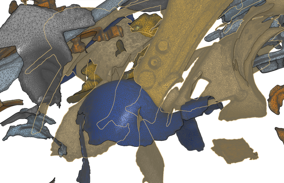

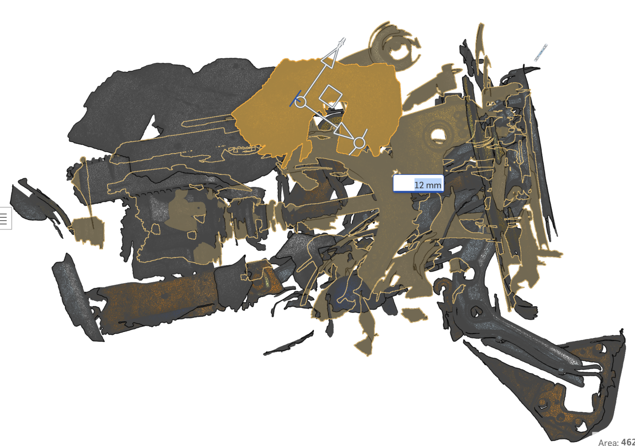

          Sweet. Now we need to attach it to the muffler somehow. I have some scans of the underbody of the car from the suspension project, so let's use one of those to design a bracket. And since I only have a MIG for non-stainless steel and the exhaust is stainless, and I'd like to keep it rust-free, let's bolt it on instead of welding it on. Now I know what you're thinking, time for more of my favorite exhaust clamps! Unfortunately, the pipes are so close together that those clamps won't fit. So we'll need to use a few stainless steel hose clamps (bummer) until I can find a local friend with a nice TIG welder setup. Here's what that looks like:
          Click image for larger version  Name:	Screenshot 2025-02-02 at 2.56.56 PM.png Views:	0 Size:	463.3 KB ID:	292818 Click image for larger version  Name:	Screenshot 2025-02-02 at 2.58.28 PM.png Views:	0 Size:	792.1 KB ID:	292819 Click image for larger version  Name:	Screenshot 2025-02-02 at 3.00.40 PM.png Views:	0 Size:	161.1 KB ID:	292816 Click image for larger version  Name:	Screenshot 2025-02-02 at 3.01.03 PM.png Views:	0 Size:	261.9 KB ID:	292817
          And with the order placed with sendcutsend, we now wait a week or so until install time.
          Click image for larger version  Name:	Screenshot 2025-02-02 at 3.09.56 PM.png Views:	0 Size:	111.3 KB ID:	292820
