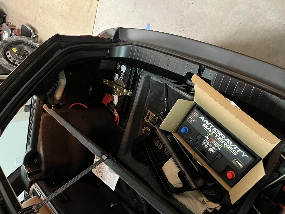

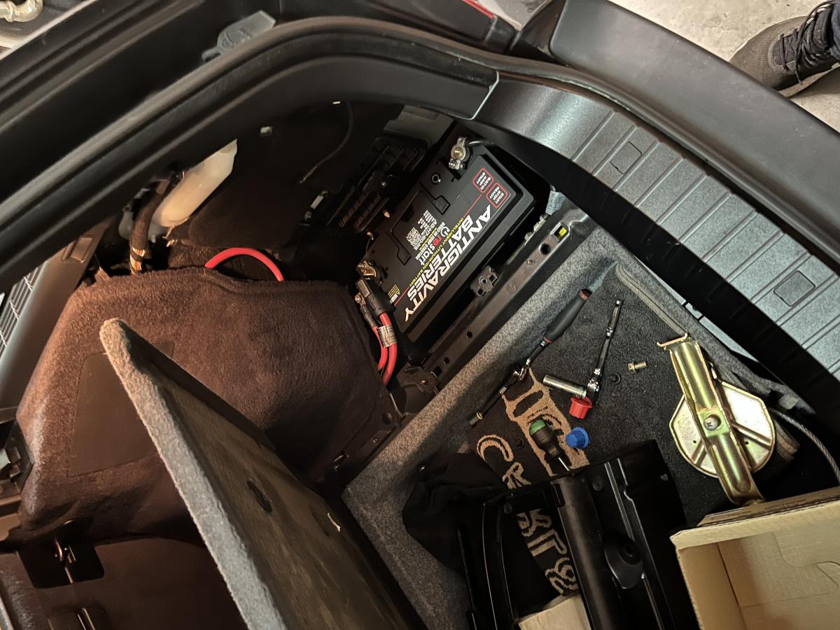

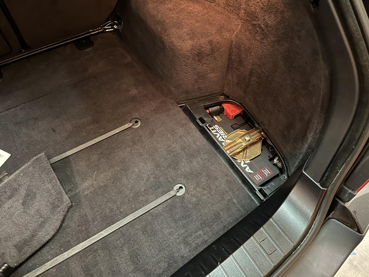

                Antigravity battery measured exactly 30lbs less than the Bosch battery that came out on the bathroom scale. H7/94R size, 60Ah capacity. Currently 3550lb and 48.5/51.5% F/R

                  Wow that nice weight savings! I need to look into those batteries. The tech looks pretty cool. Definitely a premium. i need to recover a little from my build before picking one up lol.
