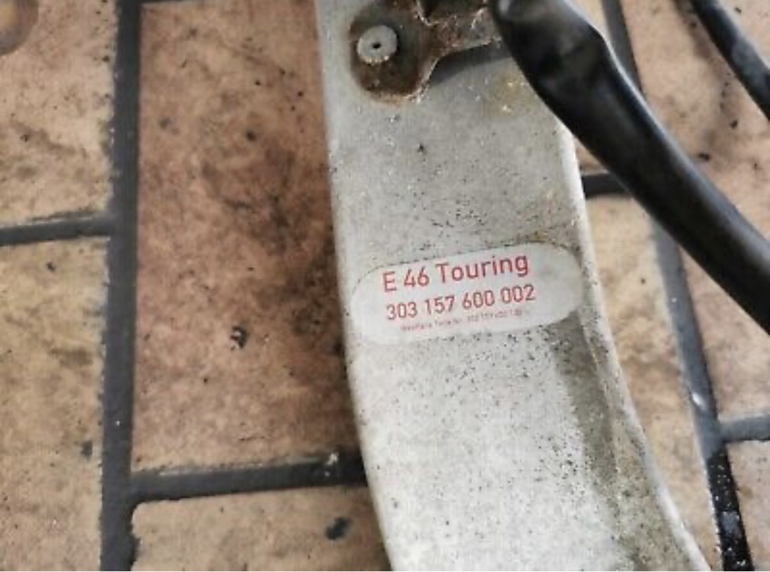

    Careful, the PNs are different between sedan/coupe and wagon. Also don't forget the backing plate that goes in the trunk and sandwiches the rails as well, but that is something you could easily get waterjet and bent with sendcutsend
    Good call. For the record:

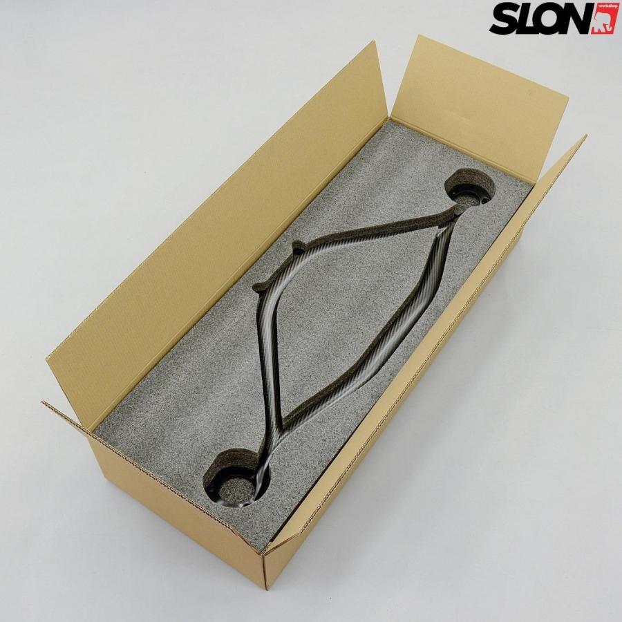

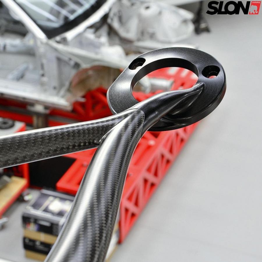

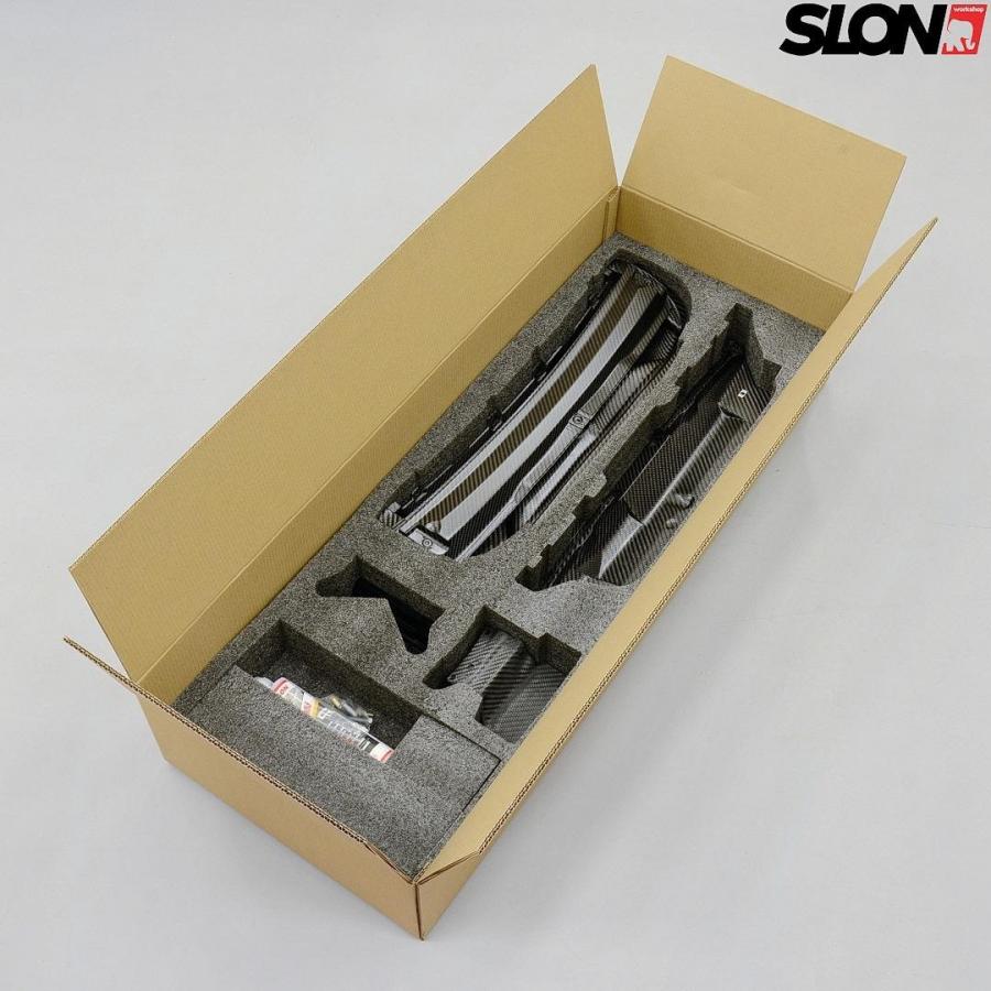

                          Slon just sent me these pics, I had the strut mounts anodized black to be a little more stealthy. Install coming soon!

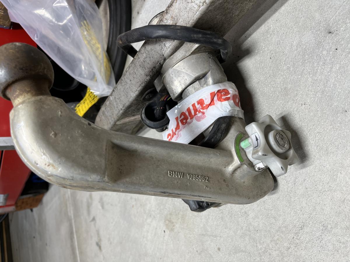

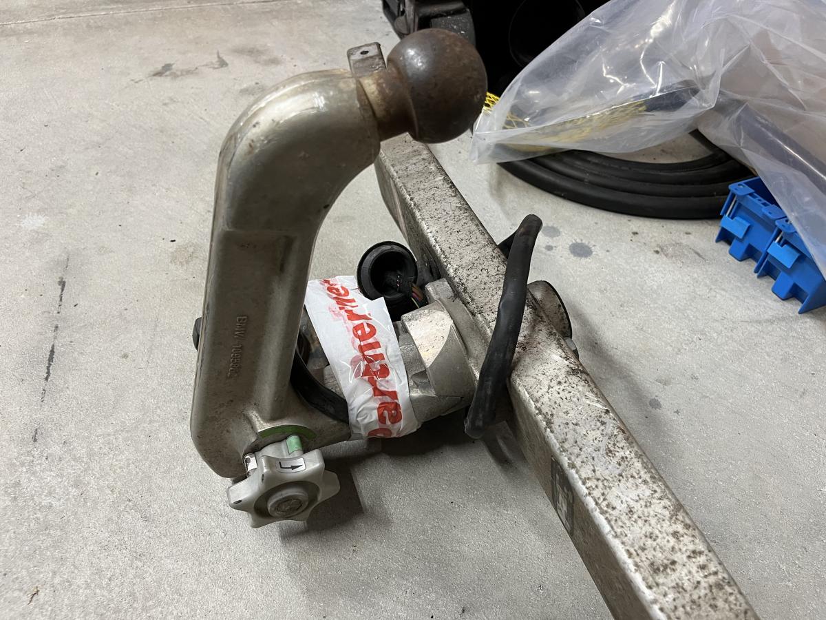

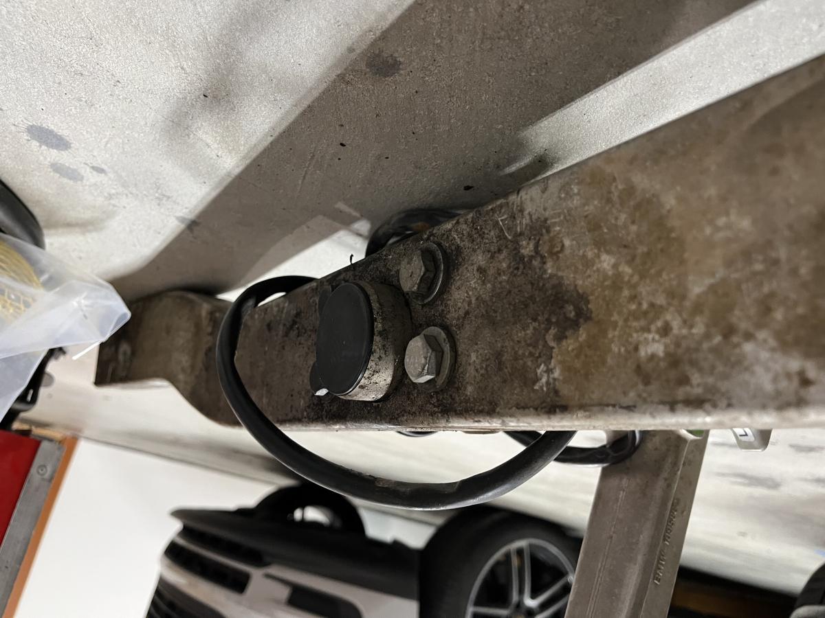

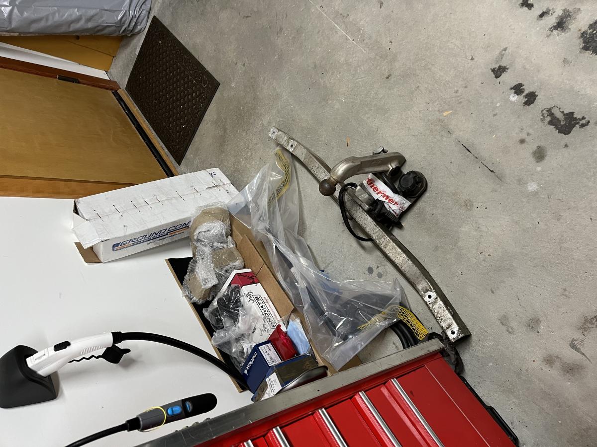

                            Aluminum BMW/Westfalia hitch showed up today - time to clean it up and adapt this to the US stealth hitches design we've got on the Macan
ID:	209977 Click image for larger version

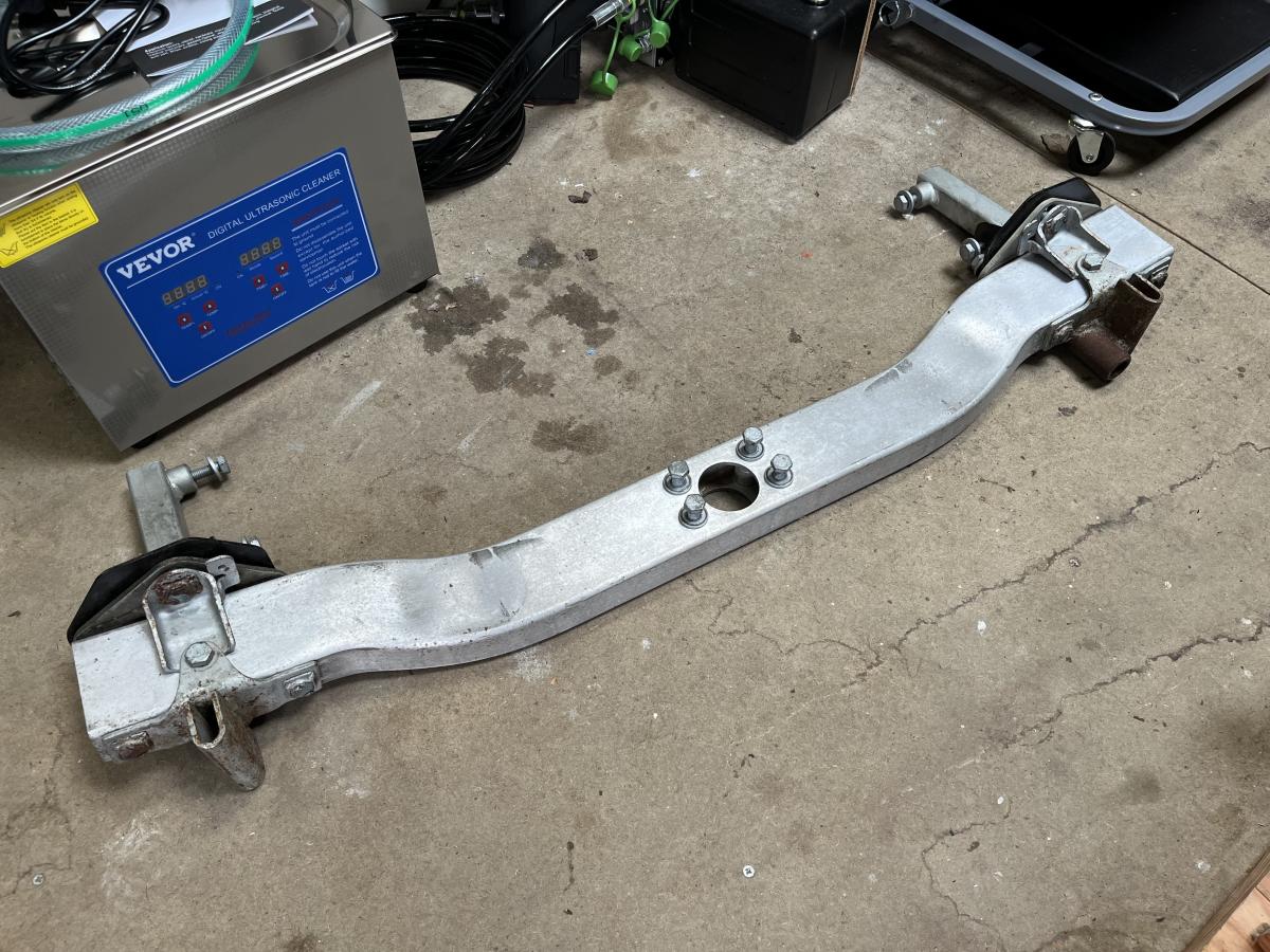

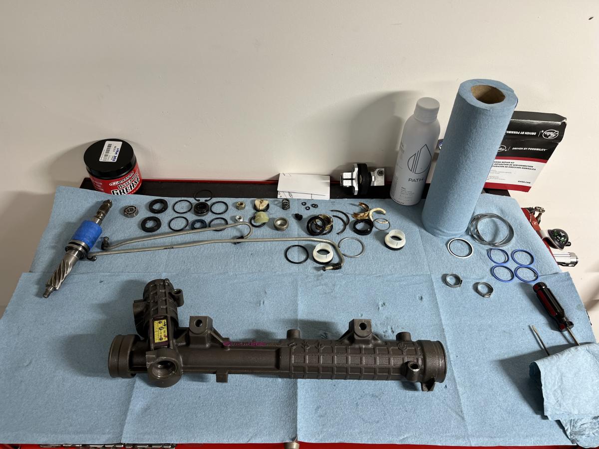

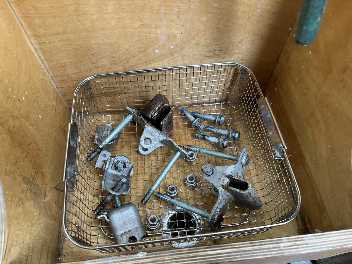

                              #74

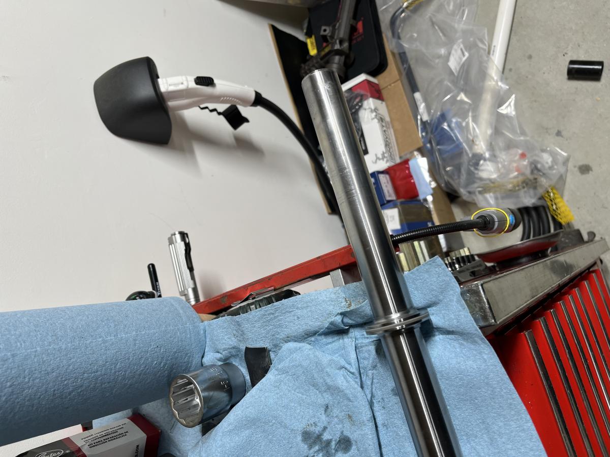

                              Spent a few hours today cleaning up the hitch and dropping the smaller parts in the ultrasonic, then started the rebuild process for the 712 steering rack that's been sitting for months. It's got a little etching, so I'll basically be crossing my fingers that it seals.

                                #75
                                That's great. Where did you get parts to rebuild the steering rack?
