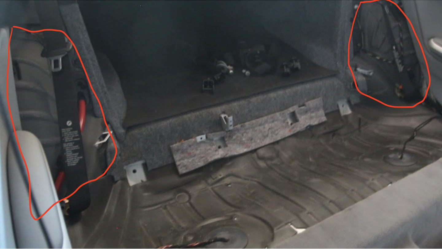

          The sound insulation over the rear wheel arches are separate items and made of the same stuff. In my case they had not degraded and hence didn't have the crayon smell. If yours have then you can buy the new-style items to replace them (realoem quote the part numbers).
          I have a theory that the dense foam in the seat base interacts chemically with the sound insulation that causes it to degrade under the rear seat, as on all the cars I've seen with this issue it's only broken up where it comes in contact with the seat padding.

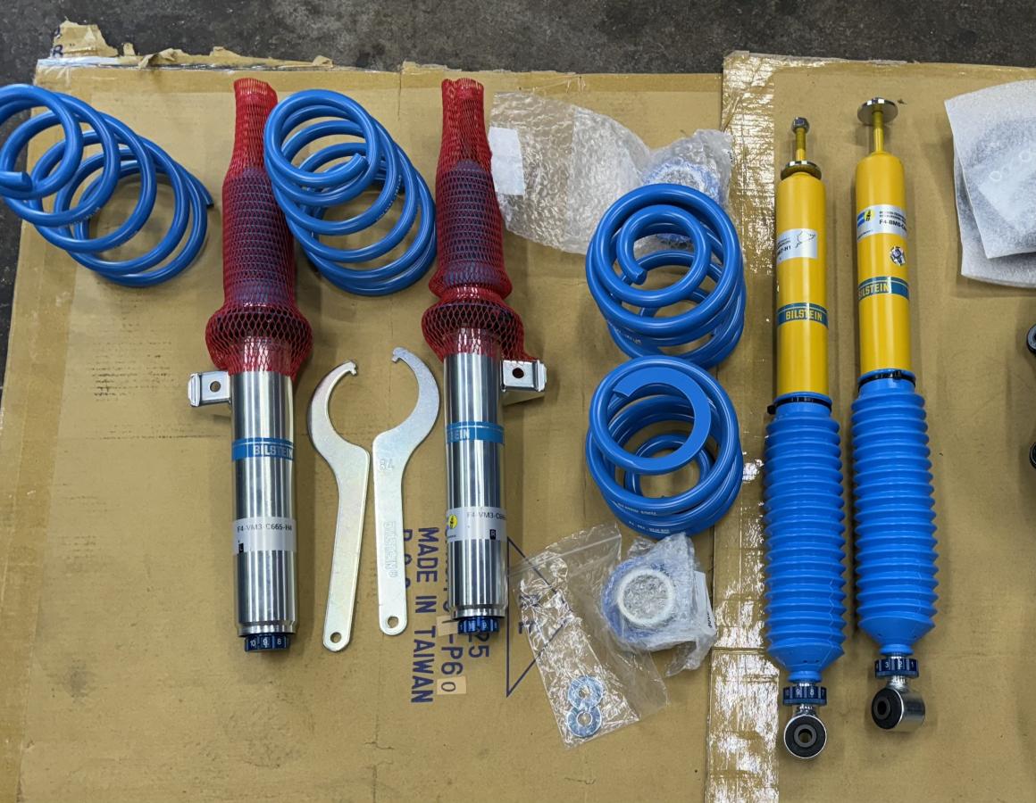

            Falling behind on this thread so time for a monthly update 😂. Made a ton of progress and the car is pretty much done! After getting the interior fully sorted I moved onto the suspension and brakes. For suspension I'm keeping it mostly OE with a couple upgrades. First a new set of coilovers. Wanted to do something different than Rosso so went with a set of Bilstein B16 PSS10 from FCP Euro. Will be interesting to see how these compare to the Ohlins.

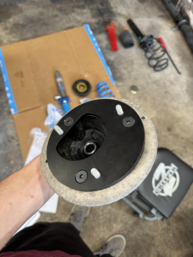

            And stuck with the Dinan fixed camber plates as I like them on Rosso and I know they will fit the CSL wheels really well

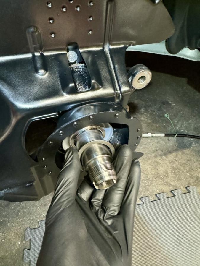

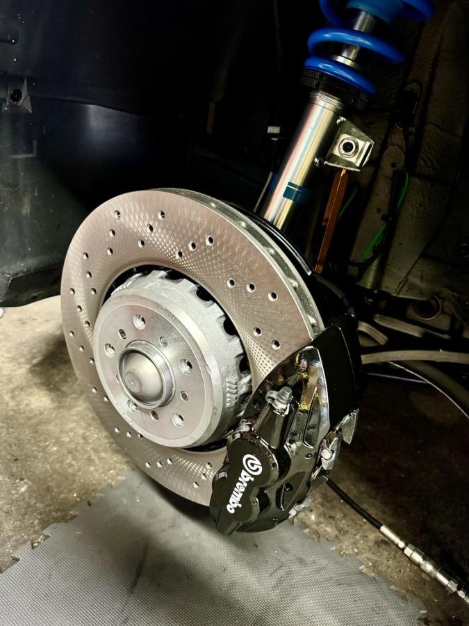

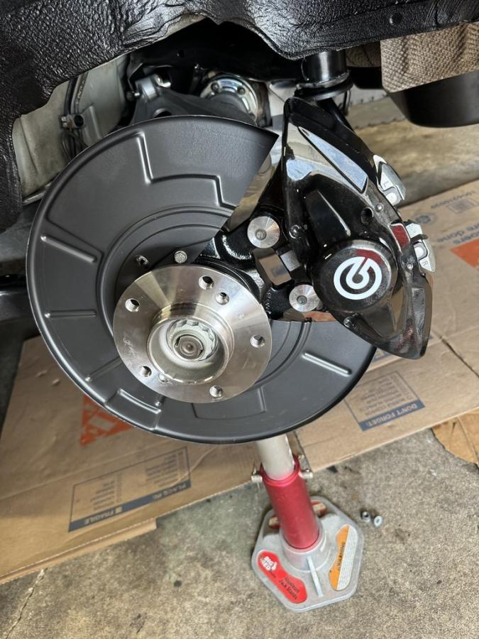

            For brakes I also wanted something different from Rosso, so decided to go with an F80 conversion. FCP sells the OE Brembo calipers for half the price of ///M branded ones! Also used their rotor and hardware kit. There are a couple ways to make these fit including custom brackets and some machining of the calipers. A better option I found is from https://vysgarage.com/ that uses some spacers on the hubs and some eccentric mounting holes in the rear. All bolt on a fully reversible.
            Spacer behind front hub (plus repainted shileds):
            Fronts installed:
            The rears require some dust shield trimming. I was also rebuilding the rear subframe so this was pretty easy with everything apart.

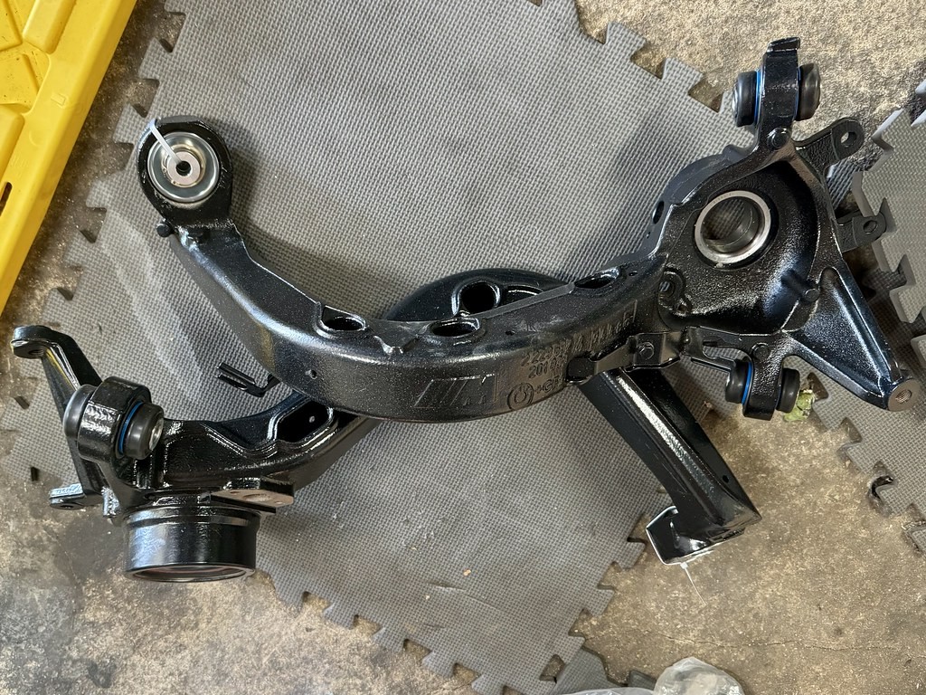

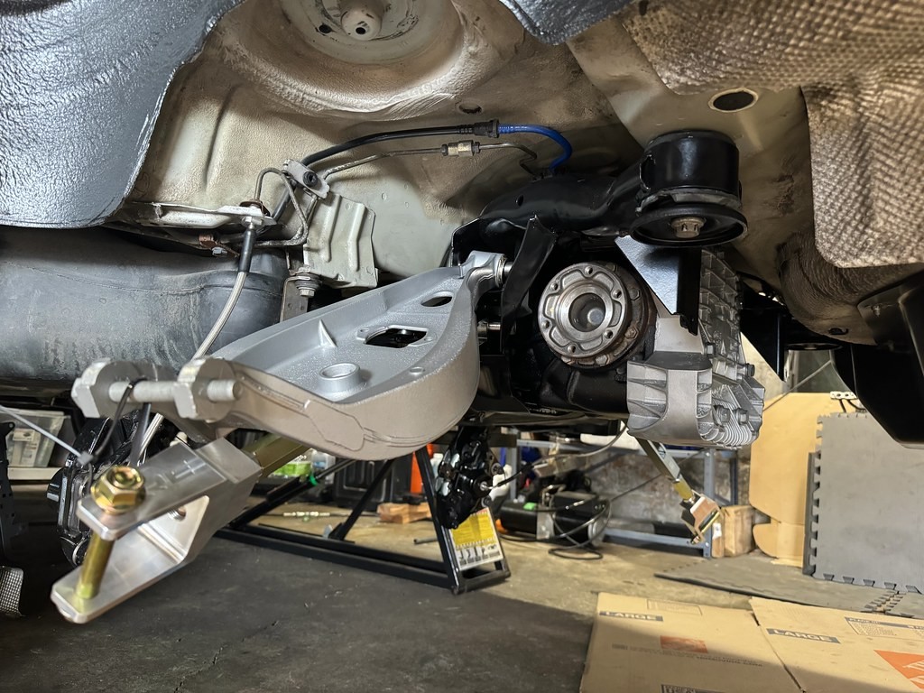

            I already had a rebuilt and new rear suspension ready to go. Subframe, sway bar, trailing arms and upper suspension arms all freshly powder coated. All bushings replaced with OE parts from FCP and Rogue Engineering RTABs and lower control arms. Drive shafts and half shafts rebuilt with new universal joints and boots. Also replaced the brake dust shields, wheel bearings, wheel hubs and parking brake hardware. Diff got a fresh cover, bushings and fluid. I'm not a welder so I'll have Rogue handle that down the road.

              Car looks amazing ! well Done. How do u like the PSS10?
              2007 Imola Red Z4M Coupe
                #82
                So far I'm leaning towards liking them better than the Ohlins! At first I had them too low and the ride was a bit harsh, but after raising them to around 13.5 they seem to be in a sweet spot for street comfort. Need to get them to some twisties and try some firmer settings.

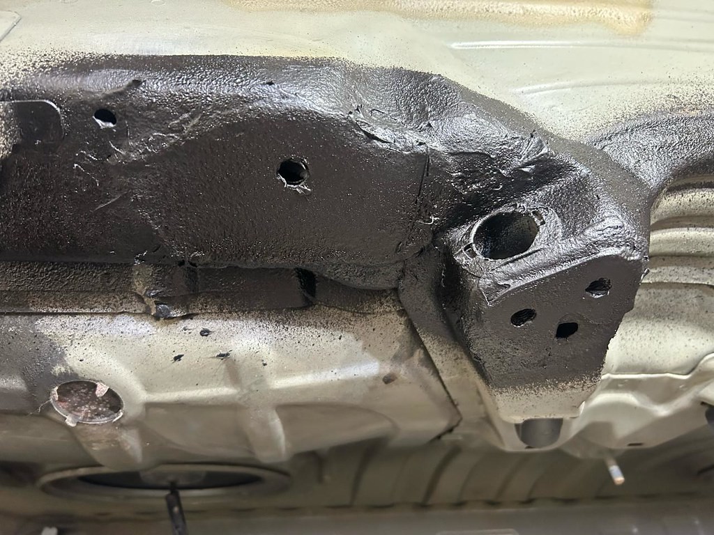

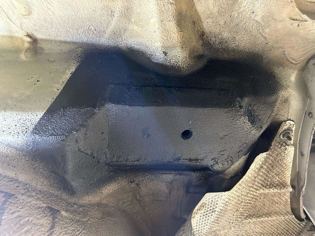

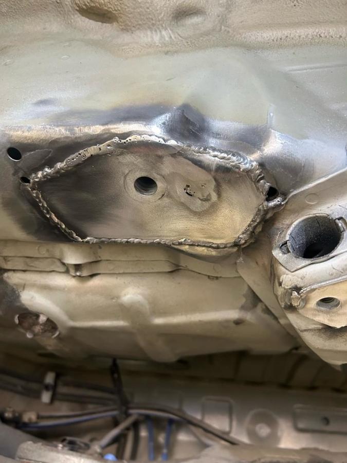

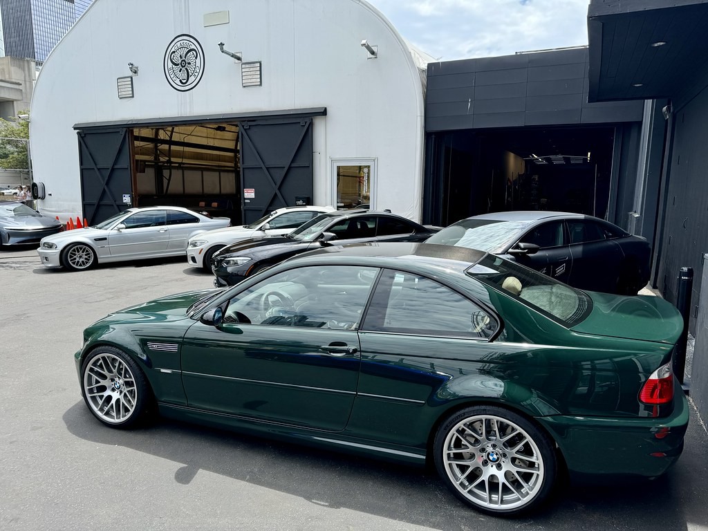

                      Dropped off BRG at Rogue Engineering for the last big item to check off; subframe plates! I dont trust my own welding 😂, so leaving this one to the pros. Ben always has a bunch of cool BMWs at his shop.

                      Welding in the Turner plates:

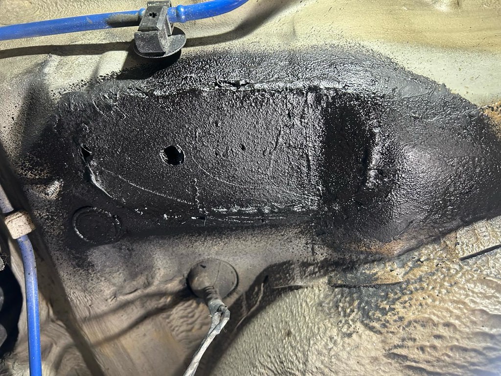

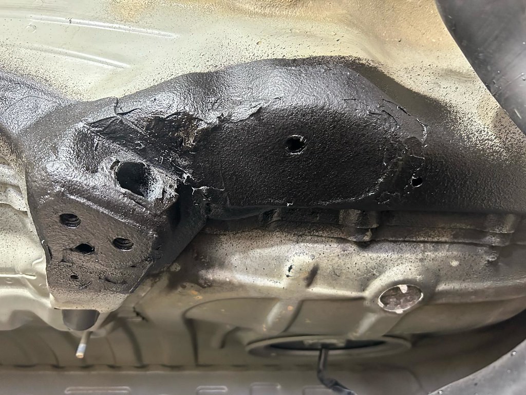

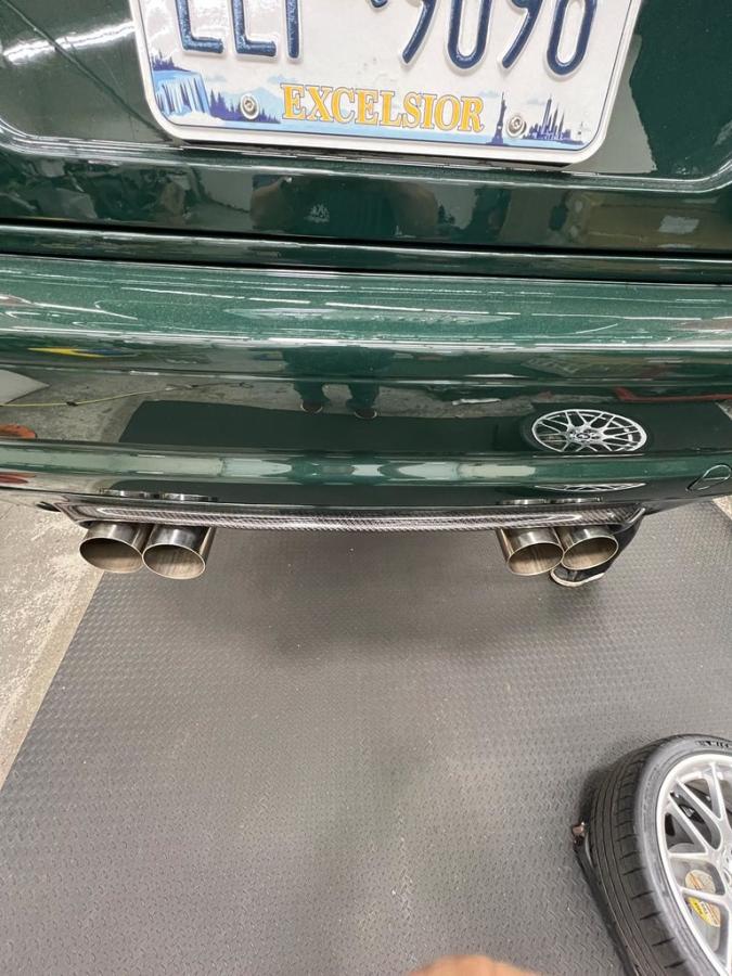

                      with everything back on Ben also got the Diablo CALIENTE Exhaust perfectly aligned.
                        #86

                          Your car is beautiful and love pretty much everything on it except that RACP reinforcement job… You should got bigger plates like CMP/Reddish/Vincebar plates. Also, welds aren’t the greatest (or maybe more the preparation prior welding I should say) and seems like only asphalt gravel guard been applied?
                            #88
                            You have no grounds to make a claim like that Marc. We've seen so few cars have issues with turner plates, and it very easily could have been from contamination (poor job).
                            Furthermore, it's very likely you don't need ANY plates, if you reinforce the mounting points with things like tied in roll cage, Xbrace, front cups, 6 point brace etc.
                              #89
                              I never mentionned issues with Turner plates?? I just said there is better options these days like CMP & Reddish. 15 years ago it was another story.
                                #90
                                Yeah I considered the Reddish plates but decided to stick with what has consistently worked for me. I've had the Turner plates on my track car almost 10 years now and when I did the subframe refresh last year everything looked great.
