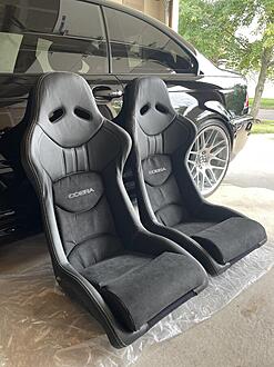

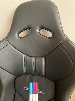

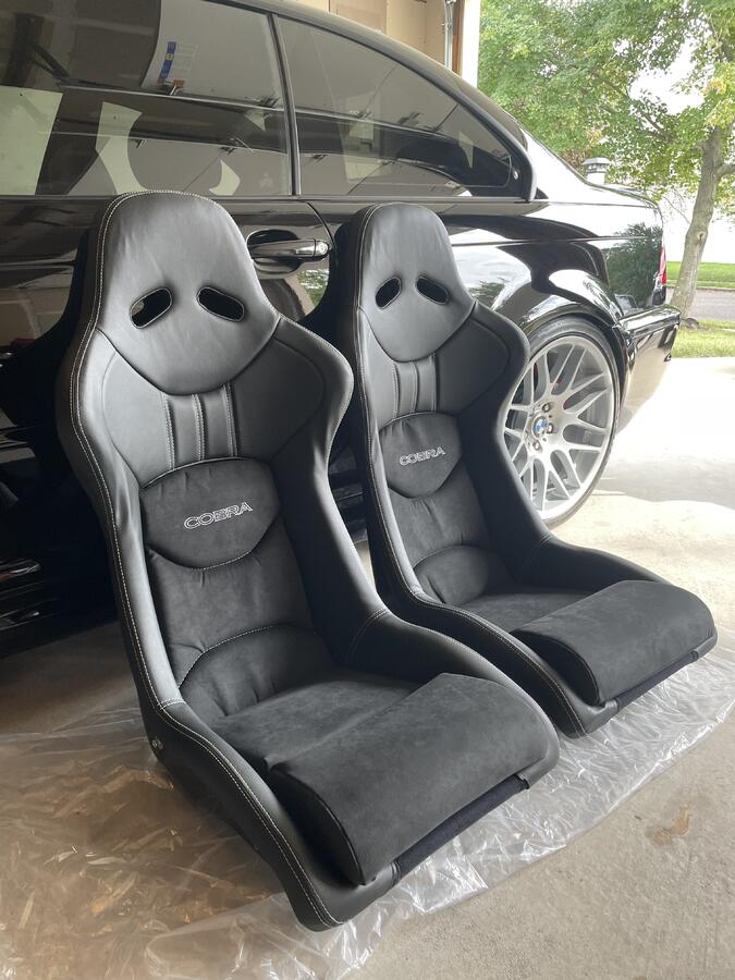

    Seats are here. Had an ETA of 2 1/2 months but they came in 1 month from the UK. Now just waiting on the Brey Krause brackets for installation.

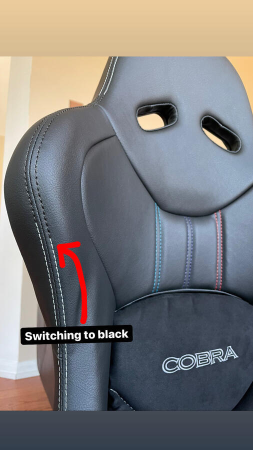

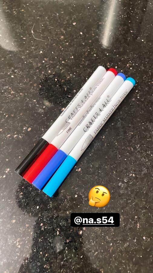

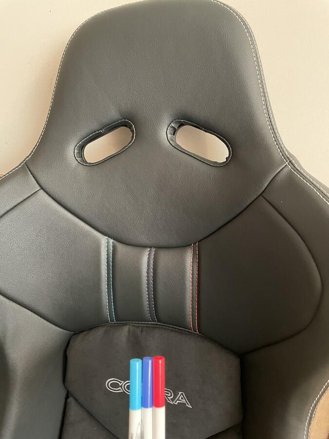

          Since I’m still waiting on the seat mounts I decided to do the Tbonem3 mod

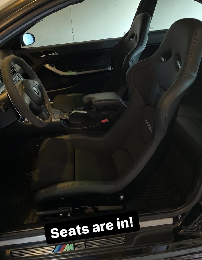

              Seats are finally in. Had to enlarge the rear Bray Krause bracket hole to make them align with the seat. Apparently it’s a problem with the seat and not the bracket itself. But faster to modify the bracket than to get a new seat. Bracket on the f/r has two holes to slightly adjust the seat, on the front I used the top hole and on the rear the lower to have a slight tilt and not be too upright.

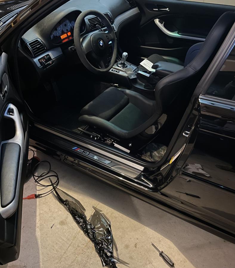

                Finally had a bit of time to start removing the tint.
                Still need to do the quarters and rear. I kinda like how it sits just without the front tint but will completely remove since I hate how the matrix dots look on the rear glass. Will probably be installing a super light tint 50%+

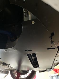

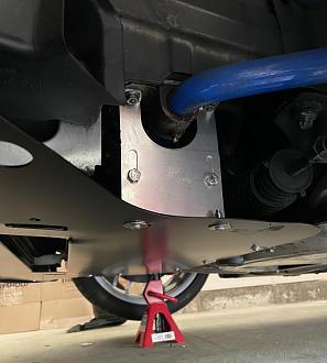

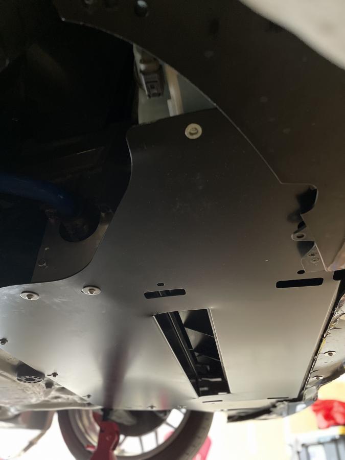

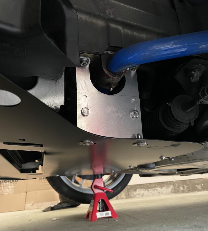

                  New belly pan from IG: pow3r_motorsport
                  Went this route bc it has the oil cooler cut-out!
                  Excuse the dirty suspension.

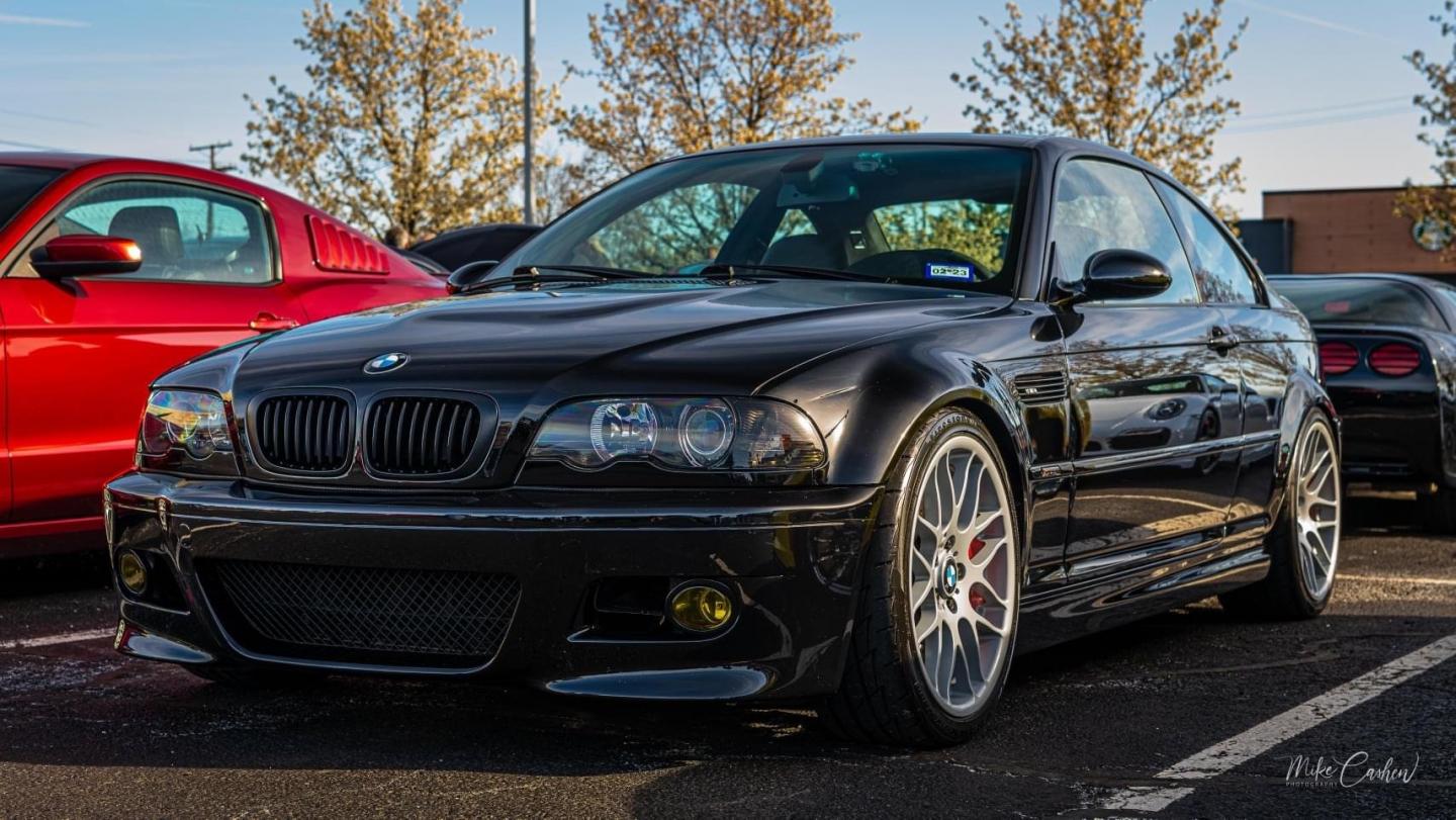

                    Pic from cars and coffee here in South Jersey

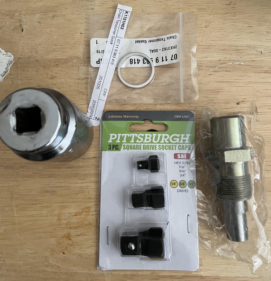

                      While I was installing the belly pan I noticed oil was running down from the timing chain tensioner. End up ordering a new one along with the washer. Recently I noticed a small ticking noise from the engine when cold, would go away within a min or so. Well this also end up solving that issue. (Drive socket caps made installation way easier)
