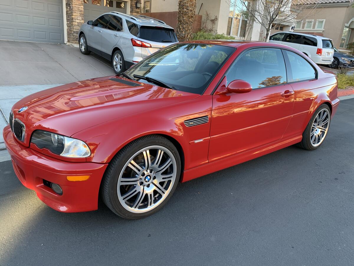

    I’m back in the E46 game again. #4 M3 but #3 E46. Picked up an Imola 6MT locally yesterday. 114,750 It’s mostly stock with the exception of a few items. Front lip, K&N, springs, Auto Solutions SSK, and vinyl wrap. Cali and Nevada car so its 100% rust free. It needs a deep clean inside and out plus some refreshening.
    Any YES, the black wrap is already being removed!! I’m taking it back to stock with the exception of Koni yellows and Dinan springs.
    It has enough miles that its time to do a lot of maintenance. I am parking it till I can get it up to my standard. Here is what I’ve done since bringing it home.

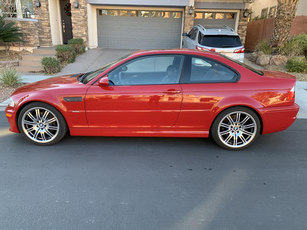

    After:

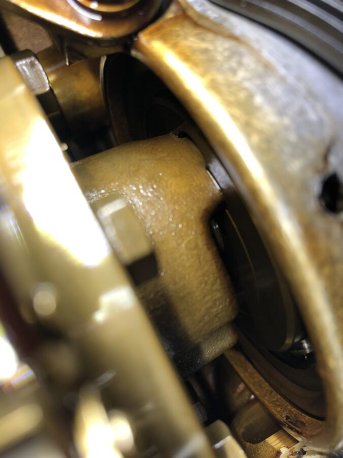

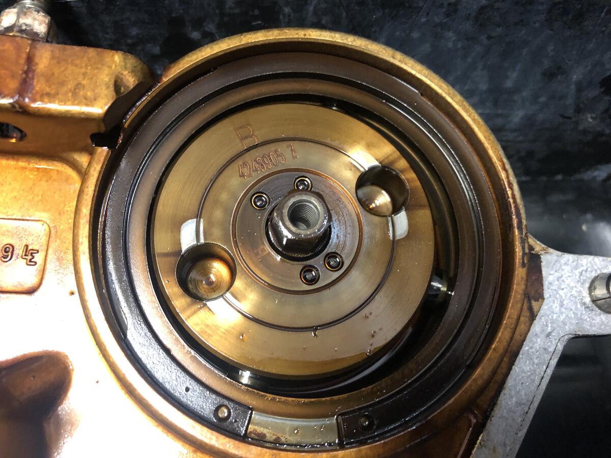

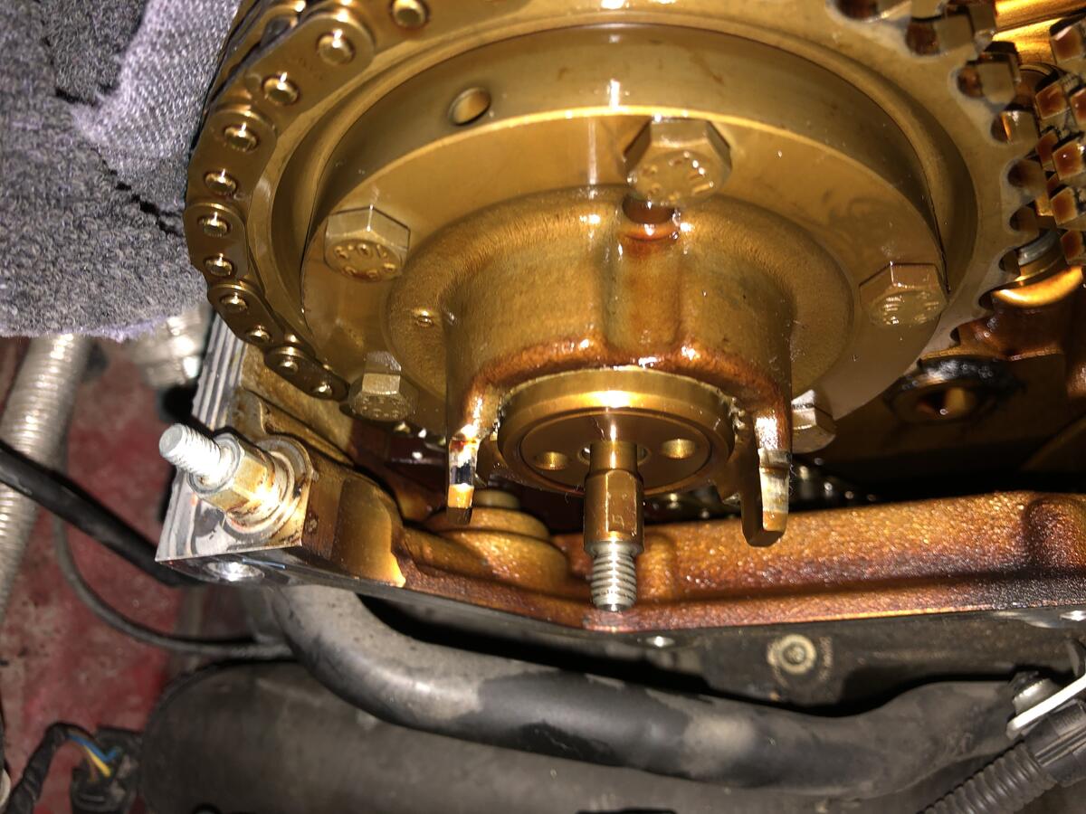

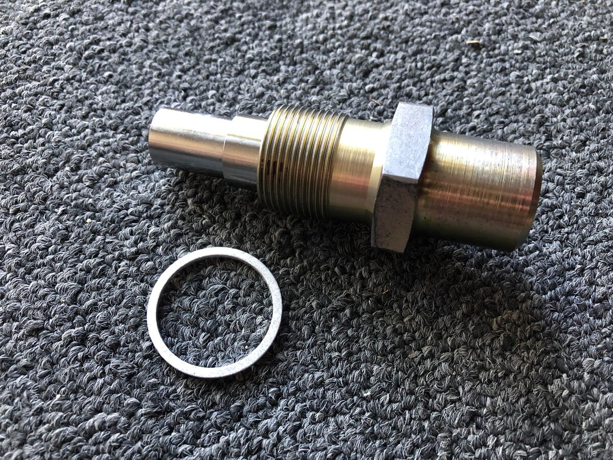

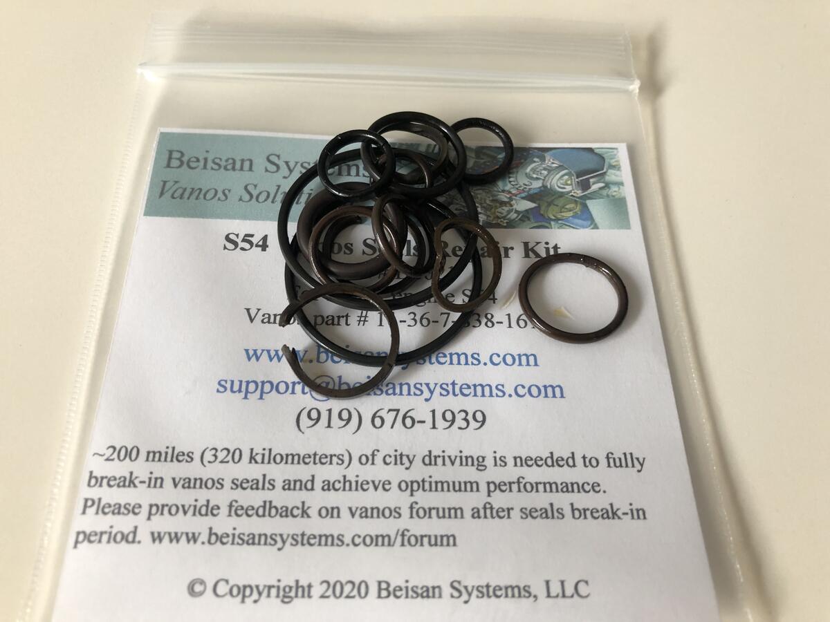

    First up, Vanos inspection and upgrade before it grenades on me! 115k, both tabs intact! Saved $500!
    Ordered Beisan upgrades, just waiting for shipment.

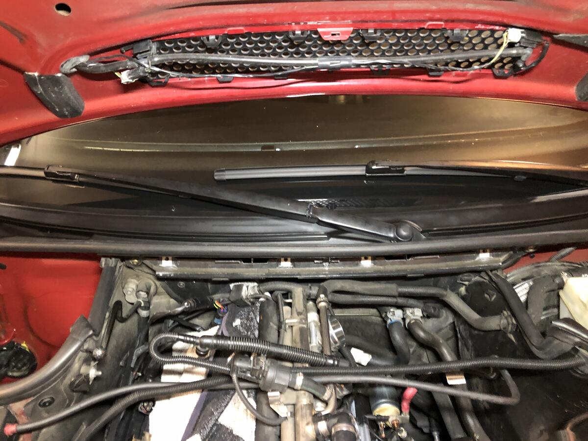

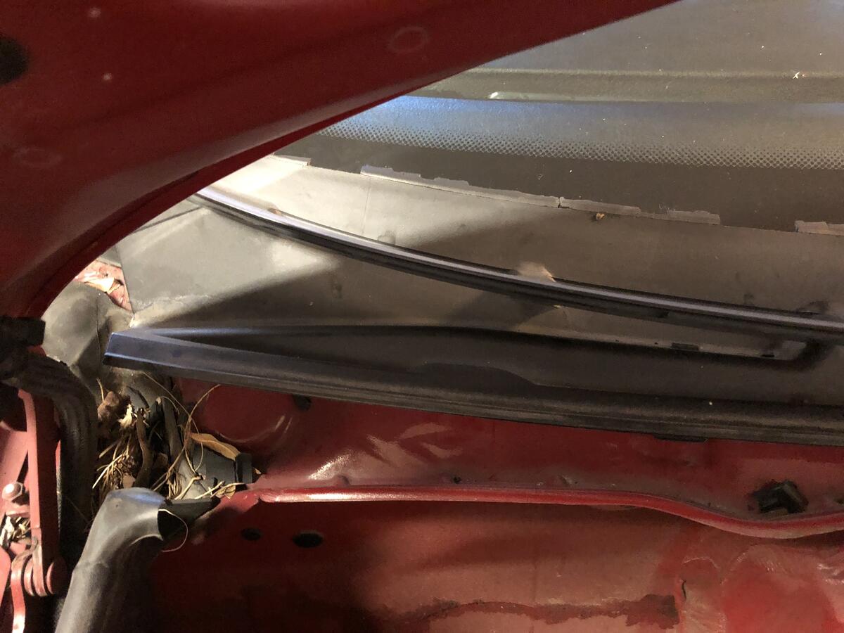

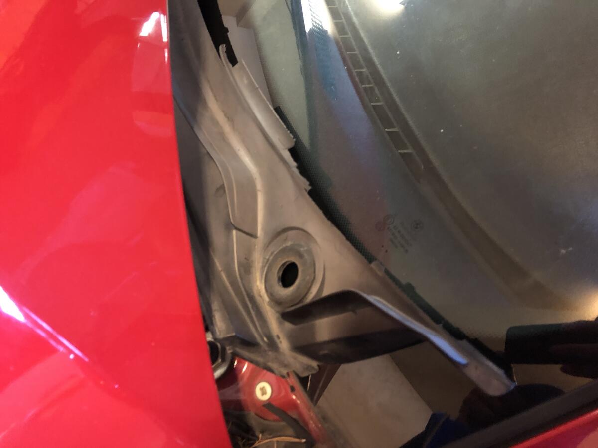

            The cowl, a few trim bits underneath it and the wipers needed to be replaced. Knocked that out along with some new wipers. I went BMW brand as the Bosch equivalent do not seem to last.

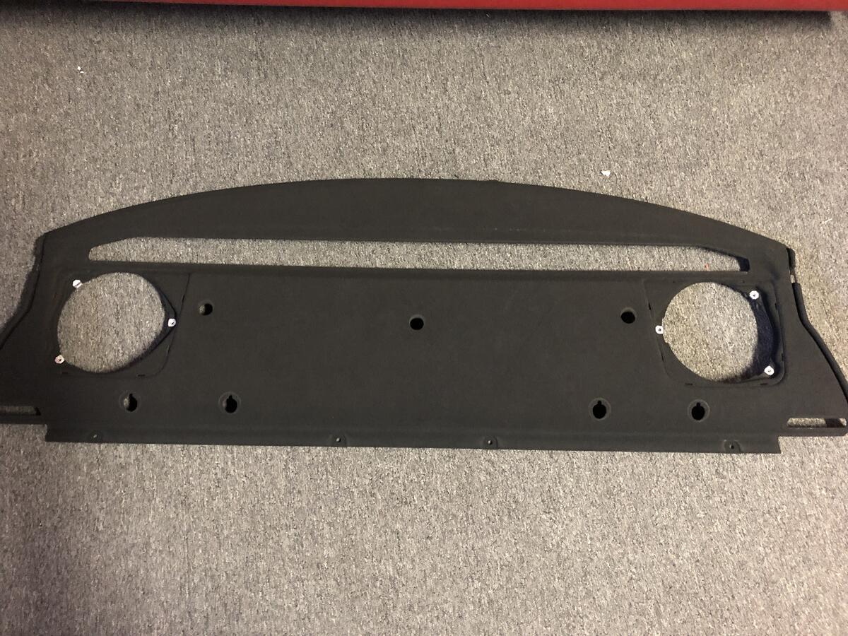

                The parcel shelf looked okay but after removing the tint, you could really tell it was faded. Nothing some spray dye can’t fix. I used this brand before and it works great.

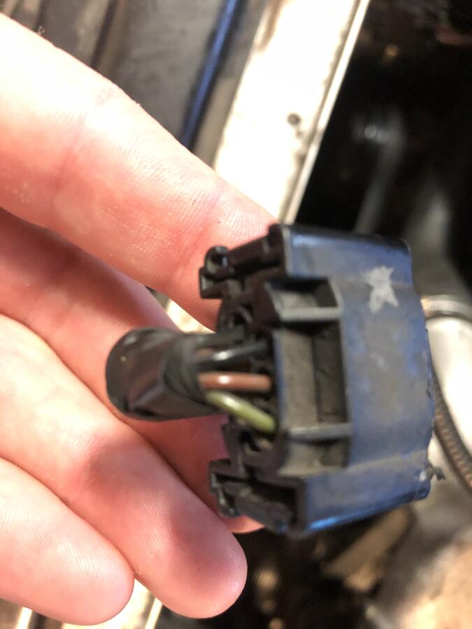

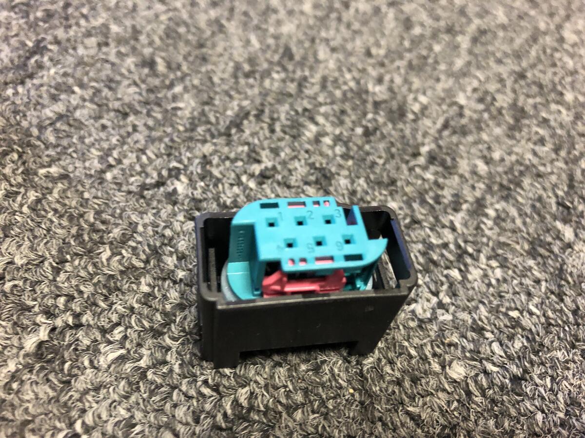

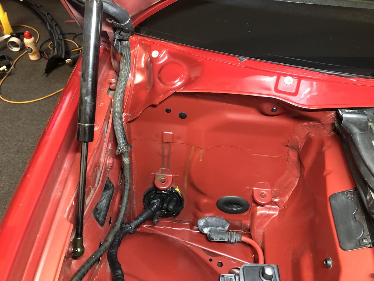

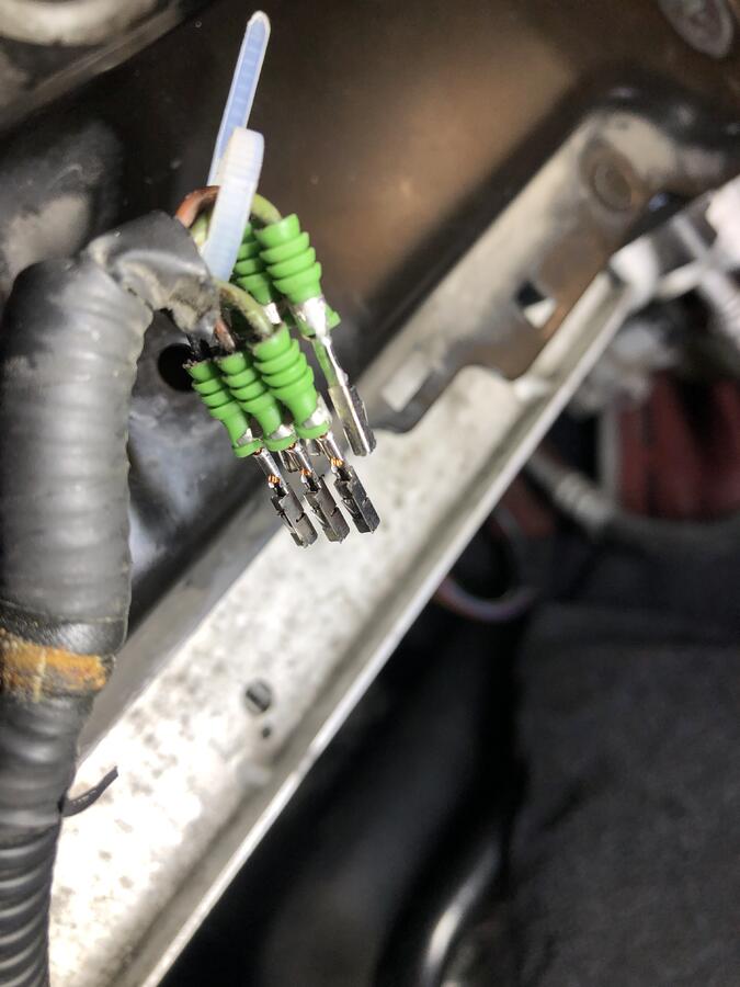

                  I swear its impossible to remove a Vanos electrical connector without breaking one of the tabs. Happened again!? Switching it out wasn’t too bad.

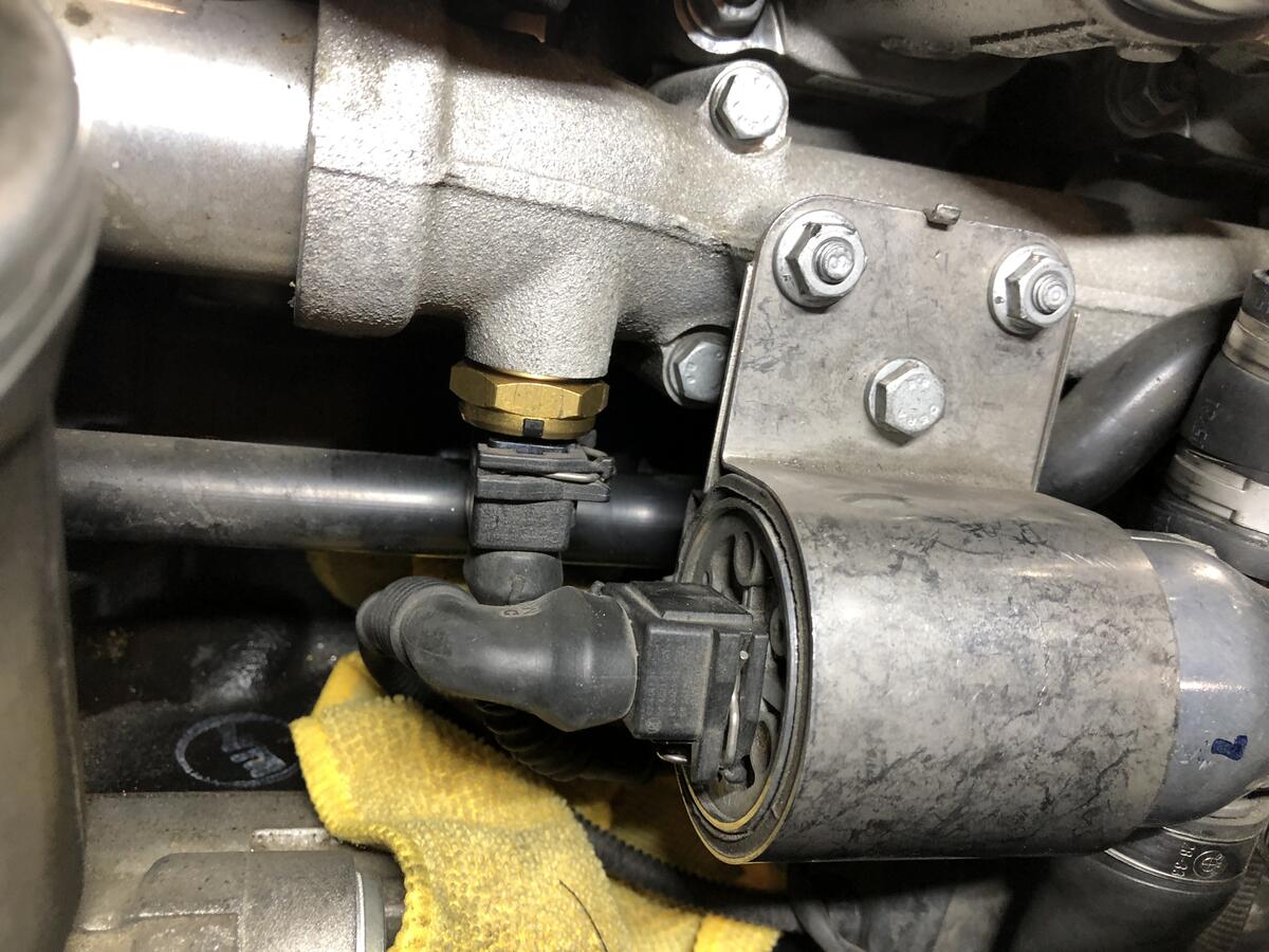

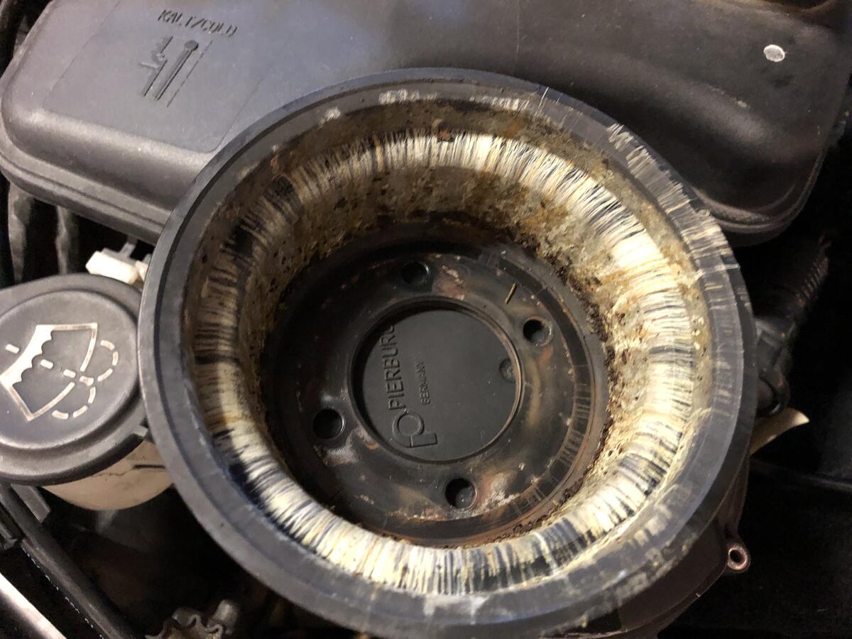

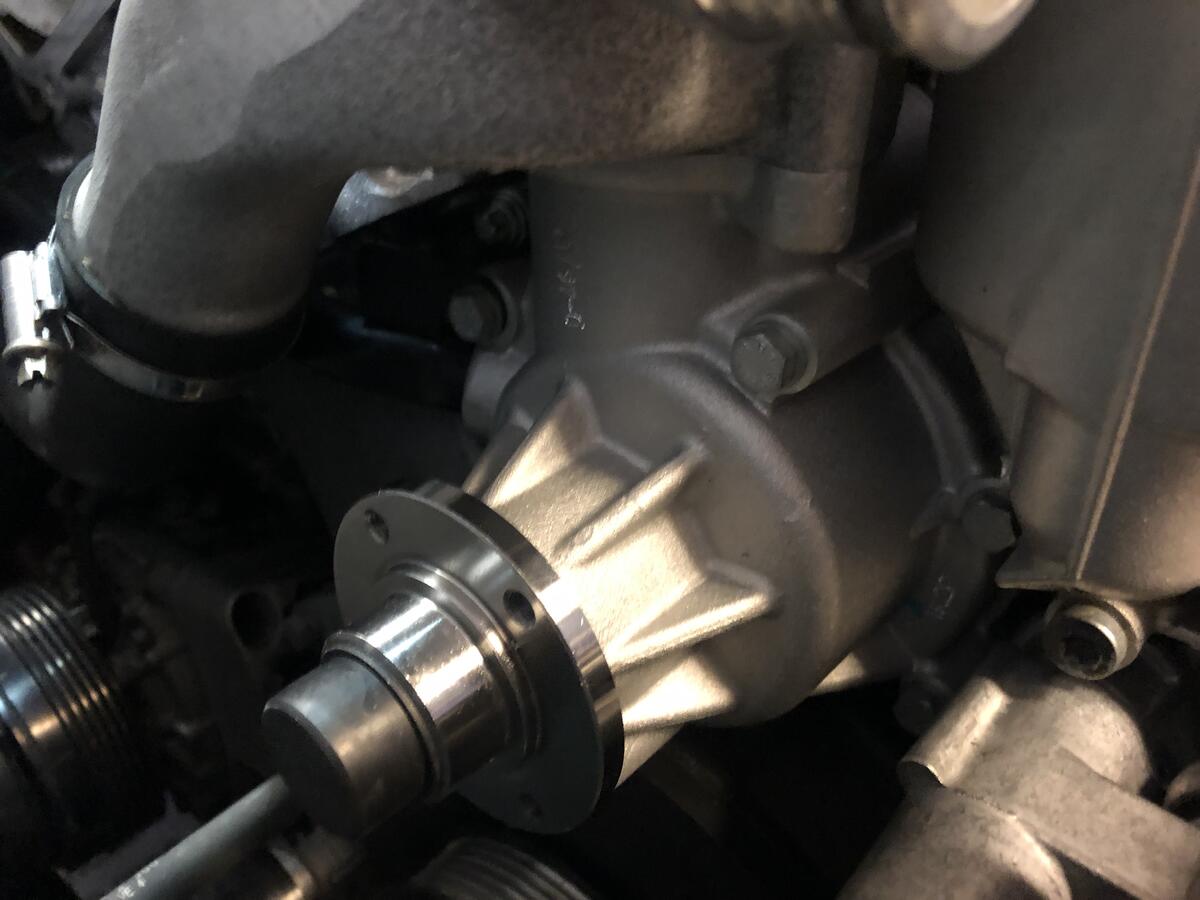

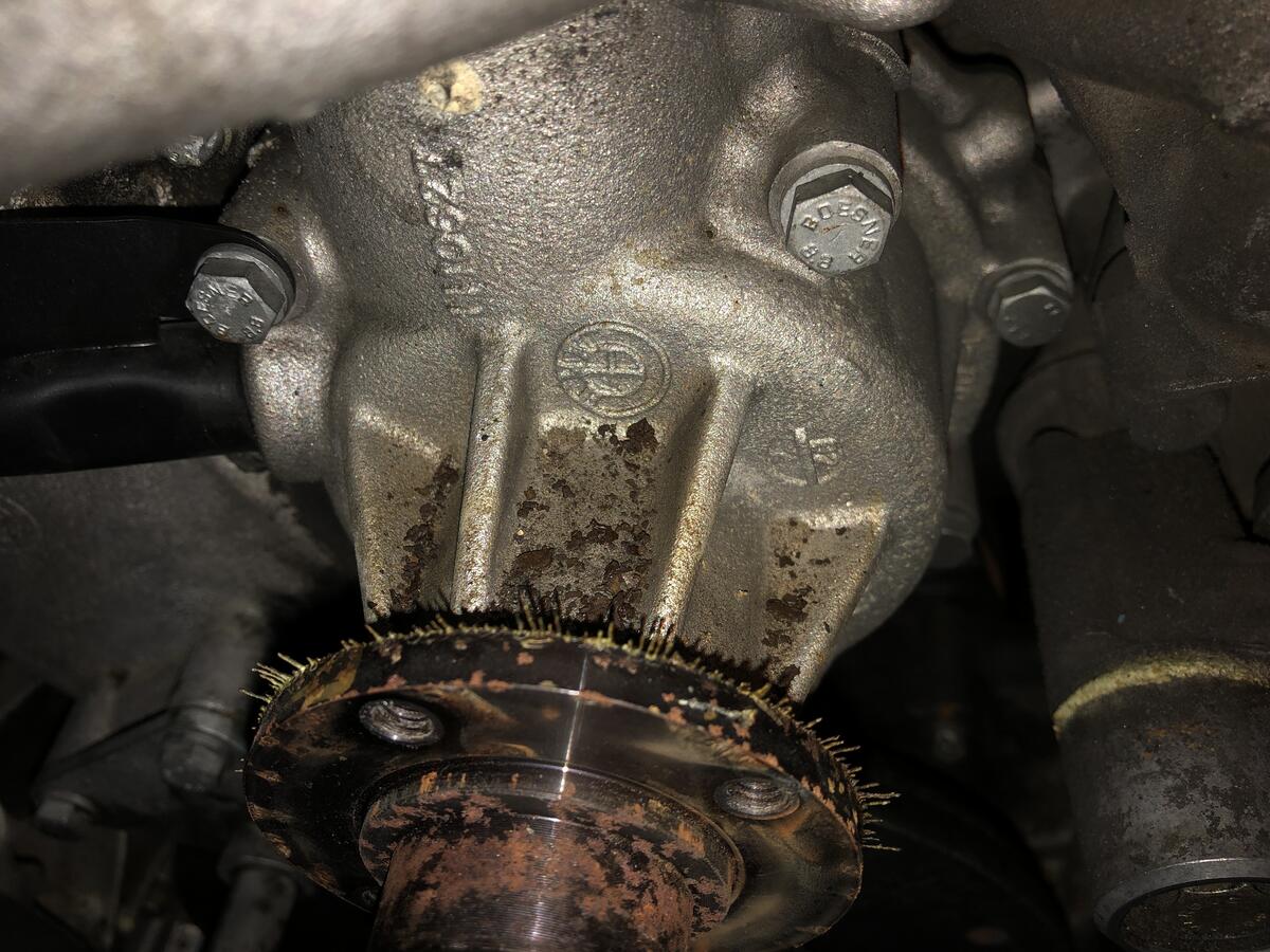

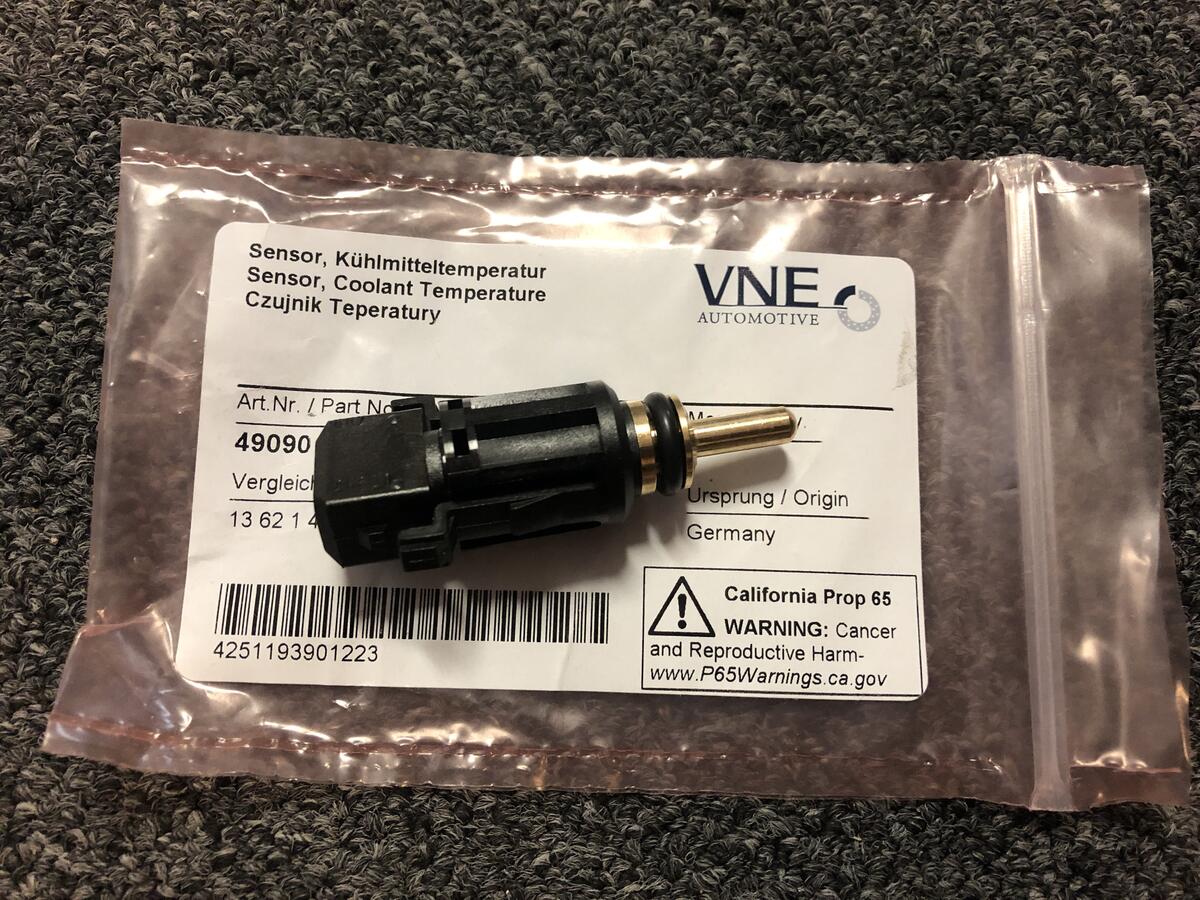

                    The fan guard had the signs of dried coolant and when I removed the pulley it was pretty bad. The water pump was the original with a 2005 manufacturer date. The bearings were shot.
                    I replaced the temperature sensors along with the water pump. I throughly flushed the old coolant out with a cheap harbor freight pump and distilled water. It worked really well. I stuck the tubing in each of the passages and flushed till it ran clear.

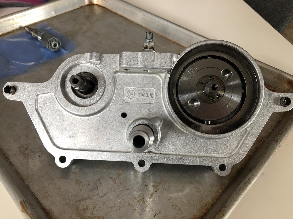

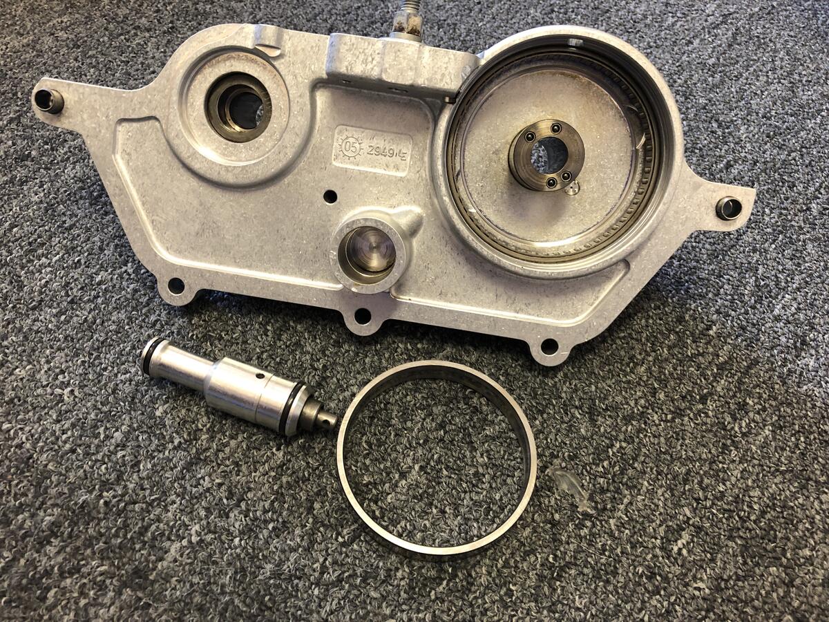

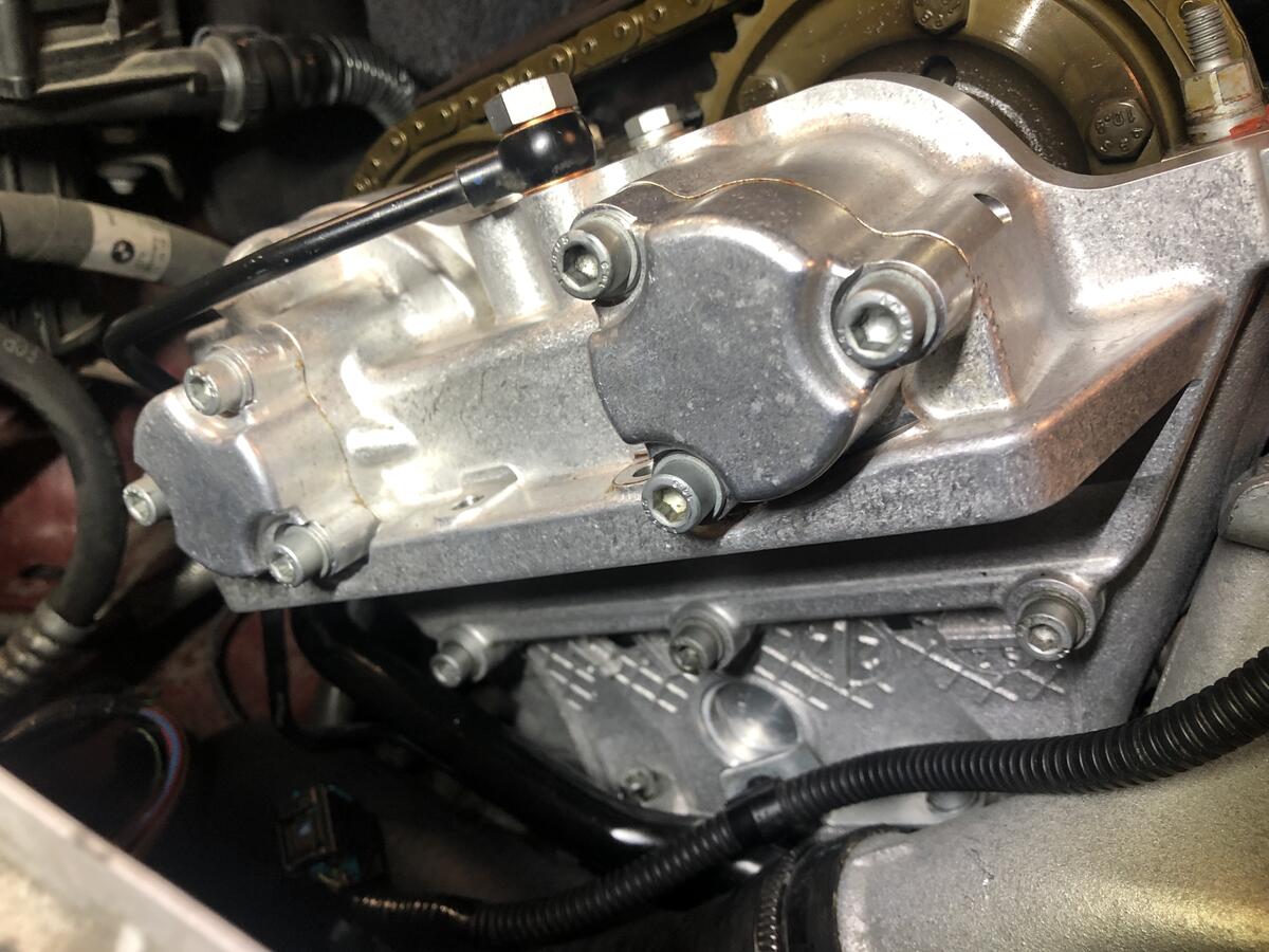

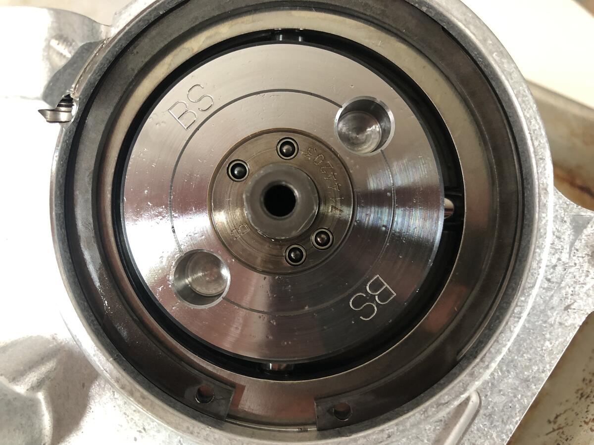

                      Vanos cleaned, installed updated Beisan seals and pump disc. I mounted up the unit but can’t seem to find my magnets to finished cleaning the solenoid block. Got to run out in the morning to pick one up. Hopefully I will have it back together tomorrow.

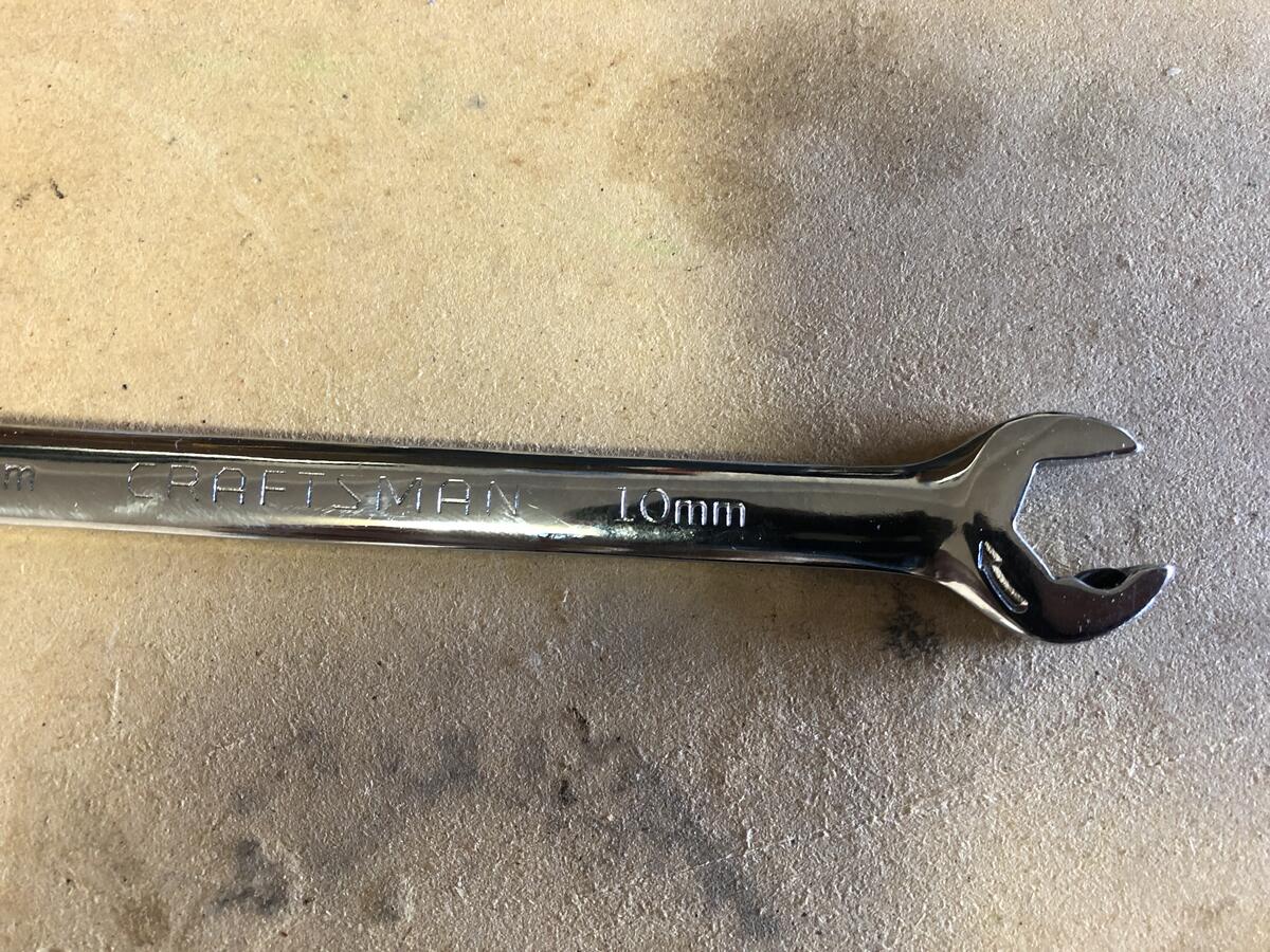

                        I forgot to add this to the Vanos install notes. This wrench is awesome. I got it off the recommendation from someone on M3F. It made removal and install of the unit from the splined shafts super quick and easy. Also less chance of dropping the tool.

                              It’s really easy to pull the back shelf out. There are a few DIYs out there but this one outlines the steps. If you have questions, let me know.
                              I bought my car back in December and when I bought the car it had no tint so the rear deck panel faded to a blueish color. Today I finally decided to remove and re-paint the panel but I could not find a good DIY so I figured I would type up my quick version. Below I will attach a few photos of...
