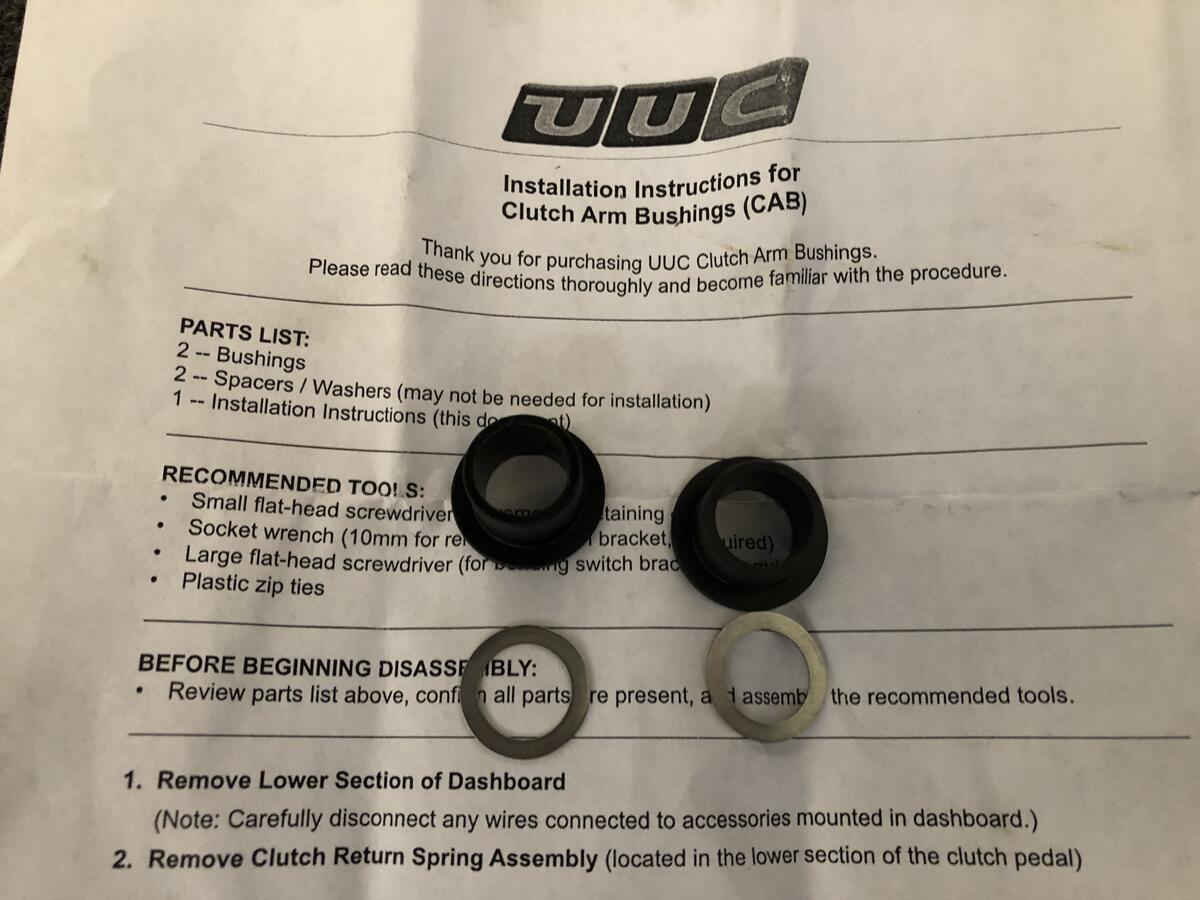

    Replaced the clutch bushings with UUC.

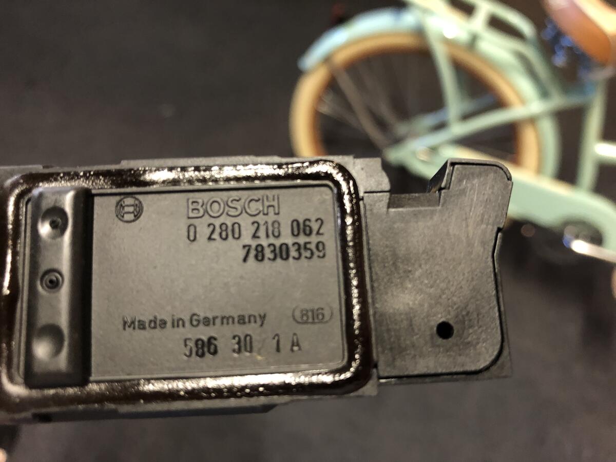

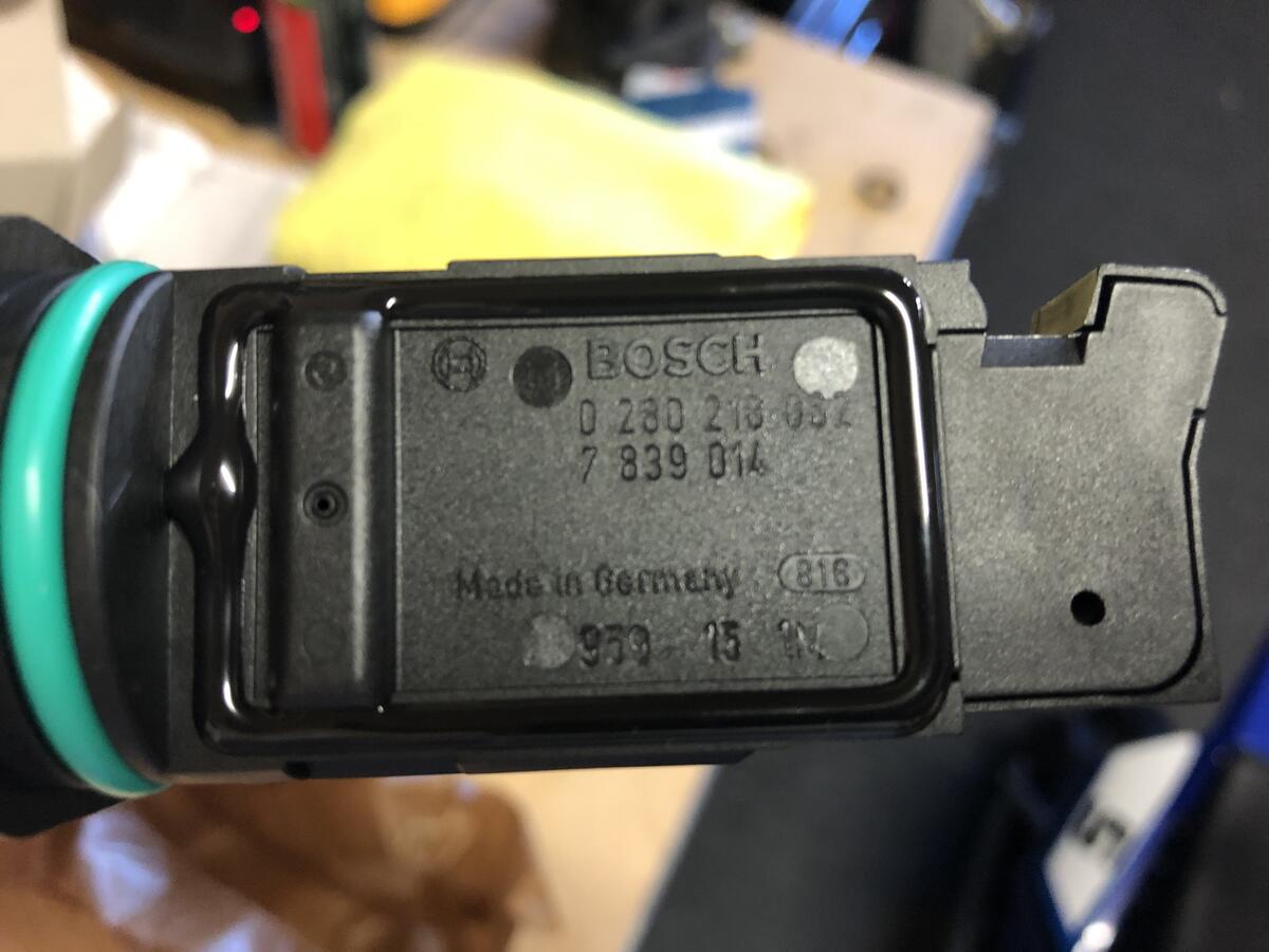

      MAF swap couldn’t hurt. The previous one was unknown age but when I removed it, it wasn’t branded BMW, just Bosch. Are there dates?
      Click image for larger version  Name:	D0A4C198-9ADB-40A0-8CE0-973F4DD64D56.jpeg Views:	0 Size:	68.1 KB ID:	58829
      New one
      Old one

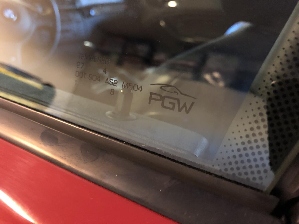

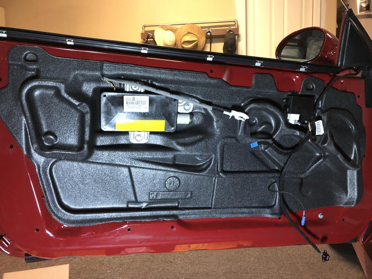

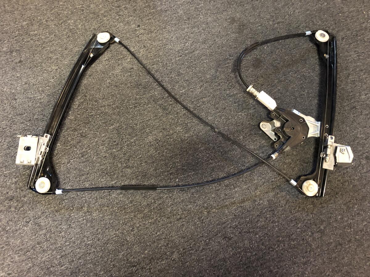

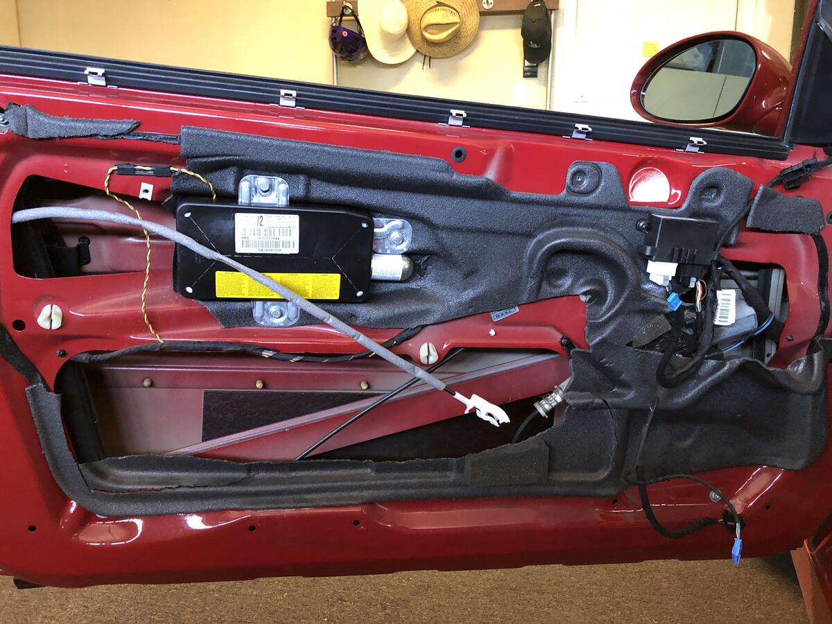

          Knocking out a project that was on the back burner for a bit. When I got the car I noticed the driver side door glass was not BMW and the window went up slow-ish. Nothing on carfax. There was a nice gash on the trim where it appears the glass didn’t drop and when the door was slammed closed, it shattering the glass...maybe.
          I will be replacing the door glass to BMW, the regulator with BMW since the OE isn’t available and the foam vapor barrier since the original was trashed (probably from the shop replacing the glass the first time).
          Lazy installer mangled the foam, will be replacing this

          Removing the old glass first

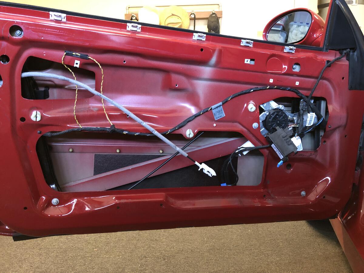

          Old regulator out
          New regulator going in

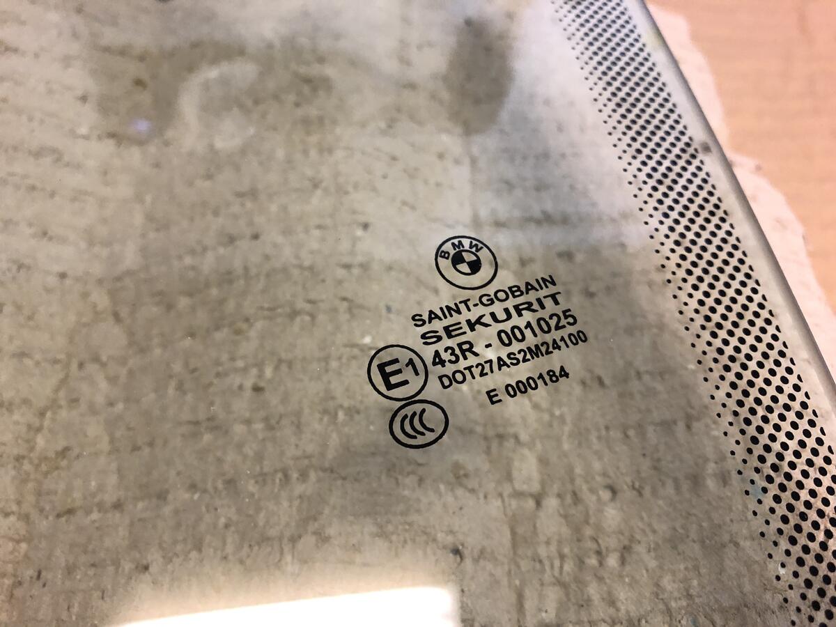

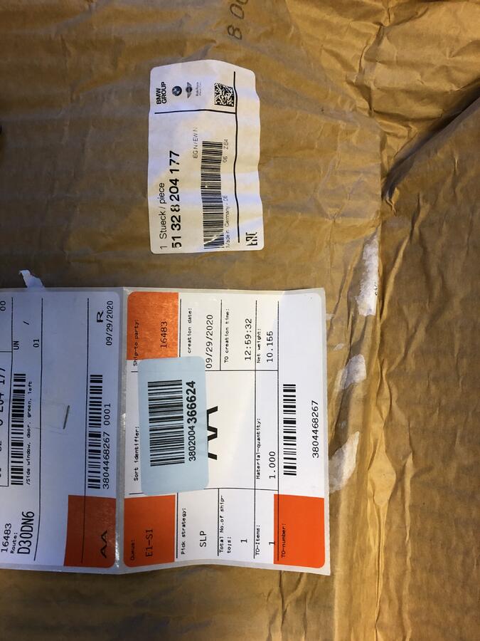

          I ordered the glass online and came well packed. The glass was pretty cheap otherwise I would have left it.

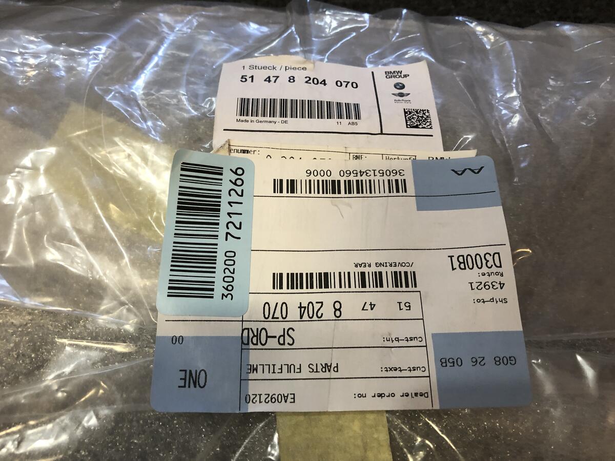

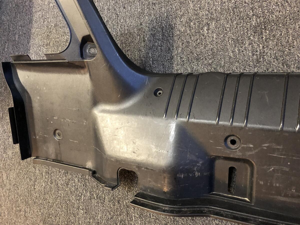

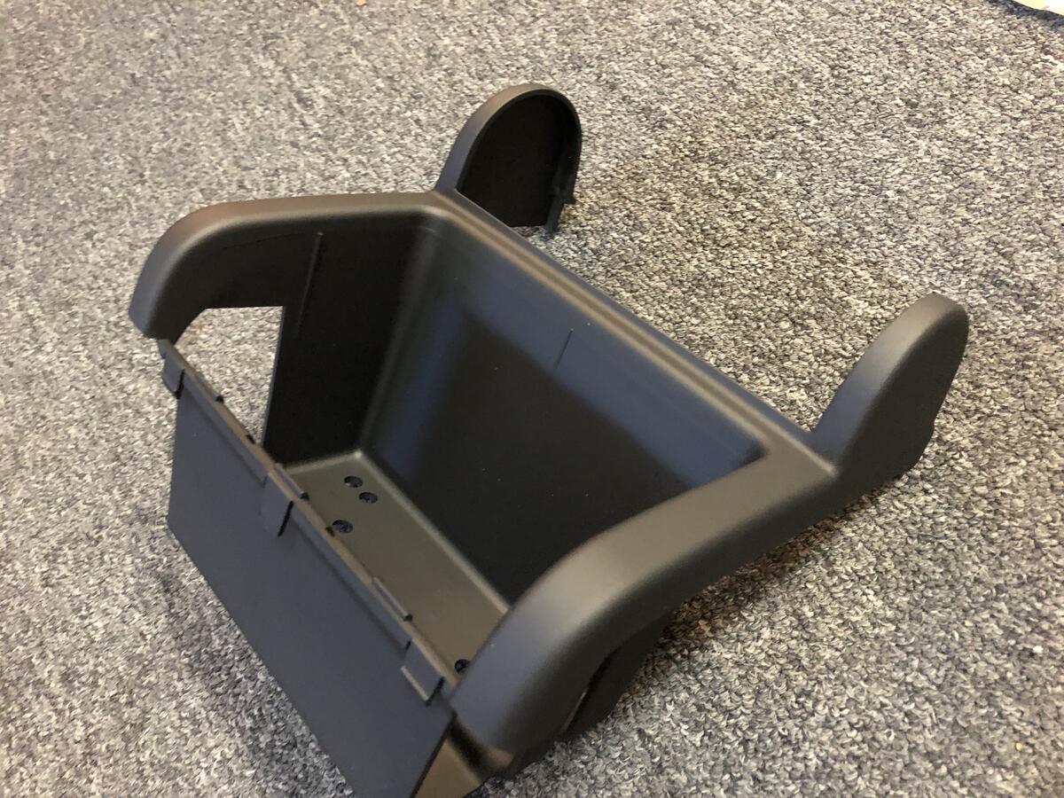

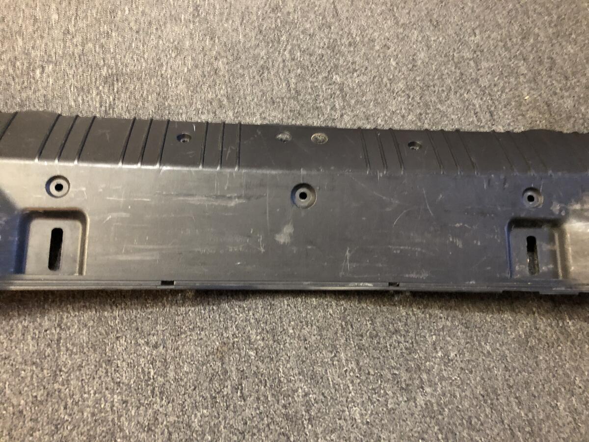

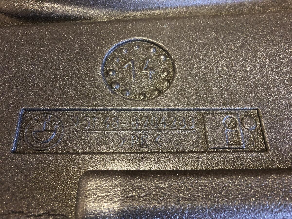

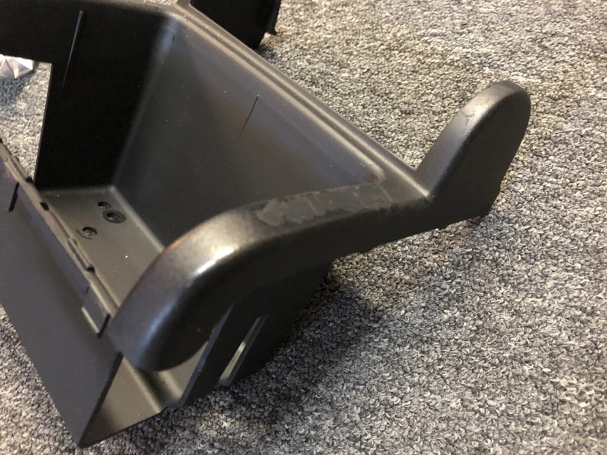

              More odds and ends I needed to clean up. Mostly inexpensive and easy things to fix.

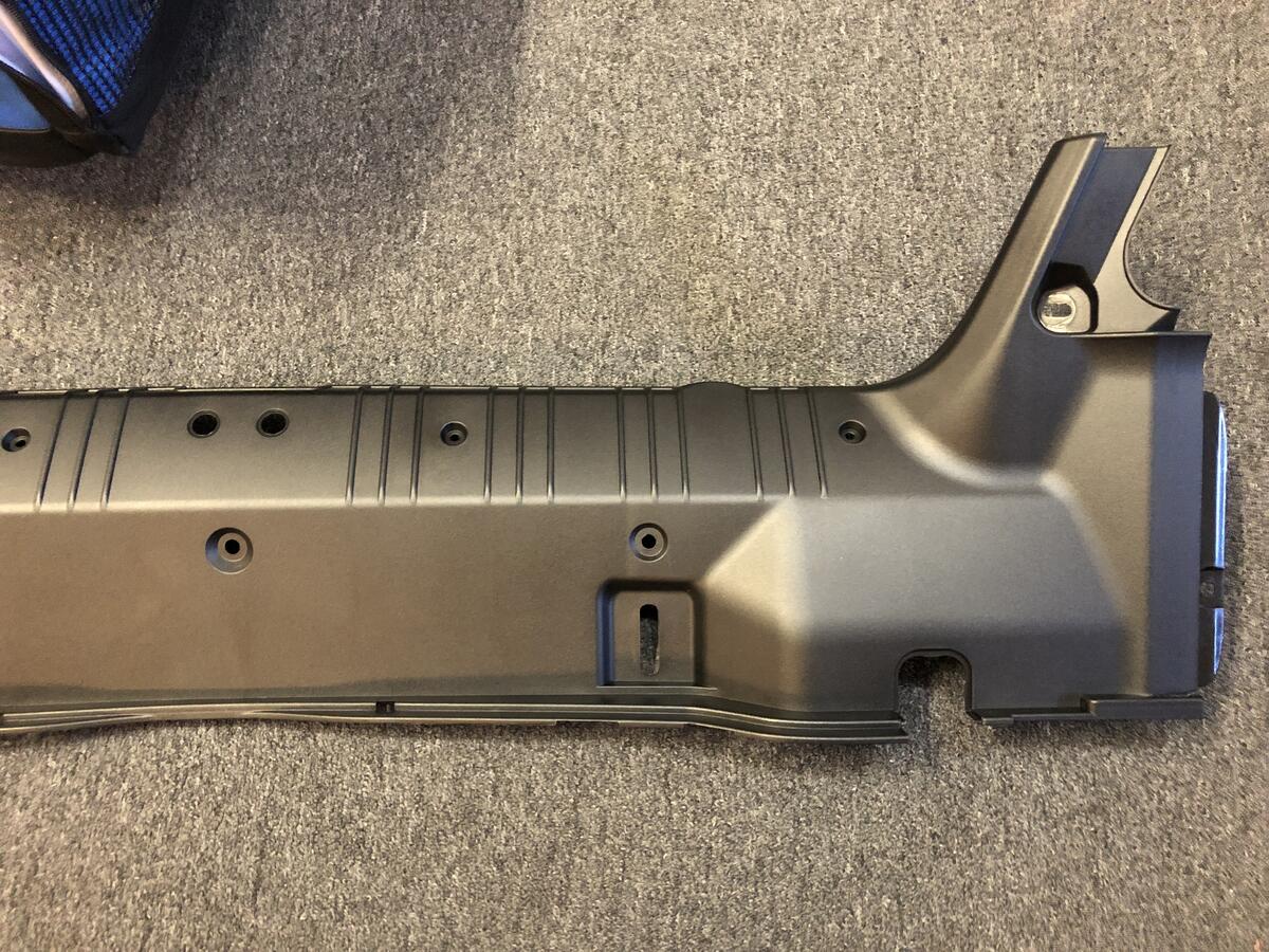

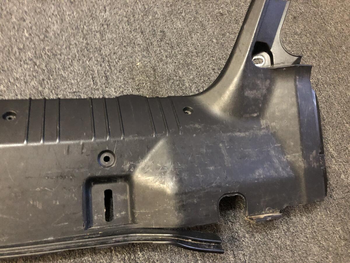

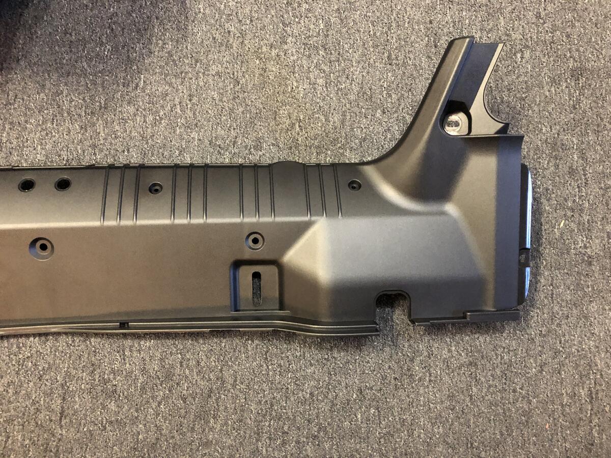

              The trim in the trunk was banged up and broken.

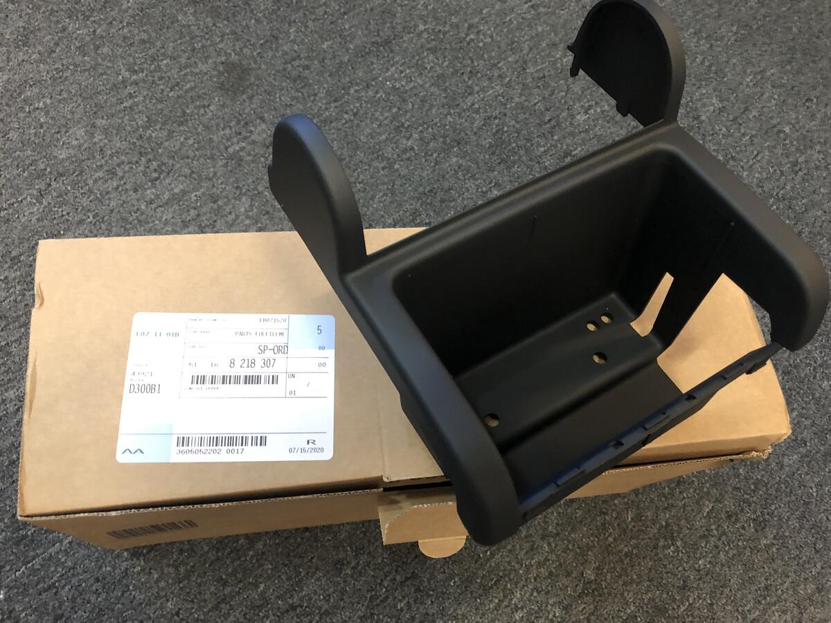

              New part so nice and clean

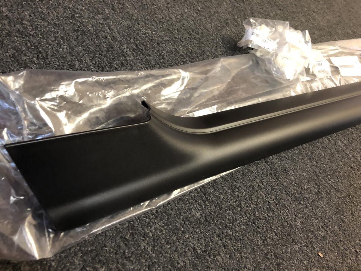

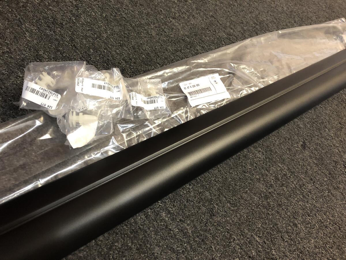

              My sill plate cracked when I removed it to install a new door seal. Replaced it and the clips.

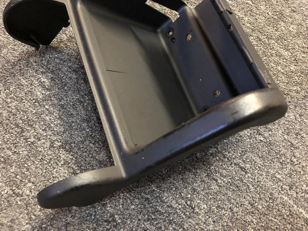

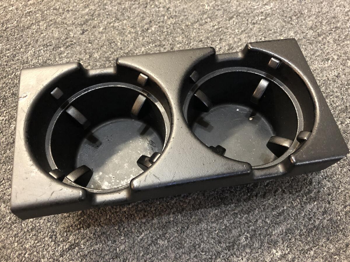

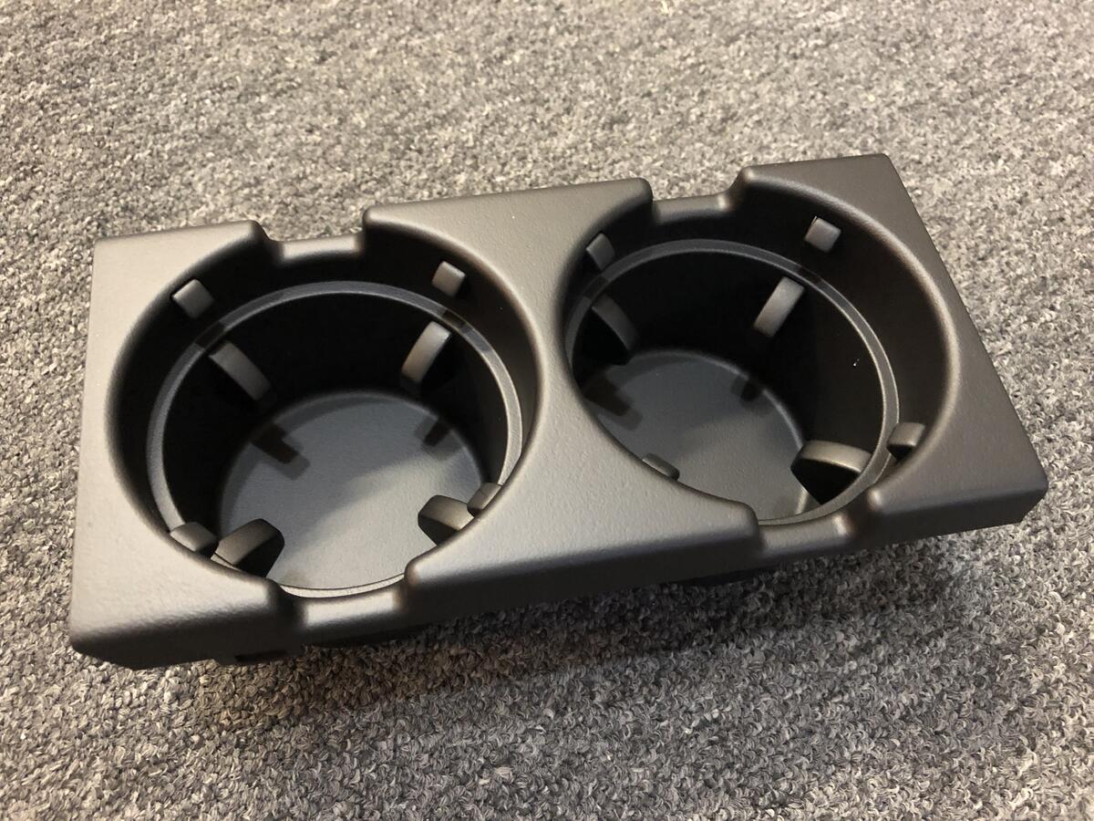

              Cup holders were past tired

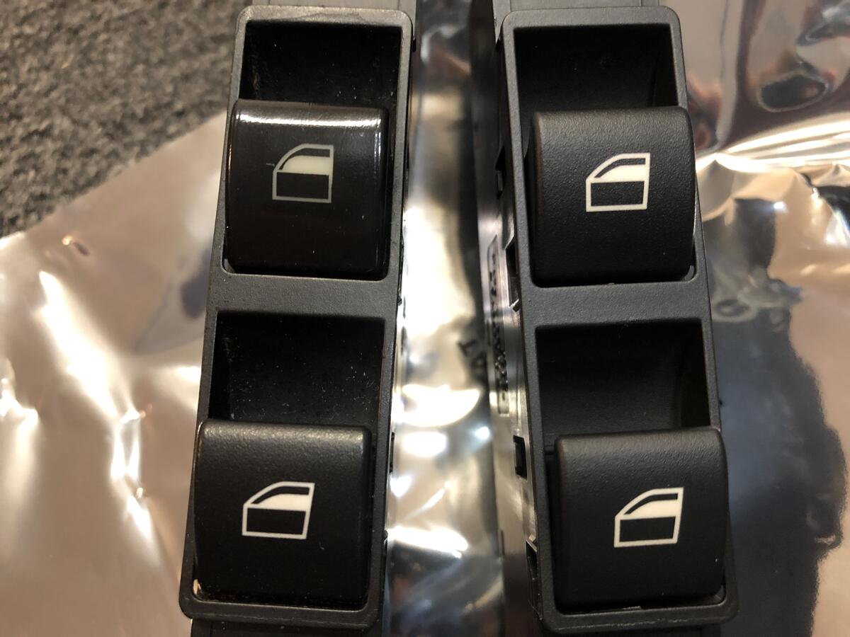

              Driver’s side window switch was worn out and worn smooth
              Worn shiny on the left and new on the right

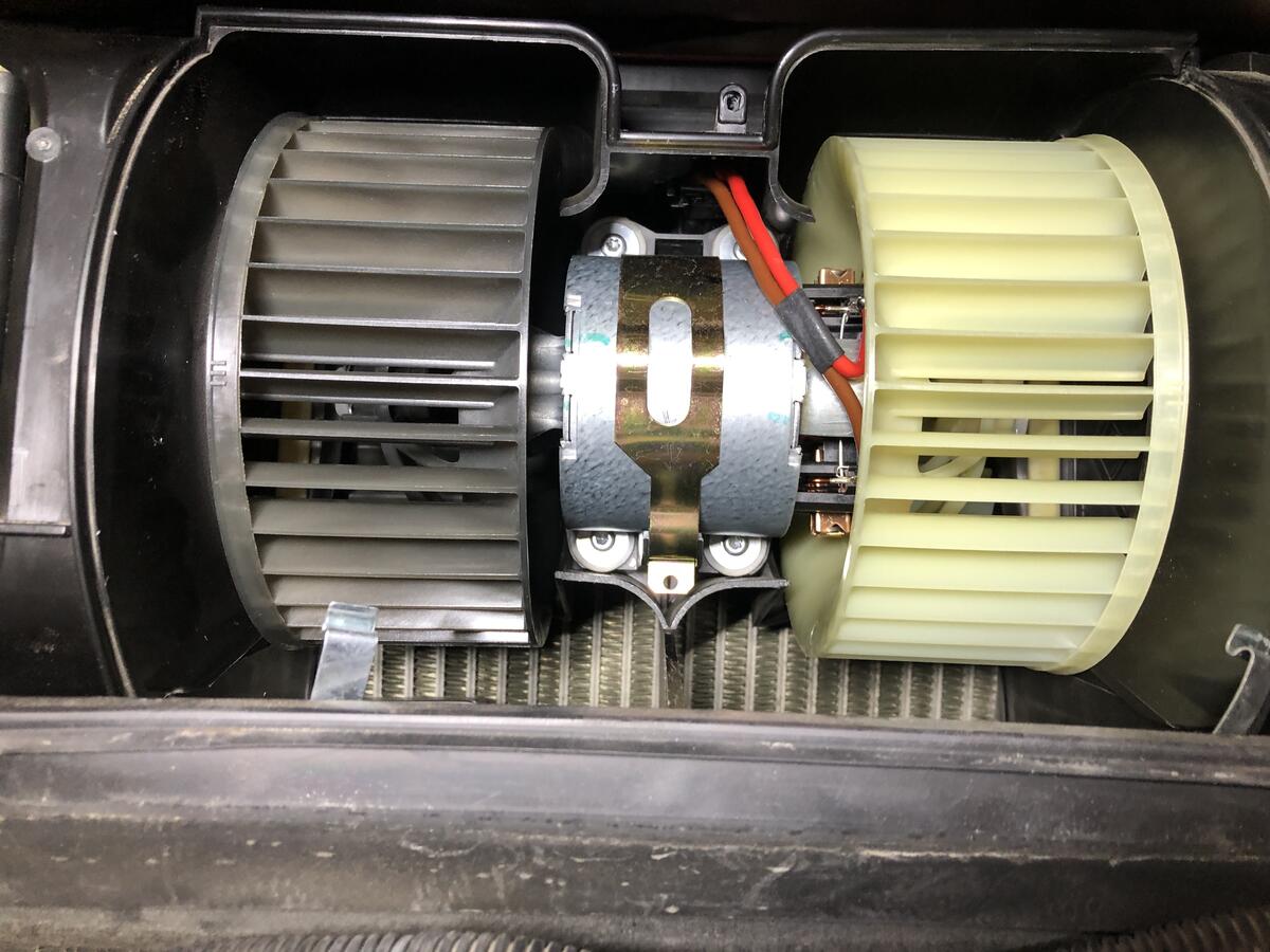

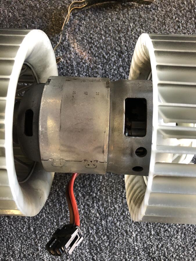

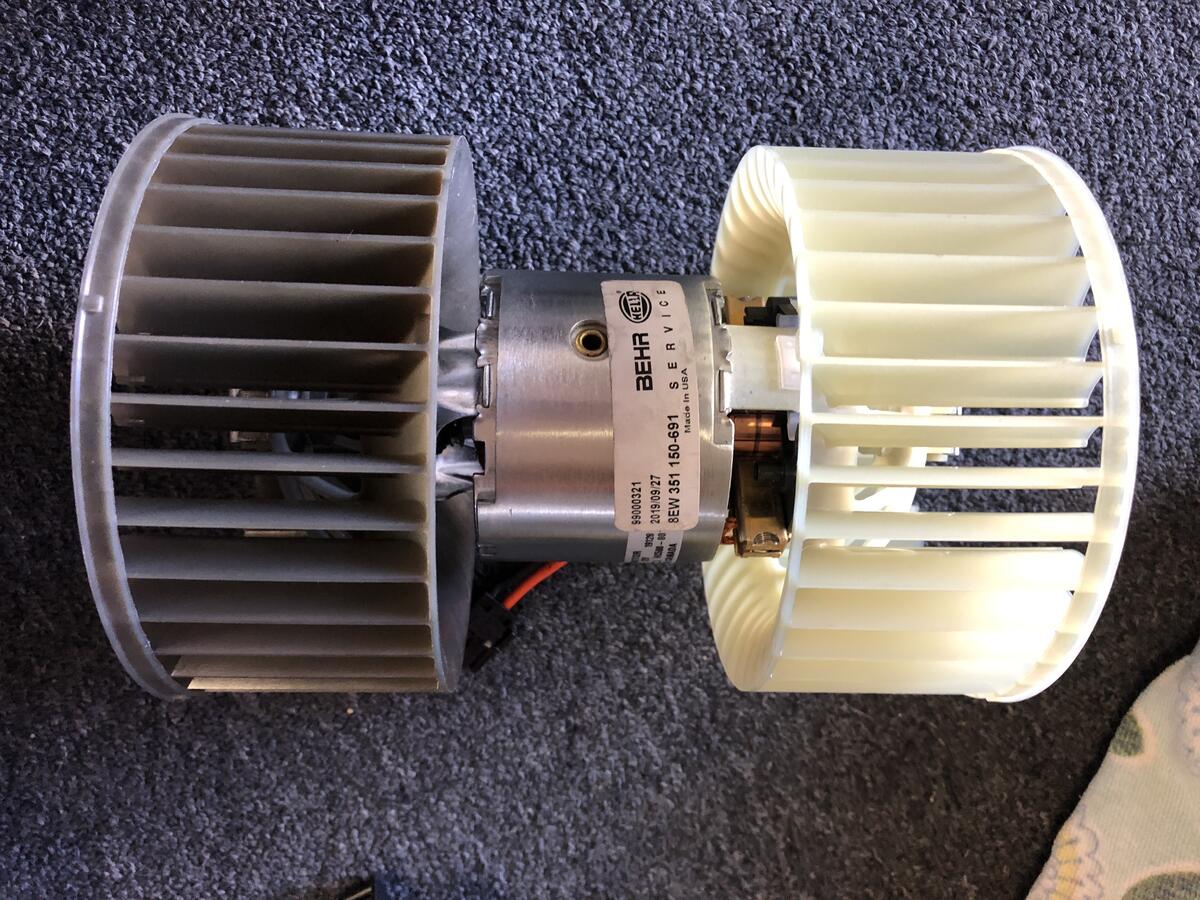

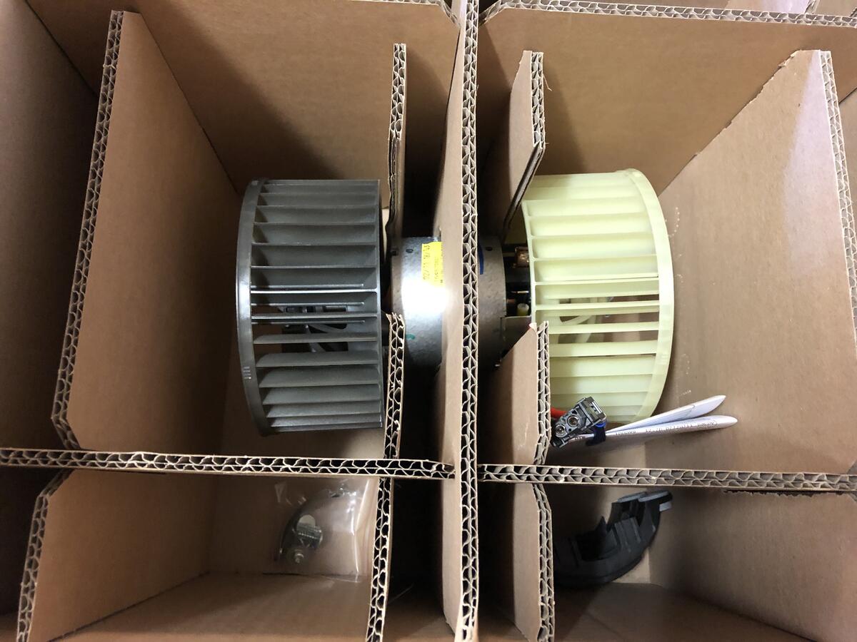

                        Small update. It was time to replace the blower motor. The squeaking got unbearable. I bought an OE replacement but the design was revised from the original. The new unit wouldn’t fit into the old style bracket.
                        Old
                        Click image for larger version  Name:	A55E9F05-CC6B-4131-876A-DAED4ED8CB0F.jpeg Views:	0 Size:	112.3 KB ID:	66111
                        Behr OE
                        Click image for larger version  Name:	49C884A2-047F-484C-834D-D77770B707DA.jpeg Views:	0 Size:	196.1 KB ID:	66112

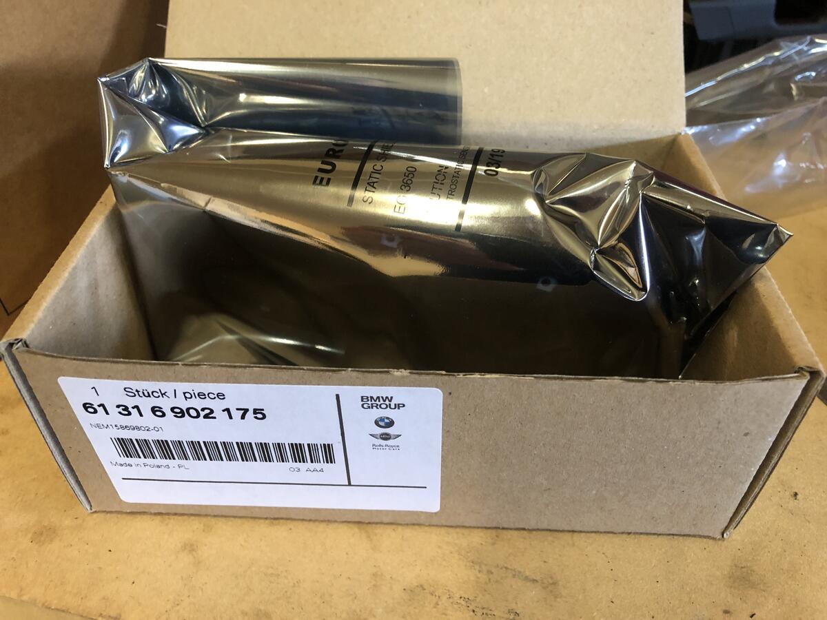

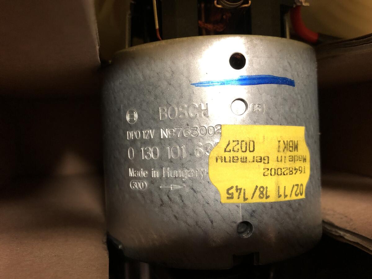

                        I ended up having to return the OE and go with the BMW brand as it included the new bracket needed. In case anyone was wondering, Bosch still makes the OE for BMW and doesn’t seem to be available as a standalone brand.
                        Click image for larger version  Name:	4F057A5A-8685-444F-983A-F68668F6B2FD.jpeg Views:	0 Size:	87.8 KB ID:	66109
                        Click image for larger version  Name:	7854FE2D-D201-4DBA-9452-214058380C53.jpeg Views:	0 Size:	128.5 KB ID:	66108

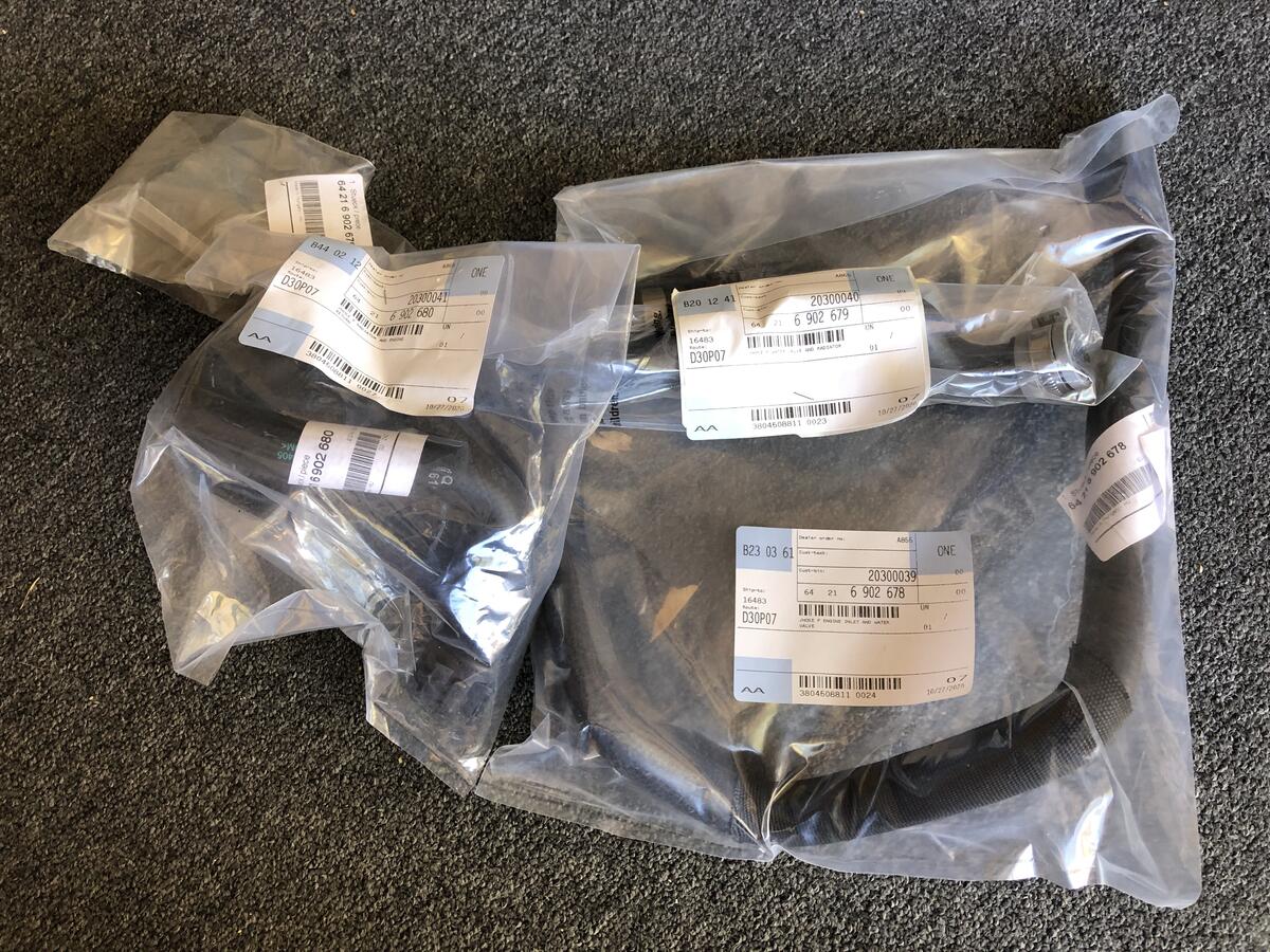

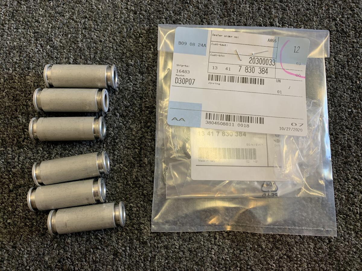

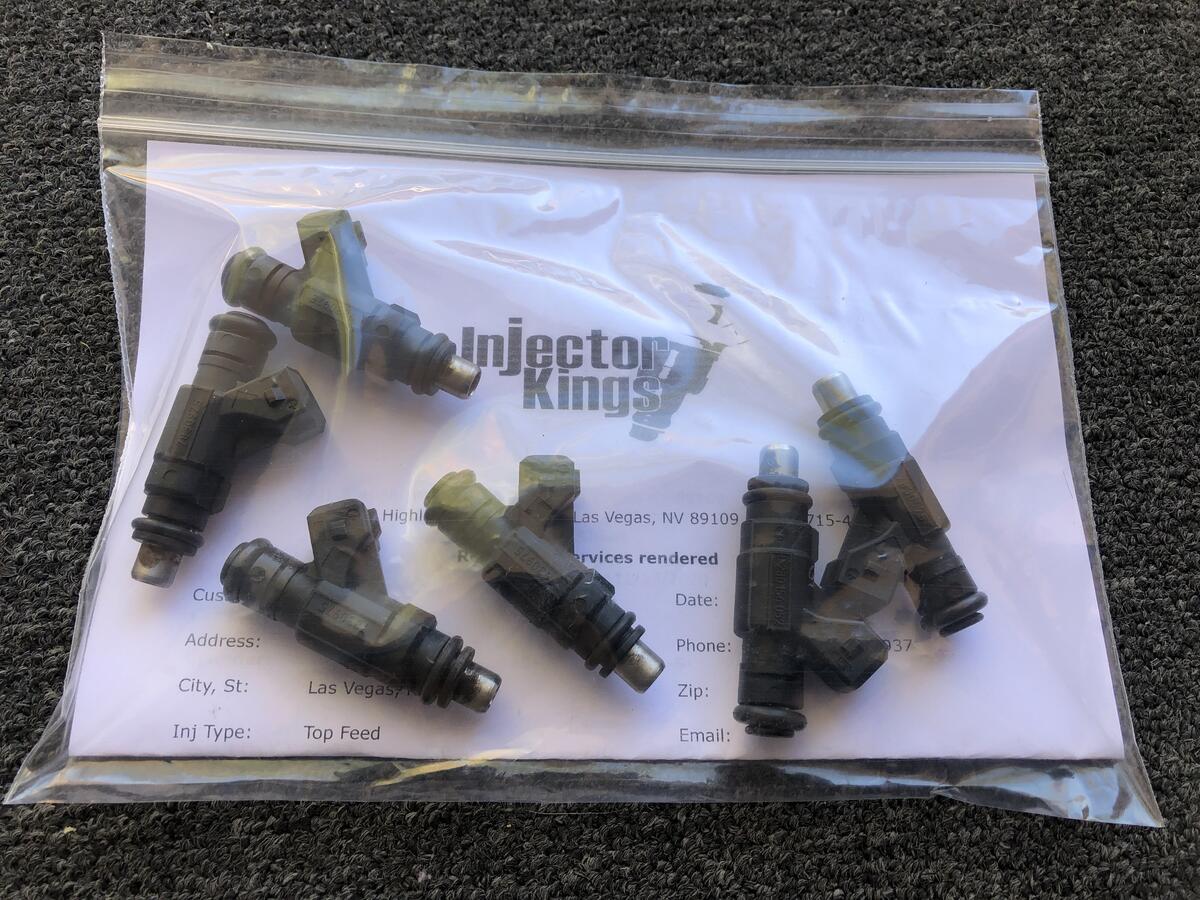

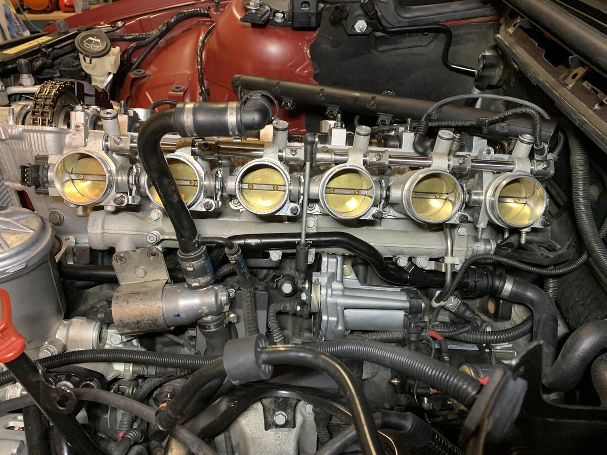

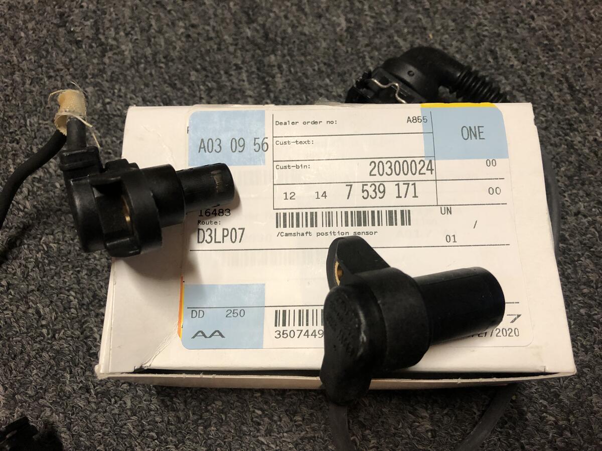

                          I’m replacing the three heater core hoses preventatively. Just not something I want to wait around till they fail. Coolant flush while I’m at it.
                          I wanted to clean up the throttle bodies, replace the air tube seals, service the injectors and replace the rear cam sensor preventatively since the throttle bodies would be off. Super simple with the TBs removed.
                          Click image for larger version  Name:	58B69970-8766-4ED8-9CAC-32DF45EC31B6.jpeg Views:	0 Size:	191.6 KB ID:	69001
                          Click image for larger version  Name:	359D52F7-9EE2-4208-9AAD-335E8C8E4124.jpeg Views:	0 Size:	256.8 KB ID:	69005
                          Click image for larger version  Name:	CF2A52B8-ED5C-438F-A84D-ADA96F0D3503.jpeg Views:	0 Size:	152.8 KB ID:	69002
                          Click image for larger version  Name:	76091CB7-49BC-4E2F-9D4F-F8784066834B.jpeg Views:	0 Size:	184.7 KB ID:	69003
                          Click image for larger version  Name:	7F0DCEF0-C53A-4530-98BE-8DC4C1A8CF7D.jpeg Views:	0 Size:	258.4 KB ID:	69004
