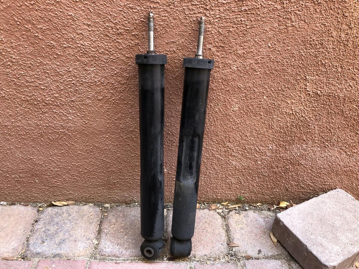

      The rebound on my factory strut is too soft LOL!
      Off to the landfill

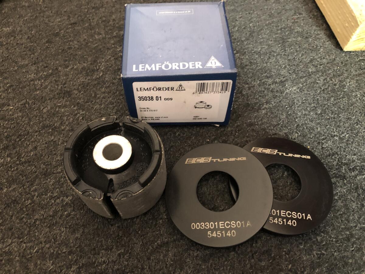

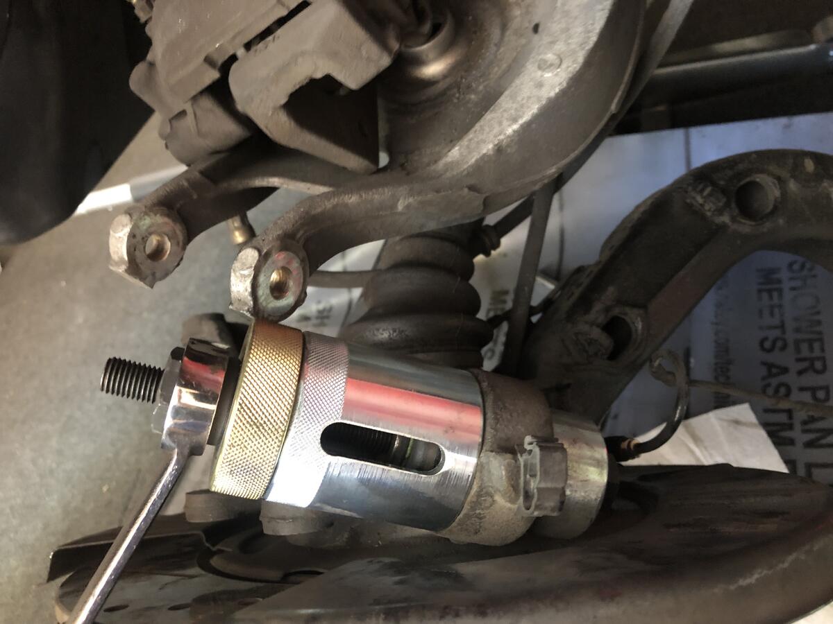

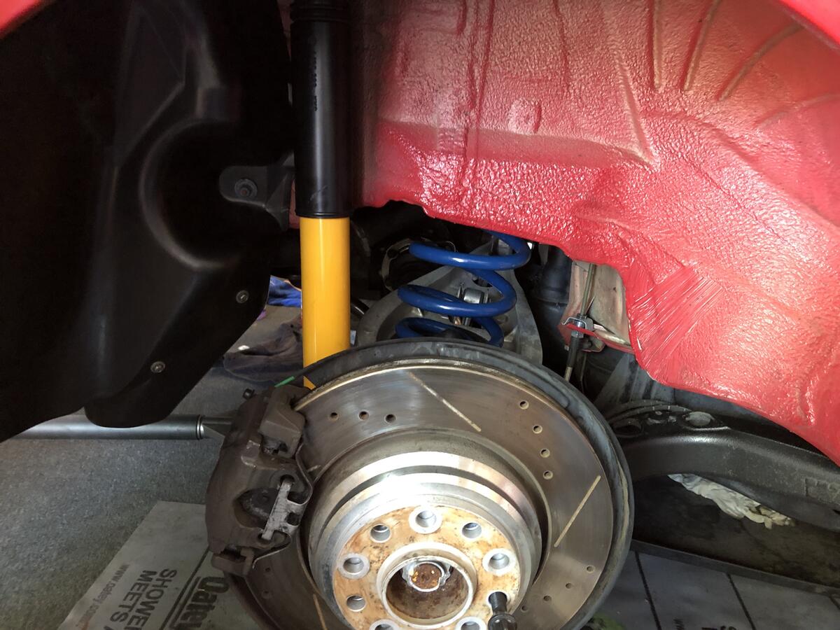

        The back felt loose and tracked bad on the highway. Just as I though, the RTAB and ball joints were shot. Given the mileage, the struts were past due too.
        RTABs out first.
        Click image for larger version  Name:	0F459AF2-620B-44E9-A175-8F622C1A6512.jpeg Views:	0 Size:	114.4 KB ID:	48624
        Went with OE plus limiters
        Click image for larger version  Name:	470A8897-7E4C-4F15-ADF2-A2551A9A0CC7.jpeg Views:	0 Size:	167.4 KB ID:	48632
        Click image for larger version  Name:	20A8324D-E2D3-499D-A707-5E8CCB35B10E.jpeg Views:	0 Size:	133.5 KB ID:	48627

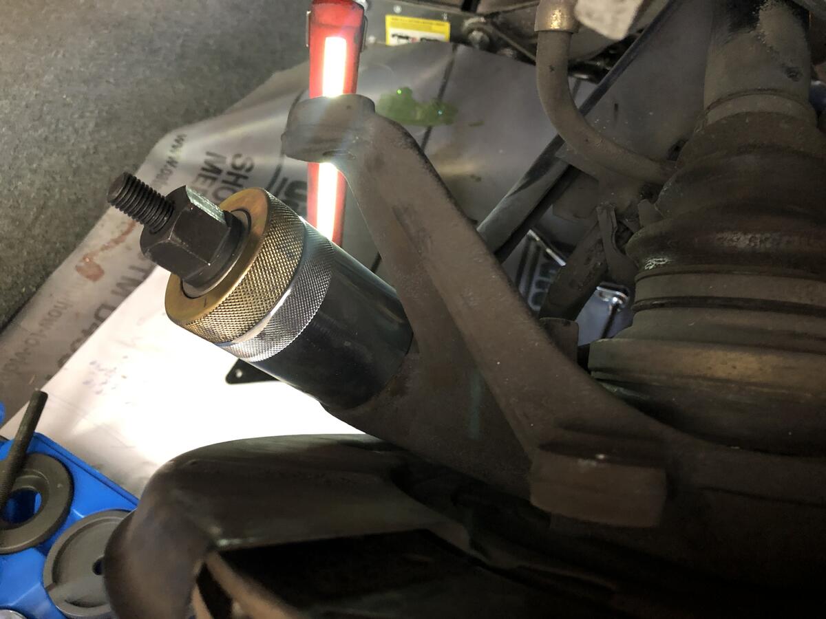

        Next remove the old ball joints
        Click image for larger version  Name:	A07EB98C-F425-495F-9B67-F19BA43DFA00.jpeg Views:	0 Size:	90.4 KB ID:	48621
        Click image for larger version  Name:	5A024F03-1F81-4CE2-943C-9E02169DE43D.jpeg Views:	0 Size:	101.2 KB ID:	48623

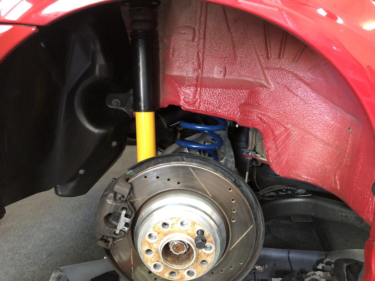

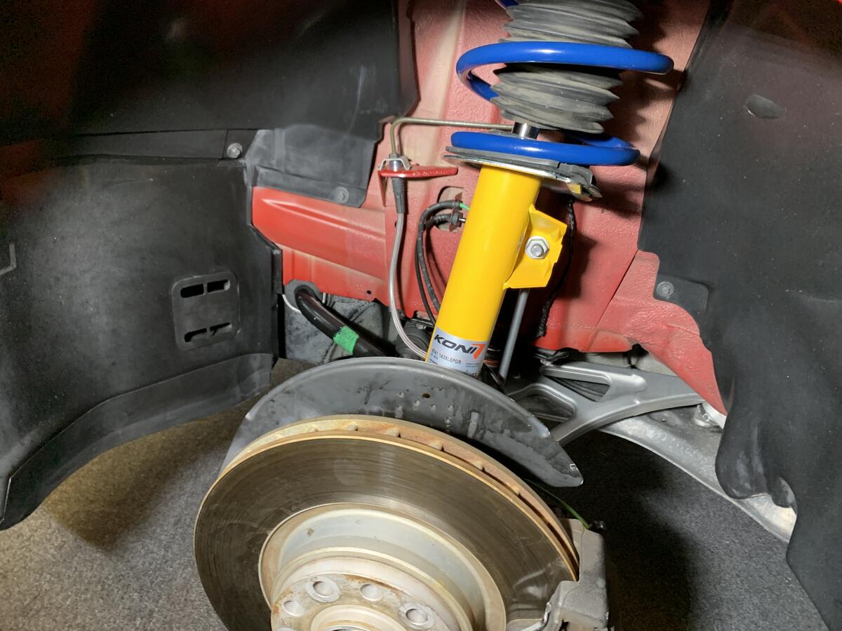

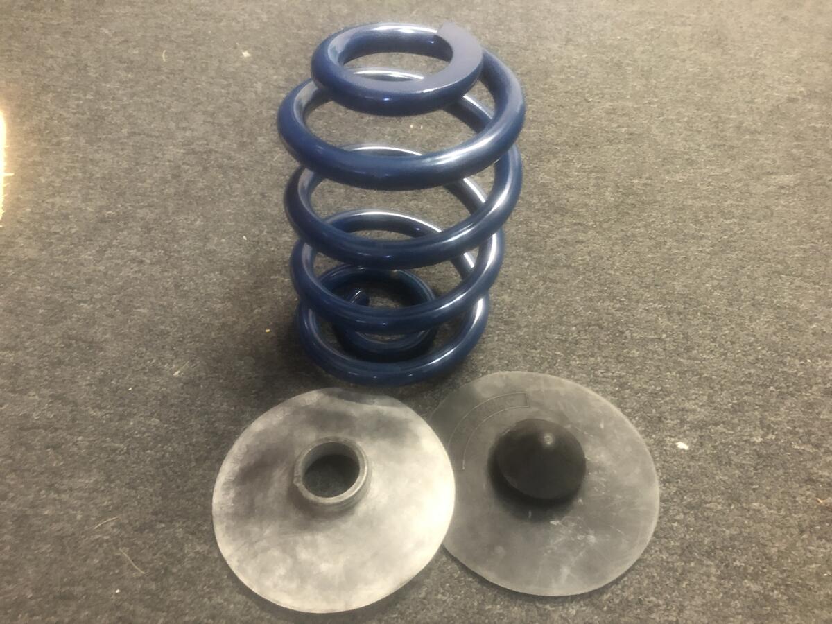

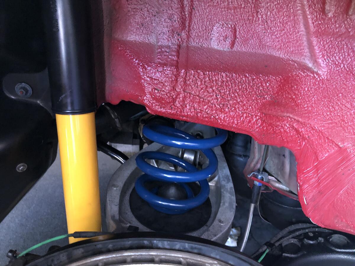

        Dinan springs going back in place of the H&R
        Click image for larger version  Name:	61ED3012-EF94-4578-BEF9-CD048E816528.jpeg Views:	0 Size:	140.1 KB ID:	48625

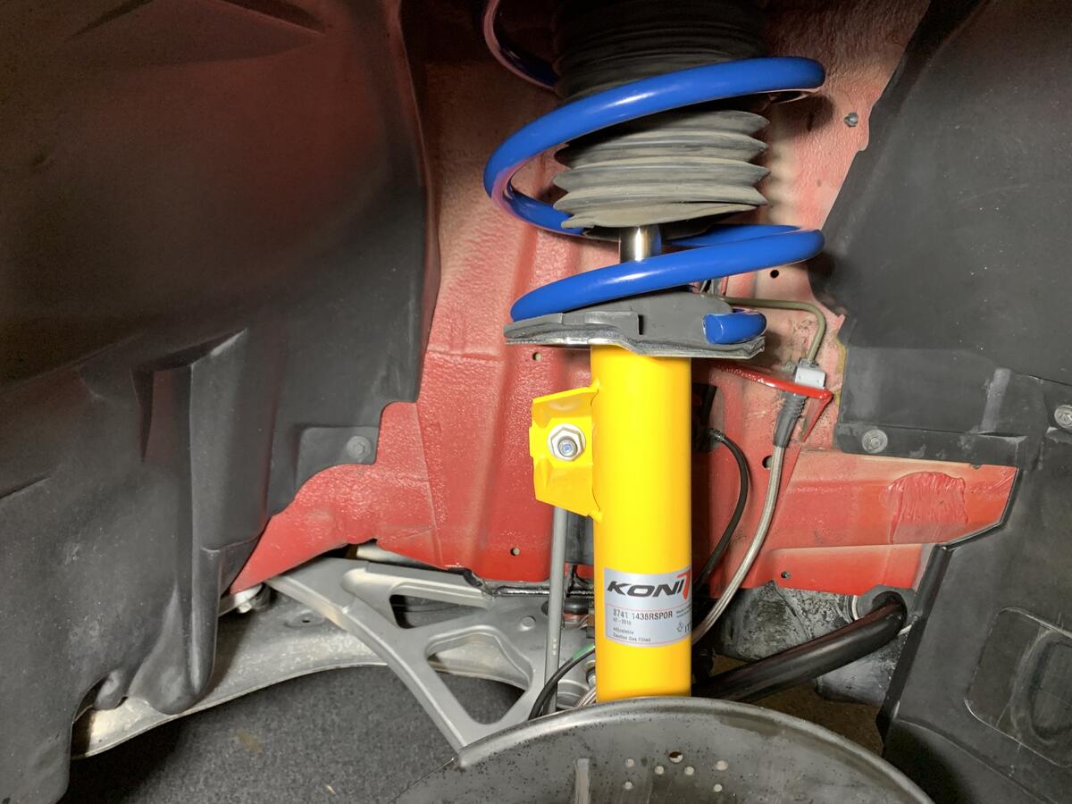

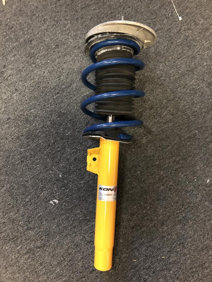

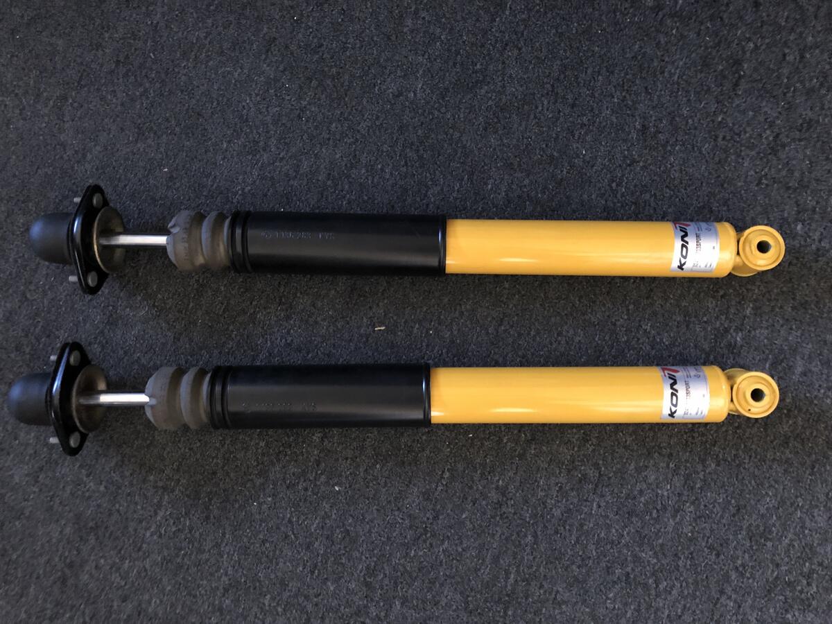

        Koni yellow
        Click image for larger version  Name:	B96C6EC4-5D15-4012-9BCB-F2945CB1E068.jpeg Views:	0 Size:	162.0 KB ID:	48628

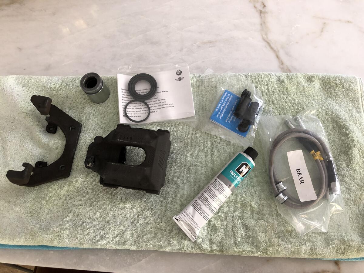

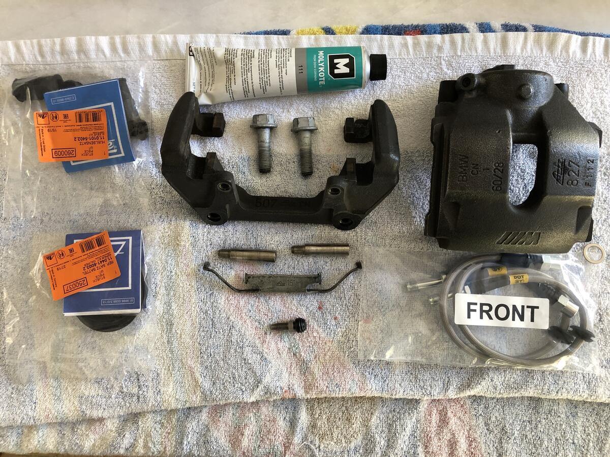

        Rebuild calipers and installing SS lines
        Click image for larger version  Name:	C400866E-BFD4-4EB4-8A2D-9D9F0BB9B1D2.jpeg Views:	0 Size:	188.3 KB ID:	48630
        Cleaned it up a bit and buttoned it back up plus bled the brakes throughly.

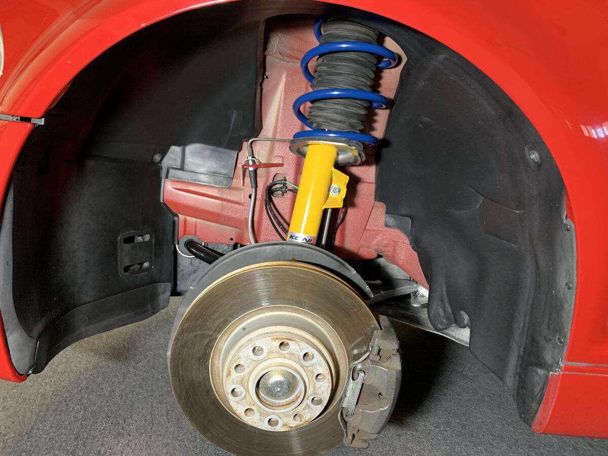

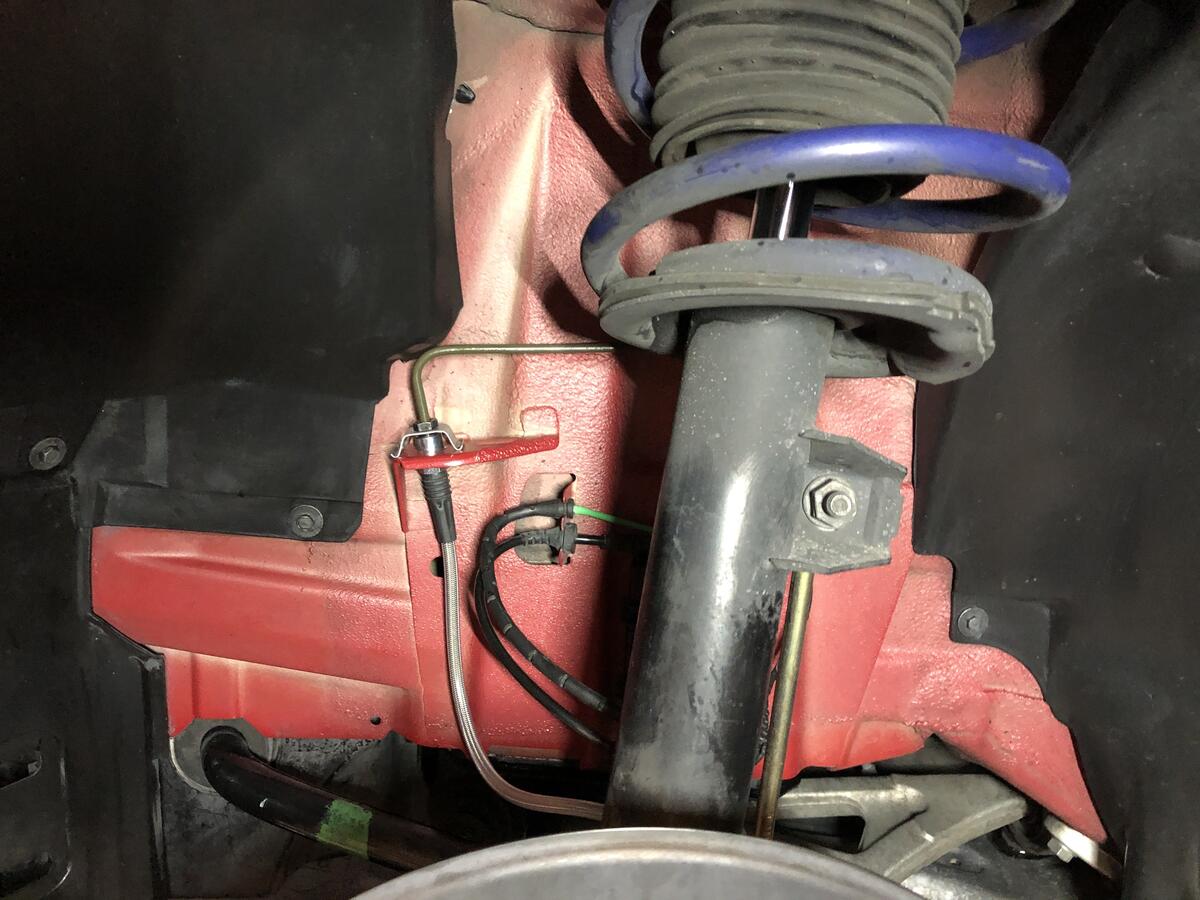

            Front brake rebuild. I’m not replacing the front shocks and springs just yet. I will be doing my rod bearings in the next two weeks and will wait to replace them when I drop the front subframe.
            Front rebuild bits
            Stainless lines peaking through. I gave the front wells a quick wipe down while I was there.

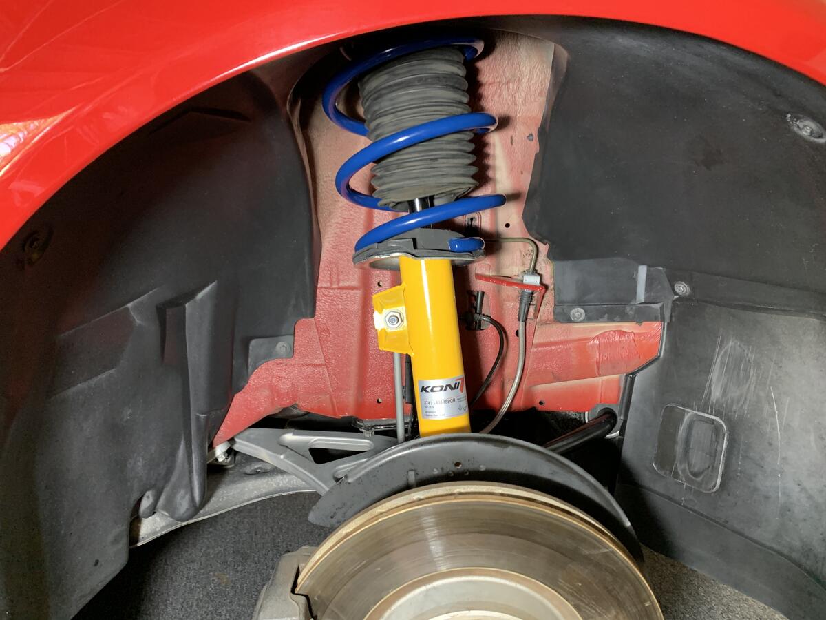

              Front strut assemblies with new everything

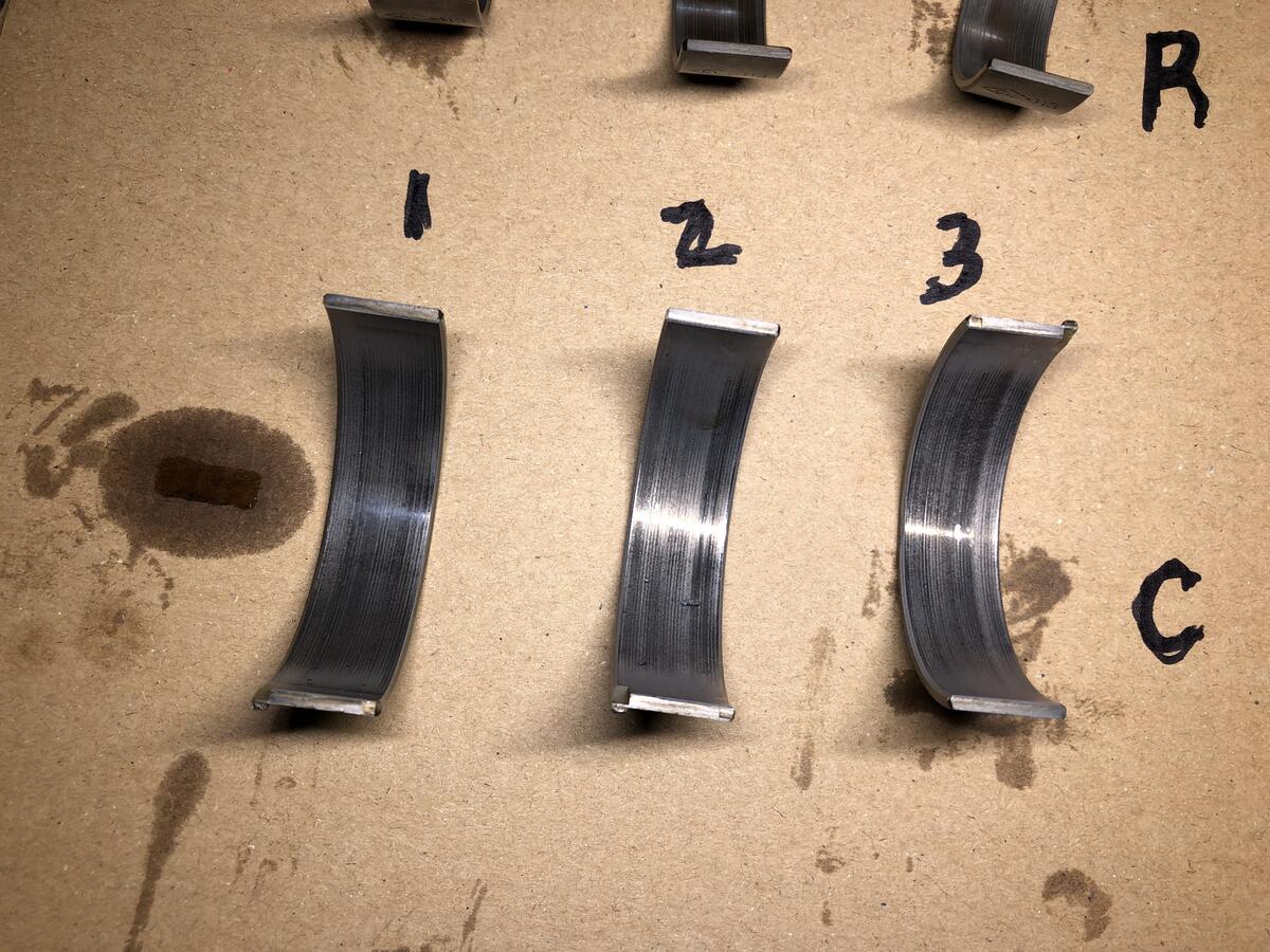

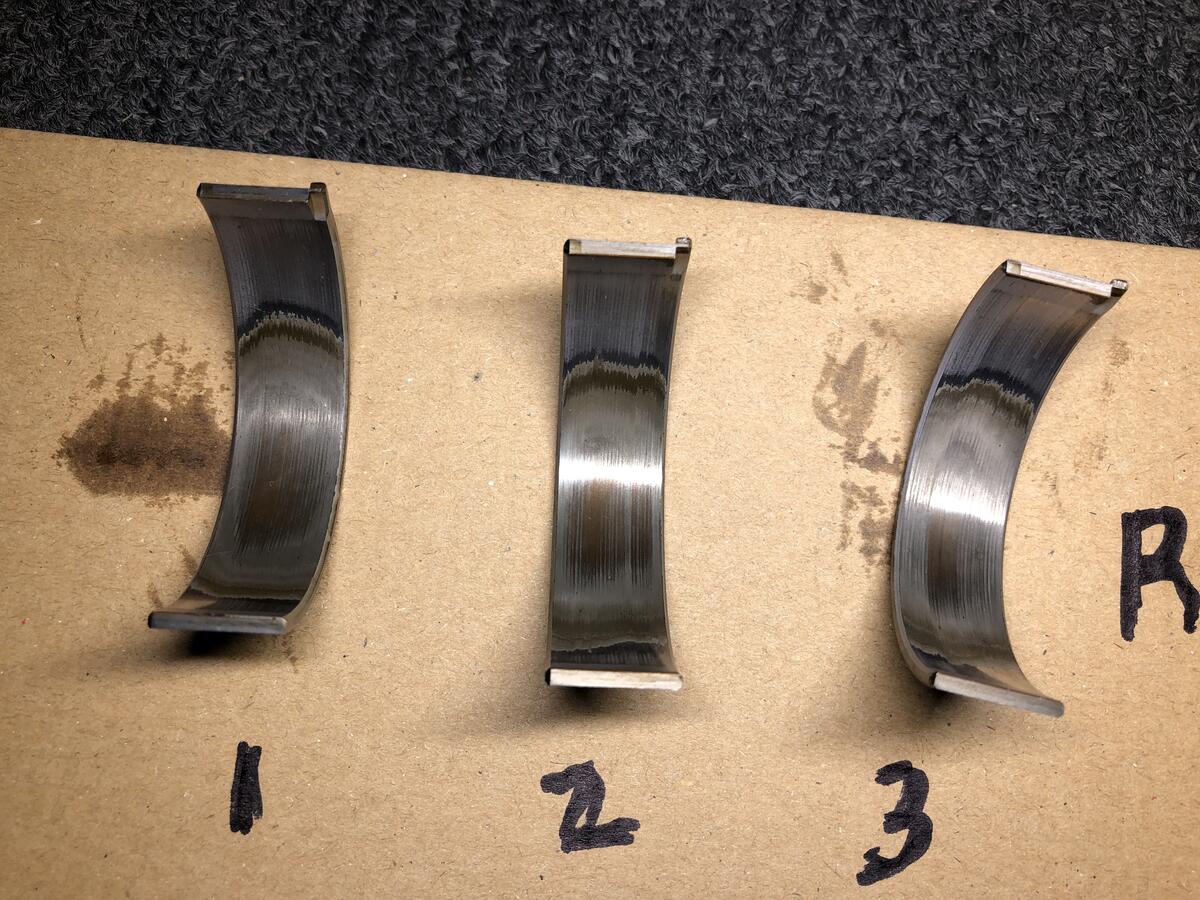

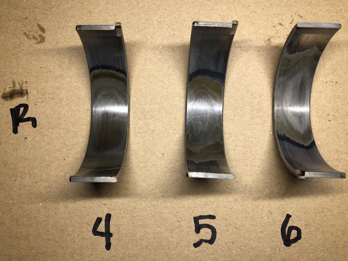

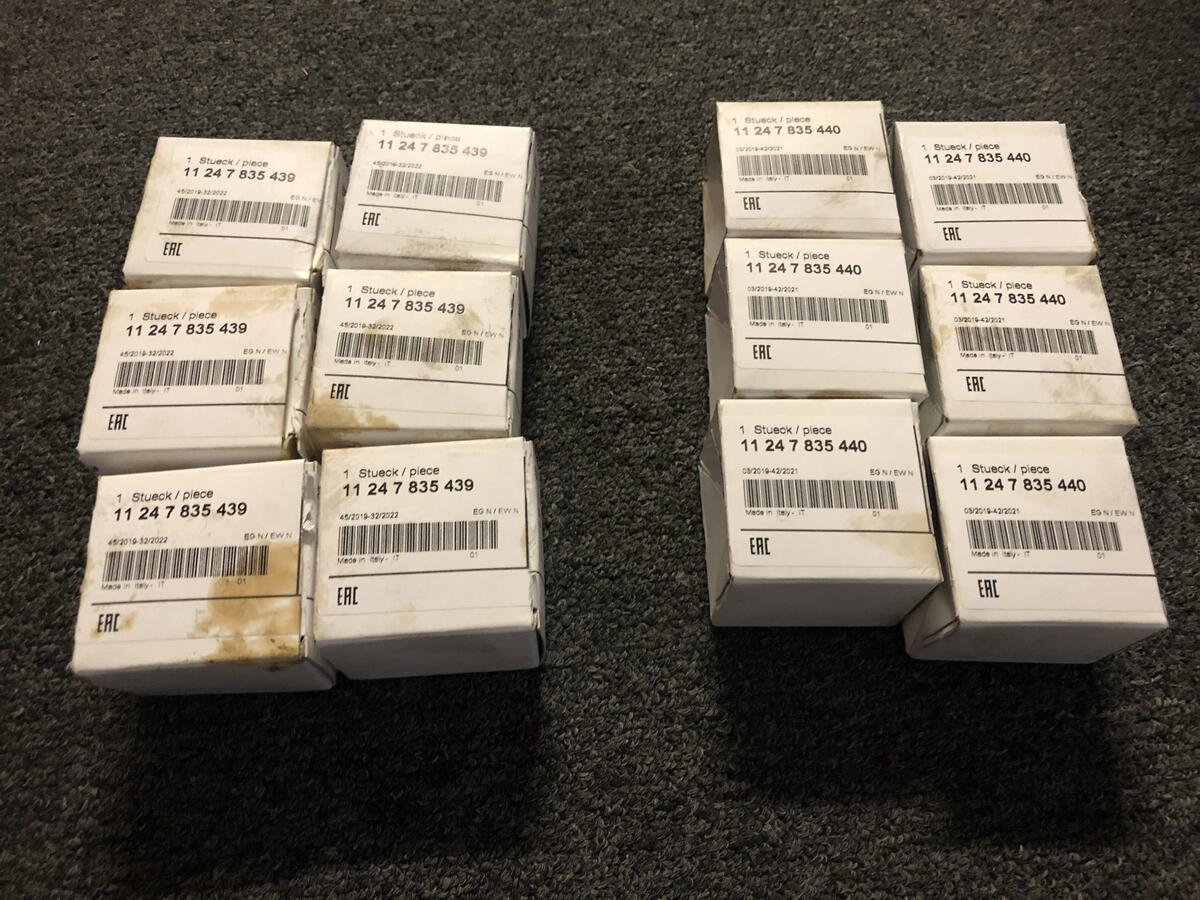

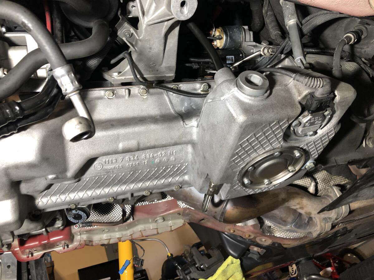

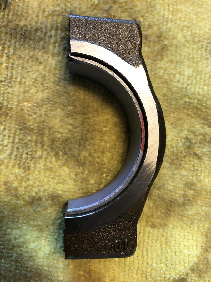

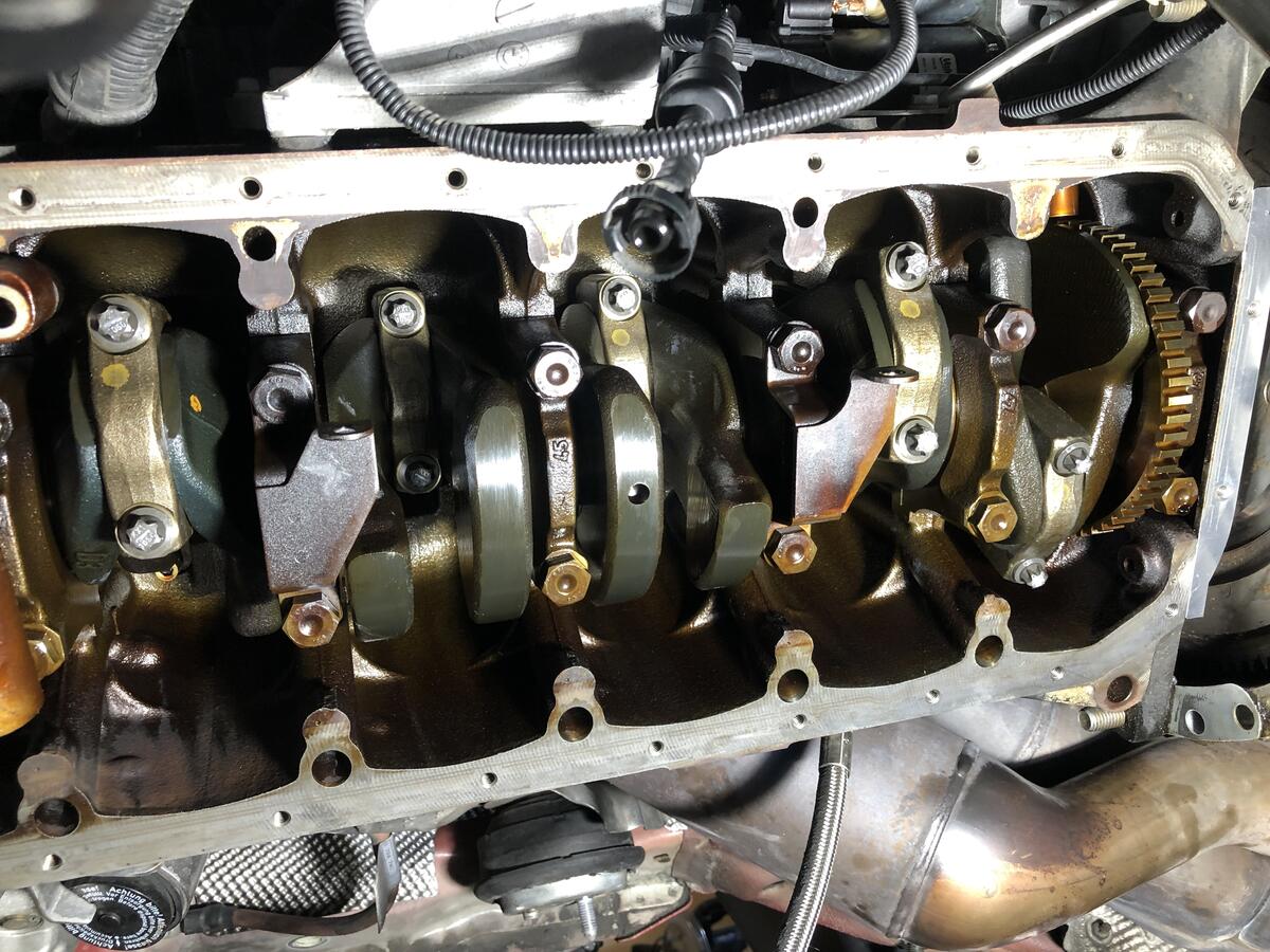

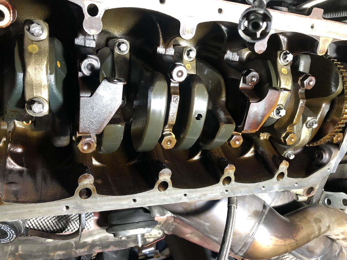

              Rod bearings were pretty straight forward but tedious. The 105 degree TTY was a arm workout!
              Click image for larger version  Name:	EF4BA0F9-E3CA-4129-B941-15AD4694E970.jpeg Views:	0 Size:	170.8 KB ID:	52728
              Click image for larger version  Name:	F384366F-66B0-43AE-AF7B-0FA5991B795A.jpeg Views:	0 Size:	181.4 KB ID:	52685
              Click image for larger version  Name:	63AC39E9-E56E-44CF-8120-B262E18B3EEF.jpeg Views:	0 Size:	119.4 KB ID:	52684
              Click image for larger version  Name:	D75C355E-7820-4877-B2E4-7EA885058DAF.jpeg Views:	0 Size:	101.3 KB ID:	52682
              Click image for larger version  Name:	33B4278A-2752-45E8-8F0F-05629C008903.jpeg Views:	0 Size:	191.2 KB ID:	52686

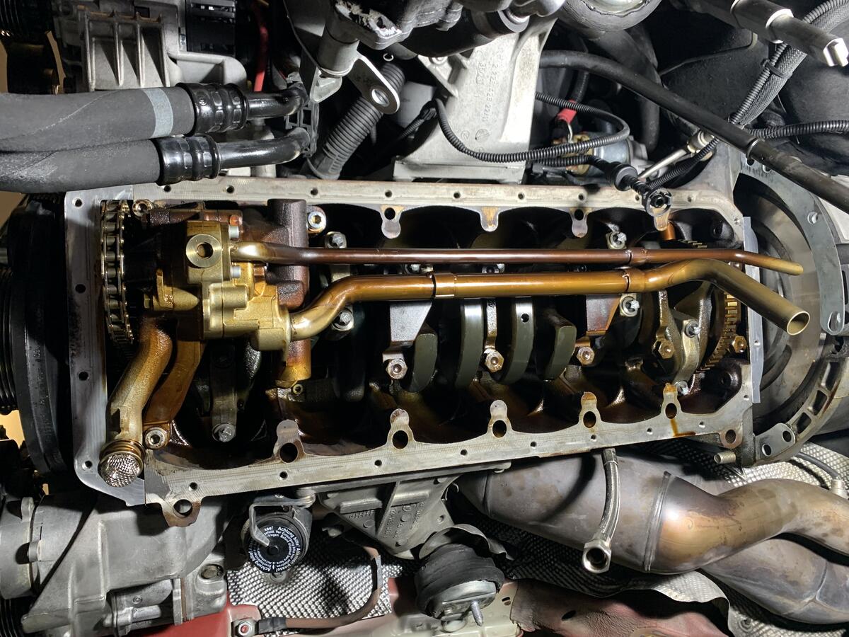

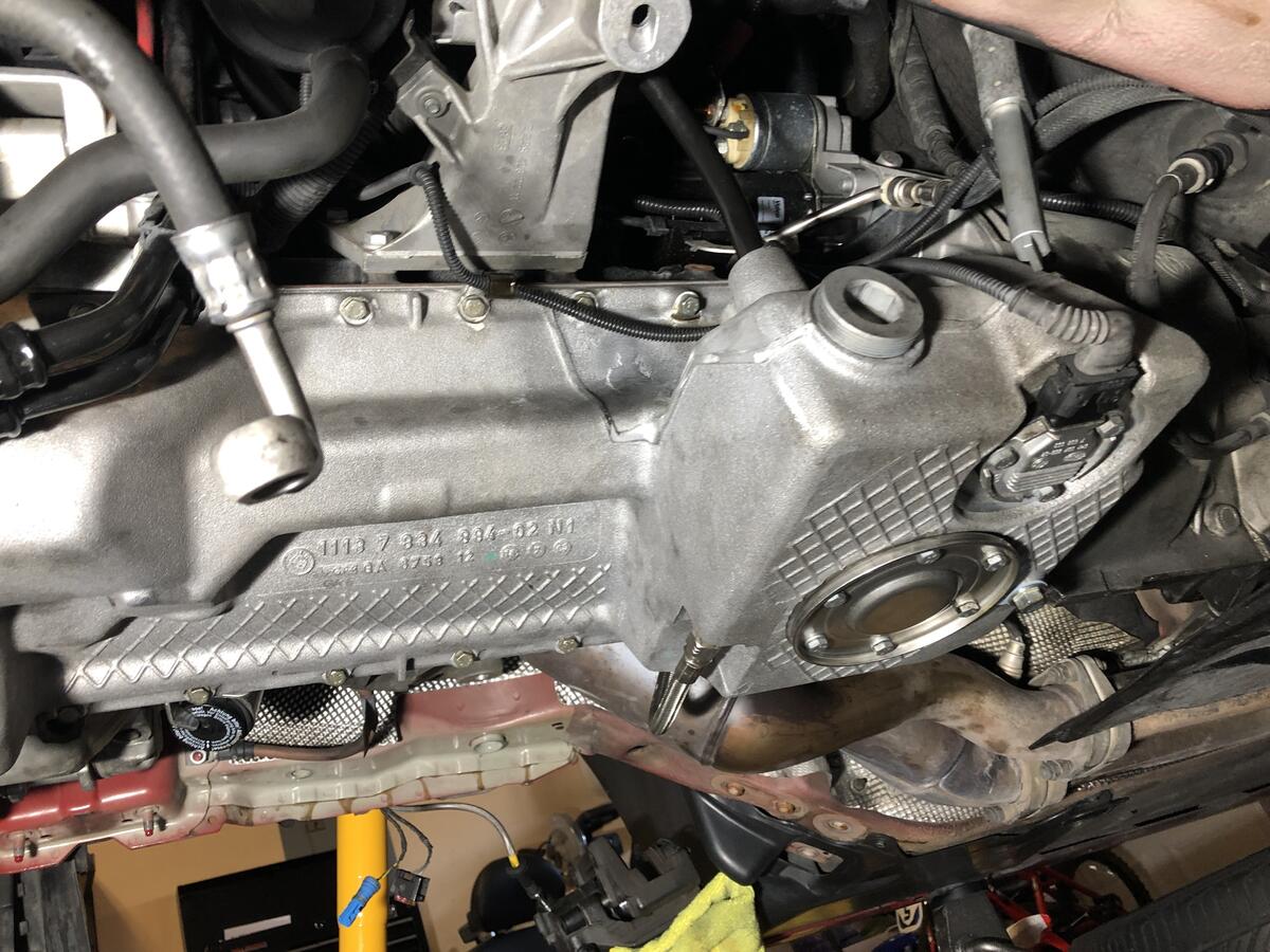

              Oil pump bolted back up
              Oil pan buttoned back up

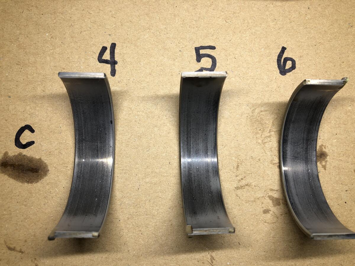

              Cap side 1 - 3
              Click image for larger version  Name:	662611AB-72EE-4F89-A486-FE7BAE2D7135.jpeg Views:	0 Size:	191.1 KB ID:	52690
              Rod side 1 - 3
              Click image for larger version  Name:	1B688F7A-430B-4A0A-B309-68646C40873E.jpeg Views:	0 Size:	199.7 KB ID:	52689
              Cap side 4 - 6
              Click image for larger version  Name:	15D62B14-3597-4551-BB87-94F6D59EE098.jpeg Views:	0 Size:	189.6 KB ID:	52688
              Rod side 4-6
              Click image for larger version  Name:	B5D2242E-D35C-4F50-AF84-034E202B2348.jpeg Views:	0 Size:	186.4 KB ID:	52687

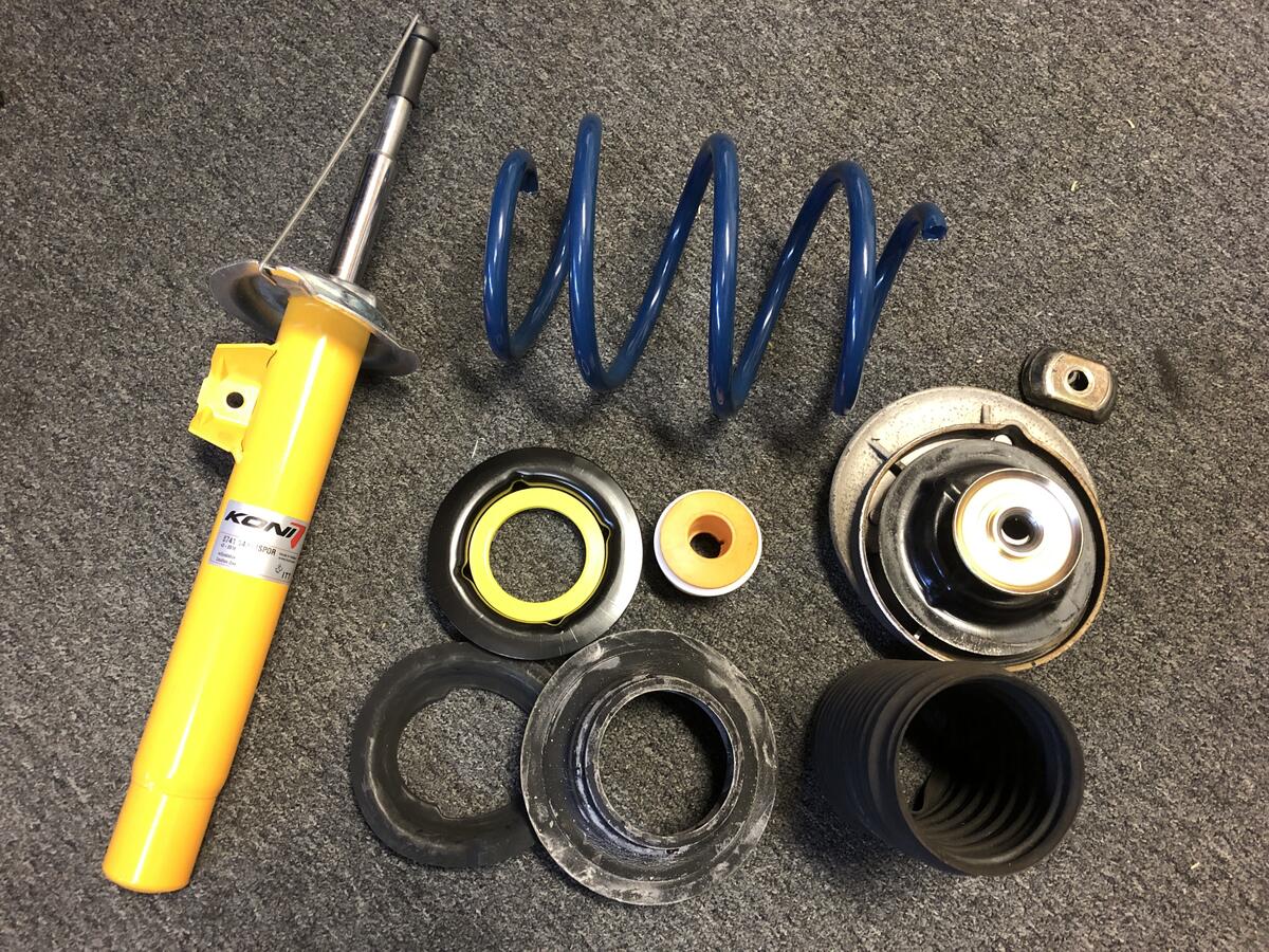

              Strut assemblies
              Click image for larger version  Name:	90814F90-C9FA-470C-921A-3E48C071E51F.jpeg Views:	0 Size:	307.3 KB ID:	52696
              Click image for larger version  Name:	A12BDC87-499D-4A60-99C3-D1699C09ACE7.jpeg Views:	0 Size:	142.5 KB ID:	52695

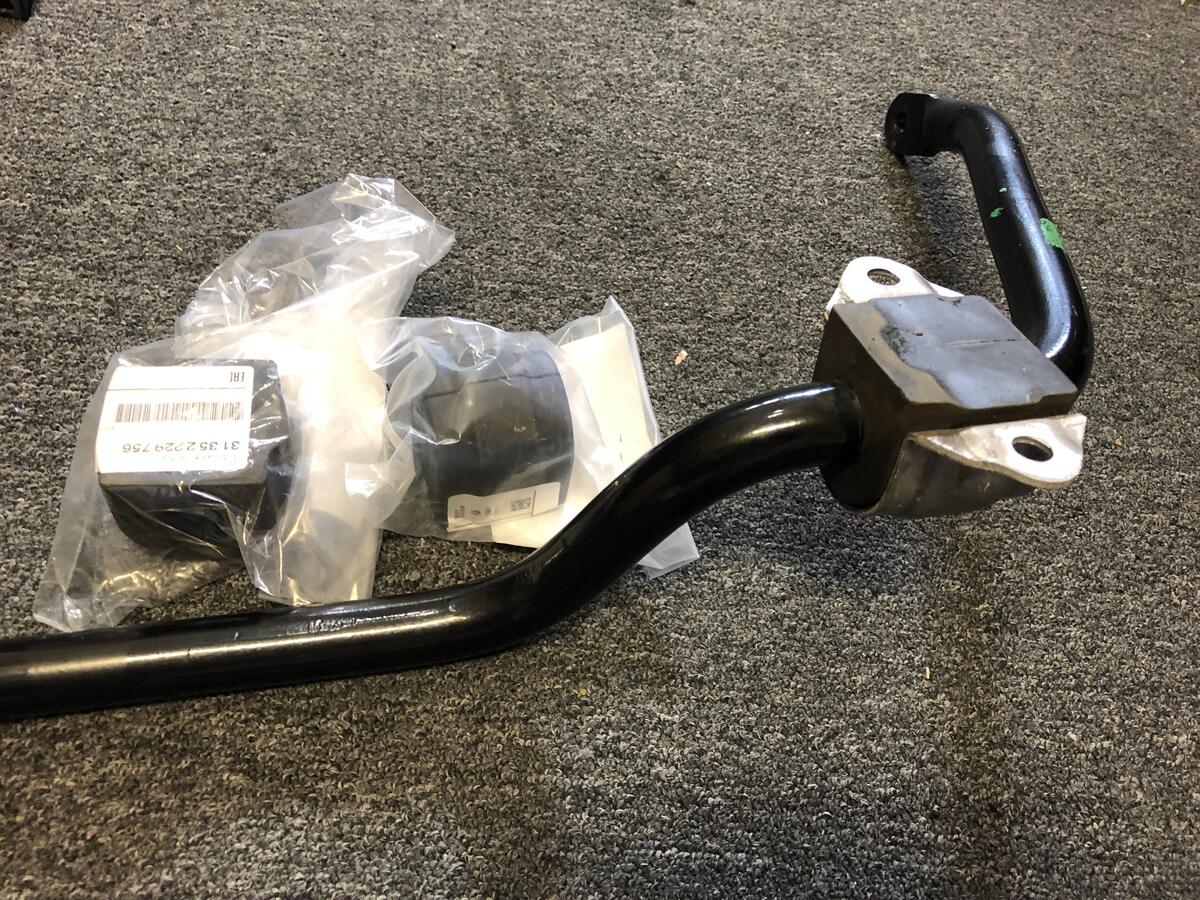

              Sway bar refresh
              Click image for larger version  Name:	CAFE0B57-8E75-4843-91A4-A6B5A9373CE0.jpeg Views:	0 Size:	289.3 KB ID:	52697

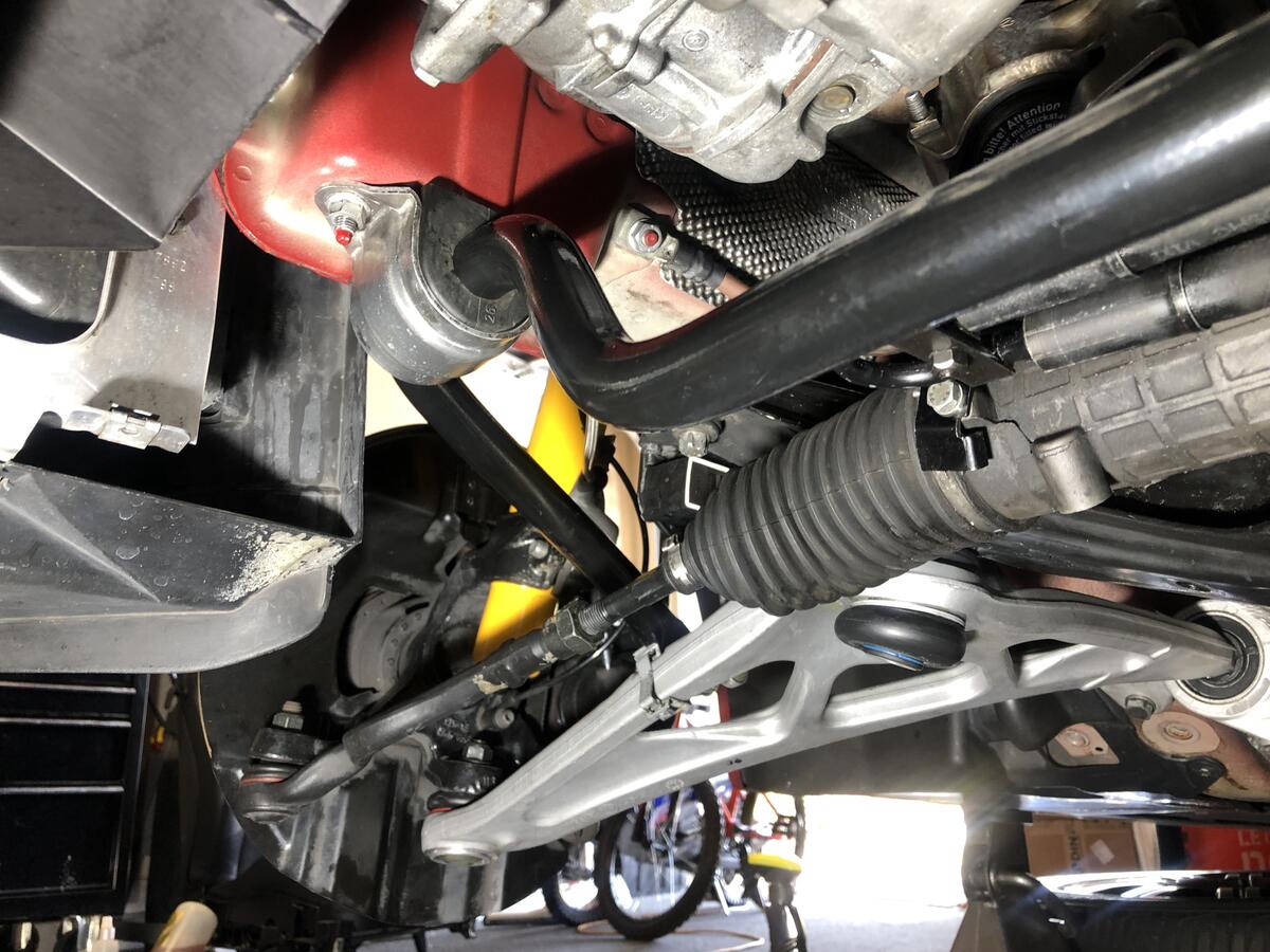

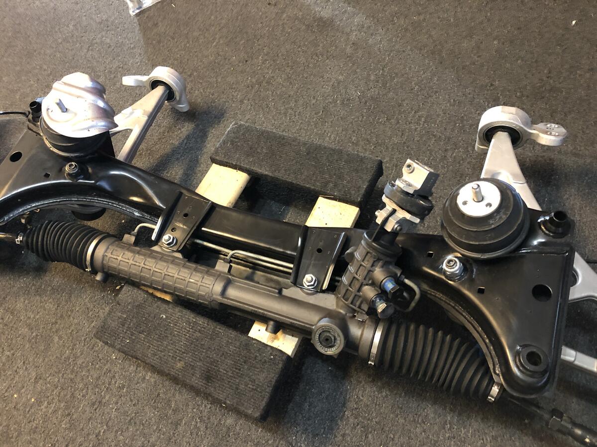

                #37

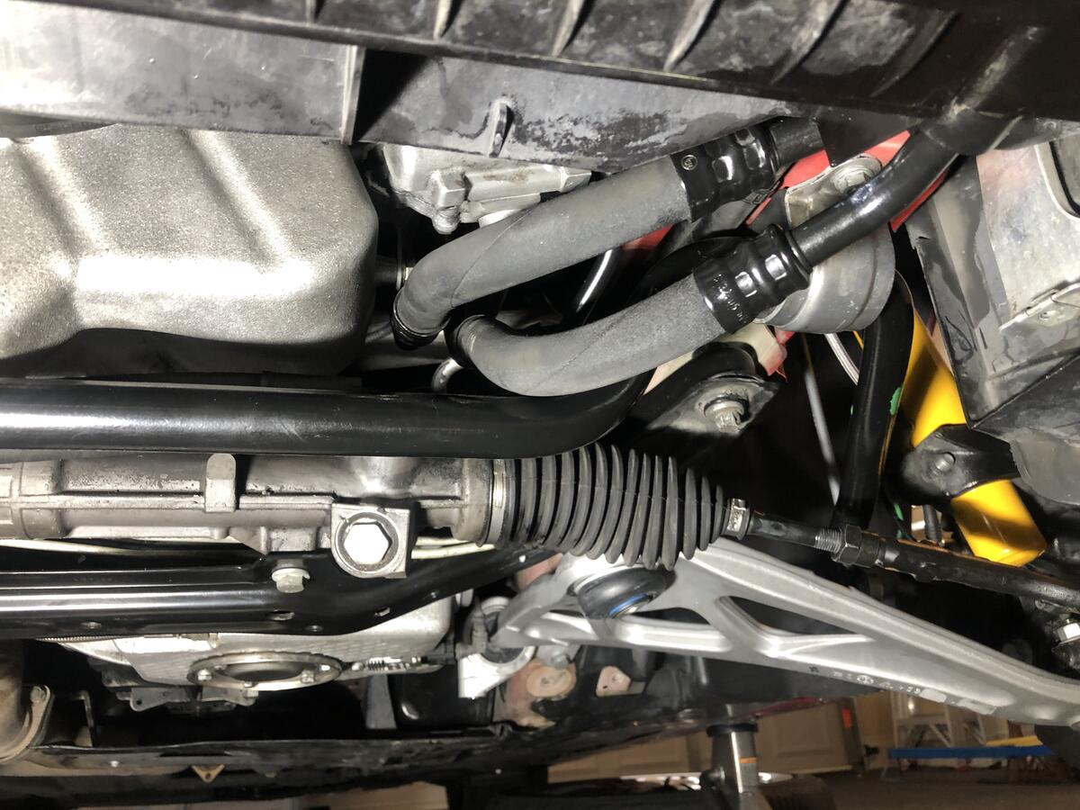

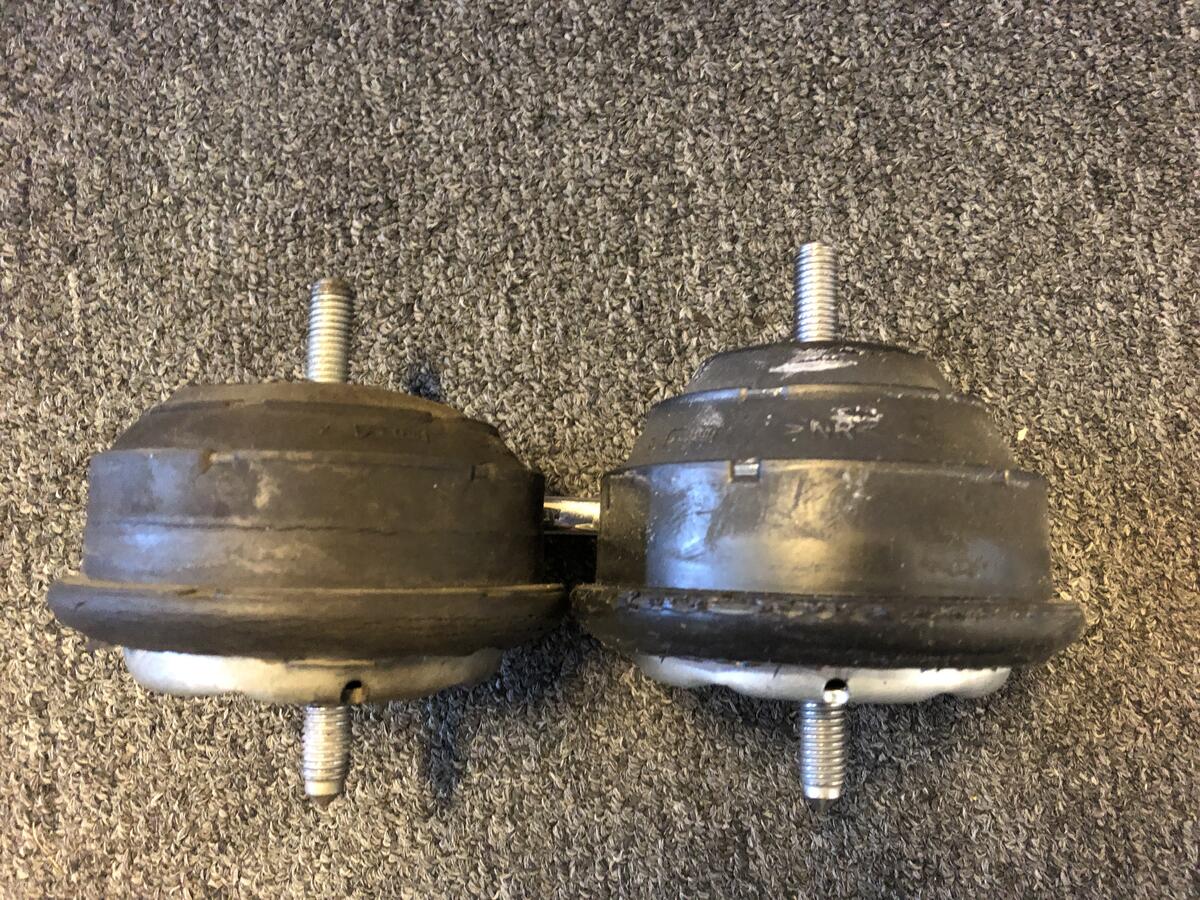

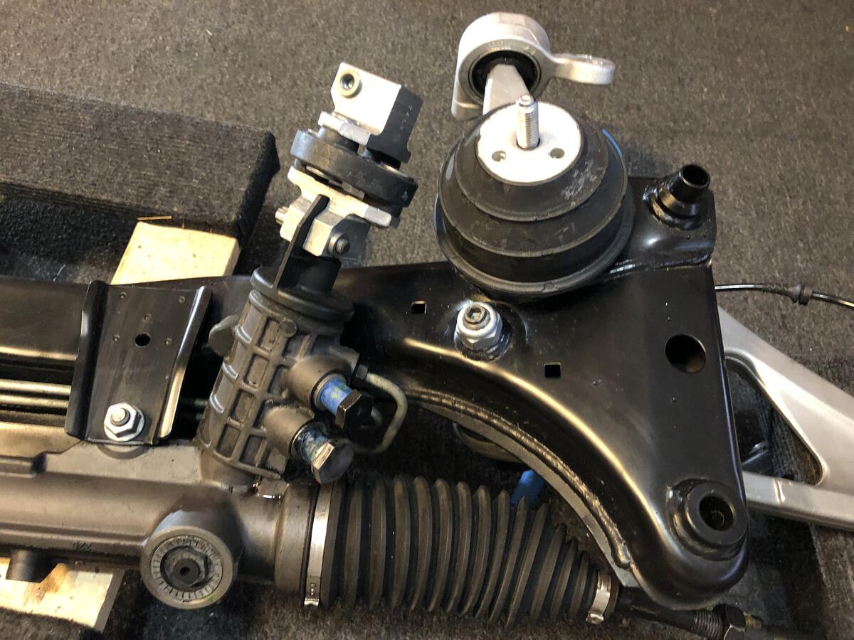

                FCABs, lower control arms, motor mounts

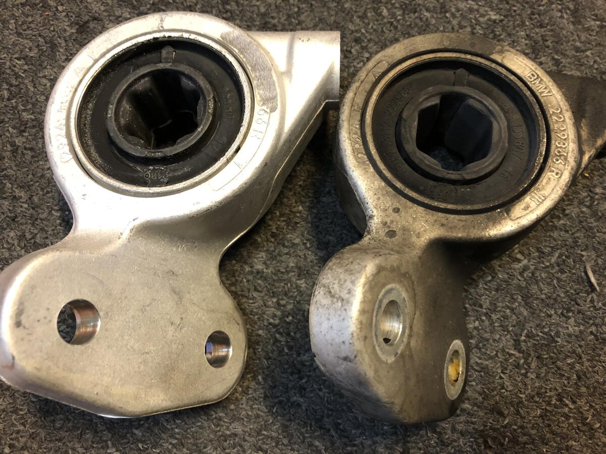

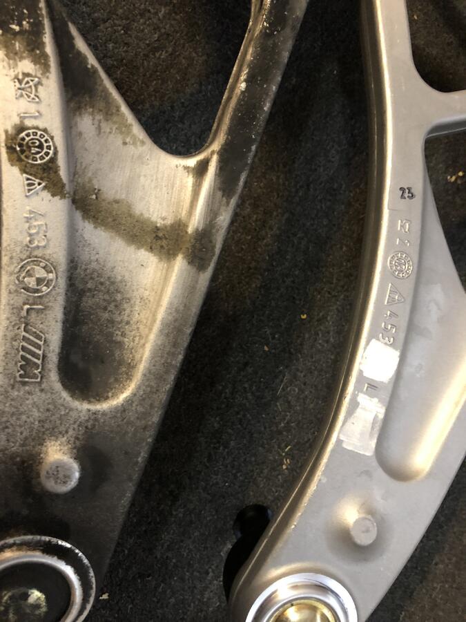

                Lemfoerder vs BMW
                Click image for larger version  Name:	40955B03-DEB7-4009-A9B3-23321215C934.jpeg Views:	0 Size:	82.8 KB ID:	52700
                Click image for larger version  Name:	BA2C5D44-5C10-408C-B149-DC3E5DC64B19.jpeg Views:	0 Size:	180.5 KB ID:	52701

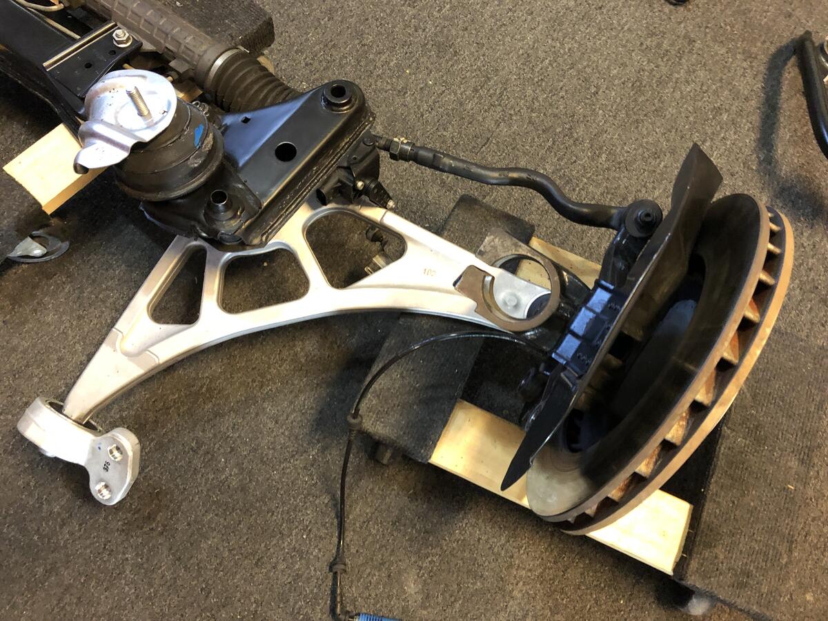

                Lower control arm and FCAB mounted up
                Click image for larger version  Name:	A19EDAEC-BD2E-478E-A735-EDF8978C842F.jpeg Views:	0 Size:	202.8 KB ID:	52705
                Steering guibo and motor mount in place
                Click image for larger version  Name:	73BAFA03-4295-40D9-BC8F-A5EB04474D22.jpeg Views:	0 Size:	156.3 KB ID:	52704
                Assembly ready to install
                Click image for larger version  Name:	679899B9-D7FF-4D36-BFF0-B1C55DFE76BE.jpeg Views:	0 Size:	171.1 KB ID:	52702

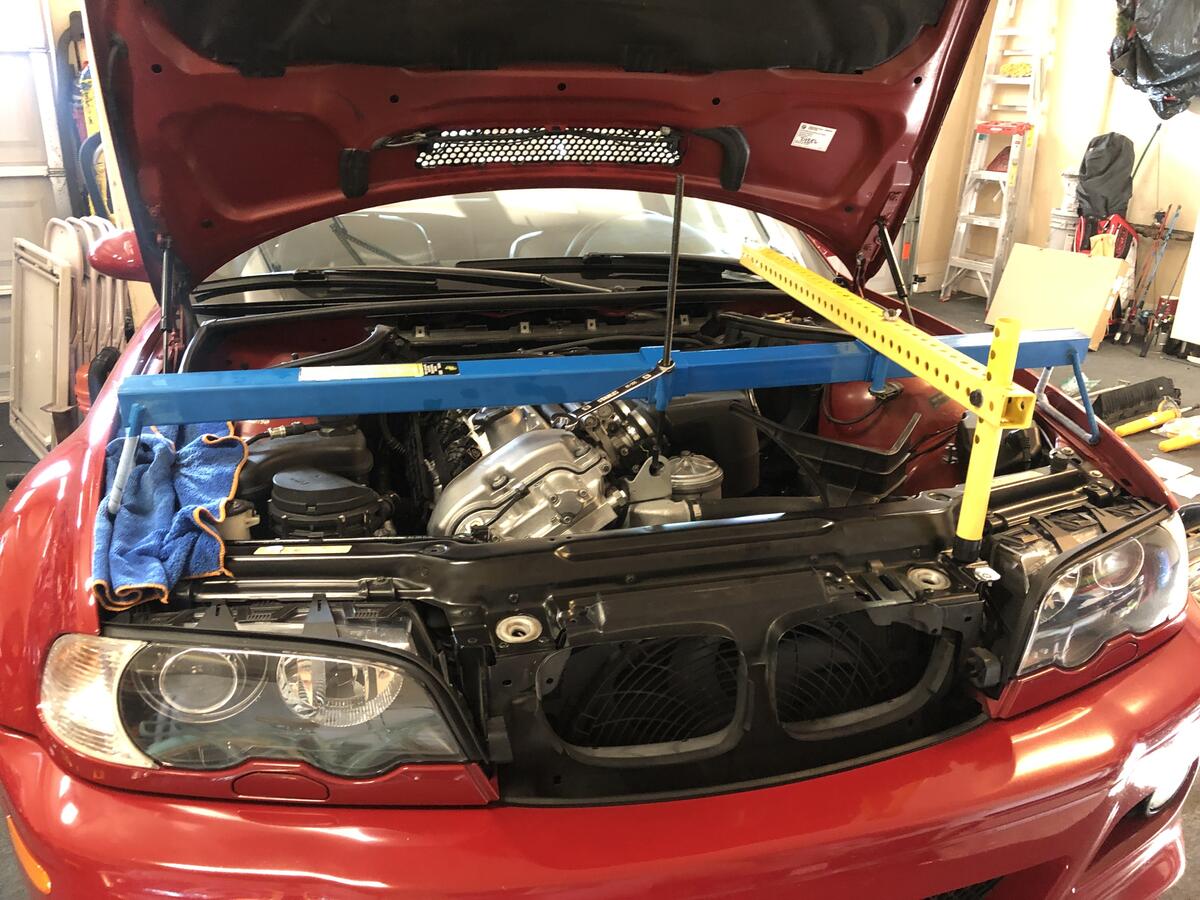

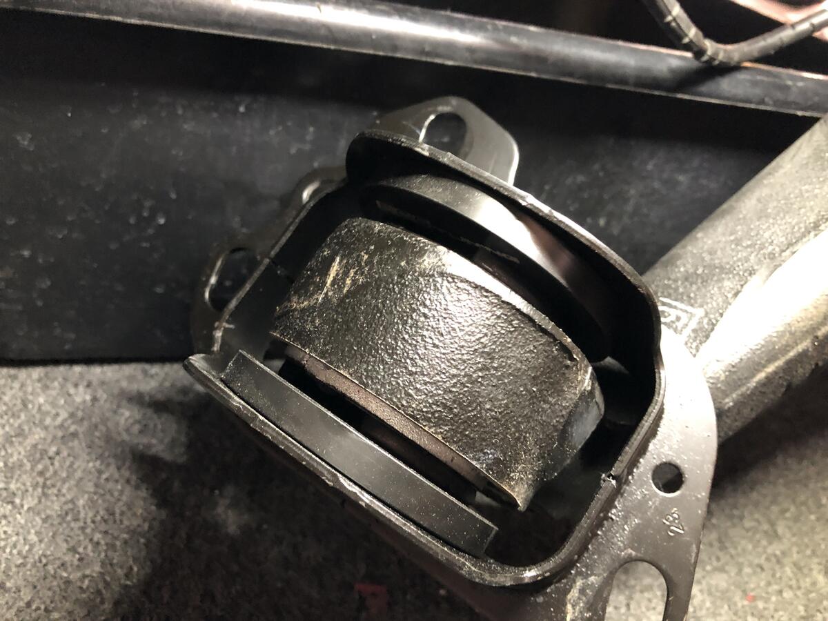

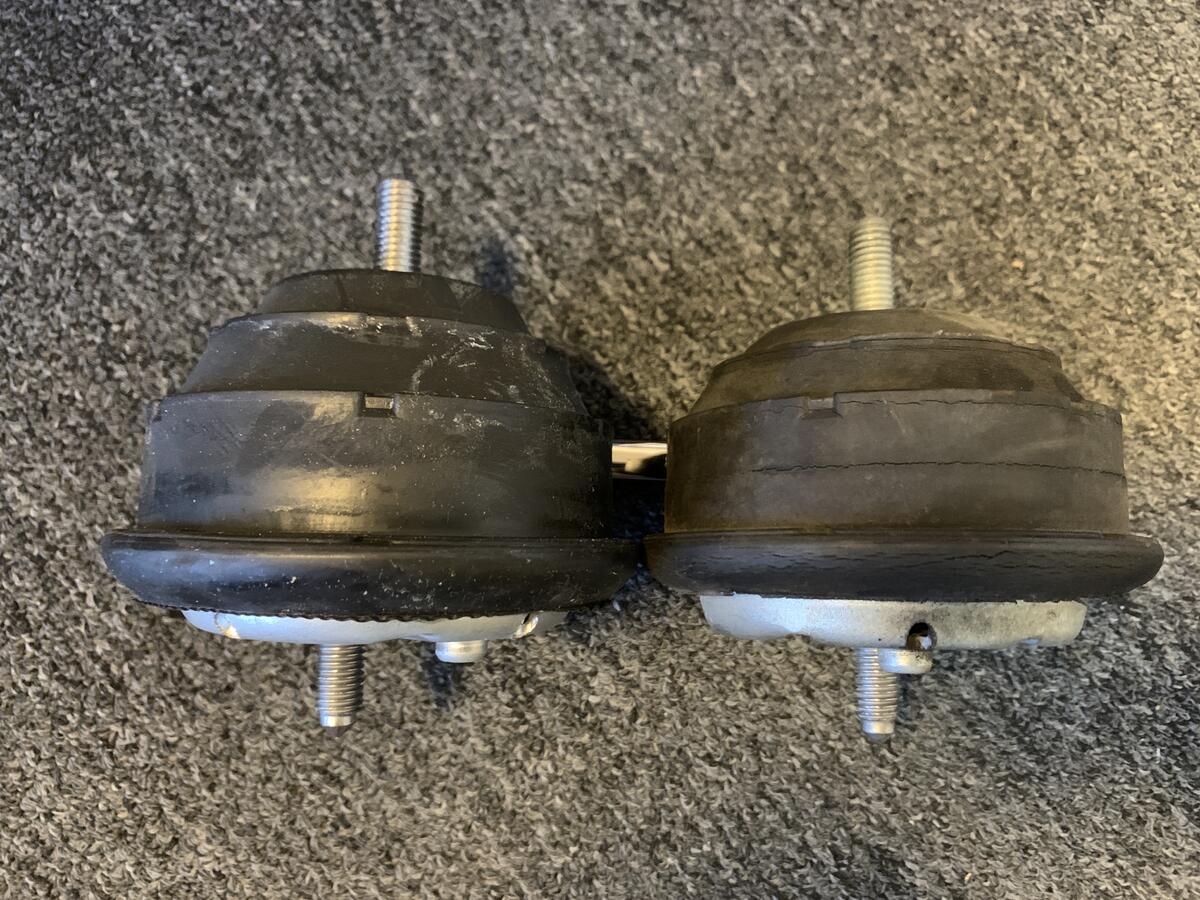

                Motor mounts severely smashed!
                Click image for larger version  Name:	8A6D0867-653B-4EAC-A9CD-AA4117C80CEE.jpeg Views:	0 Size:	209.2 KB ID:	52706
                Click image for larger version  Name:	D507BA32-6B50-4E2A-A096-56D8CDF626FF.jpeg Views:	0 Size:	283.3 KB ID:	52707
                Oil pan reinstalled
                Click image for larger version  Name:	903CCF10-42B1-4AA6-84E8-01BCAE1478A9.jpeg Views:	0 Size:	174.5 KB ID:	52708

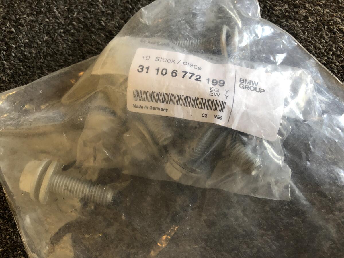

                Reinforcement plate bolts
                Click image for larger version  Name:	243DE80A-487F-4048-8EB7-3D6656C2EC7F.jpeg Views:	0 Size:	139.9 KB ID:	52711

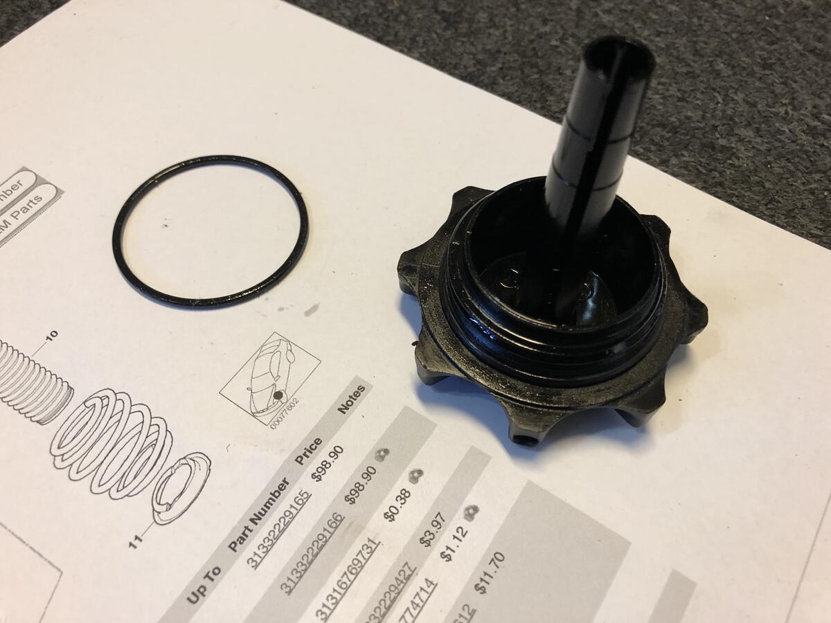

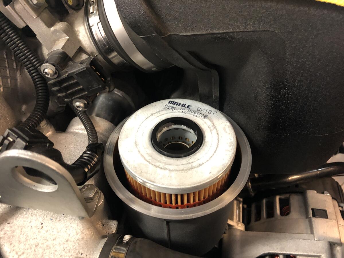

                New o-ring for the PS reservoir
                Add oil
                Click image for larger version  Name:	5B86DBD5-3AC1-4A3B-918C-E0EC8504C100.jpeg Views:	0 Size:	134.7 KB ID:	52716
                Let it warm up and check for leaks. Topped off oil and power steering ATF. All looks good and took it out for a spin. So nice and tight!

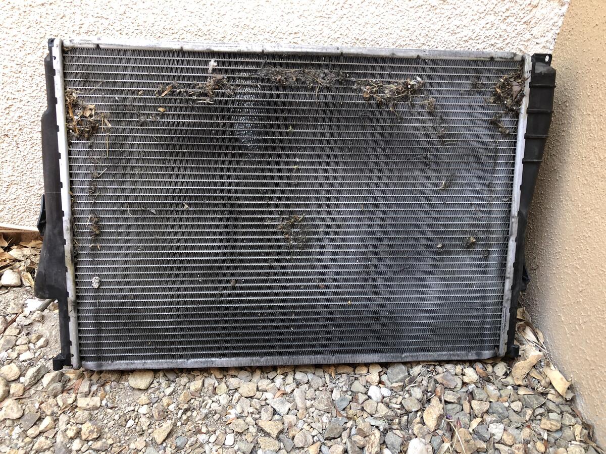

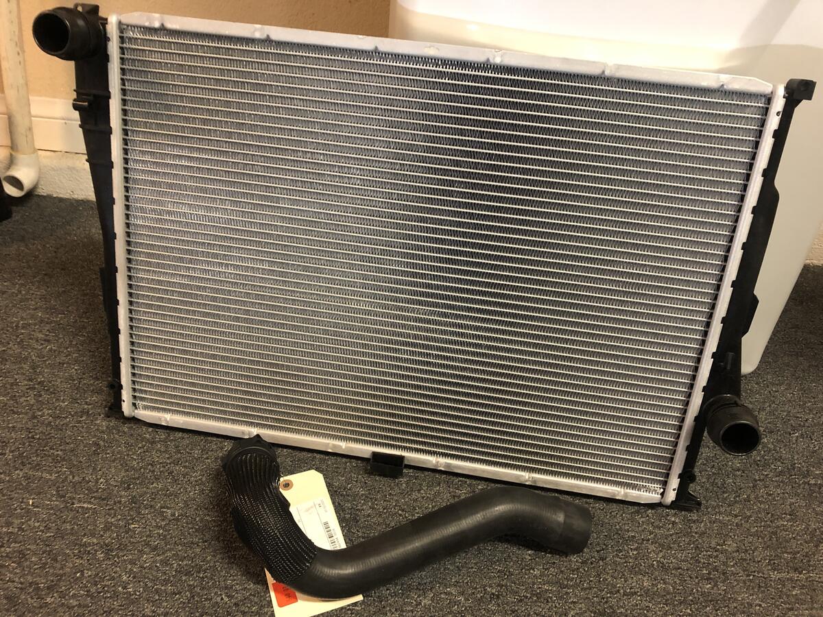

                  I replaced the radiator as it was the last piece of the cooling system left to replace. I was previously getting temperature creep while under load. Not enough to overheat but not how it should behave.
                  Bled out the cooling system and added distilled water and BMW blue. Problem is solved!

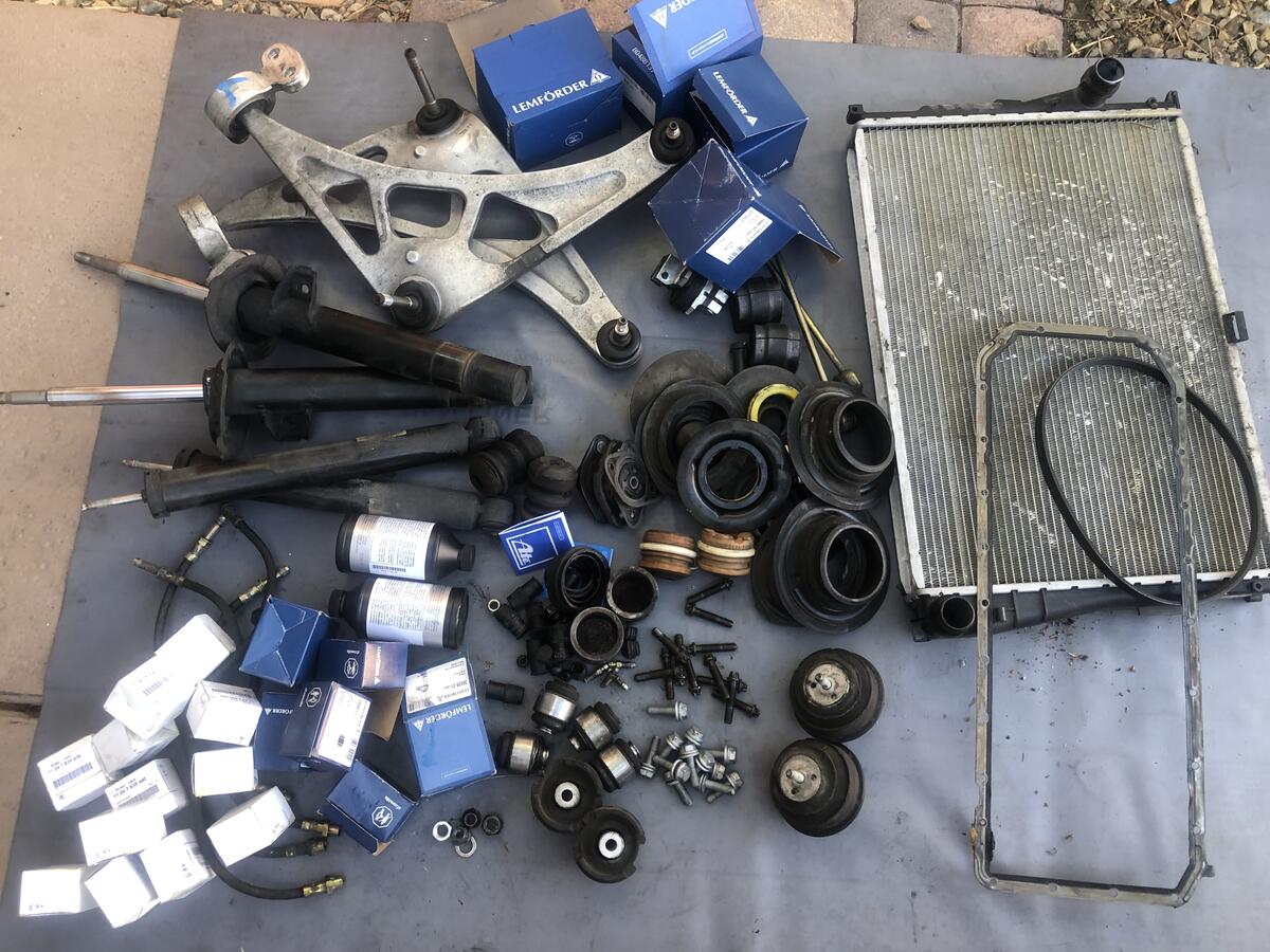

                    The aftermath
                    Not everything but a good chunk of it

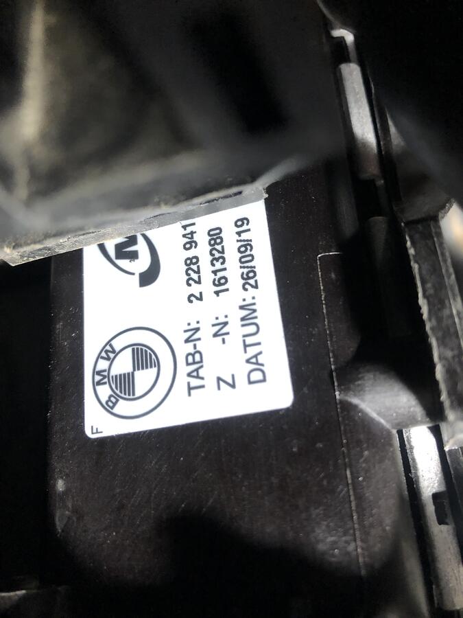

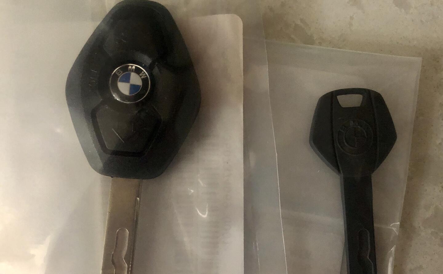

                      I only got one key with the car so I ordered another master and the plastic backup.
