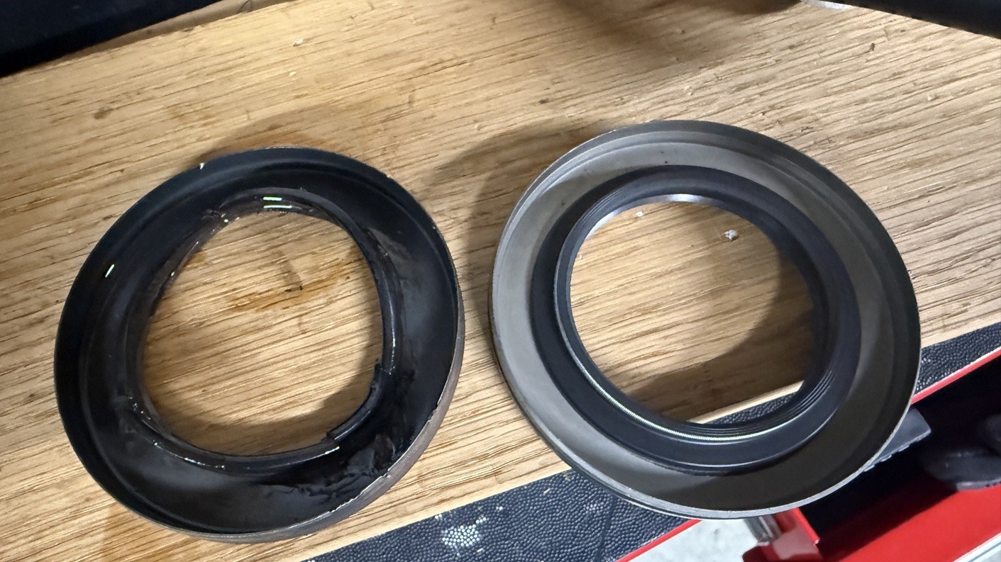

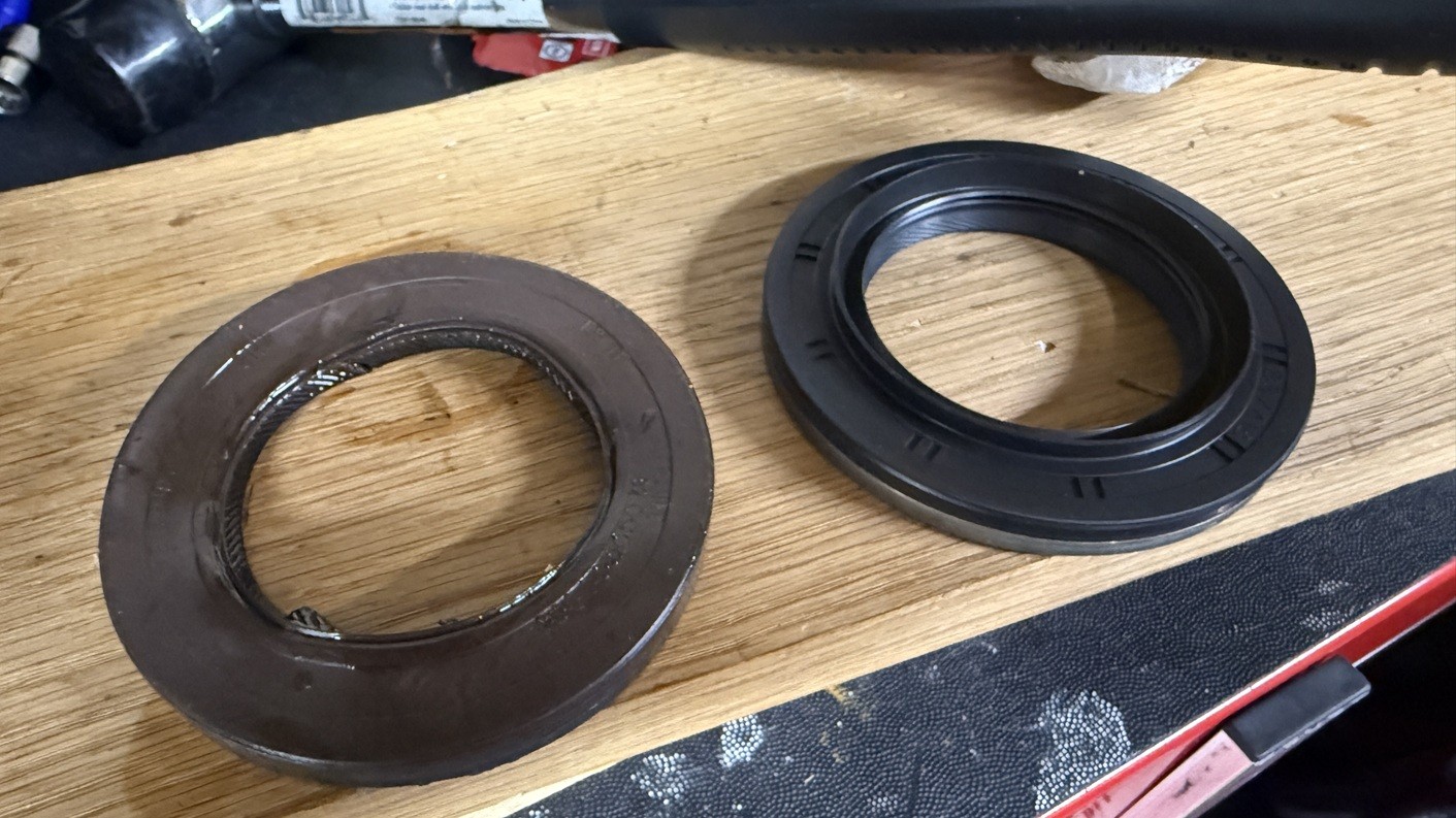

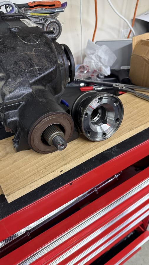

      Differential shaft seal replacement (for the convertible) and new hood struts (for the coupe). Shaft seal is the corteco part that is updated. Quite a bit more sturdy it would seem to me. New one has larger spring and a different lip. 9.5 turns to remove the shaft seal nut. 9.5 turns back on.
      Click image for larger version  Name:	IMG_1760.jpg Views:	0 Size:	309.3 KB ID:	571165
      Click image for larger version  Name:	IMG_1761.jpg Views:	0 Size:	297.9 KB ID:	571166

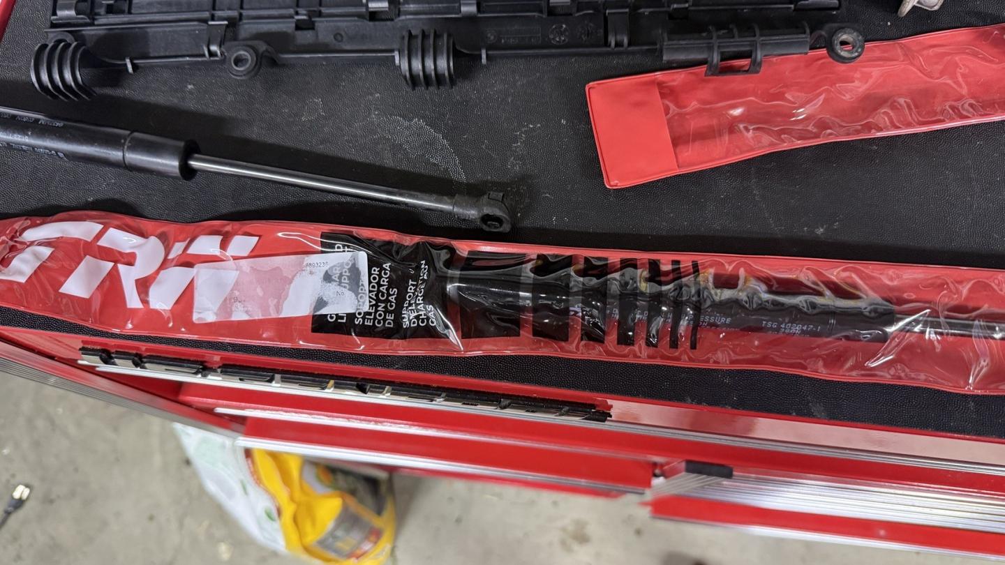

      These are the Stabilus (TRW owns now I guess) and what came factory. A third of the price as the BMW branded and work great.

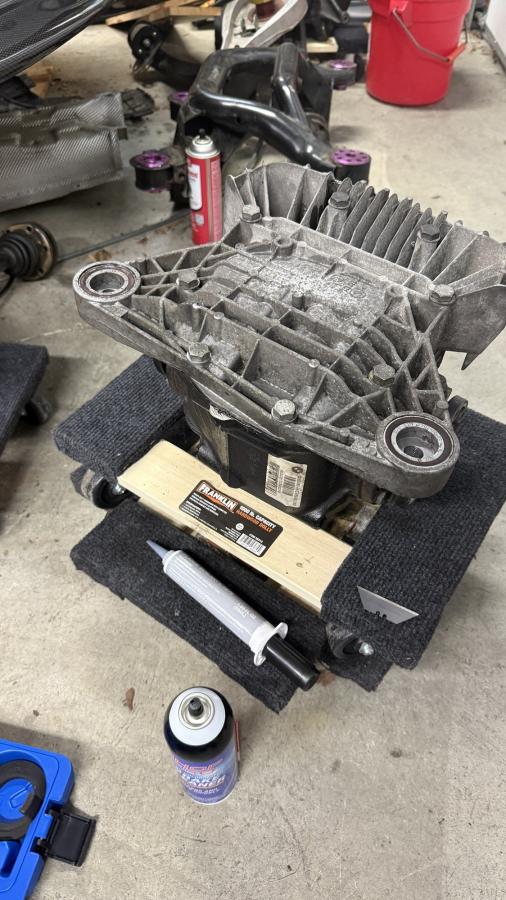

        Re-sealed the diff plate to the diff for the convertible using Loctite 5290. Cleaned the surfaces with a razor blade and brake cleaner prior. This one still had the original paper gasket so it was only a matter of time. before it leaked there as well.

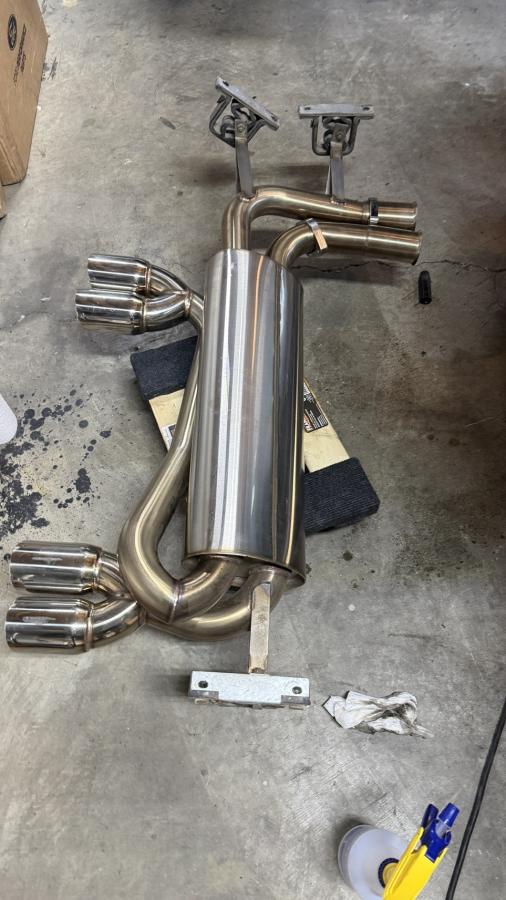

          Now that I've been running the euro exhaust setup for a while with the stock suitcase muffler I decided to swap in the rogue engineering el diablo. On U.S. headers, RE rasp pipe for section 1, and stock section 2 the el diablo droned like a MFer from 2200 to 3000 RPM.
          The drone is largely gone with euro headers, euro section 1, stock section 2. Interesting.
          Click image for larger version  Name:	IMG_1826.jpg Views:	0 Size:	74.7 KB ID:	613385
