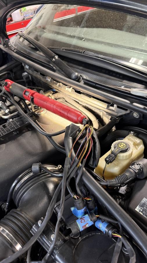

      Opened up the wire loom so I can drop the post cat 02 sensors down the drivers side of the engine. I need to get some corrugated tubing first, thought I had some, evidently not.
      My Innovate LC-2 Wideband AFR monitor arrives Monday, looks as though I have to weld on a new bung to the euro headers.

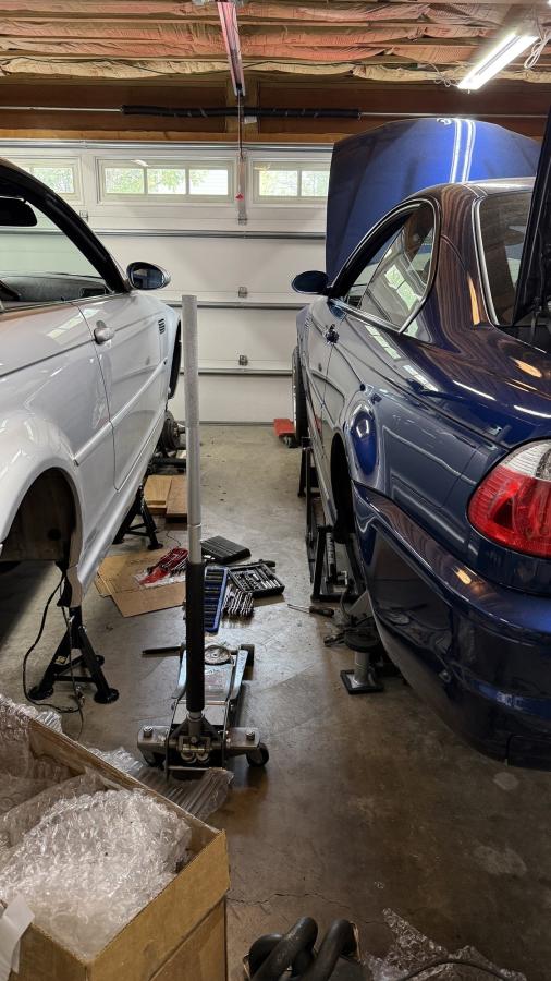

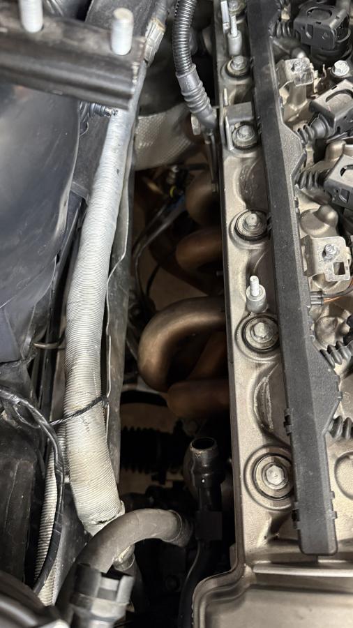

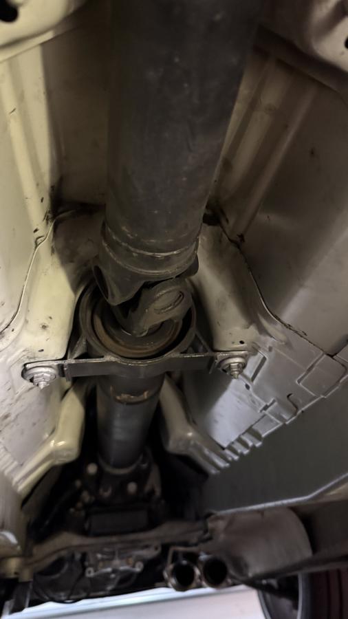

          Headers installed, bung welded in for the innovate wideband, driveshaft reinstalled plus I should have everything else back together tomorrow (big heat shield, section 1, section 2, plastic bits, wiring, etc.)

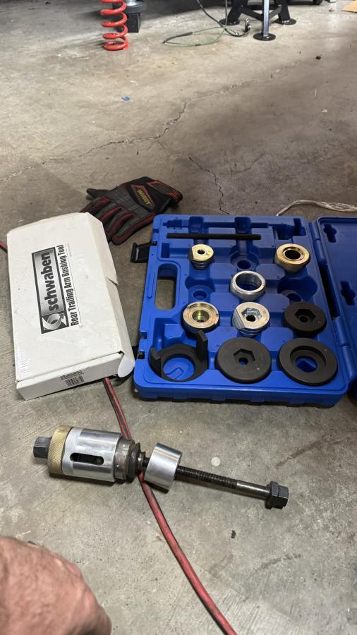

                This Bav tool makes replacing rear control arm bushings a breeze.

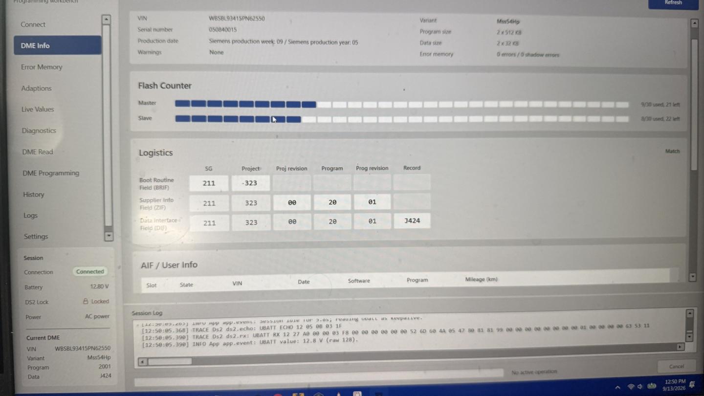

                  Since I now have euro headers and section 1 I installed the euro program/tune 211323002001J424.
                  1. Get the MSS54 DS2 Tool https://nam3forum.com/forums/forum/m...sh-counter-etc
                  2. Go to "DME Read" in the app.
                  3. Back up the Tune
                  4. Back up the program
                  5. Make sure your battery is charged and stable. I recommend power supply mode on a charger if you have one.
                  6. Download the Program "Full 211323002001J424.bin" from https://github.com/saildot4k/MSS54-X...20Full/MSS54HP
                  7. Download the Tune "211323002001J424 (EU3 6MT).bin" from https://github.com/saildot4k/MSS54-X...MSS54HP%20Bins
                  8. Go to "DME Programming" in the app.
                  9. Under "write program" select the "Full 211323002001J424.bin" you just downloaded and click "write program".
                  10. At completion I received an error message "program control: 'finalize programming' returned verify byte 0x0E. program and data references do not match'. I ignored this, perhaps because tune is not yet loaded.
                  11. I exited and restarted DS2
                  12. Go to "DME Programming" and under "write tune" select "211323002001J424 (EU3 6MT).bin" that you previously downloaded. Click "write tune".
                  13. You're done. You can check your version under "DME Info". Big thanks to karter16 and his helpers for creating this.​

                    Nice little DIY. Thanks.

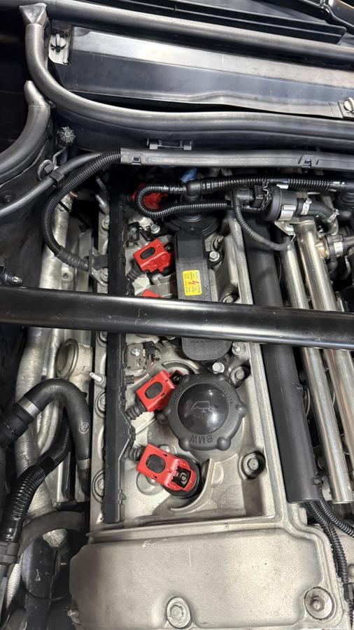

                      Nothing big today. Dinan ignition coils and new crankcase pressure regulator. Preventative maintenance. I'll keep the old one as spares. It was a mixed set of old and new which was fine, but i had the coils so why not.

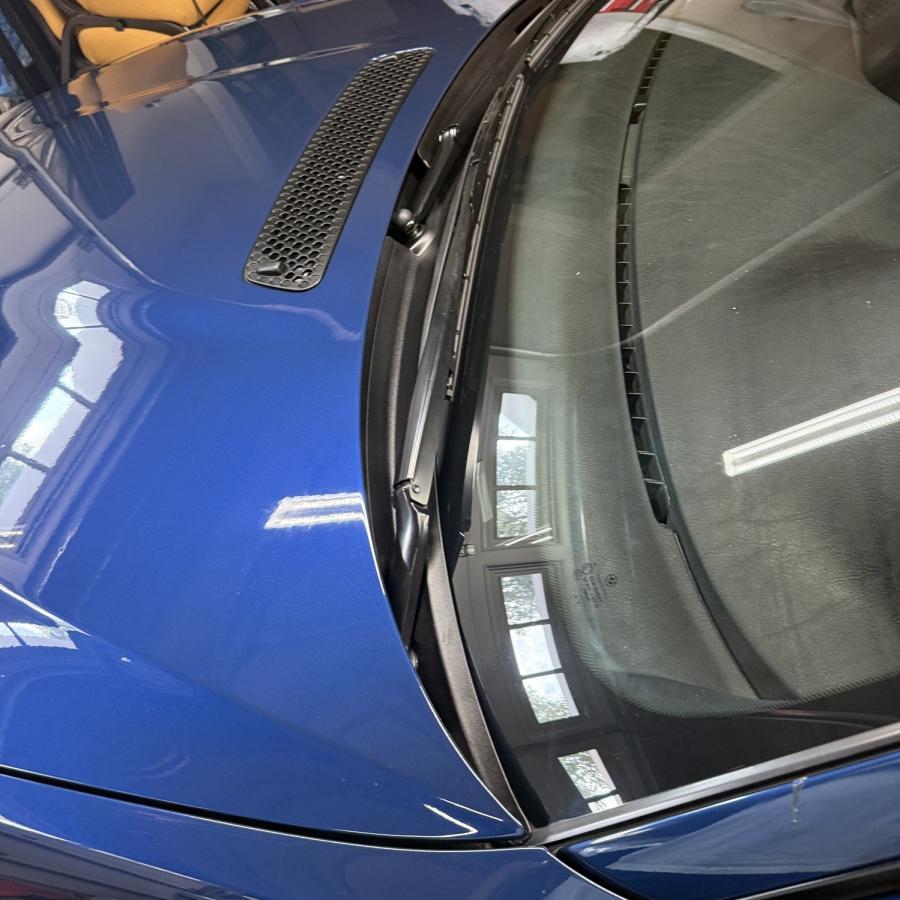

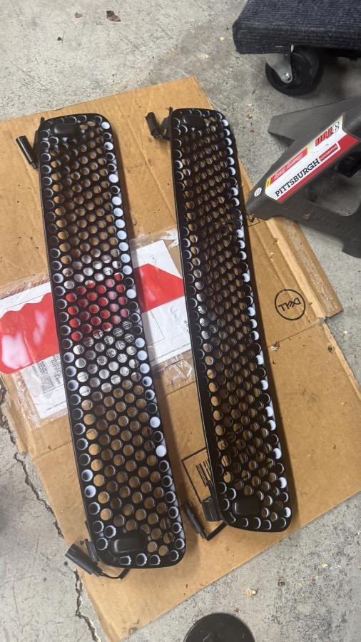

                        New windshield cowl and hood grill installed. Soaked both pieces in 303 for a couple of hours before install. I'll keep the old ones and I let them soak in 303 for a couple of hours as well.

                          Funny i ordered one too and its already on the way.

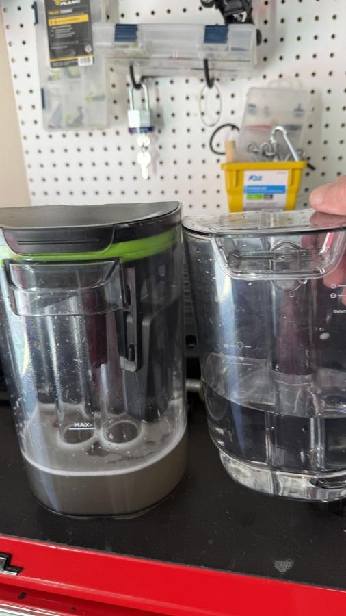

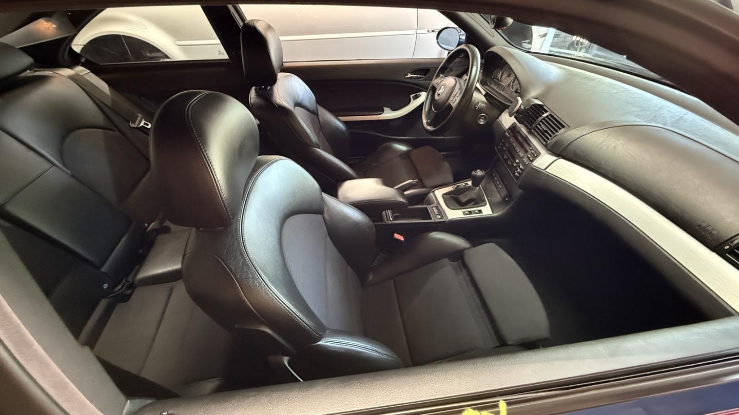

                            Seat cleaning day. I used a BISSELL Little Green Max Pet carpet cleaner and Chemical Guys Lightning Fast Fabric cleaner. Chemical Guys is pretty terrible, but this is one product that works well. I pretreated, wrapped a bristle brush in a microfiber towel. Agitated. Then used the Bissel. Clean water on the right, dirty water on the left. I repeated until there was no more dirt to be extracted.

                              Fantastic work!
                                #75
                                That looks fantastic, have the before photos? Mine have some nice discoloration I’d love to remedy if possible
