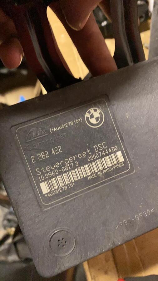

                            I don’t know what’s goin on, but this winter all my long time project goals with hard to acquire parts are coming together all at once. Not sure I’m going to have any more mods I want to do, come spring.

                                What am I looking at here?
