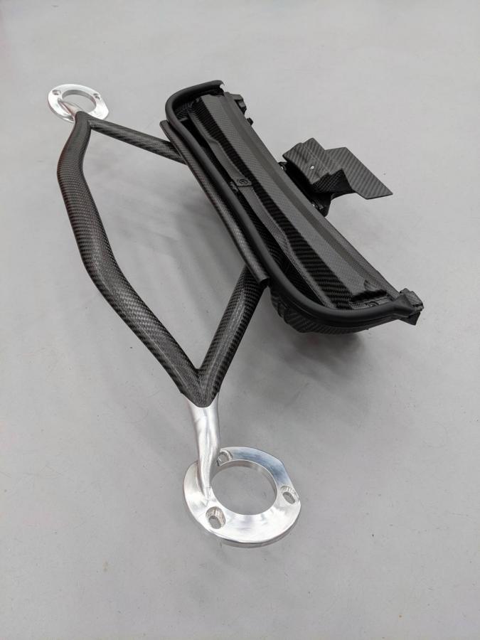

        SLON has made a front strut tower brace that triangulates loads to the firewall (as BMW has done on newer cars). The result of this is an 18-20% (depending on other mods and chassis condition) torsional rigidity increase (as actually measured on a chassis twister). More torsional rigidity is only better-- better handling, better ride quality, better grip, better NHV. In terms of making your car better, it's right up there with reducing weight. Speaking of reducing weight, this is also 5.5 lbs lighter than stock, on the front end of the car (where it's hard to remove weight).

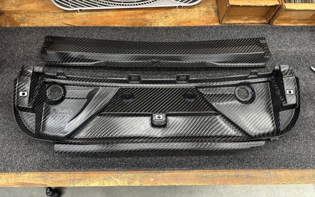

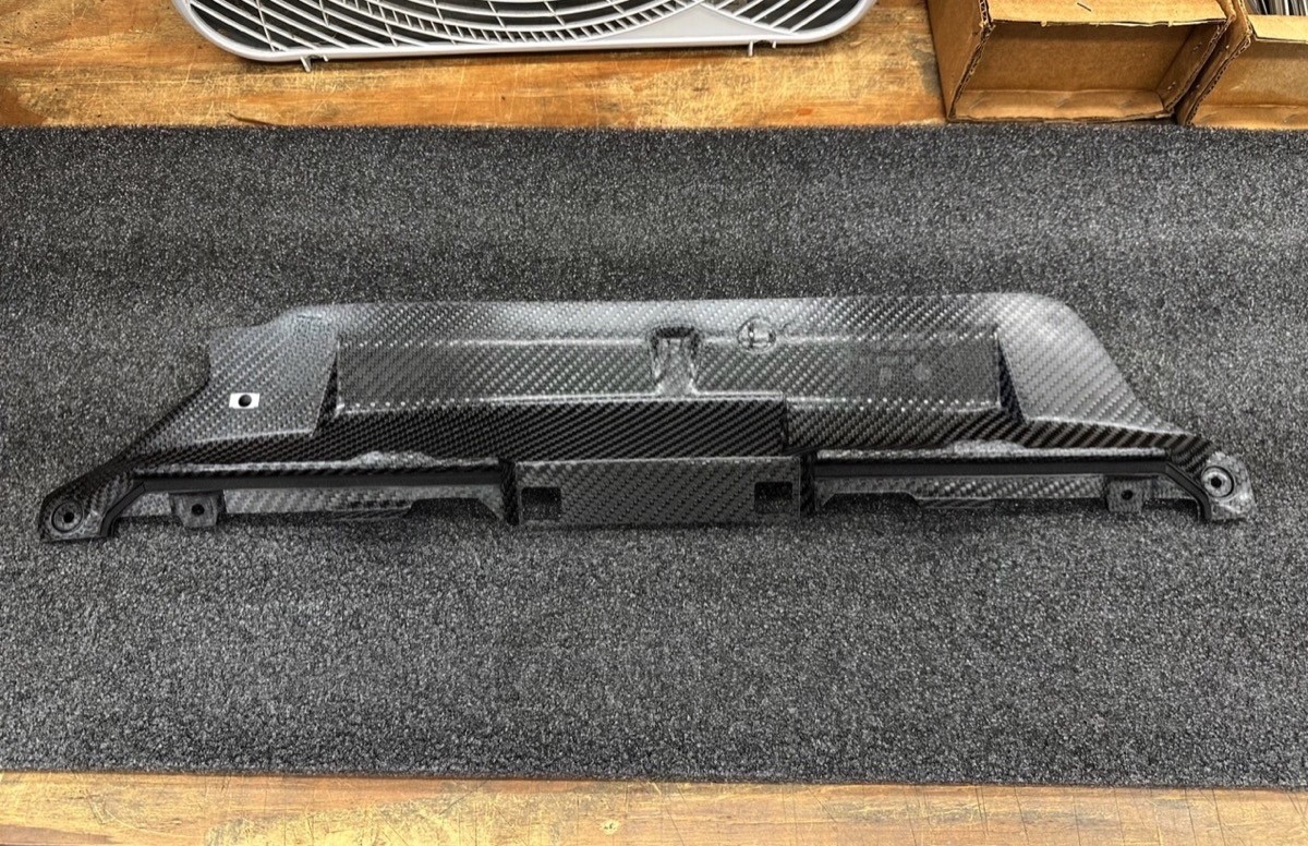

        This is how it assembles, so the part pictures make sense. The portion behind the cabin air filter housing is structural epoxied to the firewall. The cabin air filter housing needs to be replaced to create the clearance for the brace to fit:

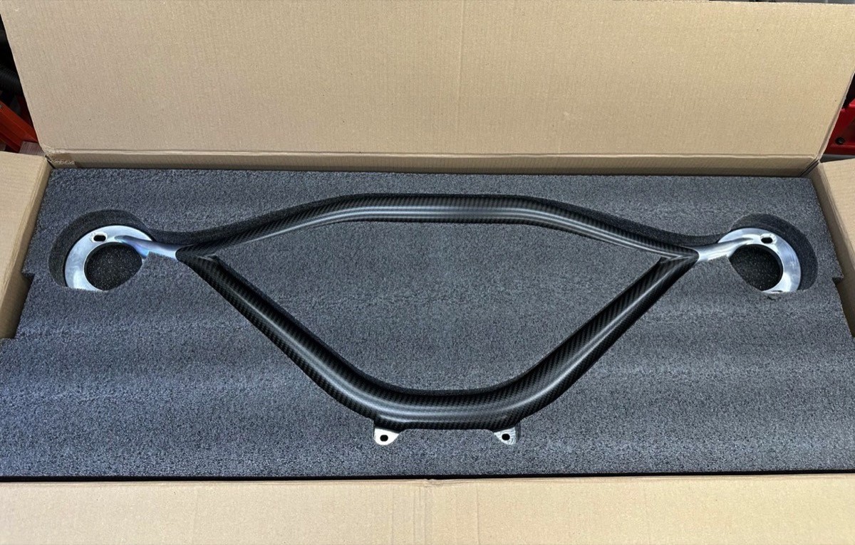

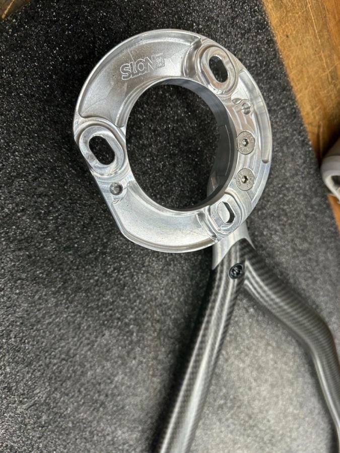

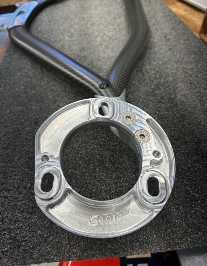

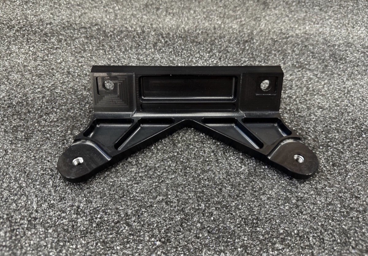

        These parts are like nothing I have seen in the aftermarket space, or professionally (I'm a product design engineer, in an automotive adjacent space). I hesitate to say it, because it sounds absurd, but they feel like I imagine F1 parts would feel. Super light, super stiff, super precise.

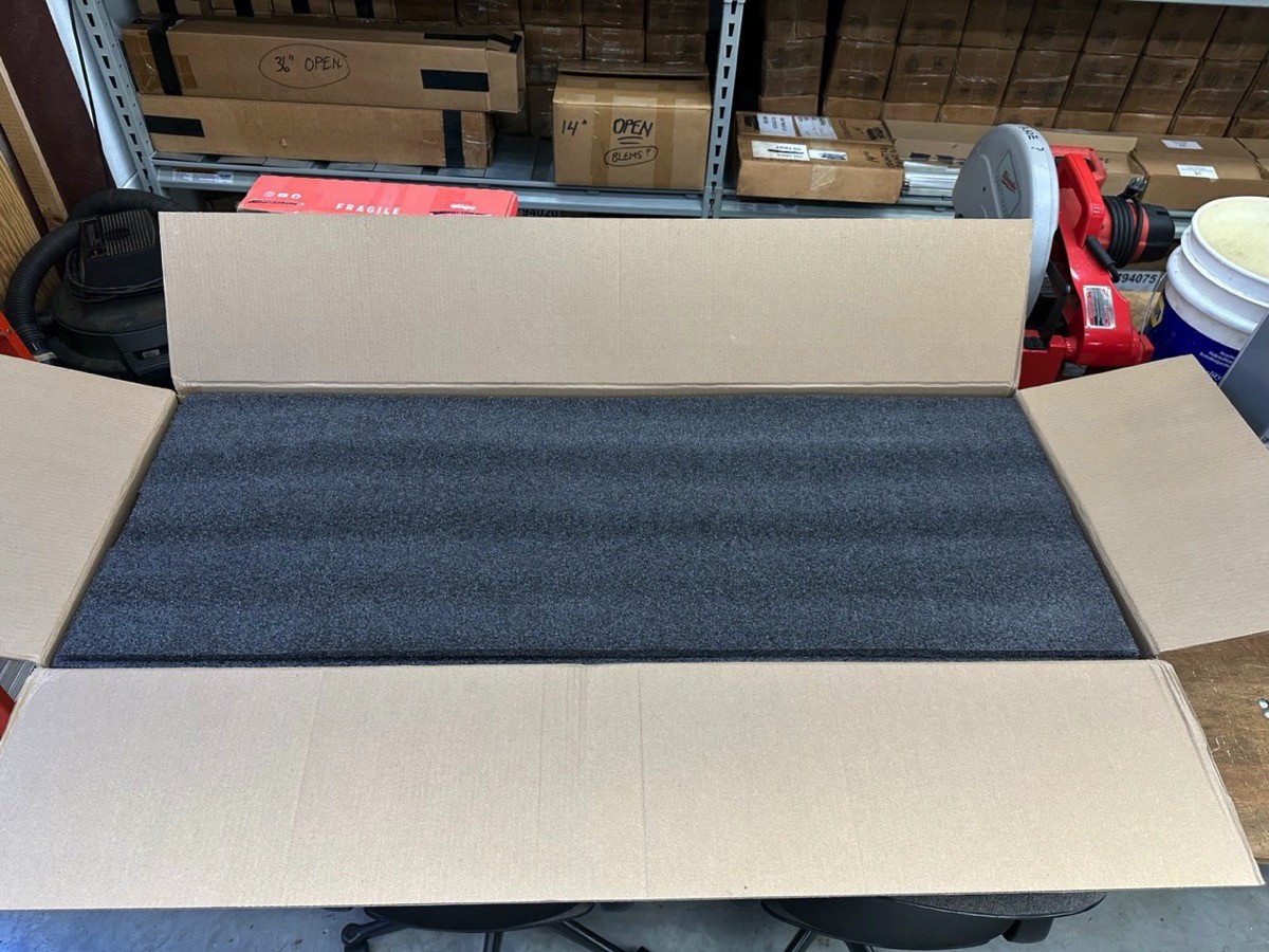

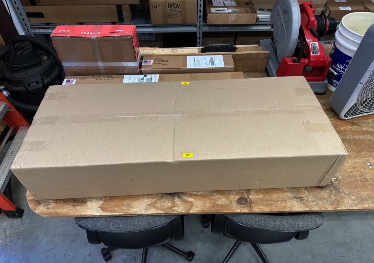

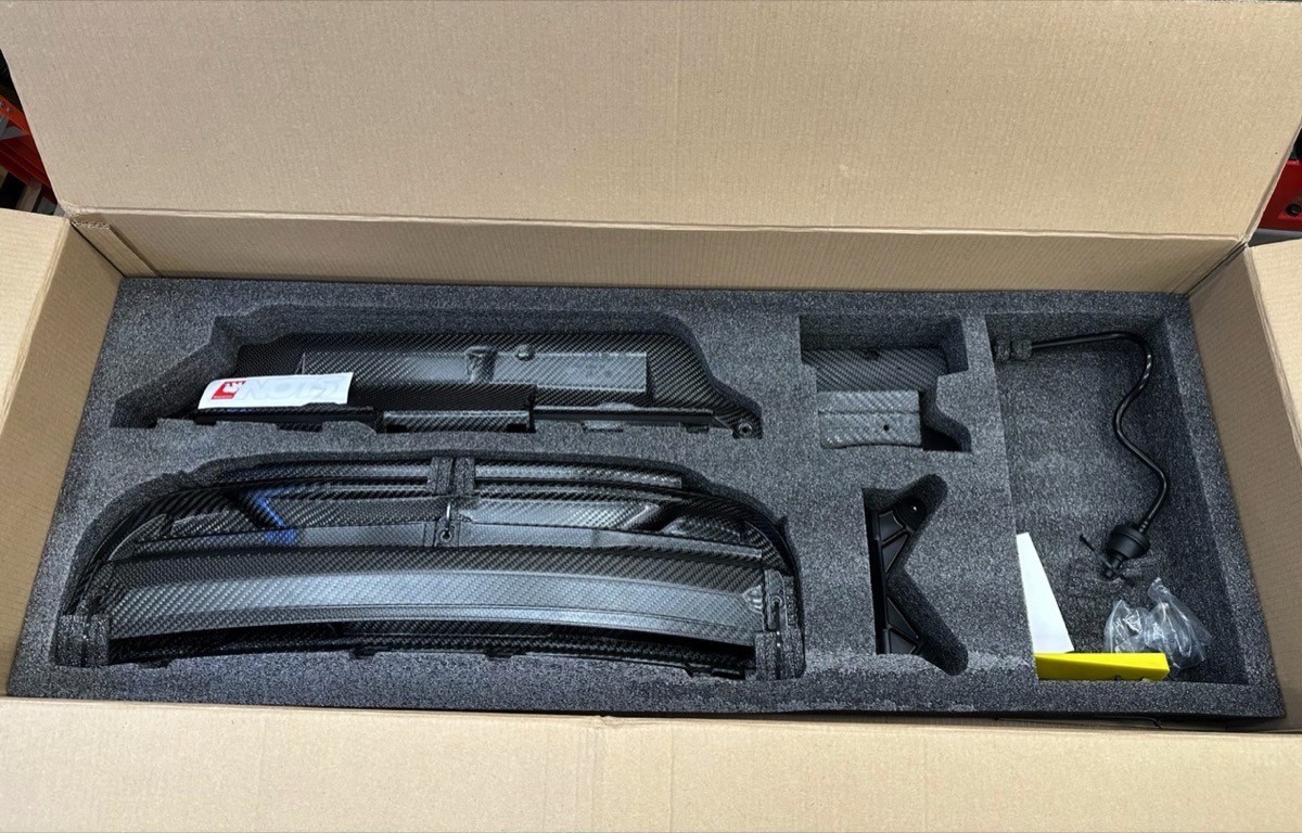

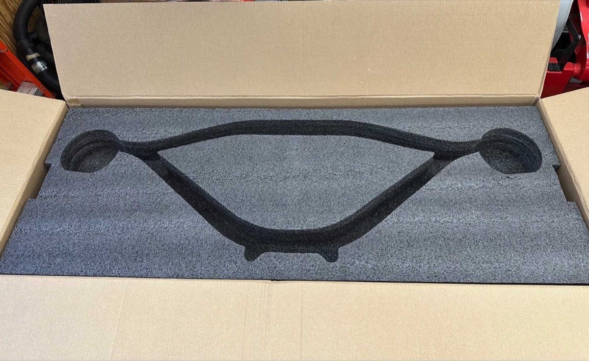

        They're also some of the best packaged parts I've received. Every significant part has it's own custom cut foam hole, so they can't damage each other. They'd have to come by a truly inept shipping company for any hard to come to them.
        Everything is absurdly rigid, all the alu parts are pocketed and ribbed, for weight and structure, and the CF looks perfect. Oh, and the cork filled carbon firewall plug is just next level (more on that)
        Pics:
        Click image for larger version  Name:	IMG_4605.jpg Views:	3 Size:	204.1 KB ID:	230168Click image for larger version  Name:	IMG_4606.jpg Views:	2 Size:	290.1 KB ID:	230169Click image for larger version  Name:	IMG_4607.jpg Views:	2 Size:	298.8 KB ID:	230170Click image for larger version  Name:	IMG_4608.jpg Views:	2 Size:	101.4 KB ID:	230171Click image for larger version  Name:	IMG_4609.jpg Views:	2 Size:	115.4 KB ID:	230172Click image for larger version  Name:	IMG_4610.jpg Views:	2 Size:	283.0 KB ID:	230173Click image for larger version  Name:	IMG_4611.jpg Views:	2 Size:	286.8 KB ID:	230174Click image for larger version  Name:	IMG_4612.jpg Views:	2 Size:	404.4 KB ID:	230175Click image for larger version  Name:	IMG_4613.jpg Views:	2 Size:	401.1 KB ID:	230176​​
        Click image for larger version  Name:	PNG image.png Views:	1 Size:	969.3 KB ID:	230022
        ^accurate mold, can still see the BMW stamp

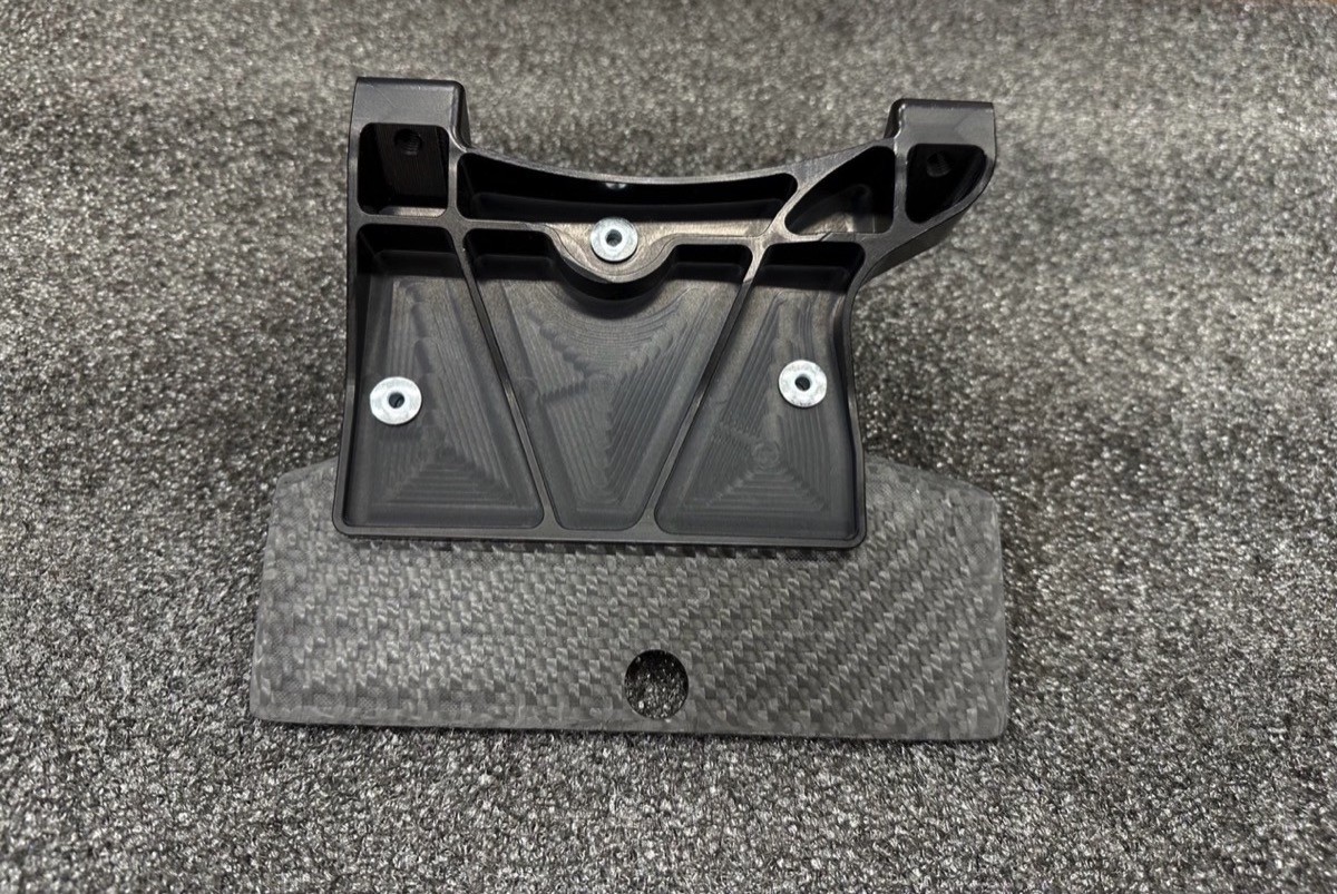

        Click image for larger version  Name:	IMG_4614.jpg Views:	2 Size:	436.0 KB ID:	230180
        This last part may be the most interesting of them all. The original version was pure carbon. A Space-X engineer, that's also a member on here (who I don't want to out-- he can self identify if he chooses), bought one of these of that version, and suggested it would be a more effective thermal barrier if it was sandwiched cork, as they do rockets. SLON tested that out, and the results were as below:
        ^stock vs carbon vs carbon/cork/carbon
        So, that got integrated into the design (and the member who suggested it received the updated version).
        Amusingly for me, that probably means I'll get a comfort upgrade out of this-- I have been running the (NLA) CSL cabin air filter housing for a decade now, and it's lighter but same material as stock-- so presumably it's just thinner, and a worse thermal barrier as a result.

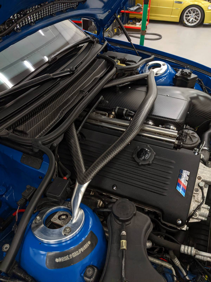

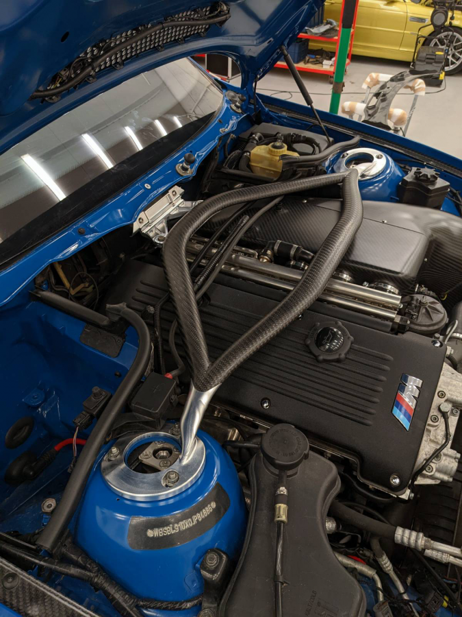

        Not my car, but this is how it should look when done:
        Click image for larger version  Name:	2.png Views:	1 Size:	973.6 KB ID:	230023 Click image for larger version  Name:	3.png Views:	1 Size:	942.4 KB ID:	230024

            Very Nice! Love it. I wonder if SLON can make the cabin air filter housing for those of us that do not want to use their strut bar.
              Obioban
              When you say “The cabin air filter housing needs to be replaced to create the clearance for the brace to fit”, does that mean SLON provides a modified air cabin filter box with this kit?

                Correct.

                  Still using the OE Cabin filter element?

                        No I meant the actual FILTER element
                          Oops, read that too quickly.
                          Yes, this still uses the OE cabin filter element.
                            Oh That's great! Thanks.
                            Now if Sloan are going to make the cabin filter housing using the same technique for people who do not want to go for their full strutbar kit.....
                              The carbon looks to be flat finish. Do they offer gloss finish if it is in fact flat?

                                It is, they do. I opted for flat.
