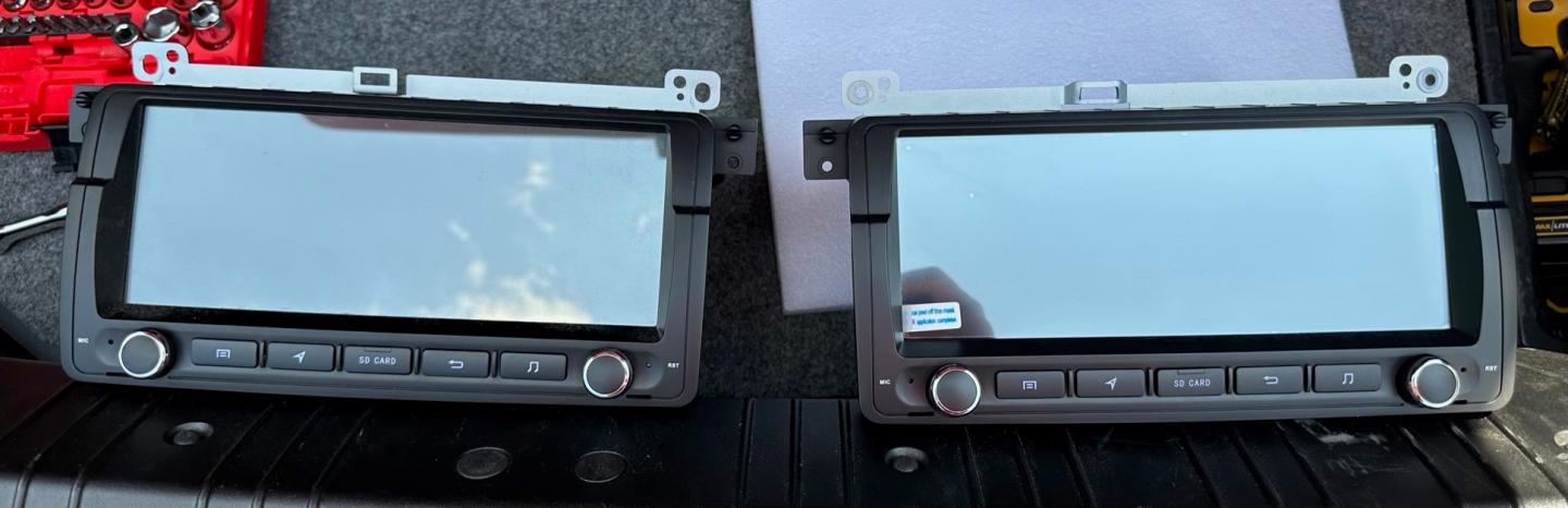

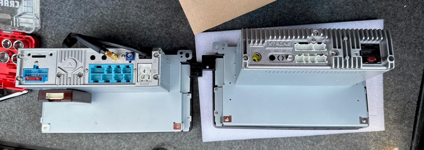

        I was replacing my Avin (because, being the high quality Chinese unit it is, it has decided that it won't turn on if it's a little chilly out) with an Xtrons, and was kind of surprised that the two units were seemingly different inside.
        Fronts (Identical):

        Rear (unrelated, everything in different locations):

        Also, the new unit has internal wireless carplay, instead of a dongle.
        I'm sure it's pissing into the wind, but I selected this particular unit over Xtrons other offerings (or another Avin) because it supposedly uses automotive grade internals. We will see...

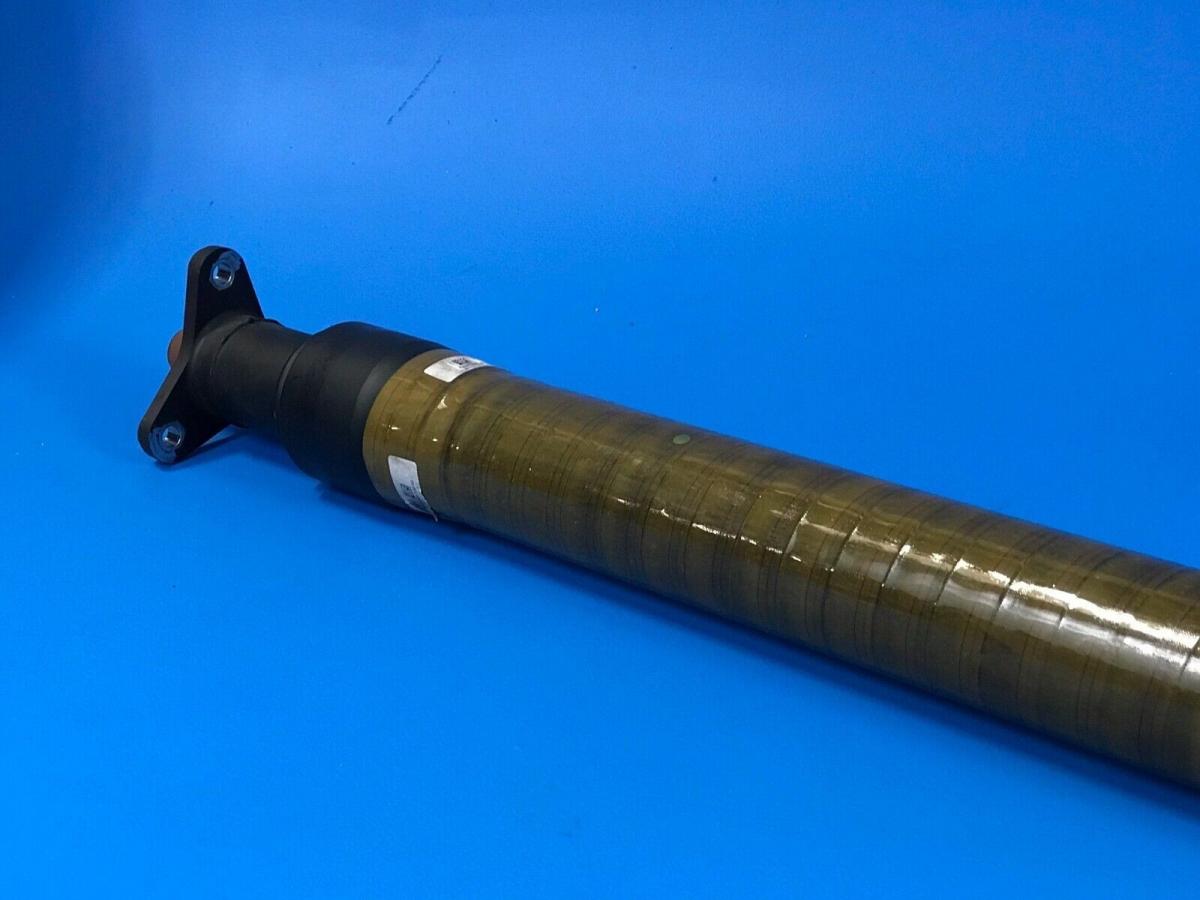

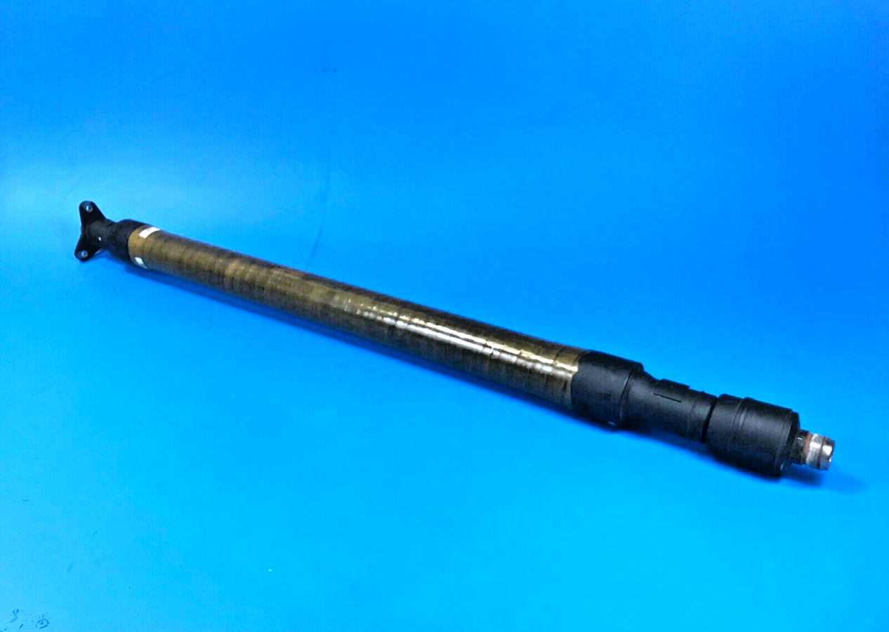

                        Just bought a used F8X driveshaft. Going to follow Altaran's lead and put e46 M flanges on it, for a hopefully OE qualify CF driveshaft on the cheap.
                          When I saw what Altaran did I actually thought of you as I figured six seconds would elapse between you seeing it and you buying one. lol
                            I'm very tempted to do the same, just a bit scared of the increased labor required to get the driveshaft on and off. Looking forward to the reviews.
                              I don't know how to feel about being so predicable.
