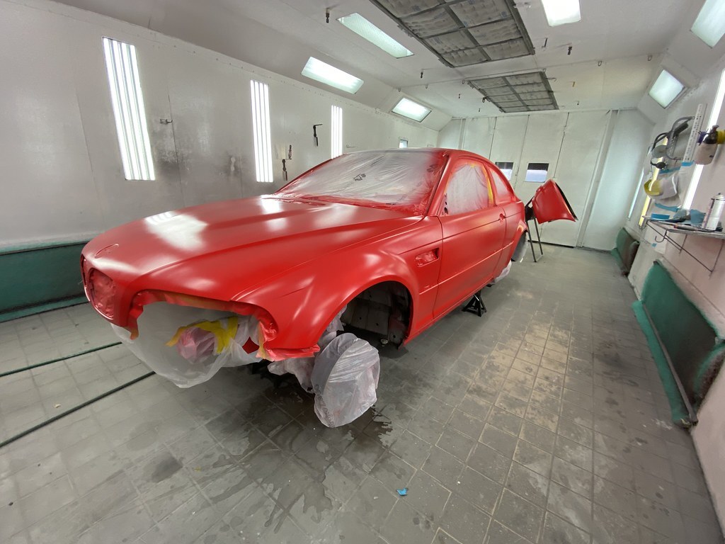

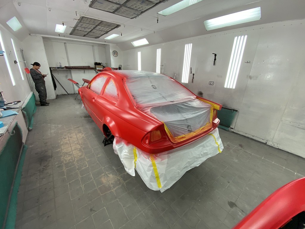

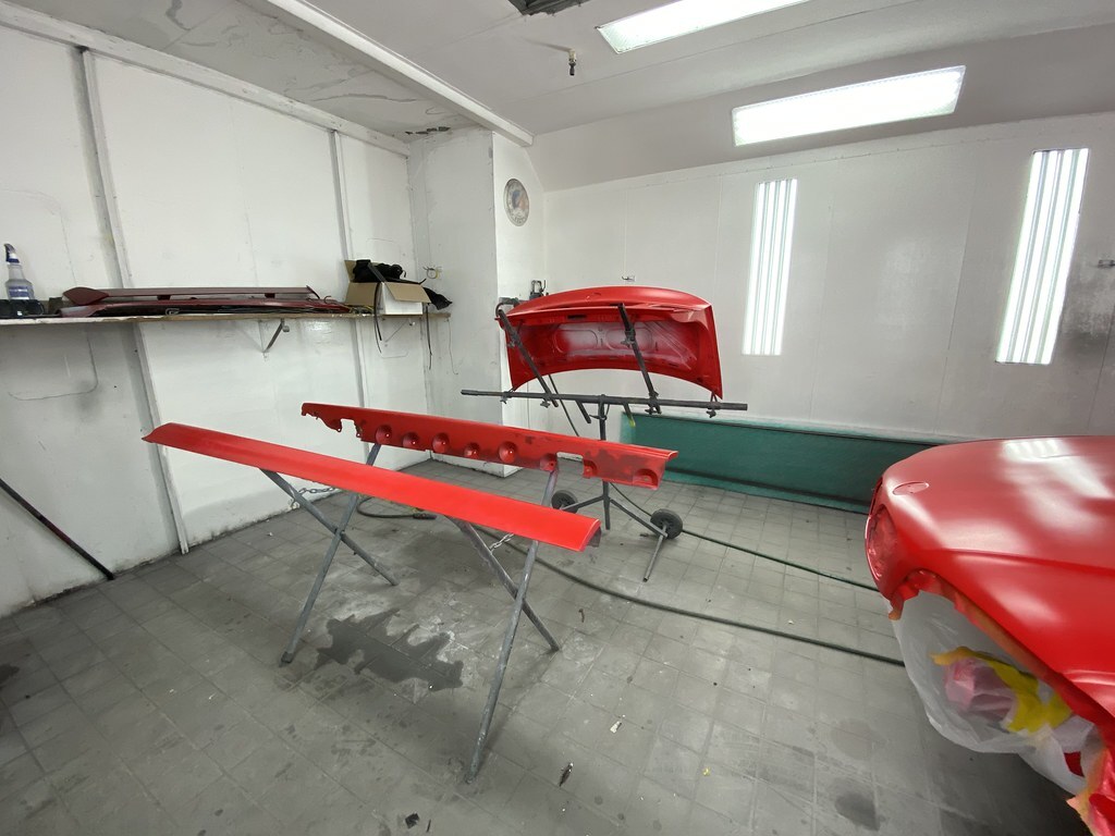

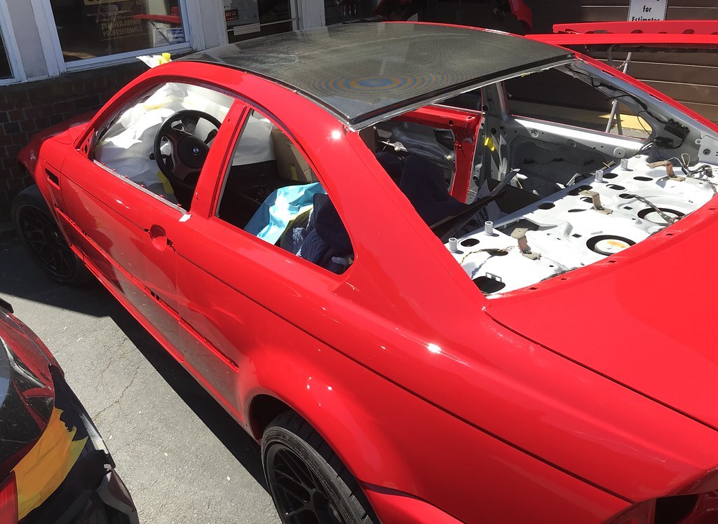

                      In May things finally started to open back up in the NYC area and the M3 entered final paint stages. Mario kept me updated with a lot of pics 👍
                      Click image for larger version  Name:	49883068658_7d18007068_b.jpg Views:	0 Size:	138.2 KB ID:	48907
                      Click image for larger version  Name:	49883902402_4954a917c0_b.jpg Views:	0 Size:	133.3 KB ID:	48908
                      Click image for larger version  Name:	49883068548_23a3ca146b_b.jpg".jpg Views:	0 Size:	125.0 KB ID:	48909
                      After the final coats of clear I was able to make it up to the shop and see it day light for the first time in 7 months. And yeah, exceptionally happy with the results!

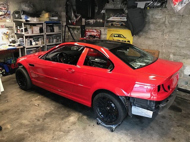

                      The next step was to get the car back to my garage for initial assembly and giving time for the paint to fully cure. The plan is to take it back to Mario once I get it rebuilt enough to drive so he can do final touchups and polish. So in late June we loaded it up and got it back to its home in The Bronx.
                      Click image for larger version  Name:	50066058476_09ba76556f_b.jpg Views:	0 Size:	285.9 KB ID:	48911
                      Let assembly begin!

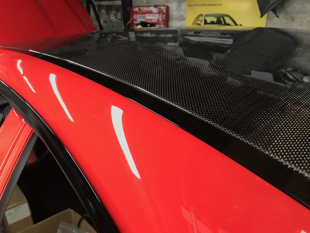

                      Had to get a shot of that roof 🤤

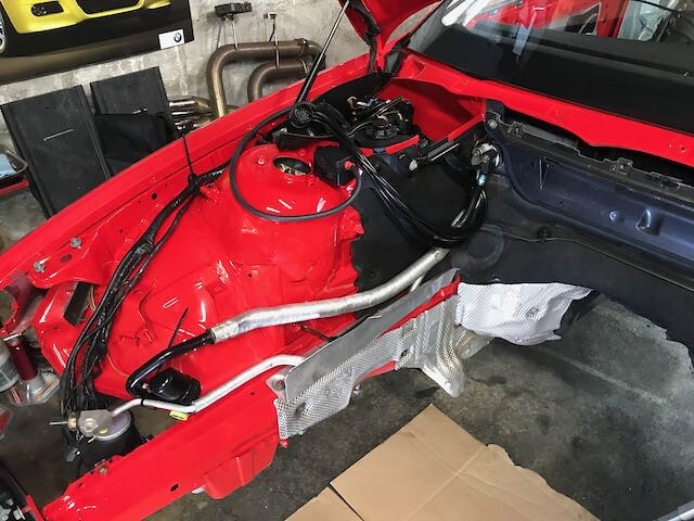

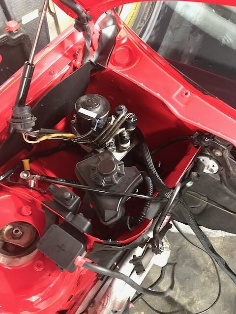

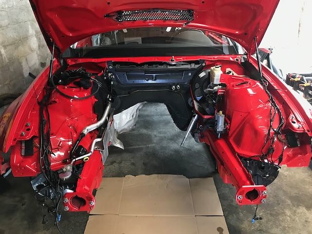

                        First major goal was to get the engine and transmission back in the car. Before I could do that had to knock out a couple small projects: Clean up the wiring harnesses, install new water hoses and a/c lines, and relocate the SMG pump. There were a couple brittle plugs on the harness as well as some plastic loom that was torn up. So anything that was suspect I replaced, got pretty good a de-pinning plugs!
                        Click image for larger version  Name:	49480264916_d84674119f_b.jpg Views:	0 Size:	53.6 KB ID:	48941

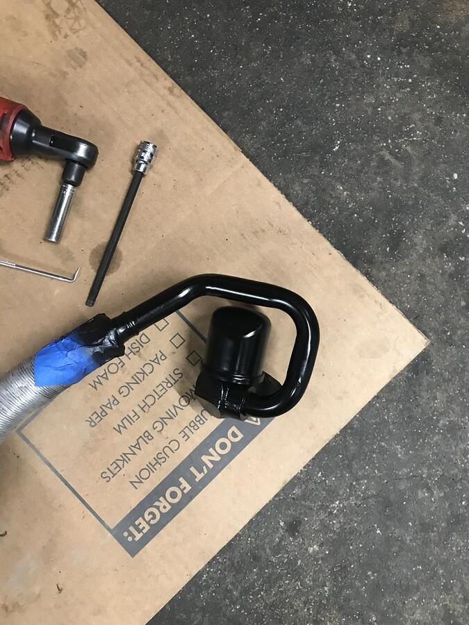

                        Cleaned up all of the a/c lines and repainted connections chassis black:
                        Click image for larger version  Name:	50066058306_25e14c4f26_b.jpg Views:	0 Size:	103.9 KB ID:	48942
                        Hoses and insulation back in. Spent a ton of time cleaning the metal insulation:
                        Click image for larger version  Name:	50155929053_b86be7bbe5_z.jpg Views:	0 Size:	77.1 KB ID:	48943

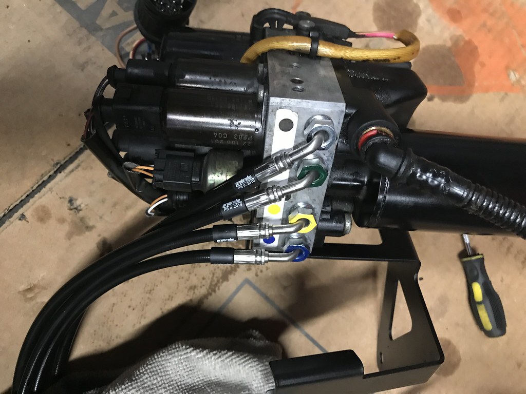

                        Finally got the SMG pump relocated to the drug bin using the Burkhart Engineering kit. Very nice solution and the hydraulic lines run very nicely across the back of the engine bay using the same mounting point that the '01-'02 MK20 cars use for brake/abs lined (but aren't used on the '03+ MK60). Powder coated all of the brackets black and it look pretty OE imho:

                        Click image for larger version  Name:	50155928973_2a08eb32e4_z.jpg Views:	0 Size:	76.6 KB ID:	48944
                        Ready for an engine 👍👍

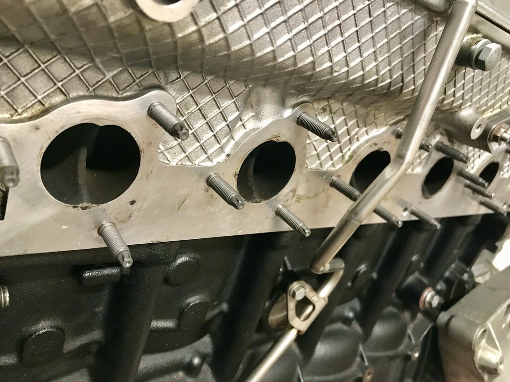

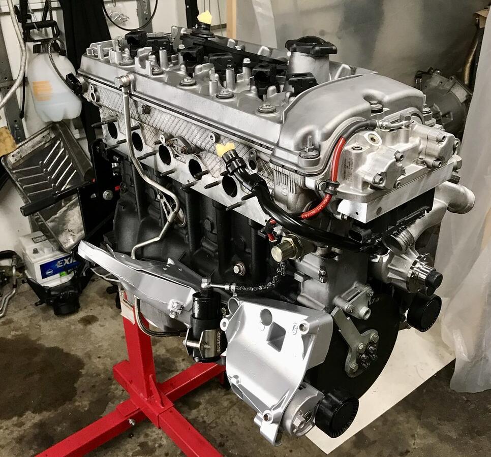

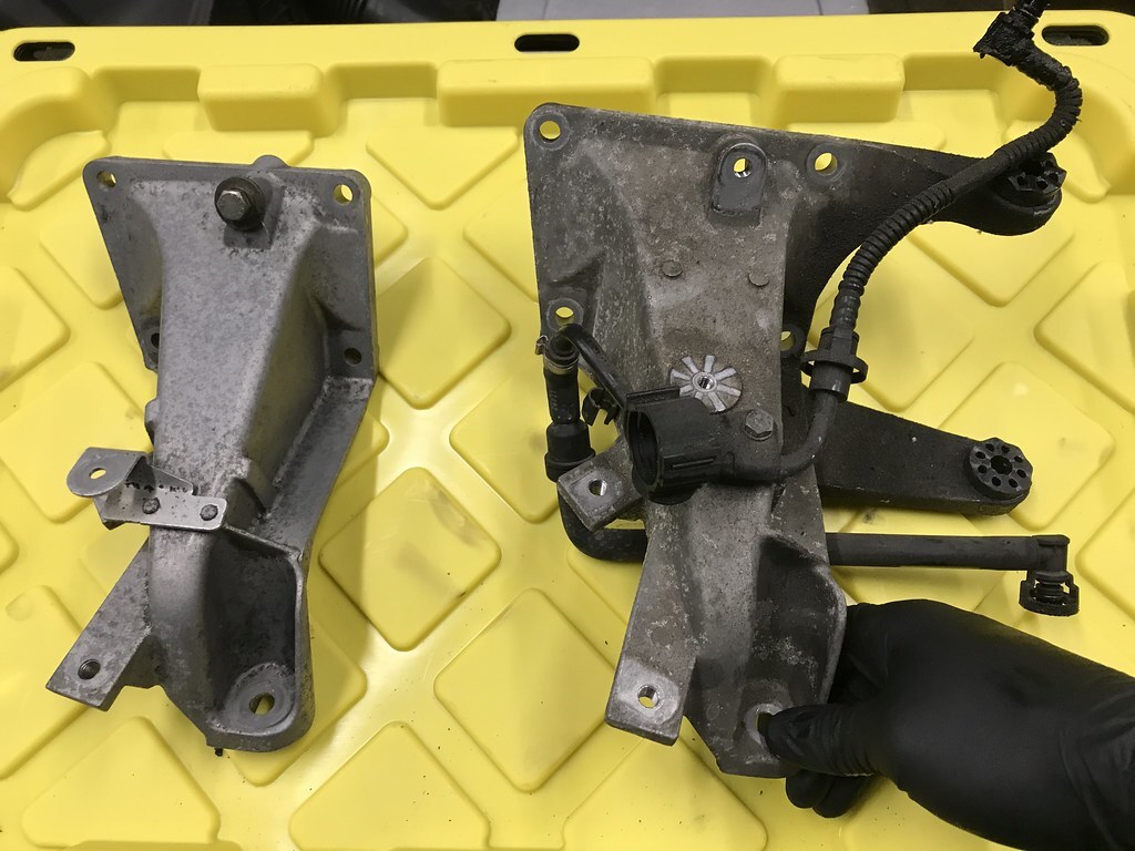

                          Next a couple of finishing touches on the engine as well as some items that have to wait until its on the hoist. With the SMG relocated I swapped to a non-SMG engine mount bracket and also trimmed up the coolant res bracket. Then decided to go ahead and do another round of powder coating:
                          Click image for larger version  Name:	49205603596_7e3f84e221_b.jpg Views:	0 Size:	146.1 KB ID:	48948
                          Click image for larger version  Name:	49745867621_8d5174f22c_b.jpg Views:	0 Size:	73.8 KB ID:	48947
                          Went ahead and installed a new water pump, pullys/tensioners, front main seal, header studs.
                          Click image for larger version  Name:	49219463687_7353a34999_b.jpg Views:	0 Size:	180.9 KB ID:	48949
                          So clean!
                          Click image for larger version  Name:	49883597031_cef70c2abb_b.jpg Views:	0 Size:	159.5 KB ID:	48950

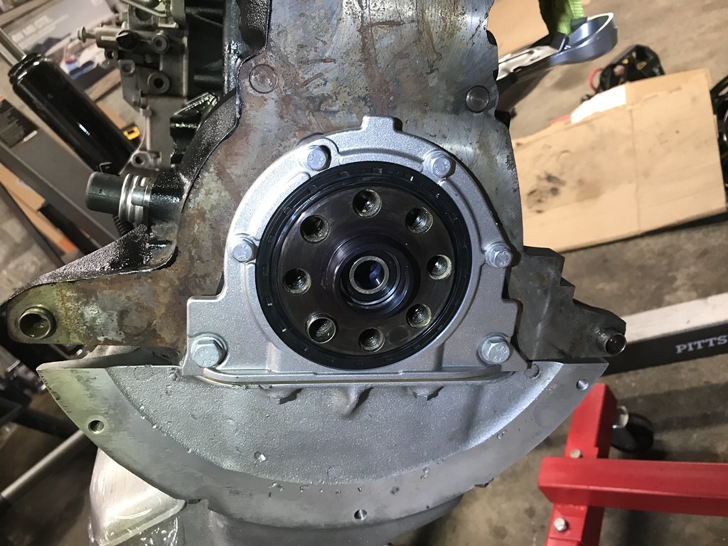

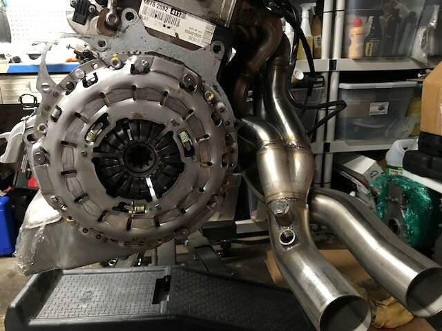

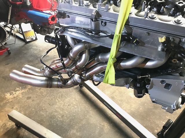

                          With the engine off of the stand and on the hoist I installed a new rear main seal, pilot bearing, clutch and flywheel. Also new Supersprint V1 fully stepped headers. Much easier to mount these prior to putting the engine in, just have to be very careful not to tweak them installing the drivetrain in the chassis.
                          Click image for larger version  Name:	49745867661_4b461796c6_b.jpg Views:	0 Size:	197.0 KB ID:	48951
                          Click image for larger version  Name:	50156487961_9ee88b897b_z.jpg Views:	0 Size:	83.2 KB ID:	48952
                          Click image for larger version  Name:	50156487976_6050777bcf_z.jpg Views:	0 Size:	74.9 KB ID:	48953

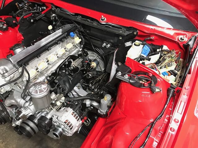

                          Soooo much easier to do this with an SMG. No shifter linkages to deal with. Just slide the drivetrain in, get the sub frame bolts started, drop the engine onto the engine mounts (easy with quickjacks), then install the trans mount bolts and tighten everything down. Drive train back in!!
                          Click image for larger version  Name:	50155929193_4a3314fd9e_z.jpg Views:	0 Size:	77.9 KB ID:	48954
                          Hooked up the engine harness and installed the alternator, throttle actuator and new starter motor.
                          Click image for larger version  Name:	50156720232_e129da2a94_z.jpg Views:	0 Size:	101.8 KB ID:	48955
