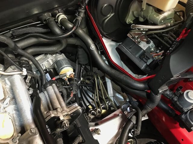

              Next up was the cooling system and steering/front suspension. For the cooling system I replace all of the hoses as well as using the o-ring set from WOLFN8TR (highly recommended!). Had a hell of a time tracking down how the heater hoses are routed but got it figured out:

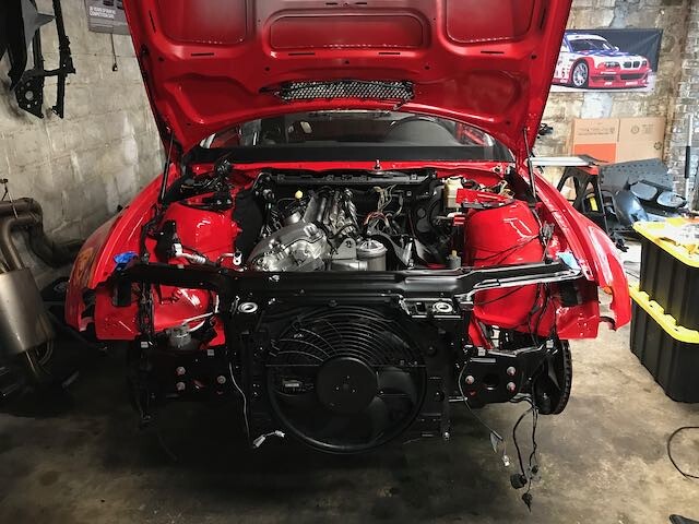

              Front clip with radiator, a/c condenser and aux fan back in.
              Click image for larger version  Name:	50155929218_2f50fe1aef_z.jpg Views:	0 Size:	80.4 KB ID:	49188

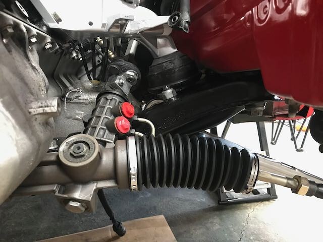

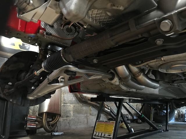

              Pressure tested the cooling system and everything checked out first try 👍, so on to steering. Debated swapping in a tighter rack but ultimately decided to keep the standard (no compromises...). I did install Turner rack limiters to keep the bigger wheels/tires I plan on running from rubbing. Also new hoses, coupler, end links and boots.
              Click image for larger version  Name:	50156720197_a0720656b0_z.jpg Views:	0 Size:	60.3 KB ID:	49189
              Finished off the front suspension with new OE control arms. Did I mention I love my Quickjacks!
              Click image for larger version  Name:	50156488036_f05d370e19_z.jpg Views:	0 Size:	62.2 KB ID:	49190

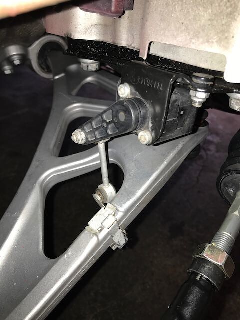

              Then spent like 3 hours getting this headlight level sensor reinstalled. First had to rewire the plug and then took forever to get the freakin mount to clip onto the control arm 😐
              Click image for larger version  Name:	50156720207_457a870c97_z.jpg Views:	0 Size:	54.4 KB ID:	49191

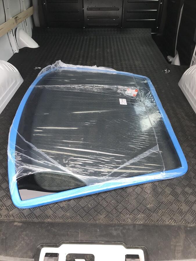

                  Next major milestone is going to be taking the car for a test drive. To get get it road worthy I needed to install all of the glass, headlights/taillights and mirrors. For glass Mario had had the windshield and rear window installed at the shop. I went with a new full feature BMW windshield with "green windscreen, green shade band, climate comfort windscreen and rain sensor". Props to Westchester BMW for letting me order this from Germany:

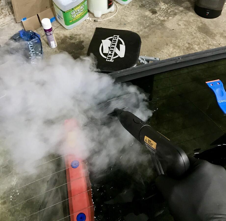

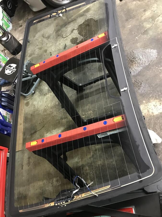

                  The rest of the glass took some work to clean up. Used a steamer to get the old tint off and then polished everything up and added some Rainx anti-phog to the interior.

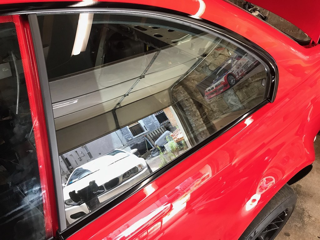

                  The side windows took some time to figure out, should have taken more pictures when I took them apart 😂, thanks you YouTube! Went ahead and got the vapor barrier and and airbags back in as well.

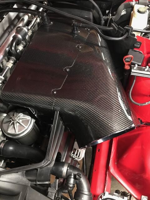

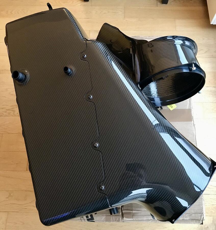

                    I had been waiting on the headlights because they needed to be installed at the same time as another modification, Karbonius airbox and non-flapper snorkel 👍👍.
                    Click image for larger version  Name:	49330140957_6ab88a41d6_b.jpg Views:	0 Size:	118.1 KB ID:	49346
                    Test fit. I used the Turner IAT kit that plugs into the MAF plug and OE everything else. The oil dip stick tube fit nicely against the shock tower with some minor bending:
                    Click image for larger version  Name:	50155929283_cfa948b3b9_z.jpg Views:	0 Size:	81.3 KB ID:	49348
                    I wanted to re-locate the headlight ballast of the drivers side to clean up the engine bay a little and show off more red, but wasn't sure where it could fit until I got the box on. Turns out it was pretty simple, using the existing bracket I was able to modify it to bolt up to the cross member tucked under the snorkel.

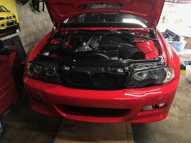

                    With lights back in I fitted the front bumper for the first time!!
