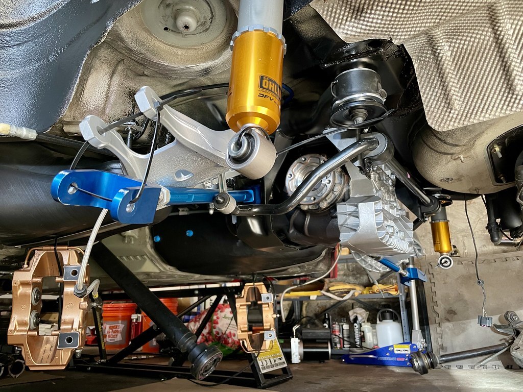

                Progress! Over the weekend got it just about done. Was hoping to have it back on the road but a lot of small projects took up more time that I had planned. First I got the diff back in the subframe. Also decided to switch to Turner solid bushings instead of the OE bushings. I'm going with the logic that solid bushings are better for preventing subframe cracking and do not ad NVH if you stick with OE diff bushings. Guess we will find out... So here is the full updated list of rear bushing/bearings:
                • Rear Trailing Arms - Turner Motorsport Sealed Monoball (Currently installed and love them)
                • Outer Control Arms - Rogue Engineering Bearing (These are installed on my track car for last 5 years no issues and no NVH)
                • Inner Control Arms - Rogue Engineering Bearing (These are installed on my track car for last 5 years no issues and no NVH. Additional bonus, they can be torqued down while not at ride height which means I can assemble the sub frame off the car)
                • Sub Frame Mounts - Turner Motorsports solid
                • Diff Mounts - OE (will match sub frame)

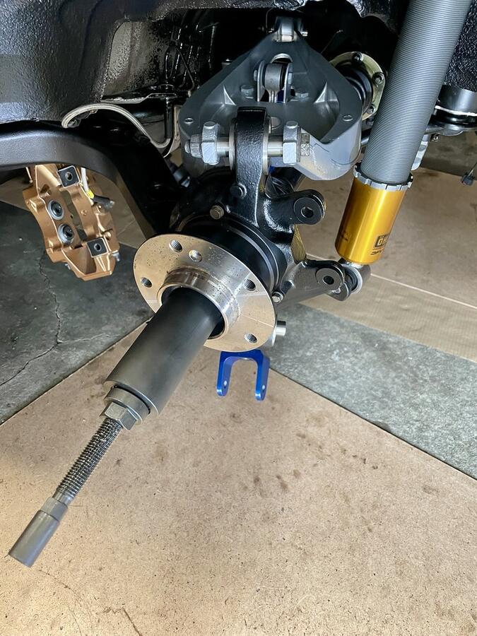

                Next got new wheel bearings installed into the trailing arms which tool forever pressing them in with the HF tool. Turner RTAB and Rogue Engineering ball joints previously installed.
                And finishing touch on the trailing arms is new hubs. Painted the back sides of the hubs to avoid rust.

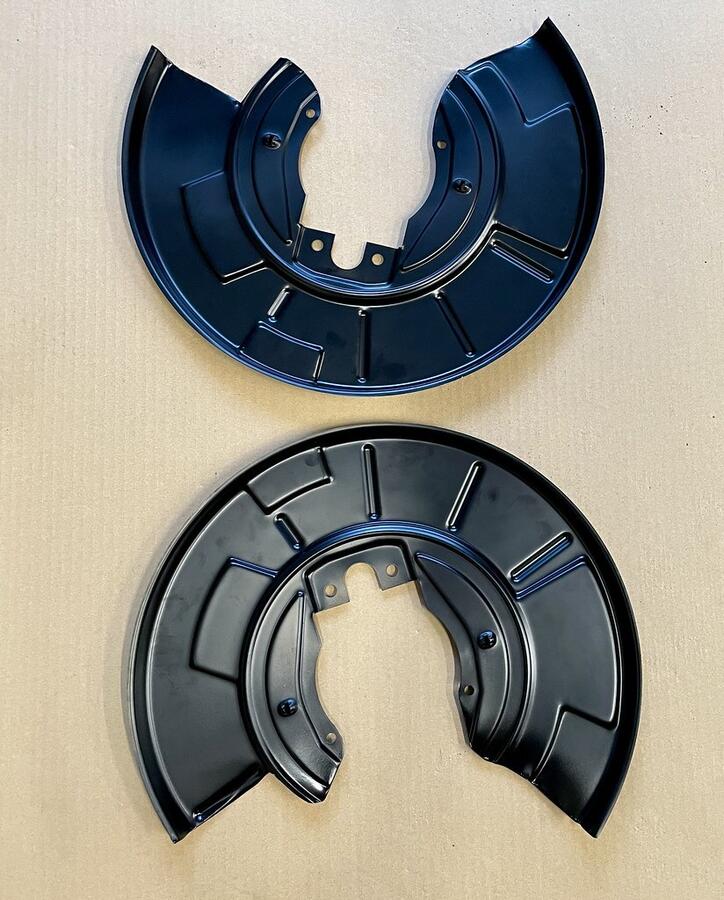

                Also got new dust shields and trimmed them up to fit the BBK as well and be able to take them on and off without removing the hubs.

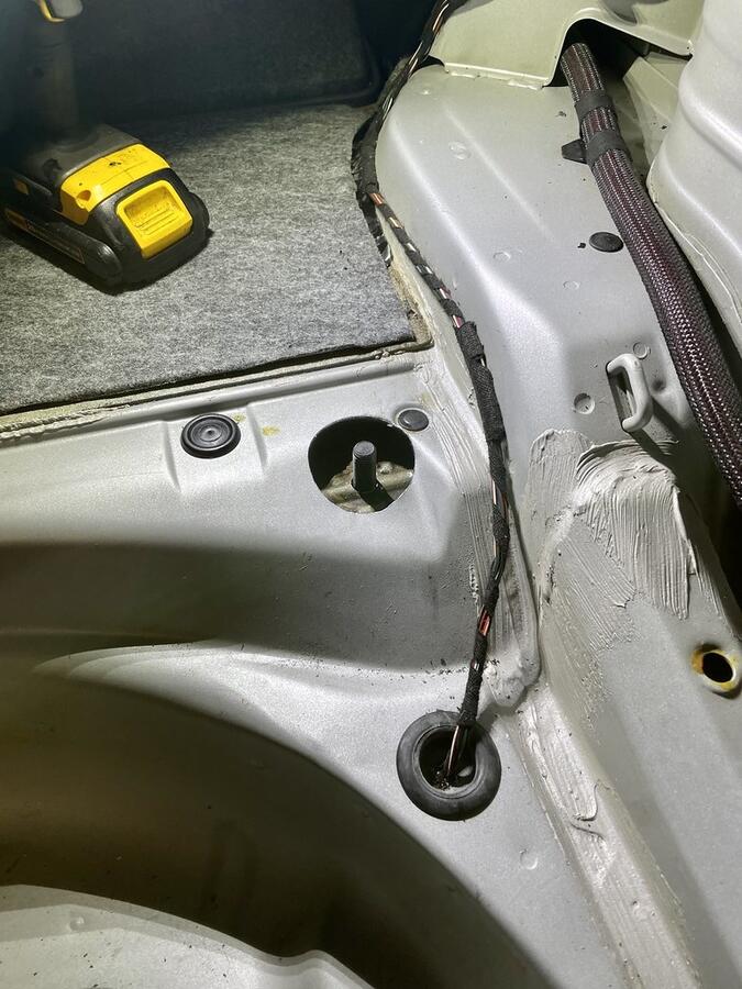

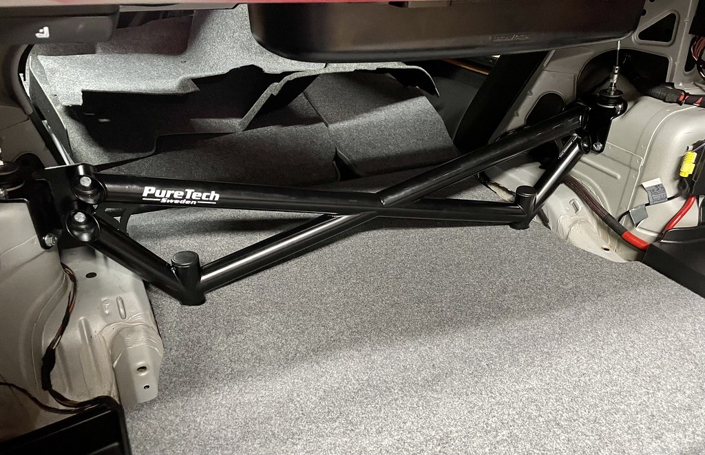

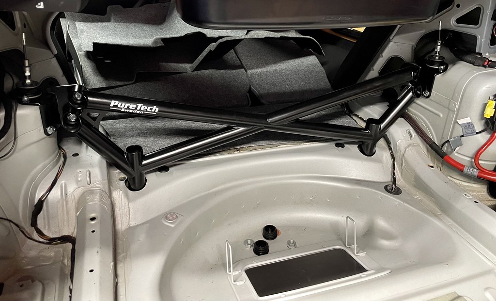

                  Before installing the subframe I also installed some top side reinforcement. Went with PureTech Sweden solution for a couple reasons: First I think it looks amazing. Second I wanted a bar that ties into the subframe mounts as well as the shock towers. Lastly its a low X that doesn't completely block the seat pass through. It doesn't tie into the front subframe mounts but between plates/mounts/bar I'm satisfied with this solution to prevent cracking.
                  The install kit is very well designed. Comes with a drill bit guide and ling bit that lets you drill a pilot hole from below then open up the hole from above. They then supply a bolt that is longer and becomes the stud that the bar bolts to from above.

                  Hole cut and new bolt installed from below:
                  Click image for larger version  Name:	51644275932_40658842d5_b.jpg Views:	0 Size:	94.8 KB ID:	134830
                  Bar fully installed. Tolerances are very tight and getting the bolts to all line up took a lot of adjusting. The instruction are pretty good but the one thing I would emphasize is to get the bar completely bolted in including the tower adapter first. Then drill and install the four bolts that go into the tower last. Also taking the shocks in and out a few times was a hassle and it would be easier to just get some temp bolts to hold down the adapters. I wanted the shock out so I could hit the bolts coming through the shock towers with paint and sound deadening so that they match the wheel wells and don't rust.
                  Click image for larger version  Name:	51645099391_924cfccc6c_b.jpg Views:	0 Size:	142.2 KB ID:	134832

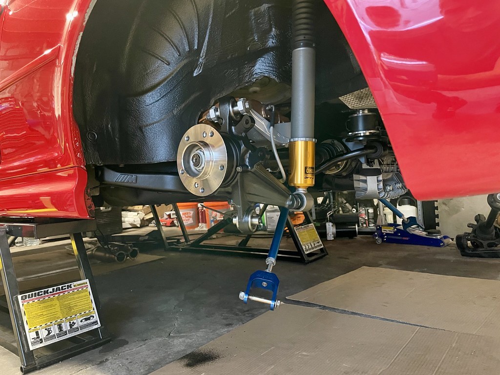

                    Time for the subframe to go back in for the last time. I installed the control arms and sway bar while it was off the car so I could torque all of the inner bolts down with easier access. Then lifted it in with a trans jack. Getting the subframe bolts to line up was a bit of a challenge but eventually it slid on.
                    Click image for larger version  Name:	51645322003_e6da184dc1_b.jpg Views:	0 Size:	260.2 KB ID:	134834
                    Next was the trailing arms and axles. First lined up the top control arm bolt to hold the weight then got the trailing arm bolted into its pocket. Used this axle puller tool and wow did it make installing the splines easy!!
                    Click image for larger version  Name:	51645099461_651580c3e5_b.jpg Views:	0 Size:	123.4 KB ID:	134835
                    Finished up by installing the drive shaft and new e-brake cables. One more session this week should have it back in the road for some fall drives!!
                    Click image for larger version  Name:	51644276012_12e2cc9424_b.jpg Views:	0 Size:	193.4 KB ID:	134836

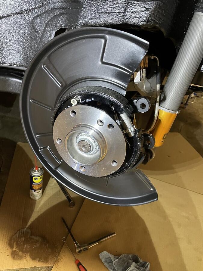

                                Back on 4 wheels! Finished up the brakes today by getting the dust shields and new emergency brake hardware installed. Anything I can't paint I'm hitting with some wd40 anti corrosion.
