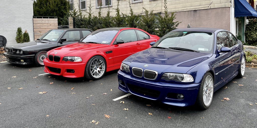

                Likely the last outing of the year! Met up with EYEHAVEYOU & @andyman746 at Sunday Motor Co in Jersey for some Coffee. Actually started snowing while we were there so its definitely about time to shut it down for the winter. NYC loves to dump absurd amounts of salt all over the roads...
