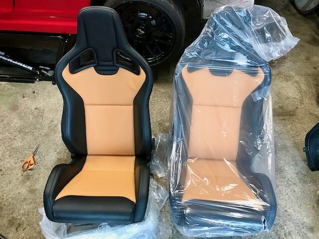

        All OE replacement as needed for the trim and some customized seats and doorcards. Here is a preview, more to come!

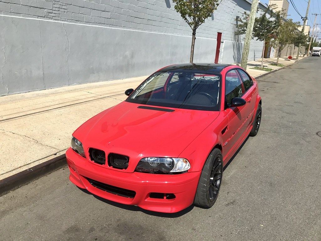

          Successful test drive! Took it out for a couple laps around the block for some basic checks. Motor and SMG seem to be running great and there were no major issues or leaks. Still on stock suspension, old wheels and no trim or interior:
          Click image for larger version  Name:	50217543993_7933a409e5_b.jpg Views:	0 Size:	227.4 KB ID:	50683
          I didn't go past 4k rpm or so until I get the tune sorted out. I think it currently has a canned tune loaded on it and it is read blocked (I'll skip my canned tunes are absurd rant...). Current plan is to use MSSFlasher (anyone heard from Paffy lately?!?!?) to get a stock tune loaded and then have Jordan at RK Tunes to tweak it for the airbox and cams. Then I'll drive it to him in the coming weeks for a proper dyno tune. Before I do that it's heading back to Mario on Tuesday for final paint touchups and polish πŸ‘.

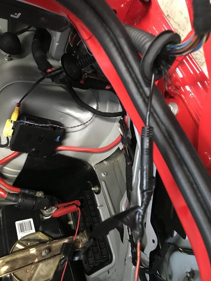

            With the exterior basically done I started on the interior. I'm installing an Avin Avant head unit with a backup camera. This car had nav installed which means I have to run a bunch of wires to the trunk. Normally a serious hassle but pretty easy with the interior out! First ran the wire for the camera, what a pain... took forever to fish it though the trunk loom.

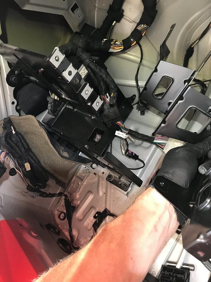

            Next I cleaned up the trunk space used to mount the nav, cd changer etc. All of that is coming out so I removed all of the hardware and brackets so only thing left is the amp. I ordered the OE bracket to mount just the amp but it actually bolts up nicely to existing holes. With all if that removed I can use new base trim and free up a bunch of trunk space:
            Click image for larger version  Name:	50233179407_c48177b115_b.jpg Views:	0 Size:	87.9 KB ID:	50690
            Click image for larger version  Name:	50233179417_65c6bab921_b.jpg Views:	0 Size:	183.4 KB ID:	50691
            Ran the harness extension and and antenna wire under the trunk shelf, along the passenger side then behind the glove box to the head unit.

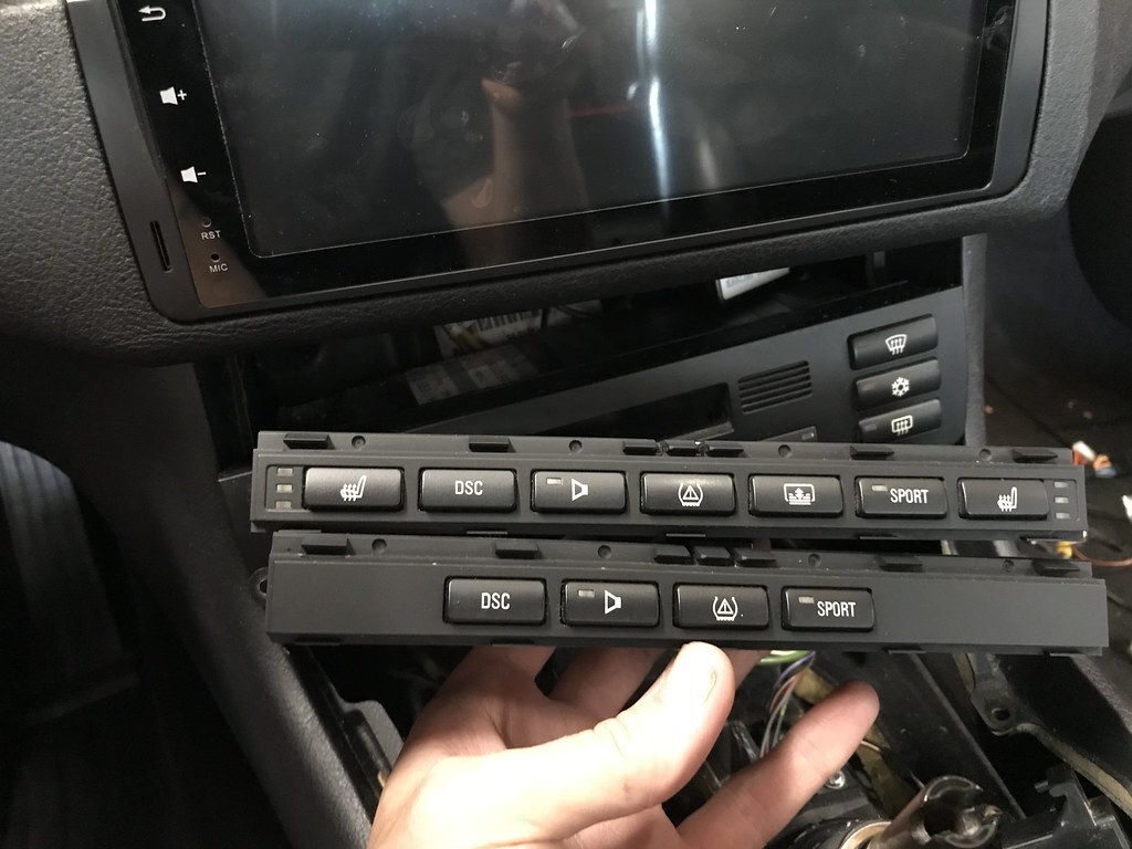

            I got everything to work except for the backup camera. Avin instructions suck... I can't get the camera to come on in reverse. Will take some more research to sort that out. While I had the dash apart I'm also putting in a different accessories button module. I removed the heated seats and rear window shade so don't need those buttons! Hunted around on ebay and found a replacement with just DSC, HK, TPS and Sport.

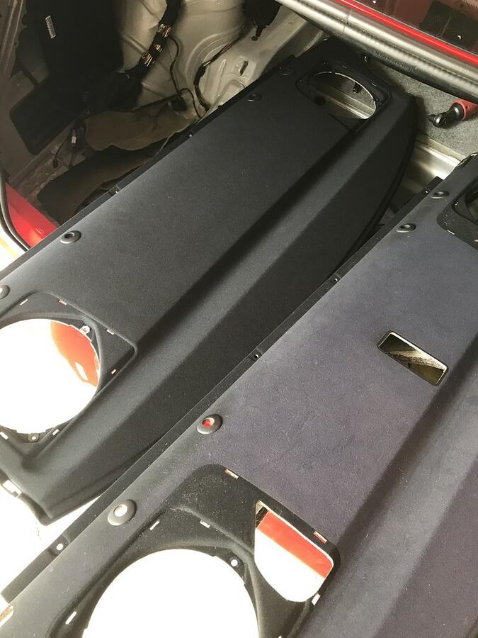

            Lastly got the rear shelf reinstalled. Went with a version that deletes the hooks for a cleaner look.

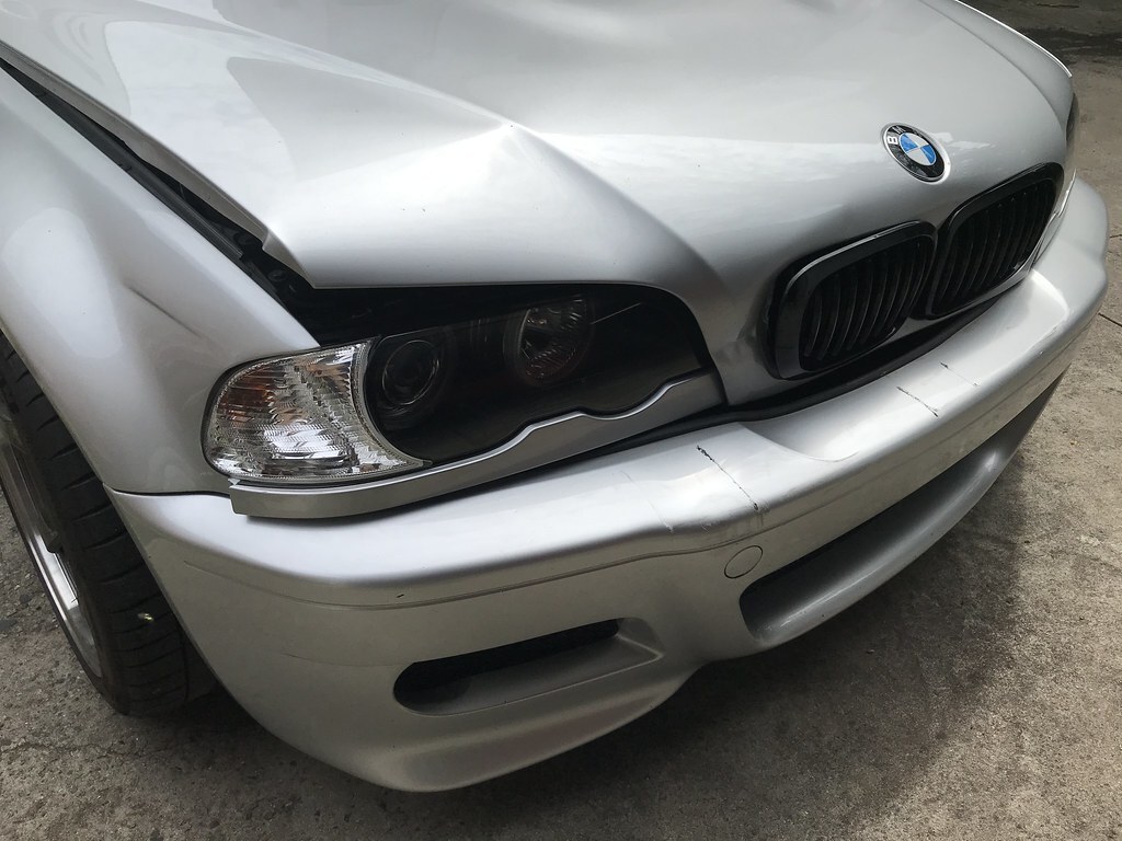

            With the car going back to Mario next week I'm going to focus on rebuilding the seats and door cards with all the new trim. Unfortunately also have a new side project. Took the track car out for a spin on Friday and someone backed into it in a parking lot 😫 (and fled...)!!! Fortunately the only real damage is to the hood and I have the parts to fix everything else. Hoping I can find a used silver hood or maybe time for a GTR or vented style hood???

              Wow I didn't know there was a version of trunk trim that reclaims all of that space! Did you cut out that big wad of wiring harness for the cd changer too?
                        Part # 51478266567 πŸ‘. For now I've wrapped up the wires and tucked them away. But yeah, there is A LOT of them.
                          Save that part number for later! I put the xtrons version of that head unit (they are all the same I think) in my car and notice how many wires are back there!

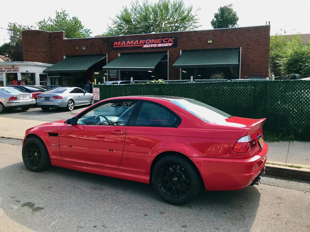

                                After a week delay was able to drop off the M3 at Marios for final touchups and polish! Should have is back within a week and then it will be the final push to get the interior and suspension installed. Its only a couple miles drive up to the body shop but the engine and SMG felt and ran great so pretty confident I've got that completely sorted.
