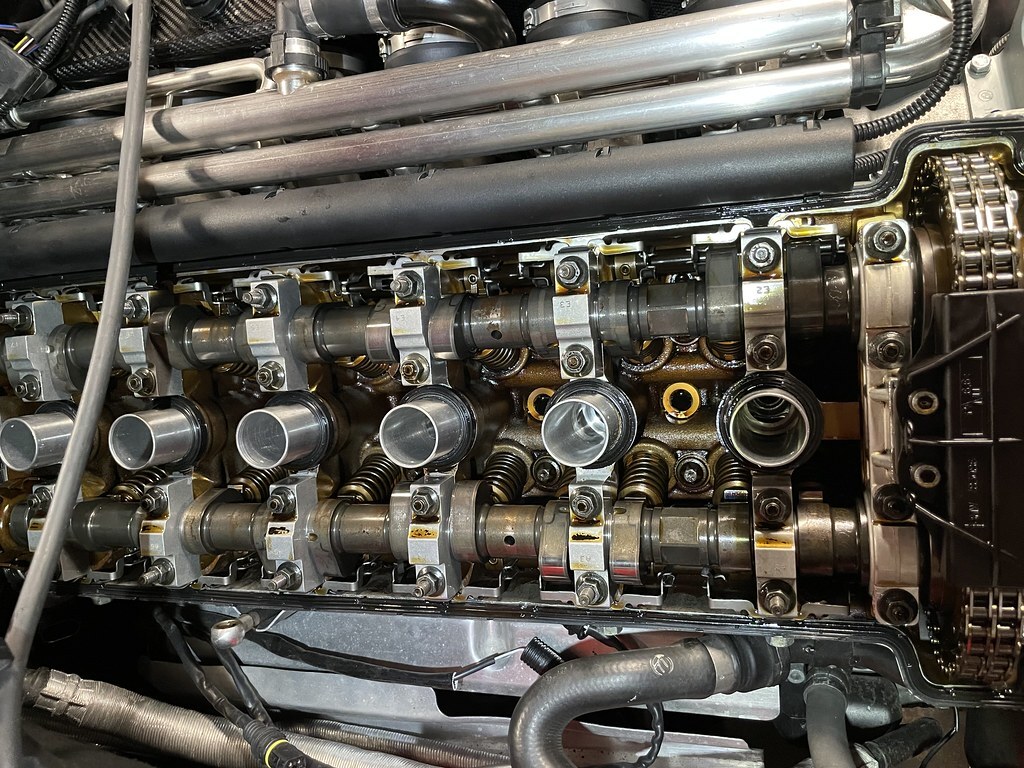

      After getting the valve cover off everything is looking really good! The cams and followers all are wearing in nicely and all of the valve clearances are still in spec šŸ‘.

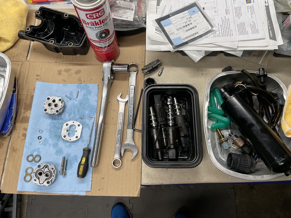

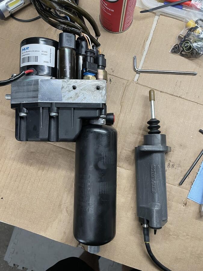

      Next was the SMG pump... Was hoping not to mess with this so soon. When it got above 90F here in NYC it started shifting poorly at low speeds and in traffic. A quick bleed of the system with INPA would fix it but clearly something was up. My theory was something wasn't sealing up correctly and air was creeping into the system. So instead of chasing the issue I just decided to replace the pump and slave clutch. I already had a spare pump and decided to rebuild it. I got new seals, motor and accumulator from MLR Engineering. I had already relocated the pump to the drug bin so taking it out was super easy. Got the pump apart and started the rebuild, thanks to Good for the DIY.
      Back together with new motor and accumulator:

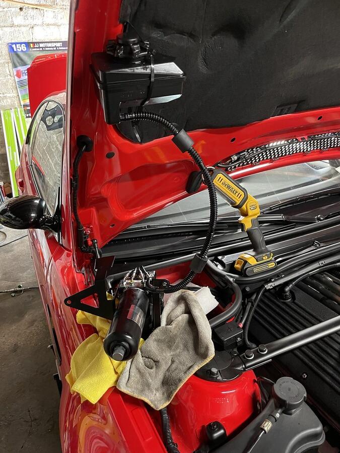

      Pump back in the car but sitting horizontal and raising the the reservoir so it will bleed properly. New slave clutch also installed:

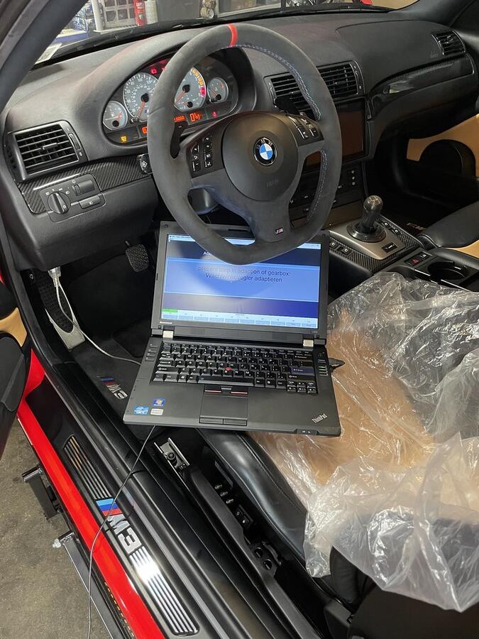

      Then bleed the system multiple times using INPA:
      Once done got the pump back into into the drug bin and took it for a successful test drive. Hopefully that is the last time I have to mess with the SMG for a VERY long time. I'm still committed to keep it as I like the auto function for easy street driving and traffic; but 6 speed conversion is always the back up plan...

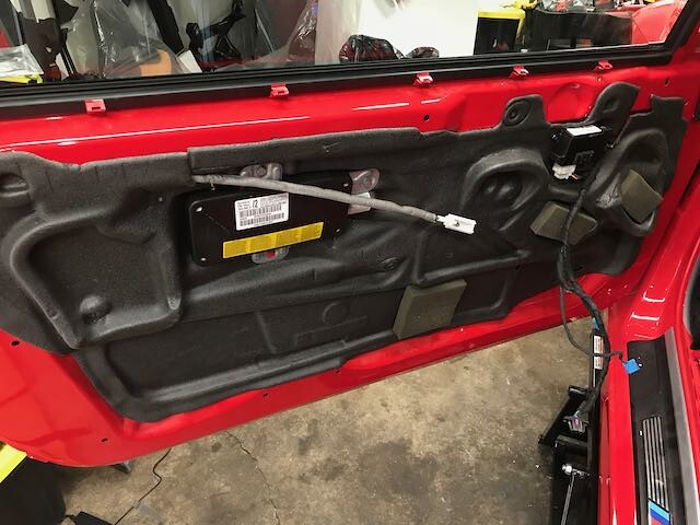

                  The side windows took some time to figure out, should have taken more pictures when I took them apart šŸ˜‚, thanks you YouTube! Went ahead and got the vapor barrier and and airbags back in as well.
                  Click image for larger version  Name:	50184356973_b8d2417548_z.jpg Views:	649 Size:	66.7 KB ID:	49343
                  When you got the car ready for the paint shop, did you completely remove the entire side window assembly from each of the doors? The motor, the glass, the window tracks, etc. Or did you just remove the vapor barrier?

                    I removed all of the glass from the car including the door windows. I was replacing all of the door trim and seals so it was easier to just take it all off and leave it off for the body shop. Putting that window assembly back together was no fun... should have taken more pics when I took it apart.

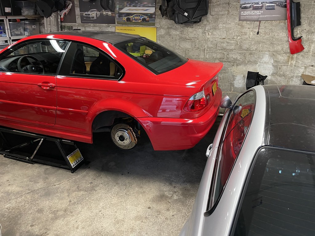

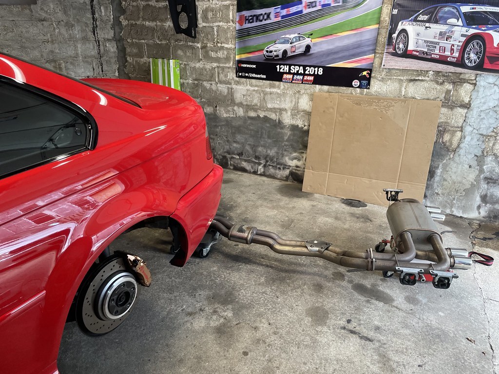

                        Kicking off the last big project for this build. I had put off rebuilding the rear suspension as I just wanted to get the car back on the road and enjoy it during the summer. I previously rebuilt a spare subframe so hopefully this will be a quick swap. Step one was get garage organized and the car up on the quick jacks. Off comes the exhaust for hopefully the last time as well as a bunch of the trim and diffuser.
                        I plan on following the great DIY put together buy FCPEuro. Goal is to get the subframe out this weekend! In the meantime, jussst enough room to still fit the Silver M3 in the garage šŸ˜‚

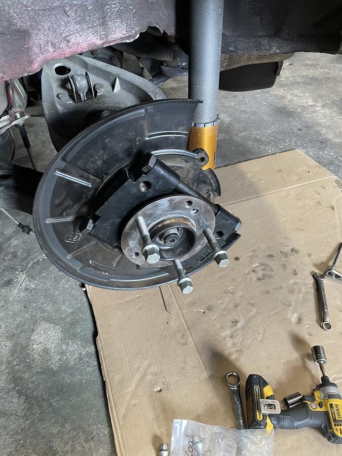

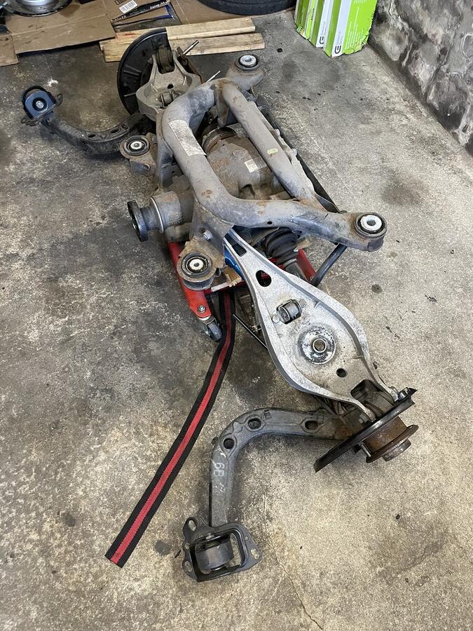

                              Phase 1 of subframe rebuild done! Got it dropped last night and fully disassembled. This went pretty smoothly as a lot of the commonly seized bolts I had previously removed (ball joints, camber arms etc...) so everything came apart pretty easy. This job is so much easier knowing I have a spare already prepped to go in. The one exception was the e brake cable in the hub. Could not get those to budge so I just cut the cables and pulled them out from inside the car. New ones ones are pretty cheap so just going to replace them. Also attempted to remove the wheel hubs as its easier to do on the car, but no luck. I'll get a machine shop to handle that as well as removing the half shafts from the hubs (I plan on rebuilding this subframe to go in my track car).
                              Click image for larger version  Name:	51541998096_44bfdcdb4e_b.jpg Views:	0 Size:	113.9 KB ID:	129737

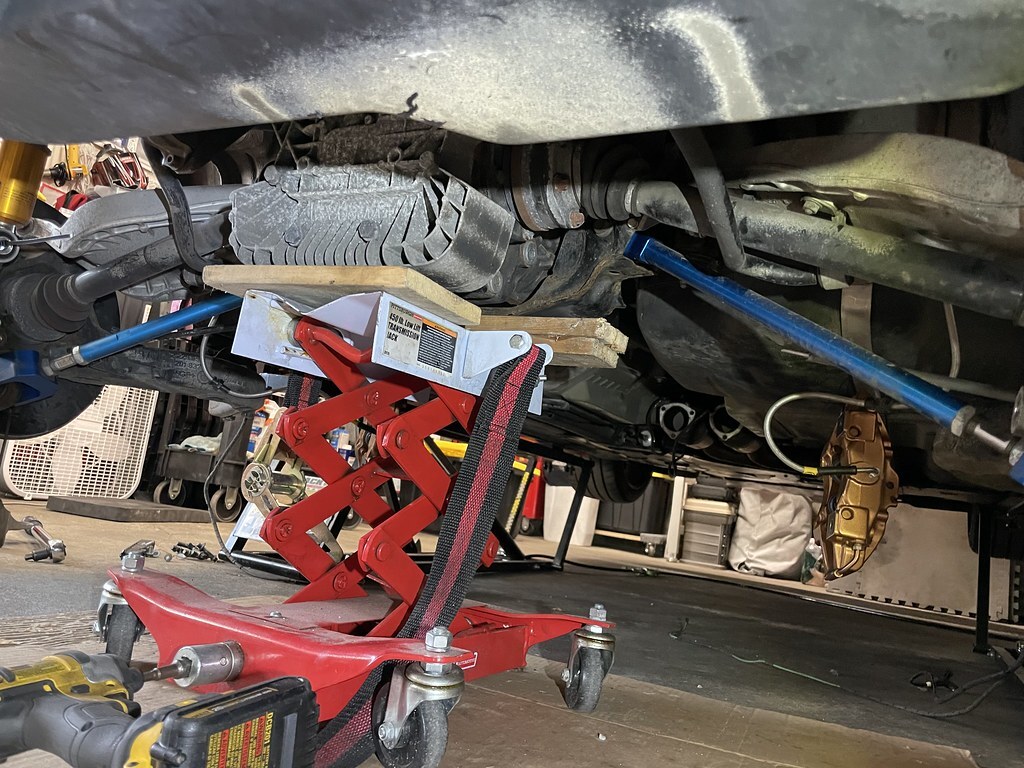

                              With the brakes out of the way and various cables and sensors removed it was ready to come out. HF trans jack was perfect for this and dropped with no issues at all. The car isn't high enough to pull it straight out the back but was pretty easy to slide it out the side.
                              Click image for larger version  Name:	51541211662_49f06a1dd6_b.jpg Views:	0 Size:	234.0 KB ID:	129738
                              And its out!

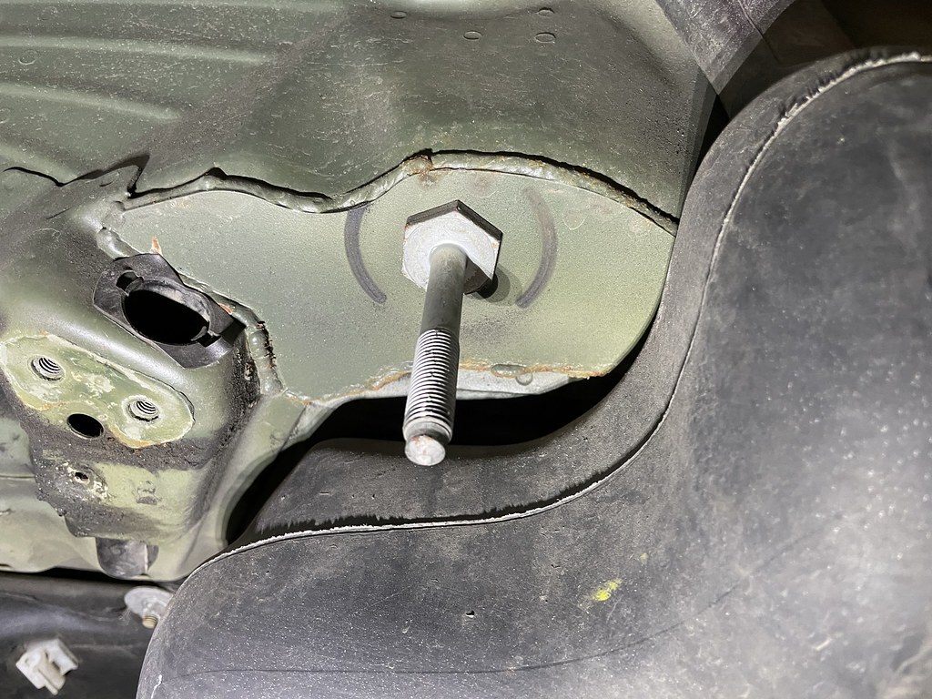

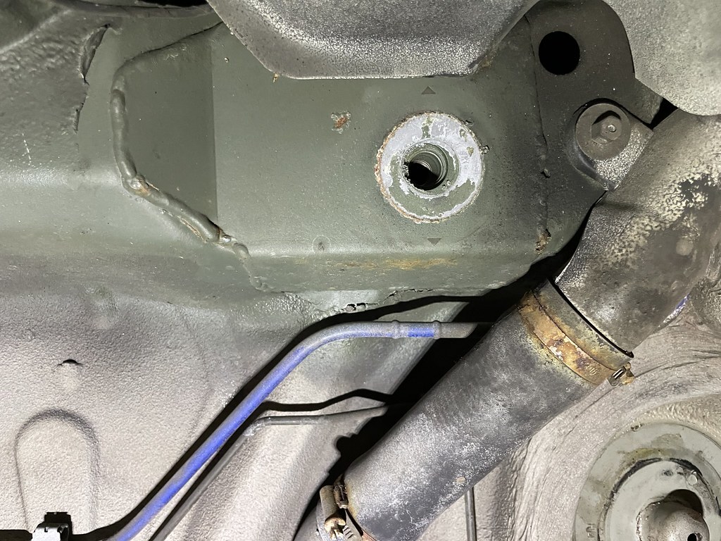

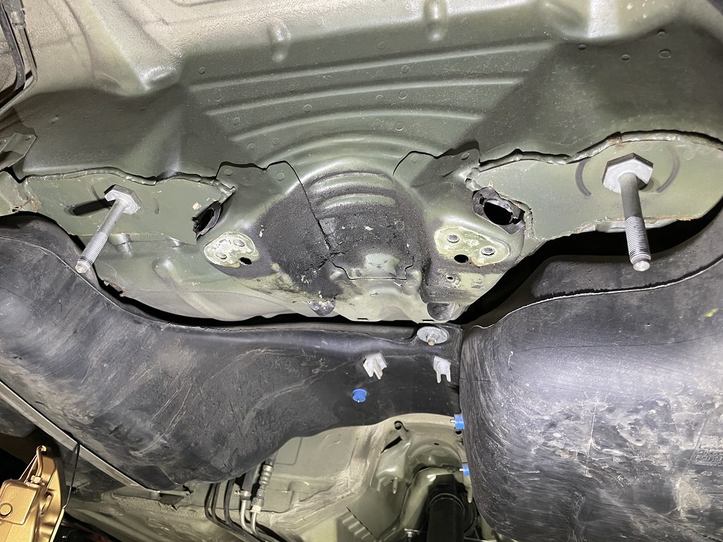

                              The body and underside of the car is in exceptional shape. A previous owner had plates installed and it looks like they did a proper job (other then the olive drab paint color..). I'm going to clean everything up and treat the light surface rust. I'll replace any rusty hardware. Also planning on doing a light coat of black boom mat sound deadening and fluid film likely corrosion areas.
                              Click image for larger version  Name:	51542243853_300fab56e2_b.jpg Views:	0 Size:	217.2 KB ID:	129740
                              Click image for larger version  Name:	51542927260_9bf53e0bcd_b.jpg Views:	0 Size:	227.8 KB ID:	129741
                              Click image for larger version  Name:	51541998086_40319643ba_b.jpg Views:	0 Size:	238.6 KB ID:	129742

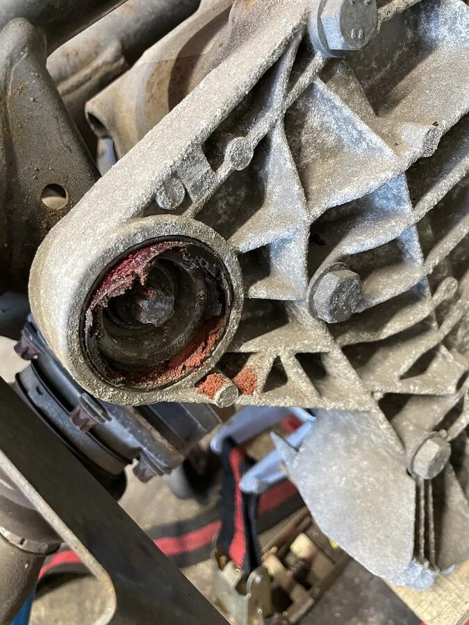

                              Although a previous owner had the plates installed and also looks like pretty new subframe bushing they did not replace suspension and diff bushings. They should have! The diff bushing were completely shot!
                              Click image for larger version  Name:	51541211652_21538445bf_b.jpg Views:	0 Size:	124.0 KB ID:	129743

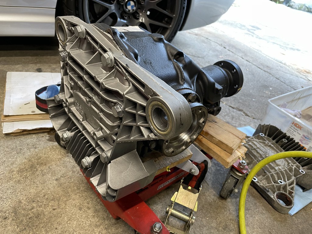

                              Next steps are to get the cleaning done and reassemble the new subframe. Also going to Por-15 the diff and install a rear strut bar.

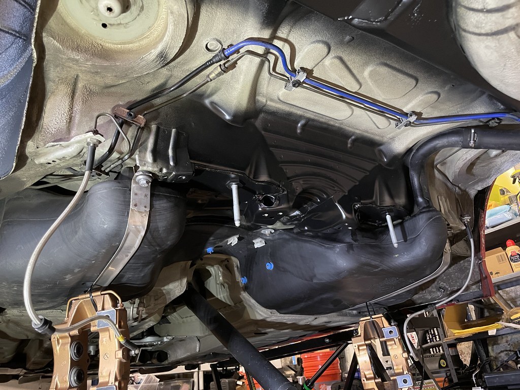

                                After a couple weeks of not much progress got back at it today. Got the body cleaned up, painted and ready for the subframe to go back in. First replaced the diff cover with a new one (including new bushings) and changed the fluid.

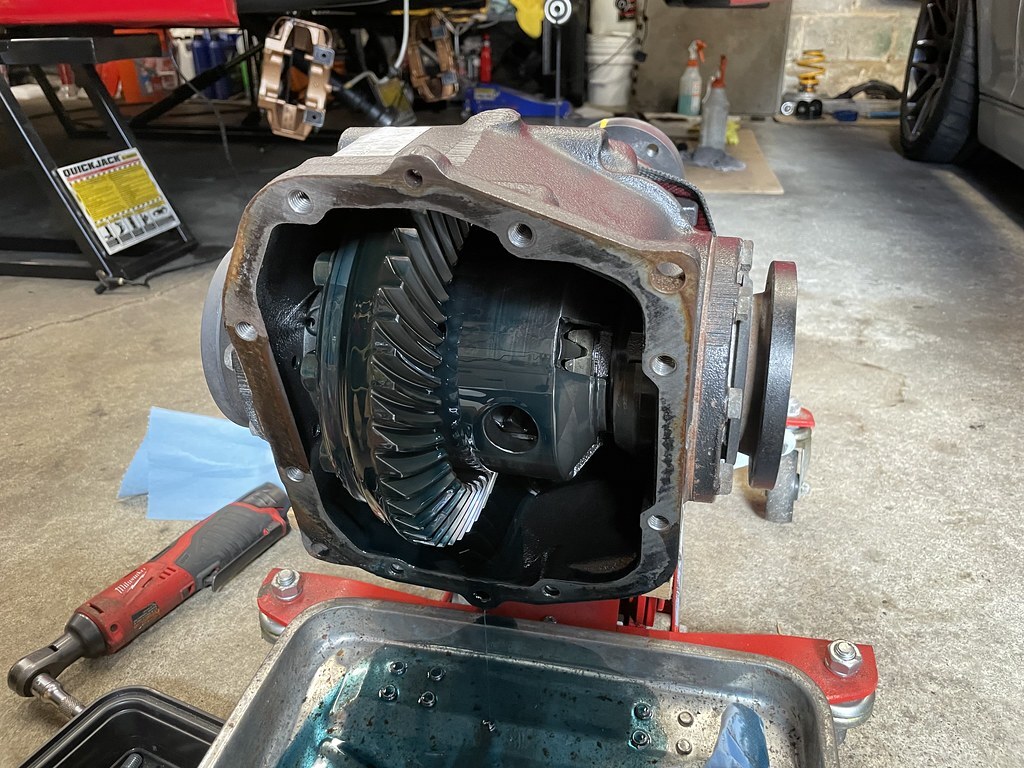

                                The diff didnt have any rust so just cleaned it up and hit it with a light coat of por-15:

                                Underneath I cleaned up any surface rust and also hit it with a coat of por-15. No its not the OE color but I care more about the rust prevention. Also replaced a couple rusty bolts and clamps. Overall though it was very clean.

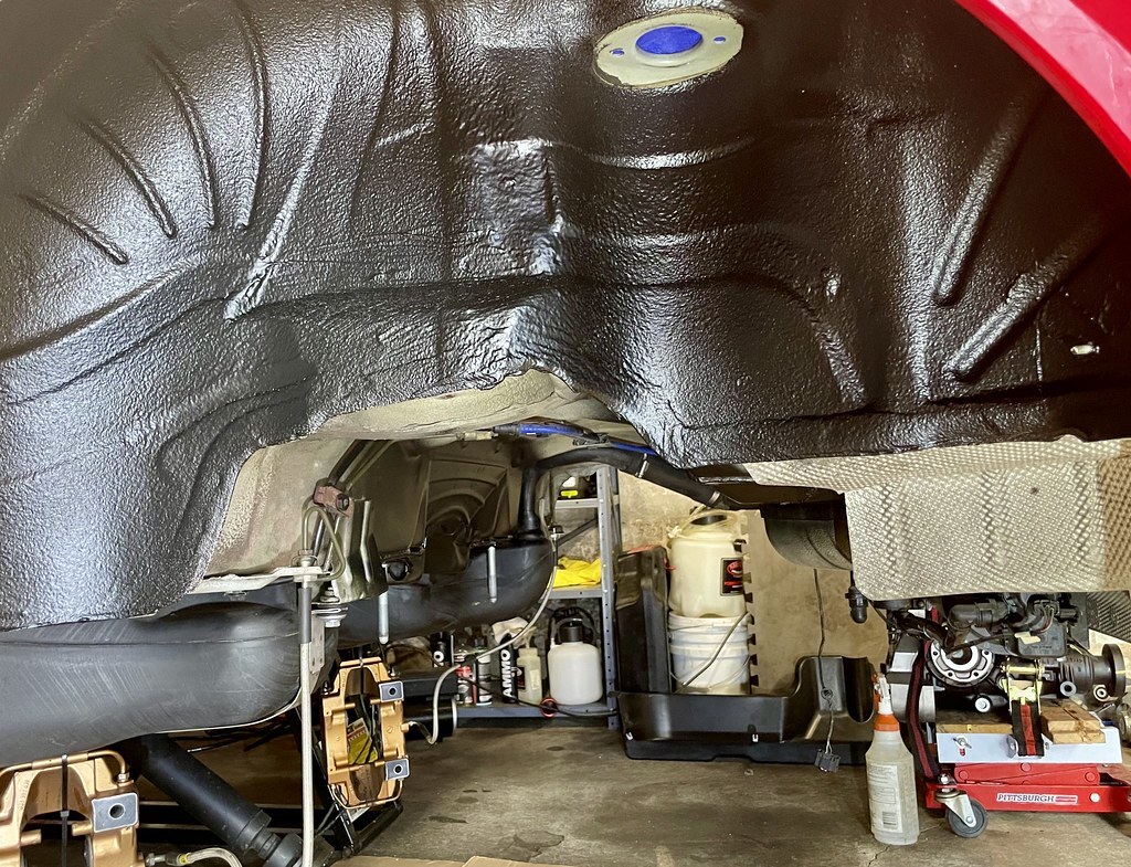

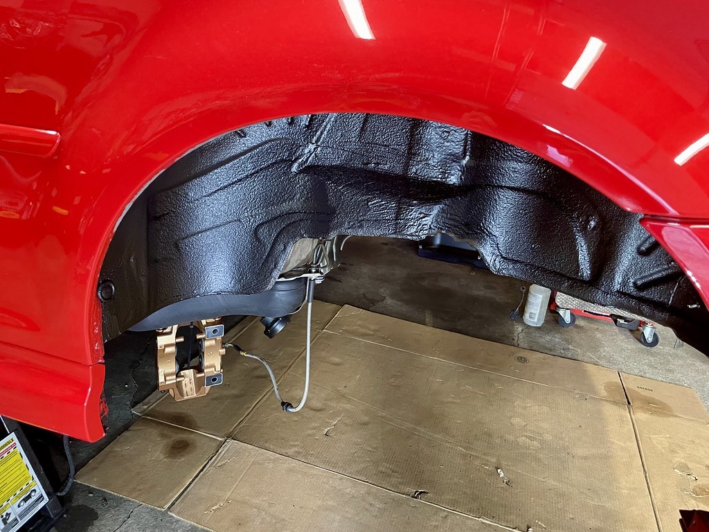

                                I also cleaned up the wheel wells and sprayed on some Boom Mat. Super happy with the result, looks good and will hopefully reduce some road noise.
                                Hopefully back together next weekend!
