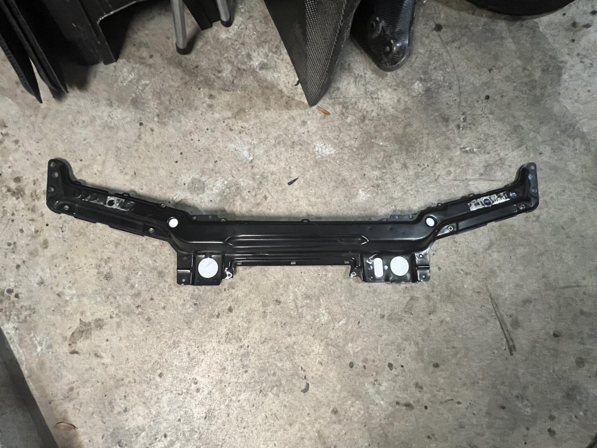

        I need to get as much weight off the front end as possible. I’ve been looking at ways to improve oil cooling while using a smaller cooler.
        I think I’m going to mount my secondary cooler on the back of the radiator. It should warm up the oil quicker so I can delete the external thermostat and provide more efficient air flow than my current setup.
        With everything apart and brainstorming…I came up with the idea to make the front crossmember out of….drumroll…carbon fiber. I can cut about 2-3lbs.

                It has been a slow year for track car progress. To get caught up to where we are at.
                I made the carbon front radiator mount! Yay!
                Its stiffer...not much weigh savings. Nothing broke, cracked or leaked - the car has seen up to 1.5g's in the corners.
