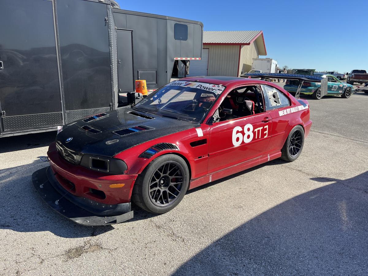

        Ready for my first time trial. Lots of stuff to get done. Annual tech, check ride, prep the car, meetings, out lap procedures…got all of that done. Luckily got checked out for a TT license early because it rained in the PM and I don’t have wipers. I wax the windshield so I can see when at speed. The issue is this course has a slower technical section on the backside. I’m good when I enter that section…blind by the time I’m getting back onto the next straight.

        One other car in my class, he has a couple of track records in the region. Really good driver. First day, was about 1-2 tenths off from him on NT01s and I was behind someone all day. Zero clean laps. Then I went home early because of allergies and missed the last session which apparently was the fastest. So second place on the first day.
        Sun…felt better and ended up getting some clear and clean-ish laps. Ran a 1:40.580 to win TT3 by .140 seconds!
        Super happy!

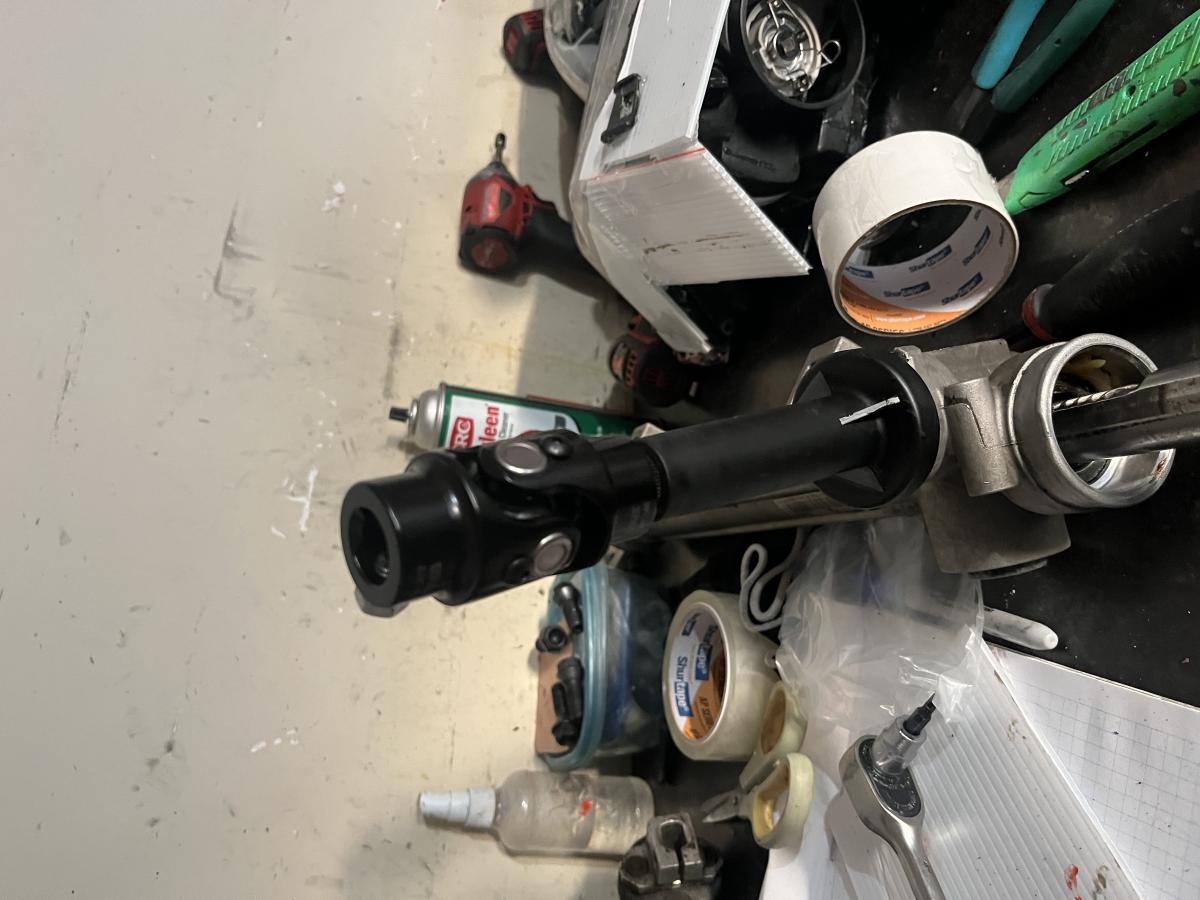

            Im going to try this PS delete…again. Last time I used one of those crossover blocks - crap - waste of time and money.
            The first gen Z4 has a manual rack with electric power assist in the steering column. I’m hoping that it will be decent through the slower turns.
            I found an eBay coupler that fits the Z4 rack. The problem is the pinion sticks out more than the hydraulic rack. Hoping I don’t have to cut down the steering shaft.
            And it fits!!! Perfectly…the pinion and shaft sit just deep enough in each end so it doesn’t interfere with the joint articulation.

            So I am working on removing the PS system. The PS system is always getting in my way and would be awesome to drop some more weight on the front end.
            I will drill an indent on the steering shaft for the set screw in the coupler to prevent them from separating. Then I need to degrease the car and then I can take it for a spin!
              #81
              Took it for a test drive, the Z4 rack worked...just the same as a stock rack with the crossover block except it was even worse at low speed from my memory. So I will finally put my dreams of manual steering to rest. I guess I could do electric steering but I don't think it nets me very much in terms of weight savings. I like the feel of my steering now with the relief shims.
              Looks like this is a case where I should leave well enough alone.

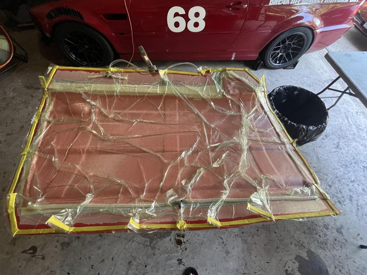

                  Let's see how this left door turns out. Learned my lesson from the hood, this one is going to be twice as thick. Planning to do the infusion tomorrow and then I'll start on the inner half.
                    #84
                    Carbon fiber doors are done. At 2598 with brake ducts and 2nd oil cooler which adds about 11 lbs - so about 2588 in min weight trim. Disappointed, thought it would be lower.
                    Just finished the left and right door. I'm happy to say they open and close, fit reasonably well, and are quite sturdy! Definitely race car grade. I used a spread tow fabric for the outer layer which is very difficult to work with on anything not totally flat. The weave got messed up on the left side, learned some lessons, and
