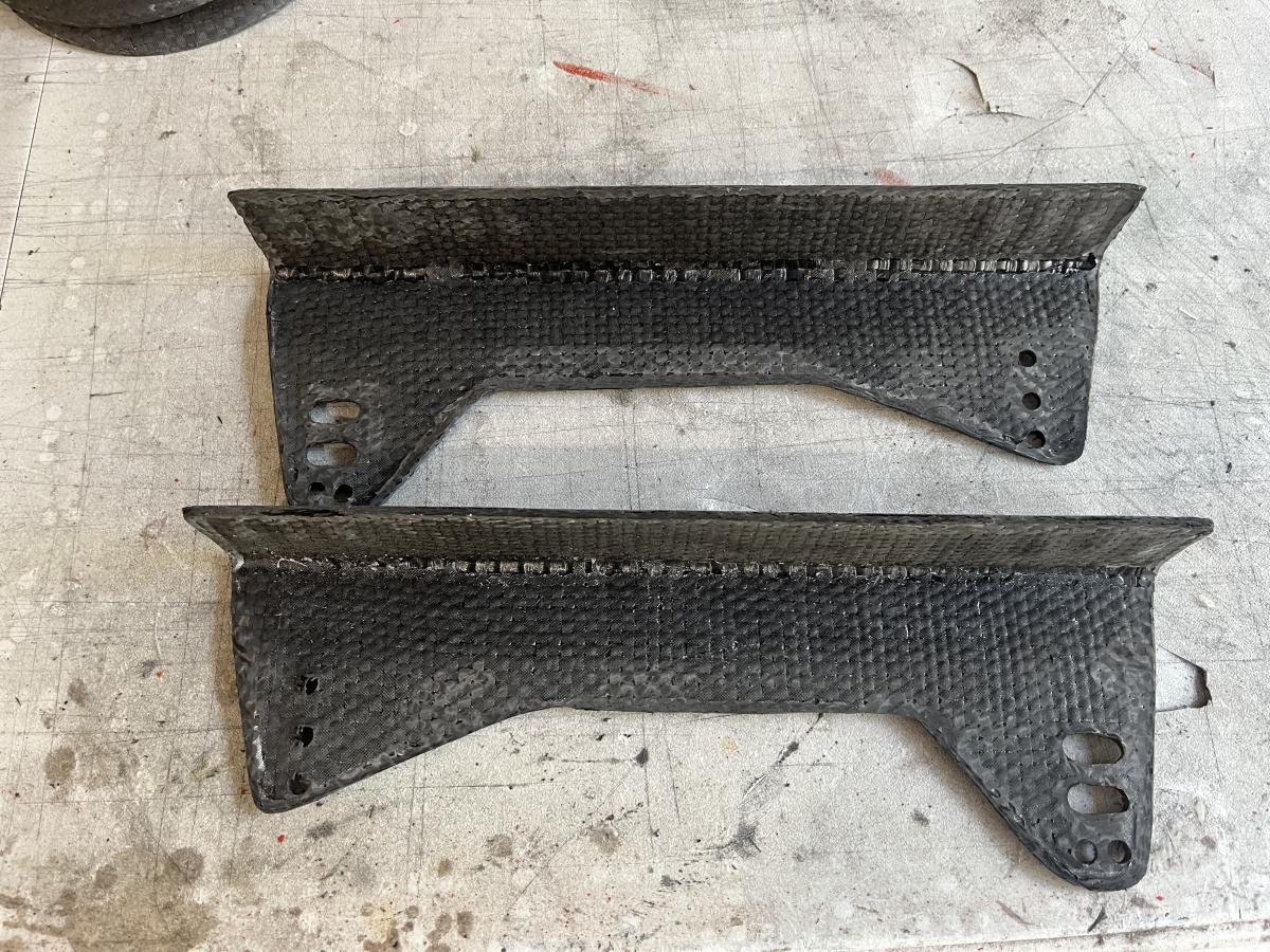

                  Carbon seat mounts…eh…need to make some changes to the layup. 4mm thick is challenging to cut. Also, I don’t think the top holes are usable. I started drilling the holes but it is too close to the edge. Not sure I’d use that hole with a steel mount.
                  Click image for larger version  Name:	IMG_4421.jpg Views:	23 Size:	254.1 KB ID:	299956
                  Click image for larger version  Name:	IMG_4422.jpg Views:	22 Size:	268.0 KB ID:	299957
