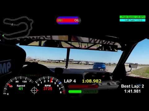

        Ran MSR Houston clockwise in May. Me and this direction have never gotten along. I don't think I've ever ran a full 8 session weekend this direction. Something ALWAYS happens. So the car was smoking again on left turns. WTF!!! Ran 3 sessions and then parked it. Rained like crazy on Sun so wouldn't have been able to run much anyway.
        Ran a 1:43.8 on NT01s as usual. I can see a 1:40 lap with a clean running (i.e. no break downs or issues).

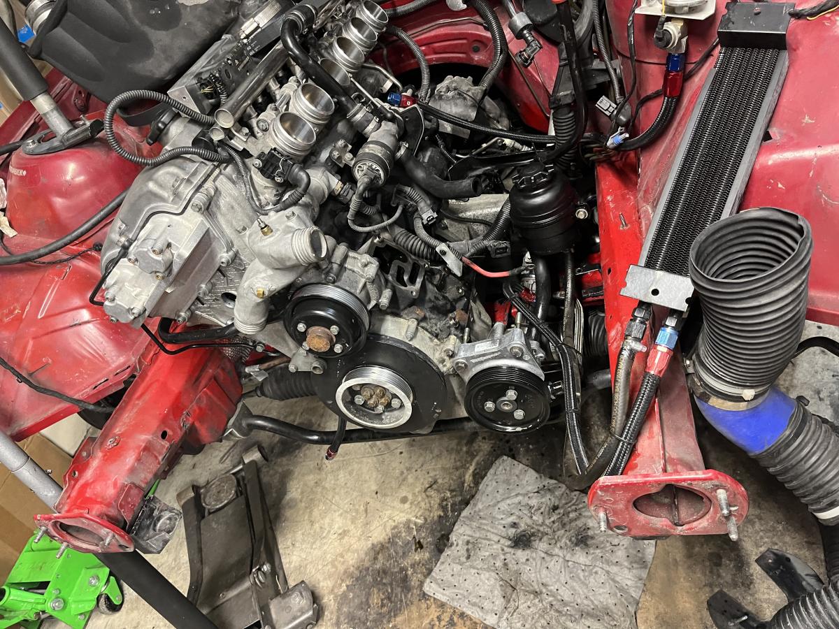

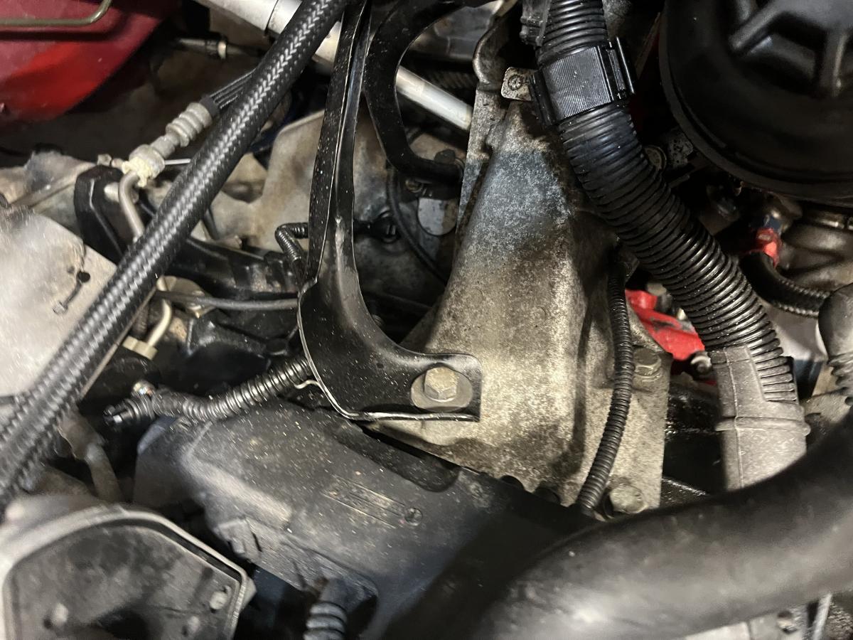

                              Removed the front end. Takes about 15 min to remove, not usually necessary to do this stuff
                              Click image for larger version  Name:	4E11CBEC-79AA-4C79-B494-0789DFFC92B1.jpg Views:	0 Size:	247.9 KB ID:	196094

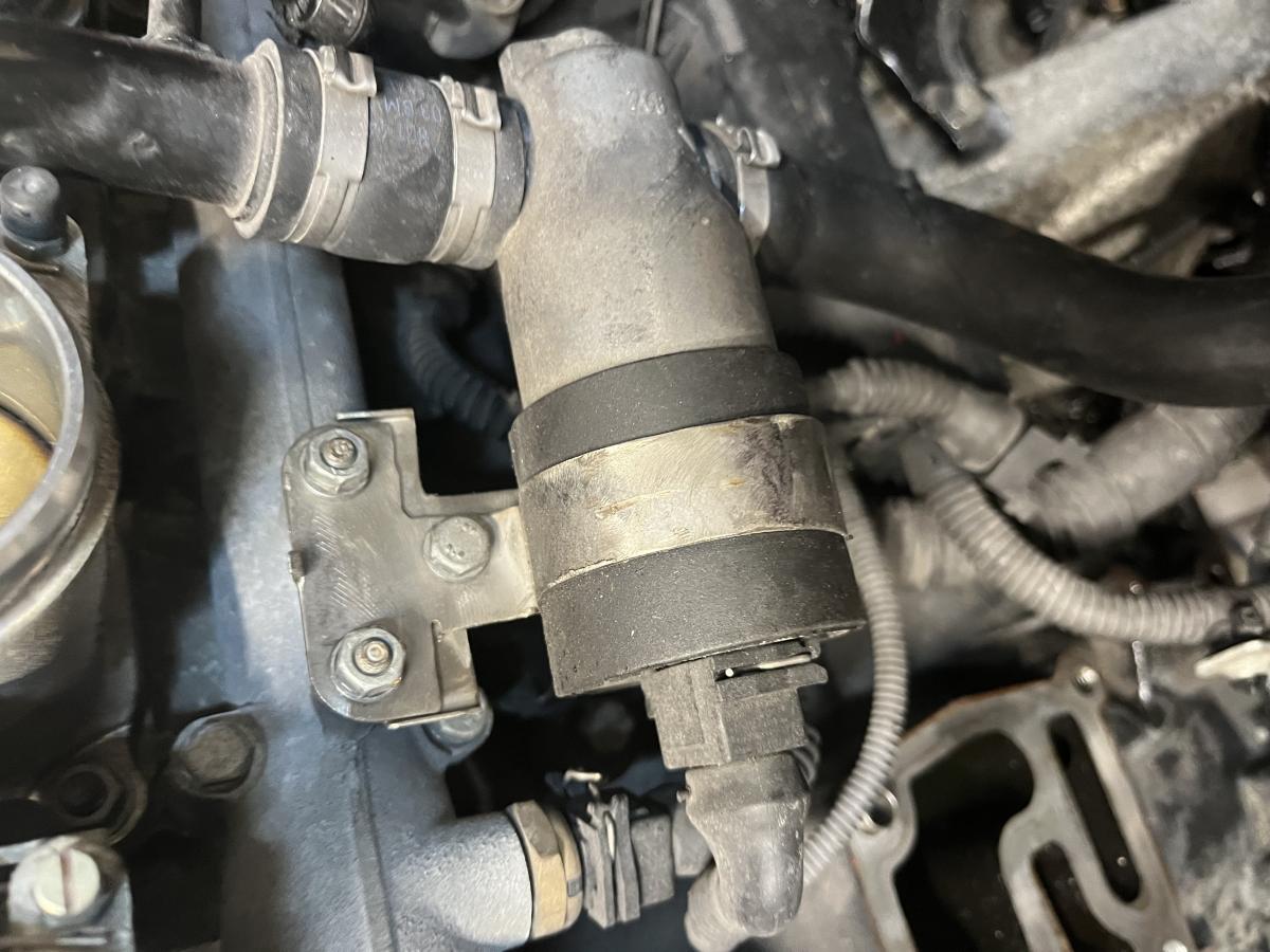

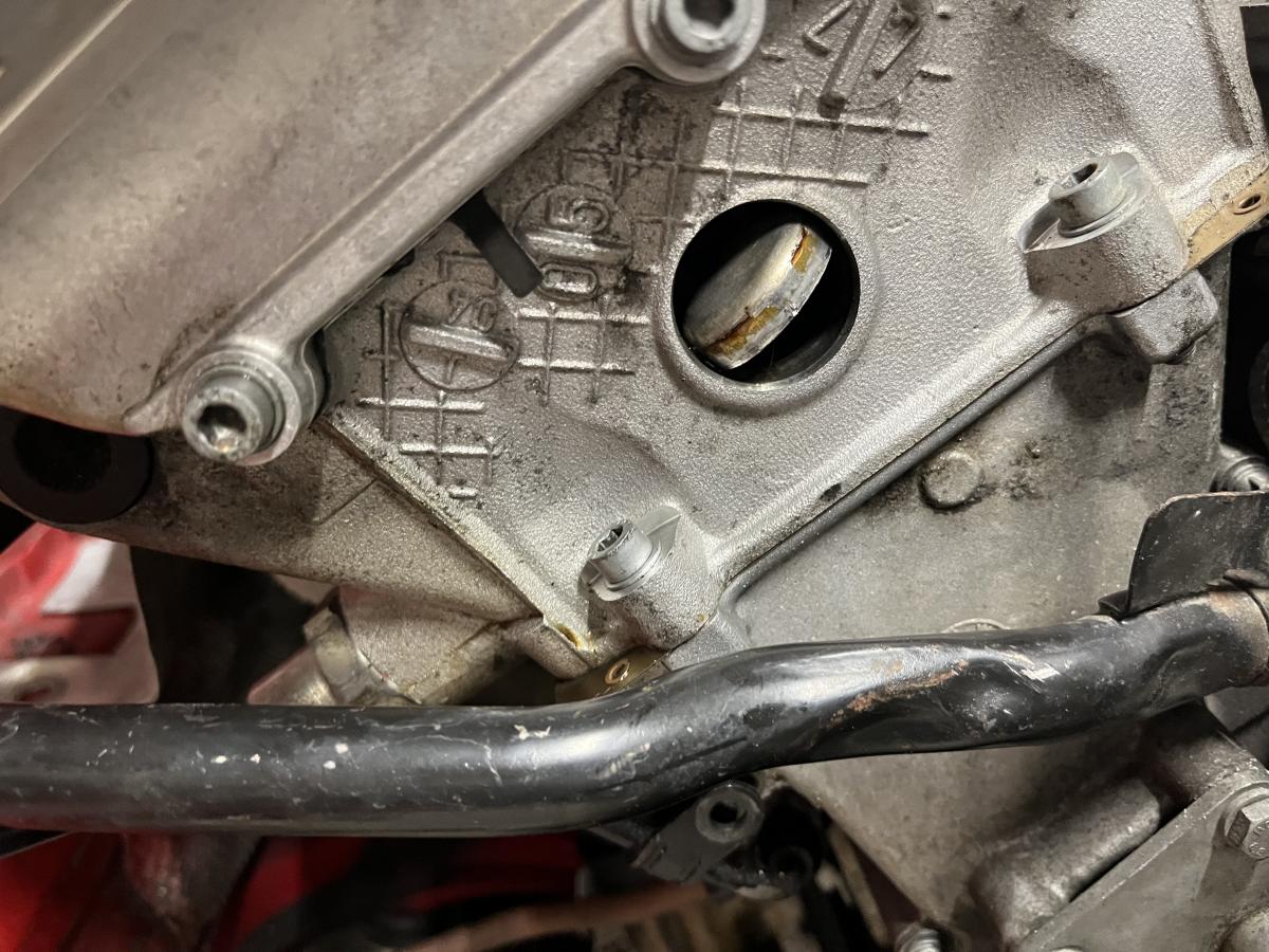

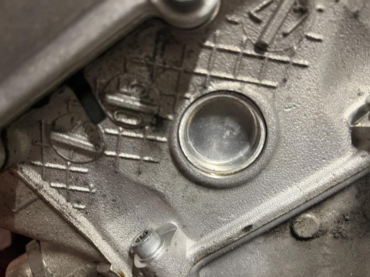

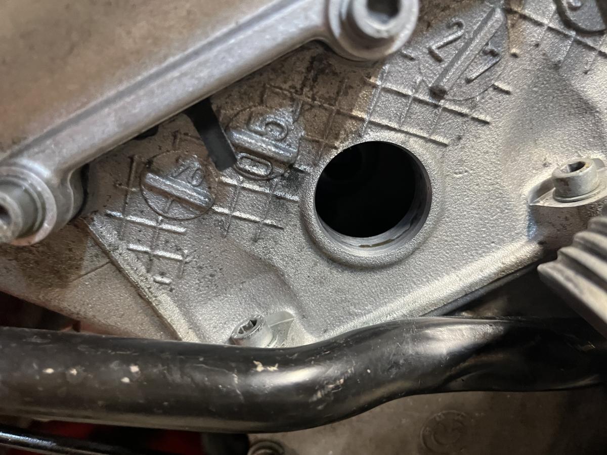

                              Chasing an oil leak. I noticed some oil around the lower half of the freeze plug. I’ve pulled the solenoid and cleaned that area up so I’m pretty sure that is a leak point. Also signs of an oil filter housing gasket leak. Hopefully that’s it for oil leaks.
                              Click image for larger version  Name:	CD543DE6-EFCA-499C-8DB2-10FD6D9498E3.jpg Views:	0 Size:	157.5 KB ID:	196090
                              I tapped the bottom of the plug to get it to rotate in the hole.
                              Click image for larger version  Name:	AD9C7AD2-2BDC-41EC-A90C-5EF647A22855.jpg Views:	0 Size:	178.6 KB ID:	196093
                              Then pliers to pull it out!

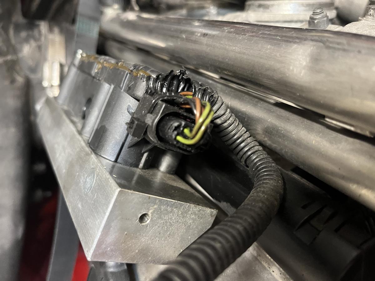

                              The VANOS solenoid plug came apart. There is a replacement socket - 61-13-8-383-300. That does not include the pins. As long as the wires, pins and insert are intact you’re good! Waiting on the part, I’ll post details.

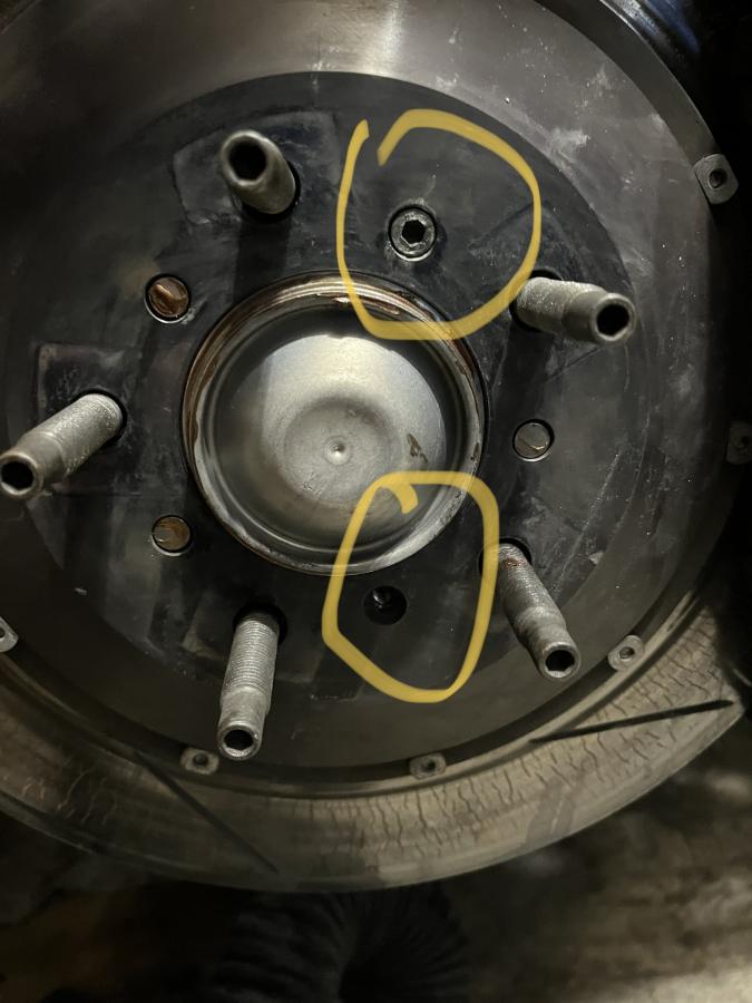

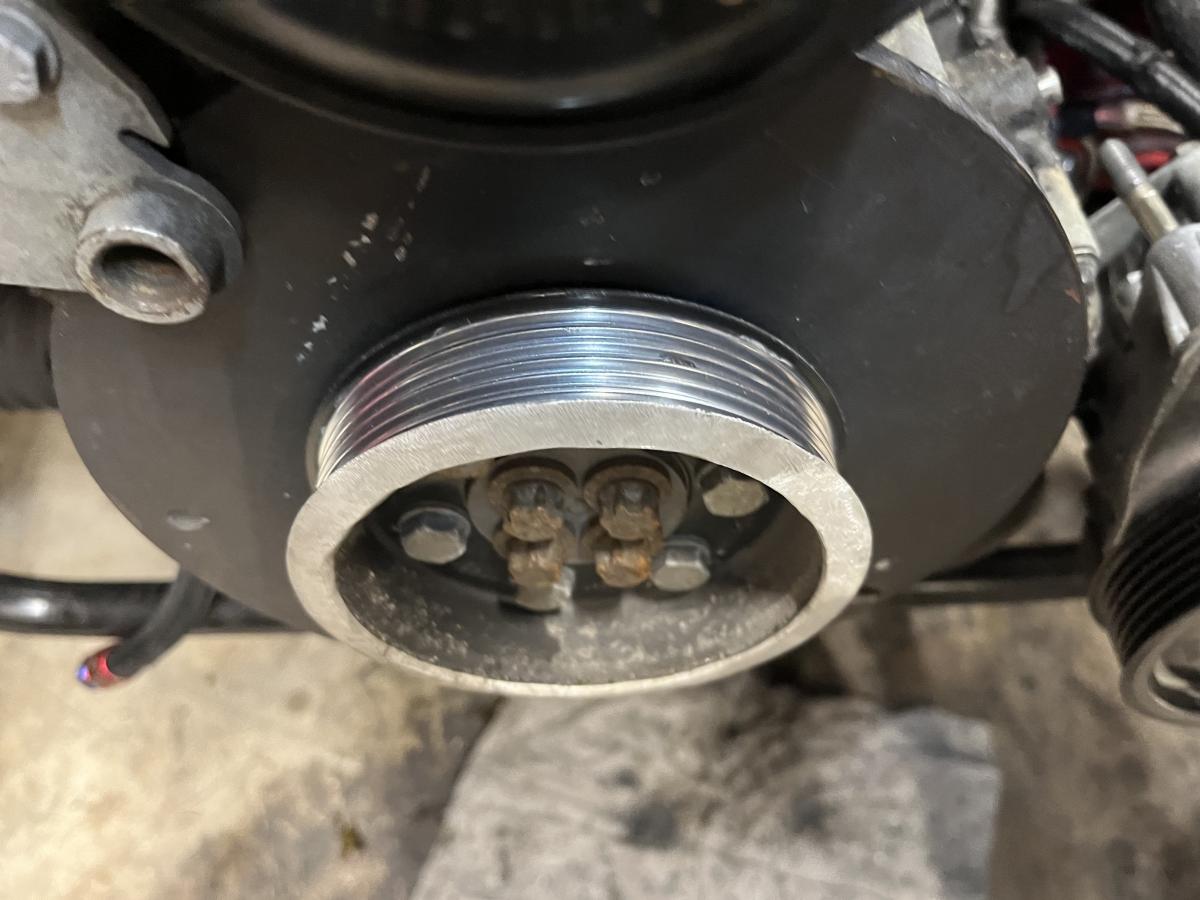

                                Do I only use 1 rotor bolt instead of 2 to save weight? Absolutely!
                                I also trim off some other unnecessary things. Seems minor but do 15-20 of these things that’s 2-4 lbs removed!
