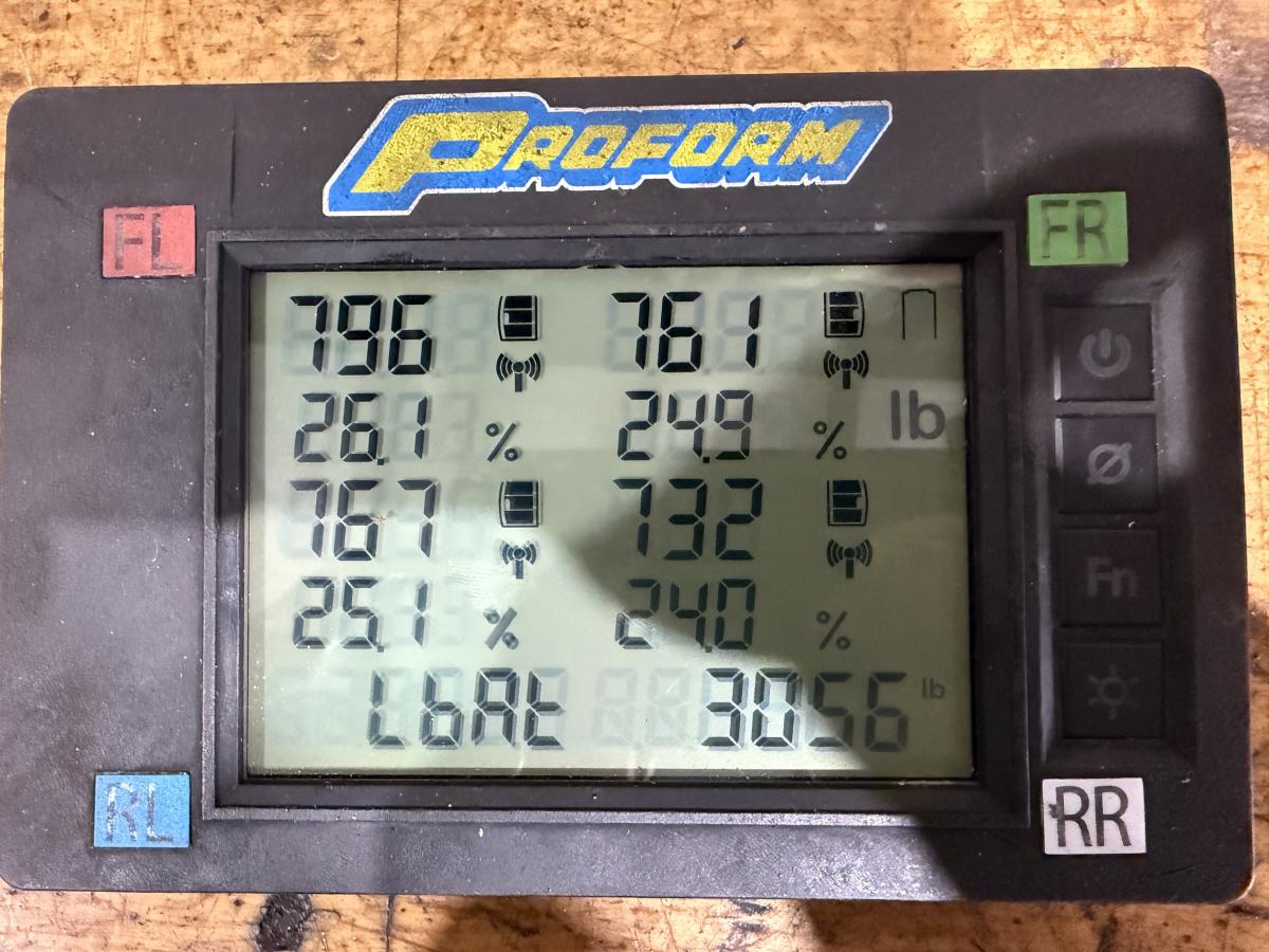

    Detune done. Corner balance done. The weight jackers do make life much easier if you don't want to make a front height adjustment. Minus ballast, driver, and fuel with Hoosier R7s, the car is at 2510lbs. With strategic ballast placement I'm within 2.1% on all 4 corners and only 50.9/49.1 front to rear distribution.
    The dream of sub 2500 lbs and 50/50 weight distribution is so close...yet so far away!

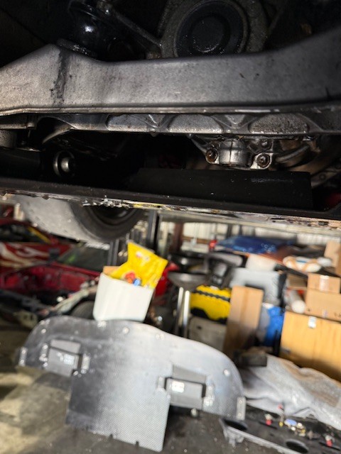

    Session 2...very bad. Cabin fills with smoke and car gets sideways. I thought I blew my diff. Drove it off track, got it on the lift...transmission drain plug is missing! I'm at a loss...because I haven't touched that plug since June last year. It is very possible I didn't tighten it enough. I tend to not want to really torque on the plug for fear of cracking the case or damaging something. Not my first oil disaster rodeo...hit it with foaming auto zone degreaser, wash off with a compressed air sprayer followed up by spraying with undiluted simple green.
    Drain plug replaced, fresh DCTF in the transmission. Trans seems ok. Goes into all gears. No rattles or noises. Fingers crossed.

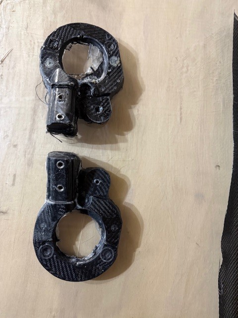

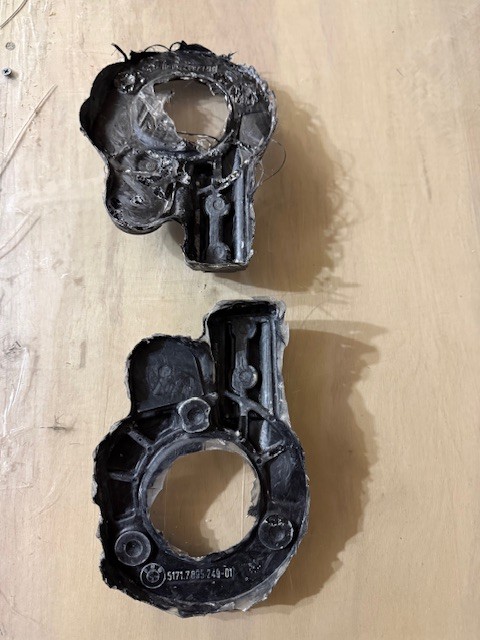

      Forged carbon strut tower plates came out good! Someday I'll finish Heinzenboehmer's strut brace project. Getting closer.

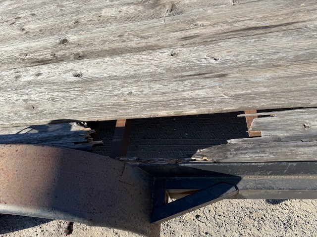

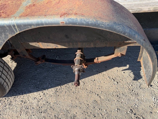

      Onto NASA at Motorsport Ranch TX. Calamities on Fri for test and tune. Lost a trailer wheel bearing and have a nice hole in my deck. I loaded the car at 10pm in pitch black conditions. Heard a crunch and didn't see damage until the next day. Then got sexually assaulted by a trailer repair place close to the track for a new axle. Trailer maintenance is not a strength! 🤣. I know my trailer looks ugly. Normally wouldn't mind if the wheels didn't fall off. Luckily the wheel came off when I got to the track.

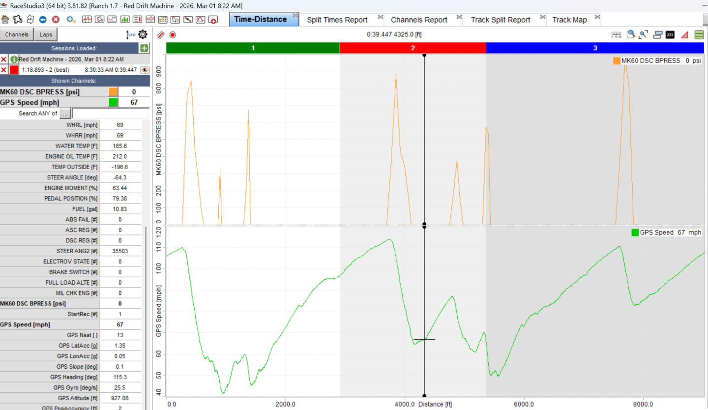

        Finally got the brake pressure data working. Greg Smith Racing, again with a genius solution.
        MK60 Brake Pressure Sensor Data – GSR Motorsports​
        It does work - stick to the white wire in the 719 cable and it will work! This is the exact data point I need to refine my braking and especially trail braking. I am doing MUCH better than I thought. The real test will be at MSR Houston though...a lot more really deep trail braking.
