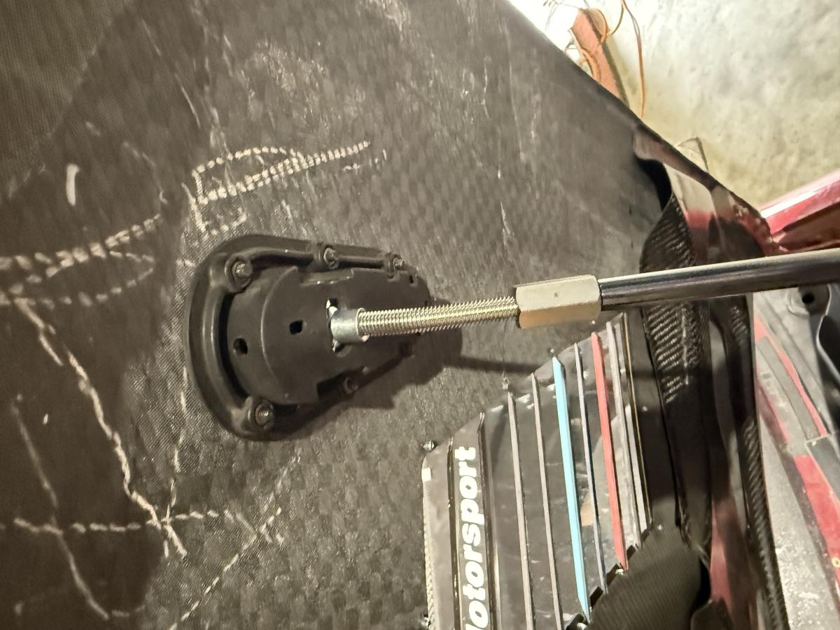

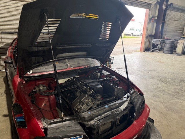

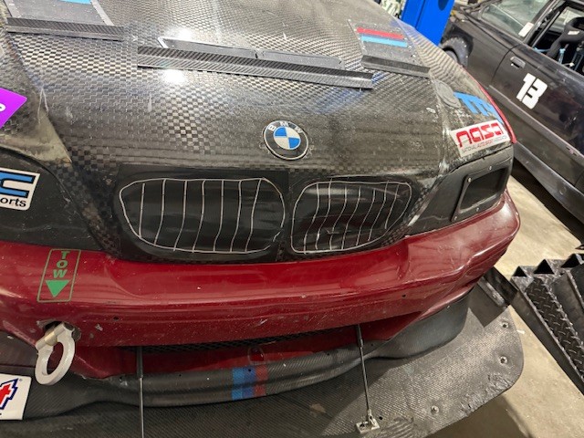

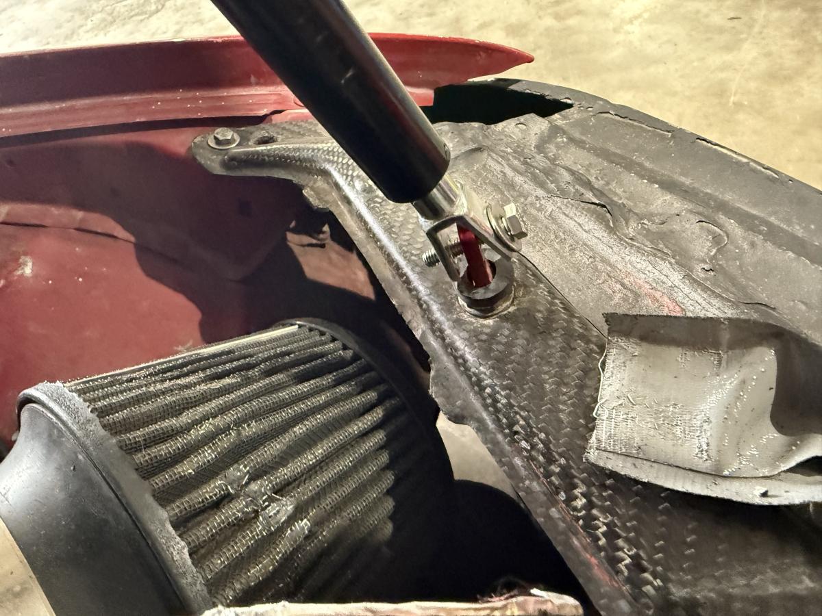

    I deleted the hood shocks and always had issues with opening the hood after a track session to let it cool off.
    well...no more! Cost about $30. It locks into the aerocatch latch and the pin. Wind proof!

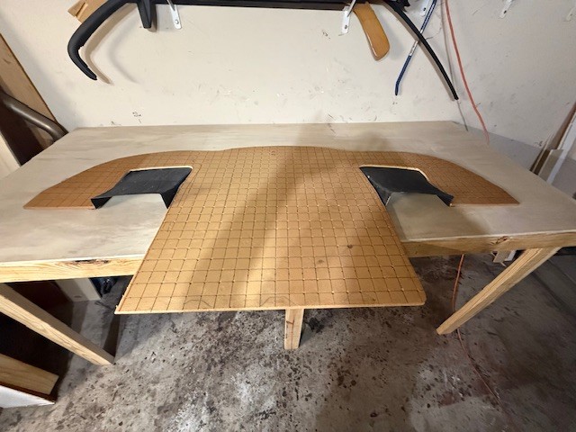

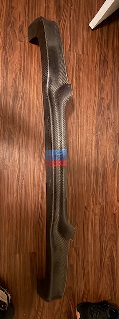

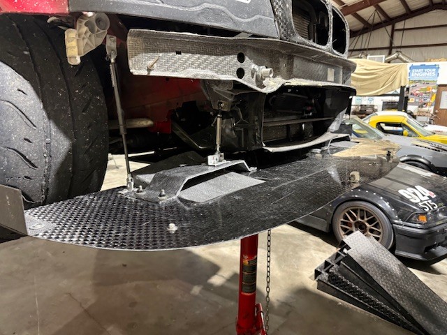

      Air dam is almost done. Needs a little more trimming.

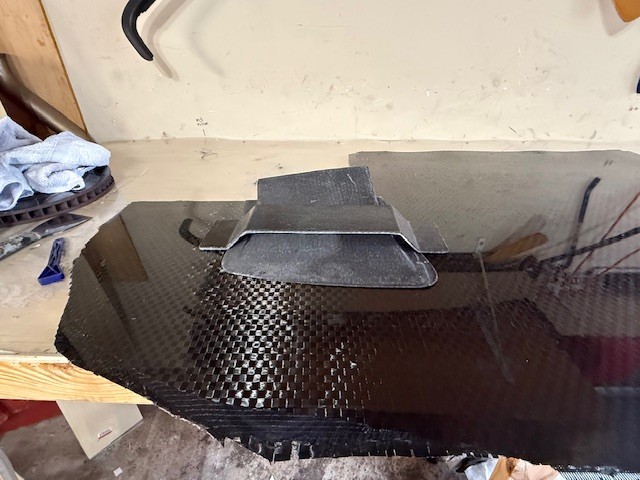

      I'm happy with the brake deflectors. So mold making has started! I think I have an idea for mounting. More to follow!

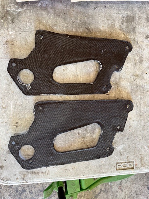

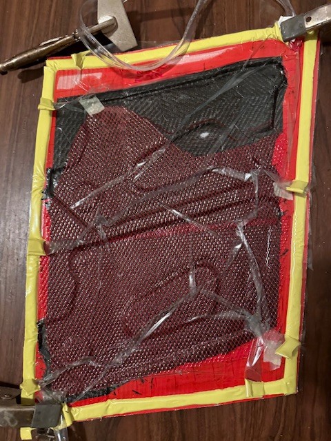

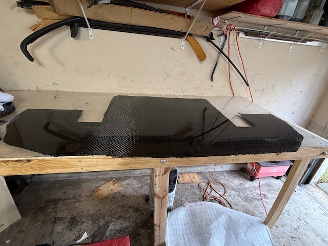

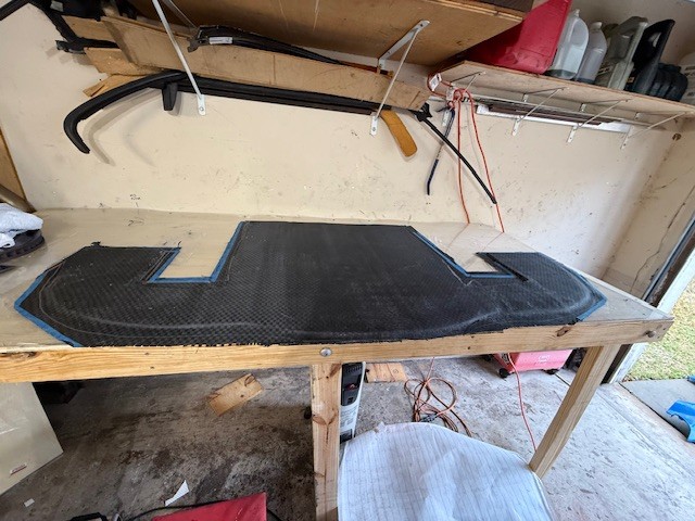

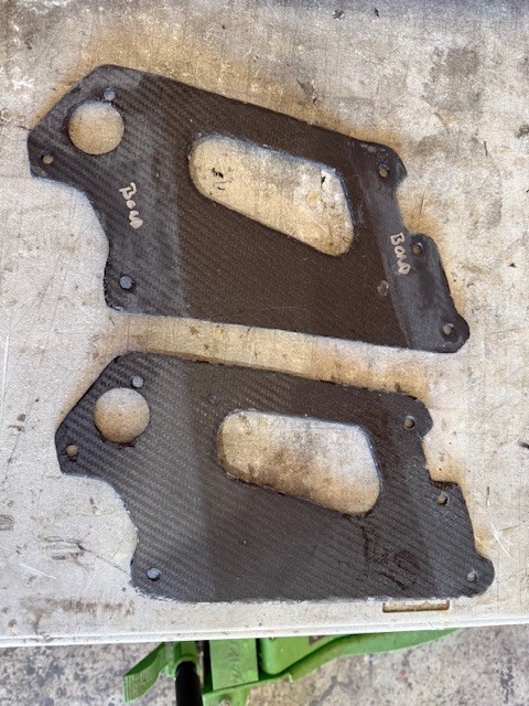

      Taking Bryson's reinforcement plate and making a CF part!

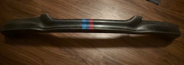

        Air dam is trimmed and finished.
        Click image for larger version  Name:	IMG_5484.jpg Views:	0 Size:	31.2 KB ID:	332317
        Click image for larger version  Name:	IMG_5485.jpg Views:	0 Size:	32.8 KB ID:	332320

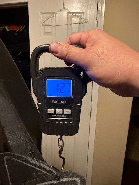

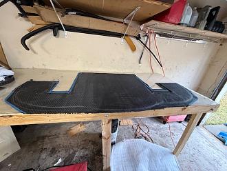

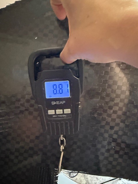

        1.2 lbs...should save me 1-2lbs over my cheap amazon.com aero version.

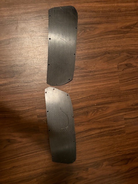

        Separate foglight block offs.
        Click image for larger version  Name:	IMG_5487.jpg Views:	0 Size:	84.3 KB ID:	332319

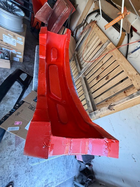

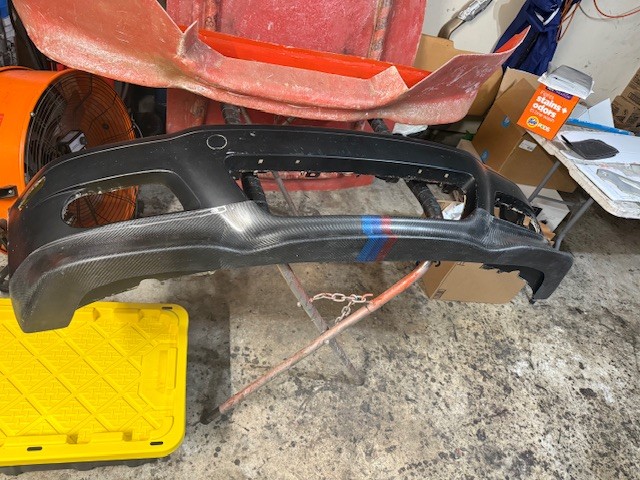

        Front bumper molds...3rd try...done. 1st attempt - the flanges need more support so they sagged when I was laminated the FG. 2nd attempt - I used some borderline release agent. Apparently, it was on the wrong side of the borderline so the part stuck to the mold and destroyed it.
        The plan is to pull a part and mold the air dam and some tire spats into one piece. Finally, make a mold of the entire assembly.

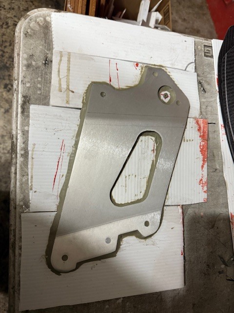

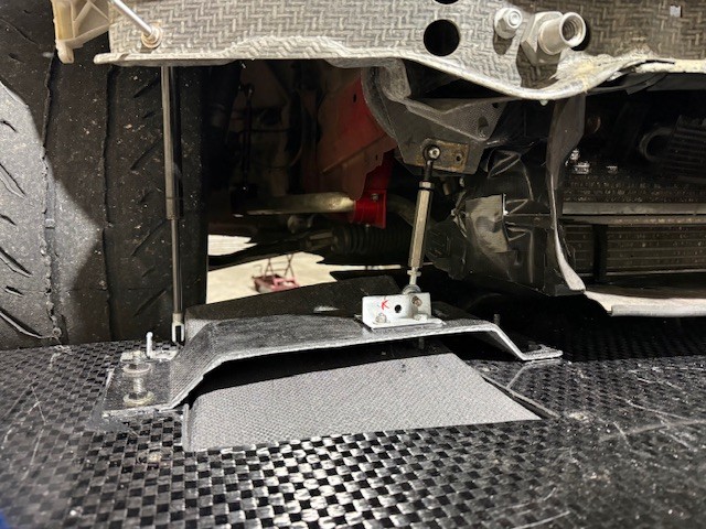

        Single air duct and brake deflector molds done. Still working on the wheel well plates. Had a gel coat issue so I'm starting over.
        Click image for larger version  Name:	IMG_5489.jpg Views:	0 Size:	91.2 KB ID:	332321

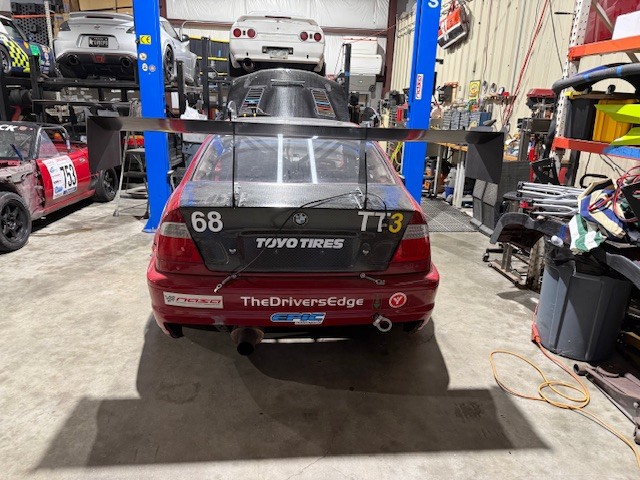

          AJ Hartman rear wing is on order, might be here in 2 weeks. Also time for a front splitter upgrade. I have to get into compliance with the 6" limit for NASA TT4 and will also add some tunnels. My splitter is 6.25" along 14" on the edge of the splitter...a 1/4"!!! But I don't want to hear any shit so better to be safe than sorry.
          FYI...A 6" splitter is a bad in-between for NASA. Needs to be a little less than 6" for TT4 or 10"-11" for TT3.
          And finally, I will implement the cheat code - Hoosiers!

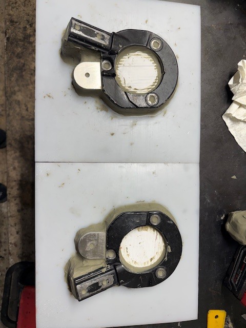

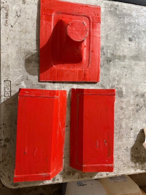

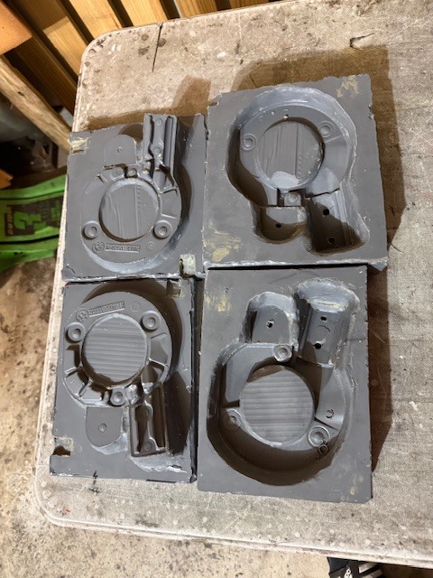

            Working on CF strut tower plates. Making a compression Adding a tab to make a triangular brace. The layup will be long strand forged carbon with nut inserts molded in. I have no idea if the insert will hold up. Worst case, I drill them out and bond a stud plate underneath.
            Half way done! The 2nd half of the mold will be a PIA. All of the little details will provide opportunities for a bad release.
              Maybe consider making the underside flat? The details are just there to save weight for the cast part.
              (which means you'll end up with a heavier carbon part if you fill that in, of course)
                I did but I don't think it will be a huge issue. I use release wax and then a chemical release. So I just need to spend more time getting the wax into the corners. Then the chem release is a solvent so it should provide a good backup to the corners and edges.
                  You could also do a hybrid. Fill the tight corners with putty to open up the radii and make release easier with little weight penalty.
                    I would more likely do that for the first half but I'm willing to risk it for the 2nd half. The 2nd half uses about 1/3 the casting resin and is relatively quick to setup. Most of the work is in the first half of a compression mold.

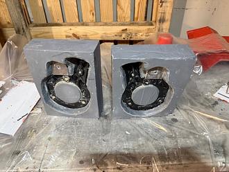

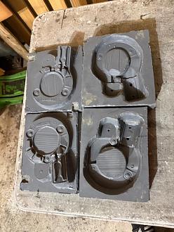

                      2nd half of the mold is done. Once again, I forgot to install drive pins in the negative side to get the part out. So I had to drive the part out by threading a bolt in. I chipped the mold around the bolt hole which will require a repair. It will be a pain but maybe I'll learn my lesson this time.
                      Also didn't catch a negative draft around the inner opening. So I need to make 2 small repairs on each side.
                      Overall they came out really good!
                      Onto making the repairs, calculating the volume, and then making a part sometime in the future. Just not sure when, gotta get ready for NASA in 3 weeks among other things.
