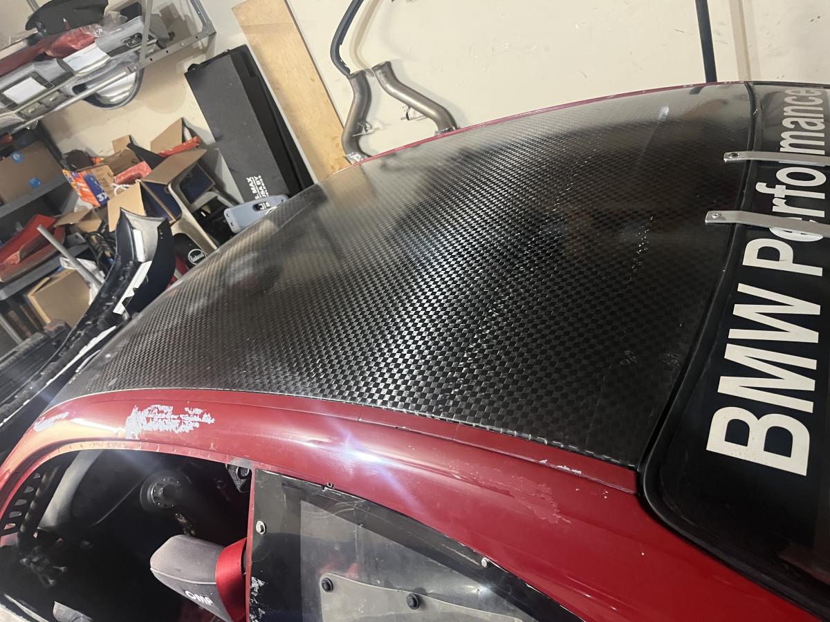

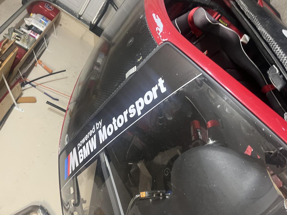

        I installed a CF roof panel. Forgot to post it.

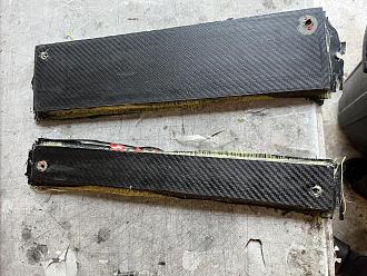

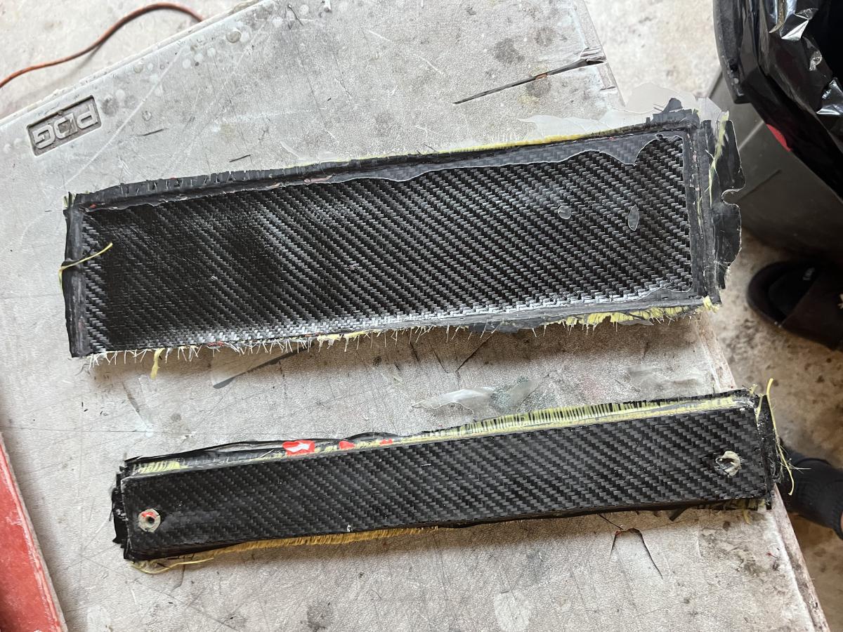

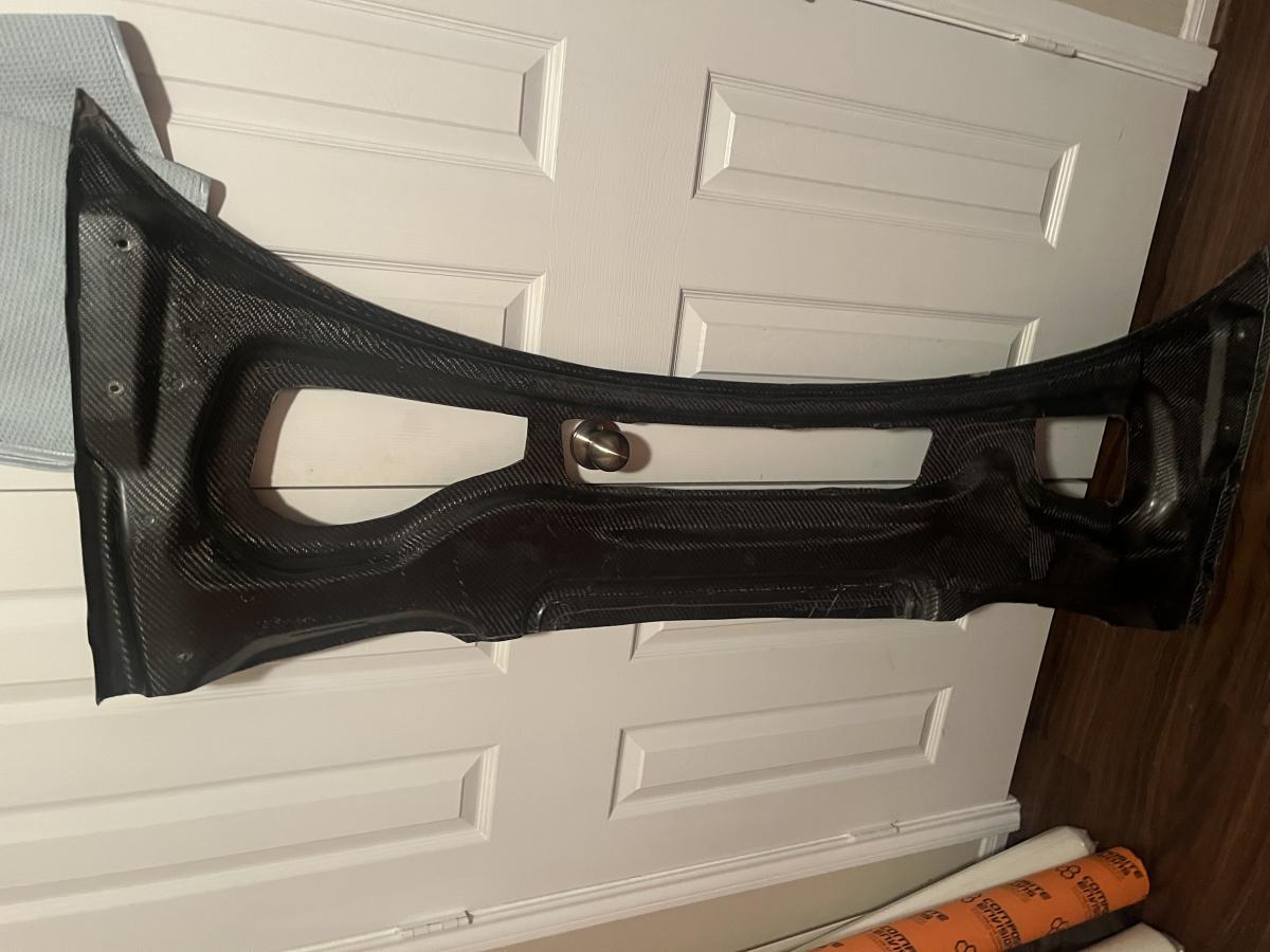

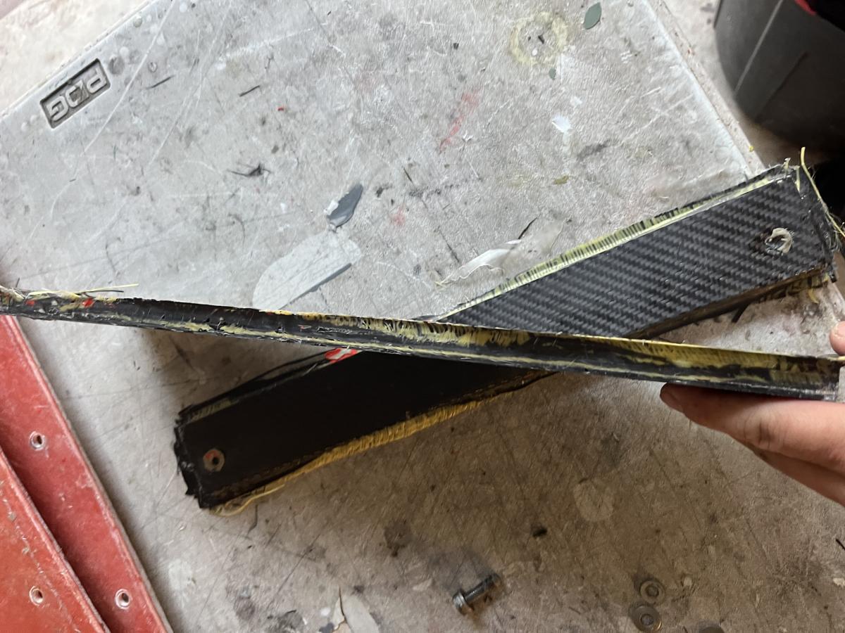

          Carbon fiber racing seat floor mounts! The backside didn’t go as planned but they turned out great otherwise! 2.25lbs for the outer and inner. 90% Carbon and 10% kevlar. These will be a mutha f’er to drill. Have to figure that out. Might have to outsource that.

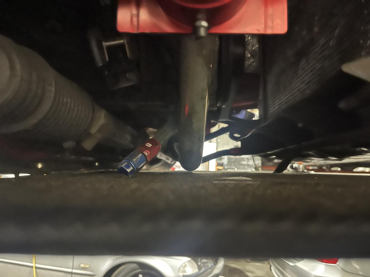

            I installed a ground control front sway bar. I know some mentioned it interfered with the splitter. It barely clears mine.
            OEM bar w/bushings, housings, and bimmerworld endlinks - 15.6 lbs
            GC bar - 12.6lbs.
            3lbs of weight loss!

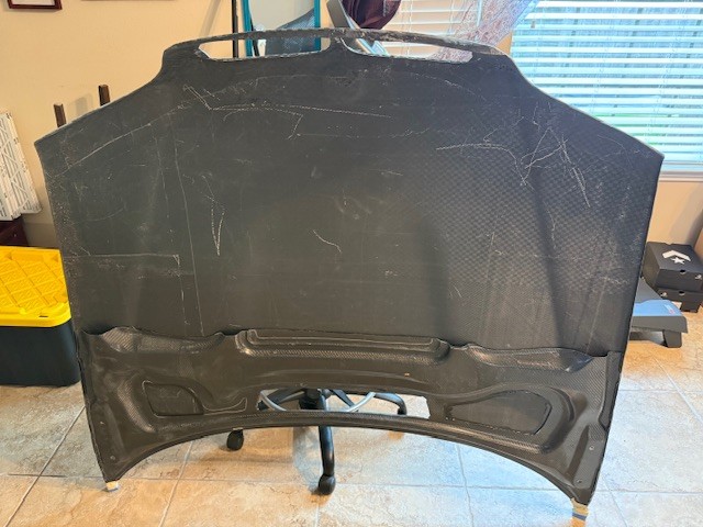

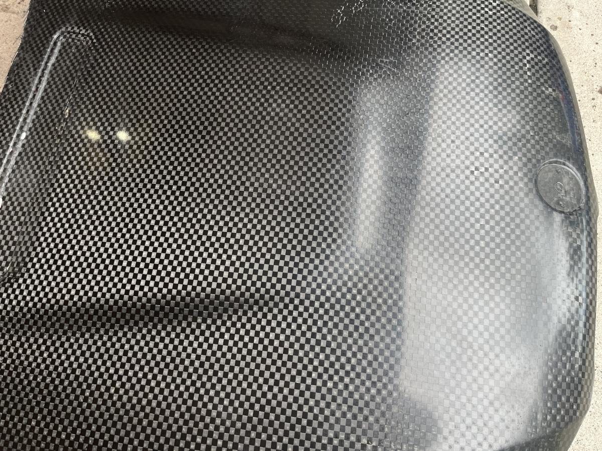

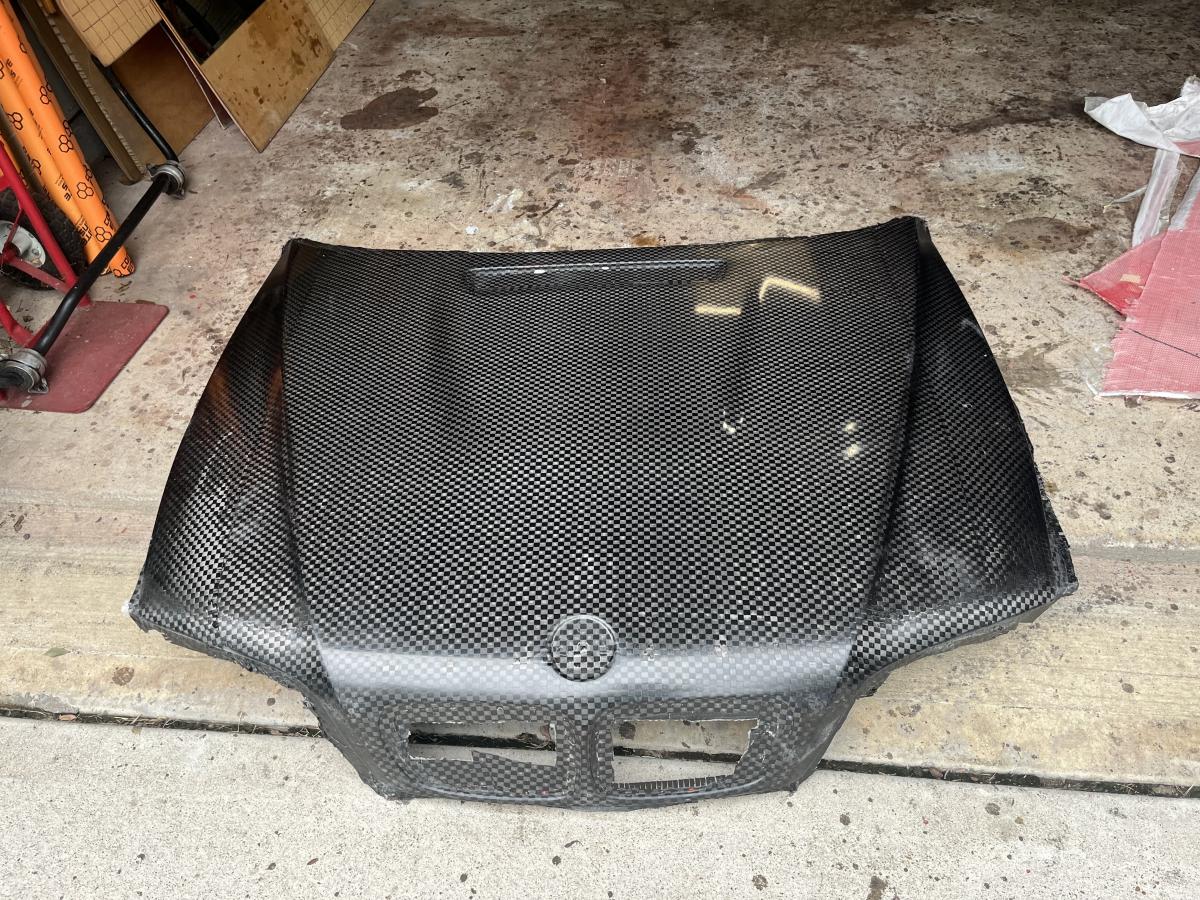

              Carbon hood #2. My supplier shipped me different epoxy which is turning out to be mildly disastrous.
              My hood did not fully infuse so I am having to do a bunch of post work which is in progress and not looming forward to.

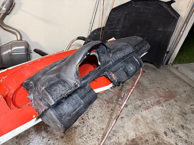

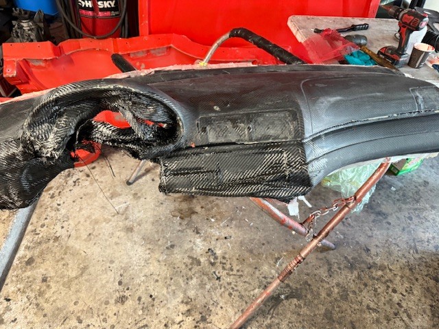

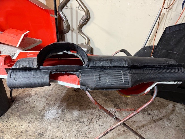

              Also got my ass kicked making a dash with this f’ing epoxy! Yeah, this one ain’t gonna work 🤣!
              Click image for larger version  Name:	IMG_4975.jpg Views:	0 Size:	128.4 KB ID:	316473
              Made some adjustments and the next one was better.

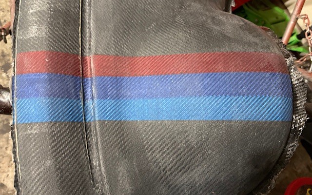

                Trying out the M color stripes. Its a total pain in the ass but it looks cool!

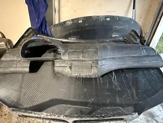

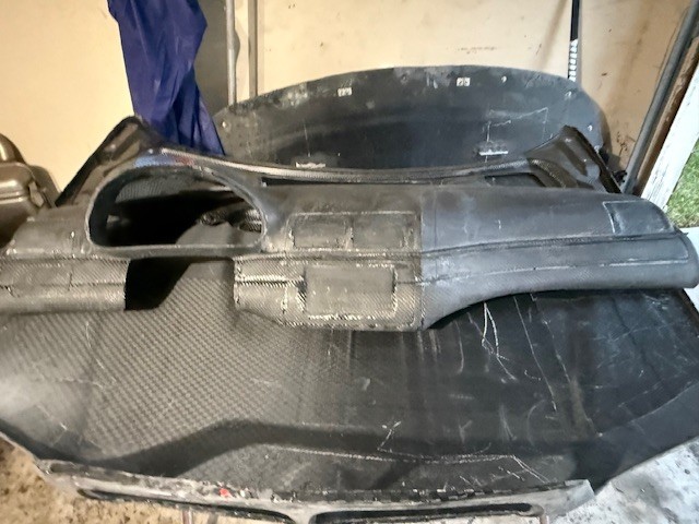

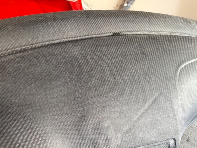

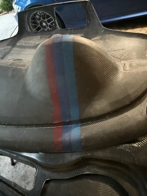

                  The dash is done! 3.3lbs full size, 3lbs trimmed to fit around the roll cage. I think this will be 10lbs of weight loss.
                  Click image for larger version  Name:	IMG_5105.jpg Views:	0 Size:	84.3 KB ID:	316798
                  Click image for larger version  Name:	IMG_5106.jpg Views:	0 Size:	72.6 KB ID:	316799
                  The dash has the OE texture so it comes out dull. Just can’t sand it or really do anything to keep it not shiny. I used a dash with some sort of cosmetic issue above the center vents. Got it cheap and its for a track car.

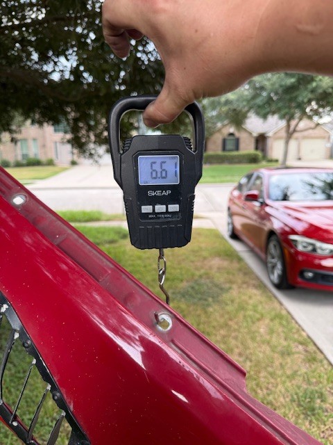

                  working on a project for someone so I had to take off my fenders. The OE fenders are 6.6lbs. Should be able to make a 2.5 to 3lb carbon version.

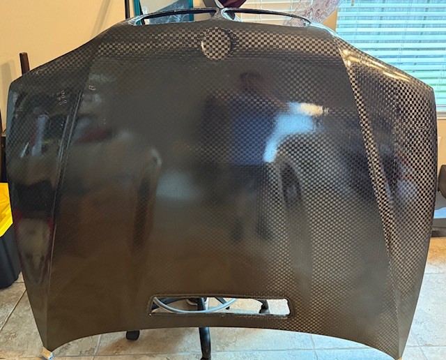

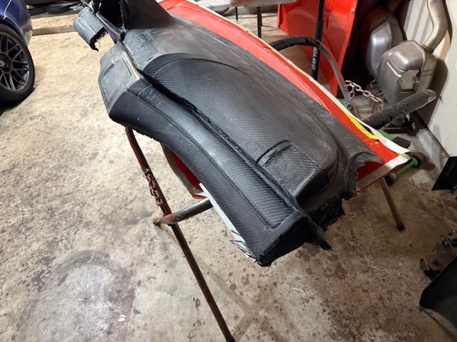

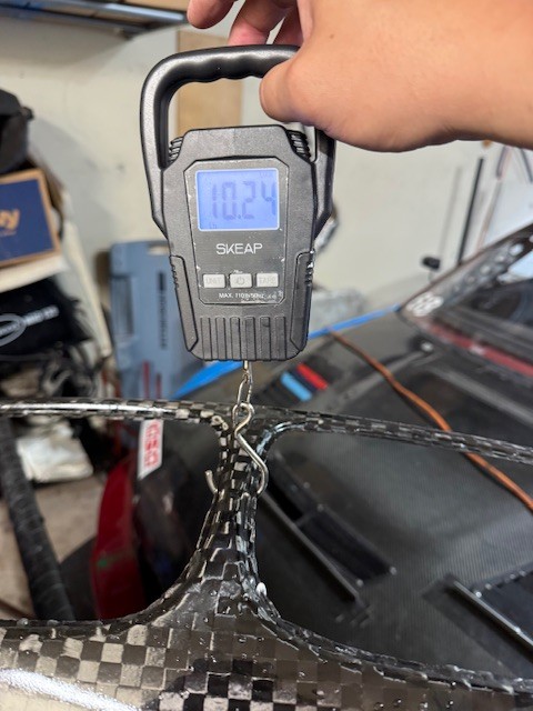

                    Carbon hood V2 is done! It is 3.5lbs heavier than V1 but far stiffer. Twice as thick and a larger underside. Don’t think it will lift along the windshield which adds a lot of drag…I think. Not perfect. Supplier sent different epoxy. I thought it would be ok but it made infusions really challenging. Learned that there is a big difference in epoxy quality.
                    It worked out in the end. Sexy spread tow fabric with a rattle can 2k clear finish.

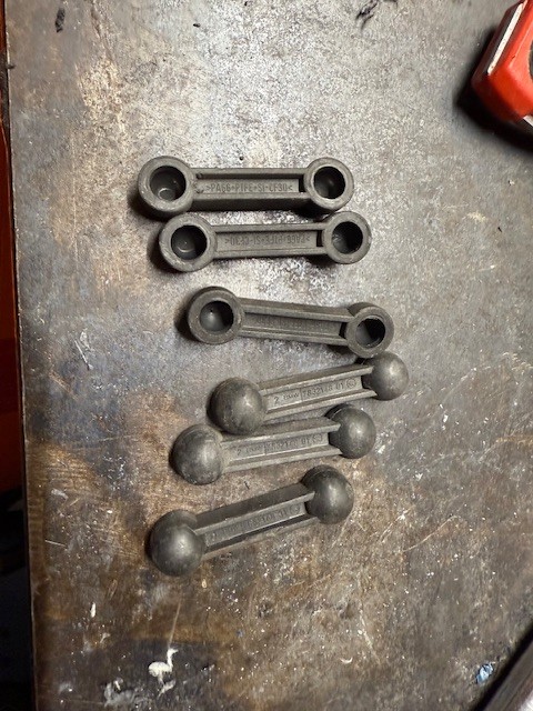

                    Replaced the dogbones on the throttle bodies. Randy from Epic saw a flutter in AFRs (I think) in the mid-RPM range and said I should replace these. Getting the ITBs off are a minor pain but it is an easy DIY otherwise.
                      How would those rods would affect AFR?
                        The plastic end gets worn out and allows the butterfly to chatter - at least that is what I'm told.

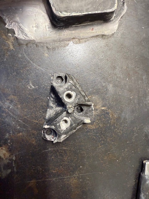

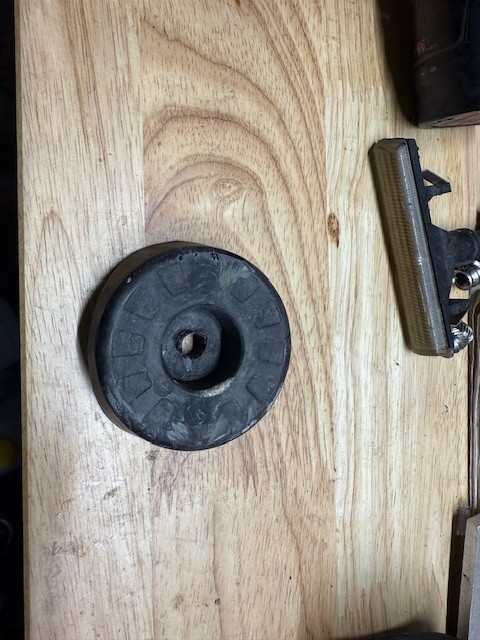

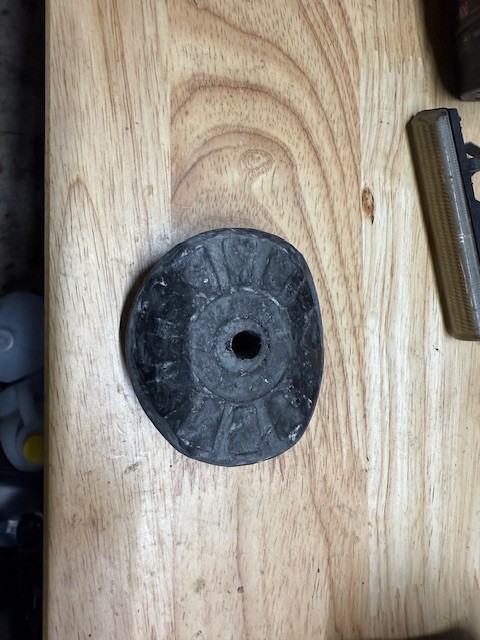

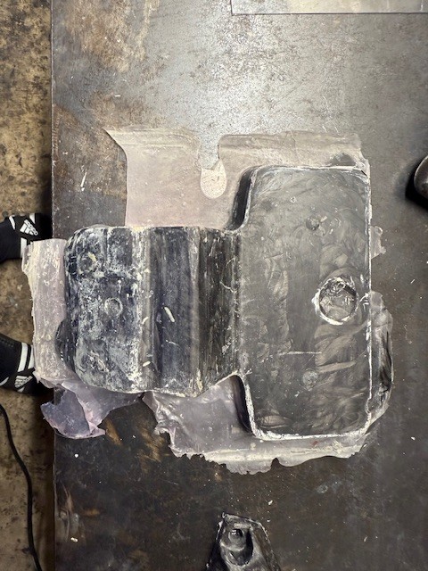

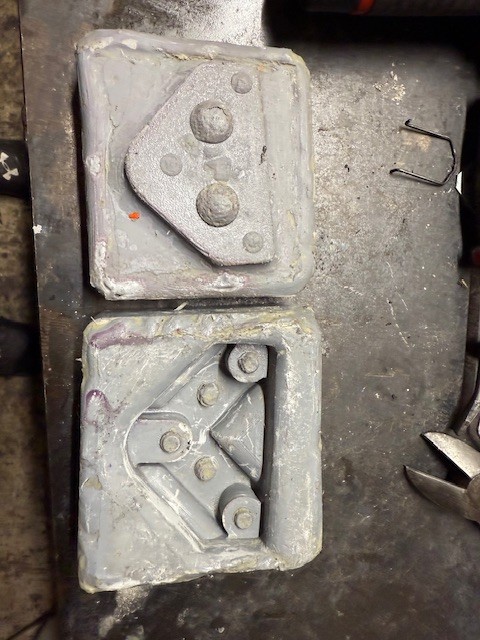

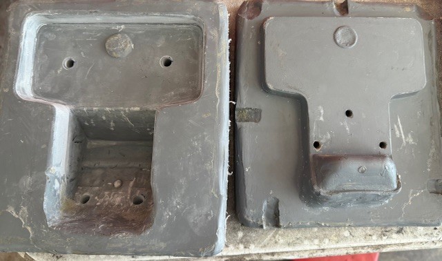

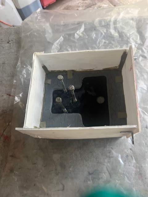

                          So I’m using heinzboehmer’s strut bar design to learn how to cast molds and also add some front end stuffness.
                          Huge thanks to Mr Heinzboemer for sending some 3D prints of the center mounting!
                          It is mildly mindbending to think in reverse of the reverse of the actual part.

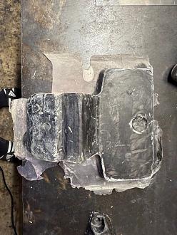

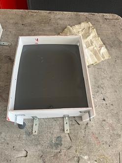

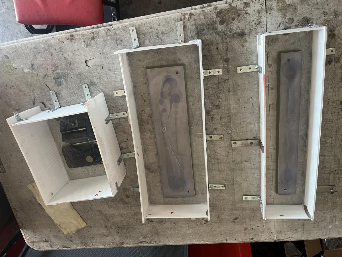

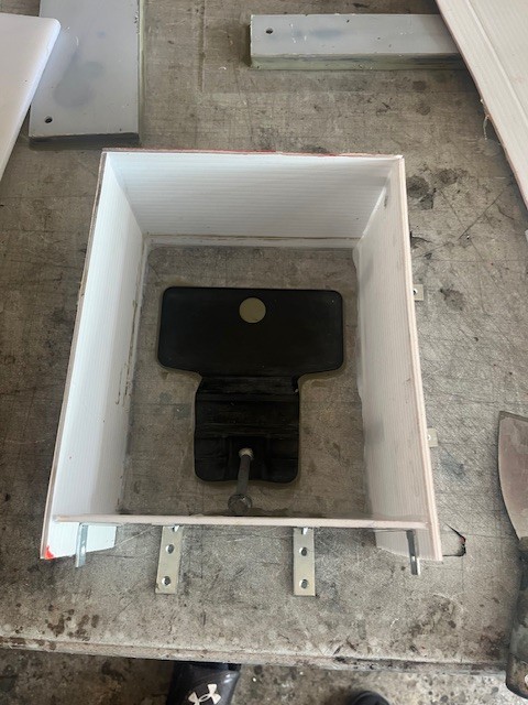

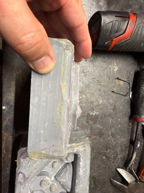

                          First, need to prep the plug to cast. Can’t have any negative or 90 degree angles! Create a draft angle at the base, seal and release and then make a fence.
                          Click image for larger version  Name:	IMG_4622.jpg Views:	0 Size:	88.6 KB ID:	320345

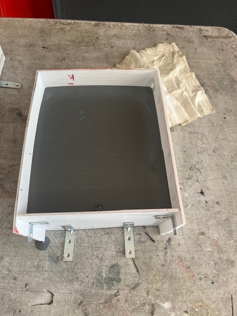

                          pour the casting resin
                          Click image for larger version  Name:	IMG_4635.jpg Views:	0 Size:	89.6 KB ID:	320344

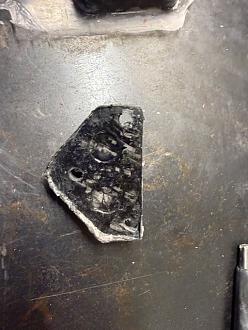

                          flip it over, pry out the base, release and pour
                          Click image for larger version  Name:	IMG_4727.jpg Views:	0 Size:	59.7 KB ID:	320340
                          Done!
                          Click image for larger version  Name:	IMG_5070.jpg Views:	0 Size:	63.7 KB ID:	320343
                          Click image for larger version  Name:	IMG_5251.jpg Views:	0 Size:	86.6 KB ID:	320347
                          Click image for larger version  Name:	IMG_5250.jpg Views:	0 Size:	99.9 KB ID:	320341

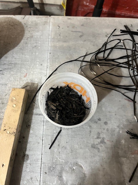

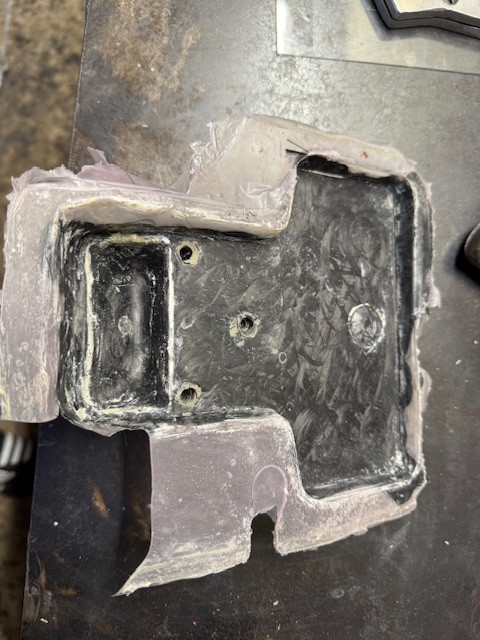

                          Chop up some carbon, mix epoxy and you have a carbon copy!
                          Click image for larger version  Name:	IMG_4757.jpg Views:	0 Size:	93.3 KB ID:	320348
                          Click image for larger version  Name:	IMG_5272.jpg Views:	0 Size:	115.2 KB ID:	320338
                          Click image for larger version  Name:	IMG_5275.jpg Views:	5 Size:	102.5 KB ID:	320349
                          Click image for larger version  Name:	IMG_5273.jpg Views:	0 Size:	105.7 KB ID:	320339
                          Click image for larger version  Name:	IMG_5274.jpg Views:	0 Size:	91.0 KB ID:	320346

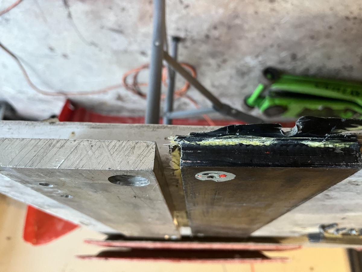

                            I molded in threaded inserts instead of studs - studs were $21 a piece! Then I’m going to bond the 2 parts together since I don’t have to worry about servicing my wipers are blower motor.
                            I’m going a different route for the strut bar plates. I am planning to bolt the extra bars onto the existing studs. I will need longer studs and I think I may need to make the strut bar end plates from something stronger - carbon fiber!
                            For the bars, I might use some tubes and rod ends from here: DragonPlate | Engineered Carbon Fiber Composite Sheets, Tubes and Structural Components | Made in USA​. Then modify the rod ends to be a negative of the OE strut bar so it fits on top.

                                I'm thinking that making the stud plate from aluminum and the base plate from carbon would be an excellent balance especially considering the cost of machining the base plate from aluminum.
