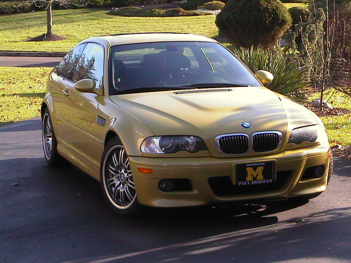

                  Couldn't resist, had to go searching for a pic. Here's my old 2001 PY, which I bought in 2004. Loved that car.
                      So pretty!
