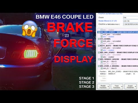

                I think the earlier cars with LED taillights have a form of brake force display with the outer LED's
                Code:
                The last clip uses this code:
                BFD_SW1_STUFE2 BFD Stage 2 activation using Deceleration Sensor 1 - aktiv
                BFD_SW2_STUFE2 BFD Stage 2 activation using Deceleration Sensor 2 - nicht_aktiv
                BFD_ABS_STUFE2 BFD Stage 2 activation using ABS - nicht_aktiv
                BFD_SW1_STUFE3 BFD Stage 3 activation using Deceleration Sensor 1 - aktiv
                BFD_SW2_STUFE3 BFD Stage 3 activation using Deceleration Sensor 2 - aktiv
                BFD_ABS_STUFE3 BFD Stage 3 activation using ABS sensor - aktiv
                BLST1_BLST3 Outer tail lights blink during Stage 3 - aktiv

                  I would set
                  BFD_SW1_STUFE3 to nicht_aktiv instead.
                  You also have to enable a couple parameters in the instrument cluster.
