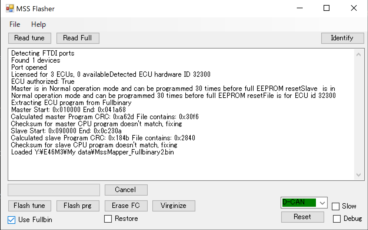

    I flashed the Fullbinary created by MSS Mapper with MSS Flasher.
    Engine does not start.

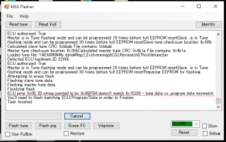

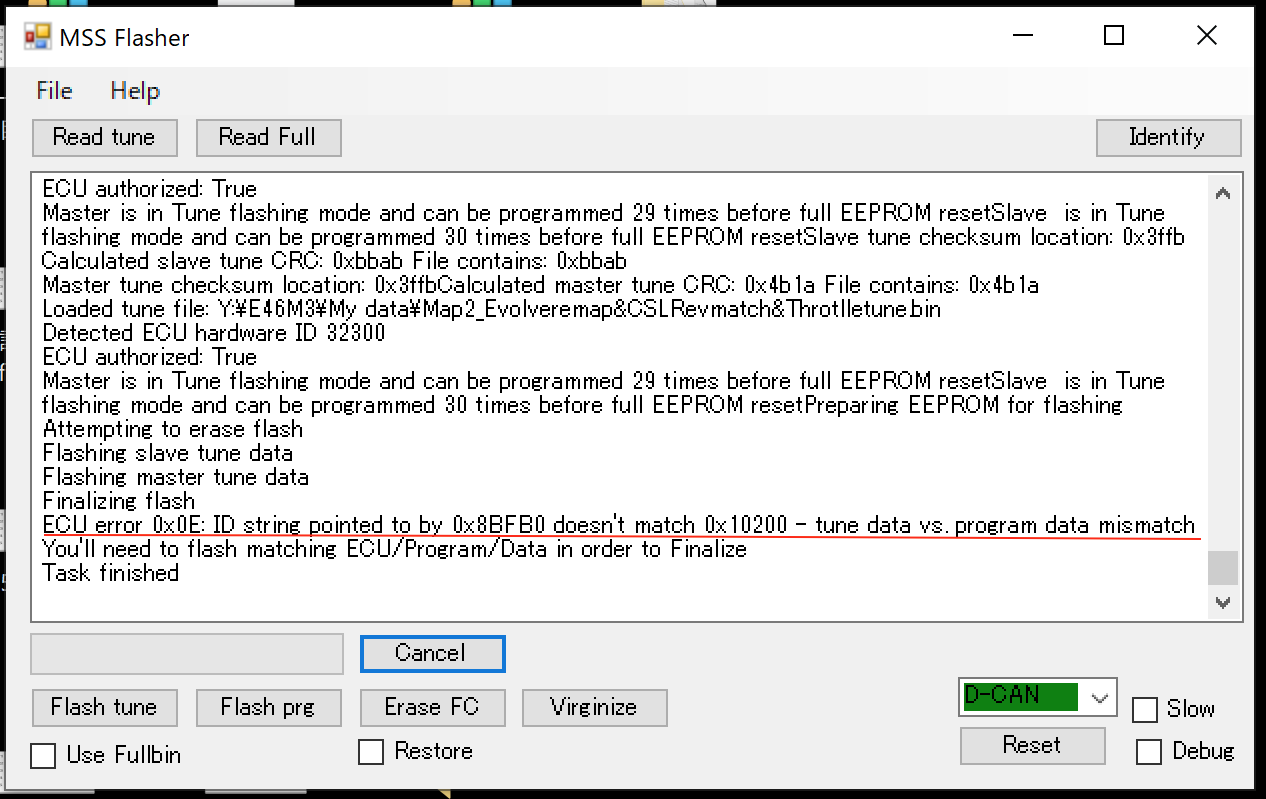

    I also flashed the Partial binary, but I get a mismatch error like the attached image.
    Are there any necessary steps?

      The problem was resolved and MssMapper was able to work in my vehicle.
      The fundamental problem was that I ended up using the full binary of another vehicle.
      (The cable was fine.)
      Communication is possible by flushing the tune file that matches the Prg file.

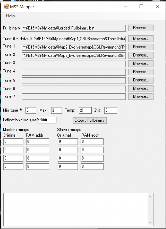

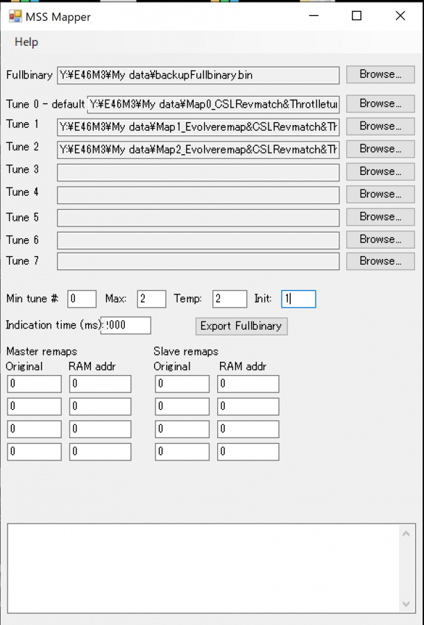

      Here is how to use MssMapper.
      1. Create a full bin with MssMapper. (Definitely use your own full bin.)
      Click image for larger version  Name:	Mssmapper.png Views:	0 Size:	225.9 KB ID:	173891
      * "Init" is the initial value when the engine is started. If you say "1" like me, it starts with tune1.
      * "Master remaps" and "Slave remaps" was okay with a blank.
      2. If you want to flash back using Mssflasher, follow the steps below.
      ・Load the full binary created by MssMapper.
      ・Run Flash prg.
      ・Load full binary again.
      ・Select Use full binary check box.
      ・Run Flash tune.

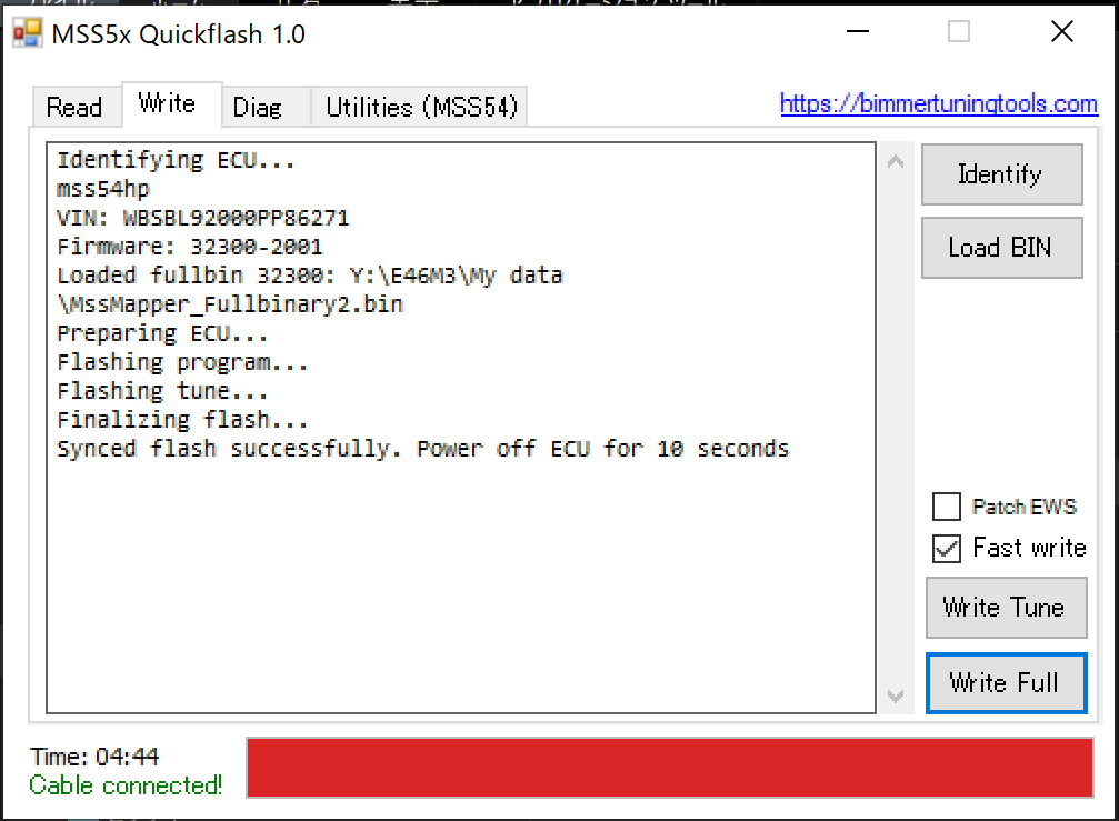

      ※You can also use MSS5x Quickflash ($49) to flash. With it, prg and tune flash in a single run operation.
