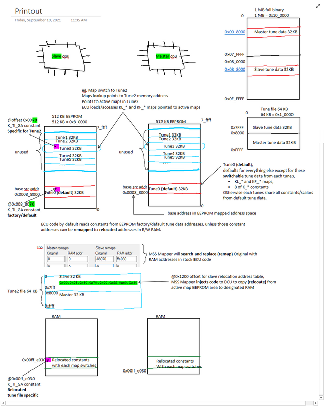

    First is the maps themselves, the BIN files for switching the maps, eg. KF_TI_N_RF and KF_TI_N_RF_VL maps. For this i had the tuner provide me with the 5 of 64 KB tune BIN files (3 are for pump 93 octane, and tunes 3 and 4 for E50 and E85 blends), along with the fullbinary that will get patched with some codes and add these switchable tunes into unused eeprom space.
    I don't understand what all happens in the background, under the hood in MSSMapper, nor do i understand how these 64 KB tune BIN files are created.. Of course i also don't know much about tuning these maps. I guess that's why i pay the tuner.
    If i were to guess these 64 KB tune files are applicable to outside of MSSMapper, and is what all other MSS54HP (which is the ECU variant i have in my E46 M3) tuner would know how to create and add their tune to the maps.
    At the bottom section of the program interface what i think those boxes are for, is allowing for remapping of limited number of tune constants, eg. what the instruction gives for remapping one example constant, the global injector constant.

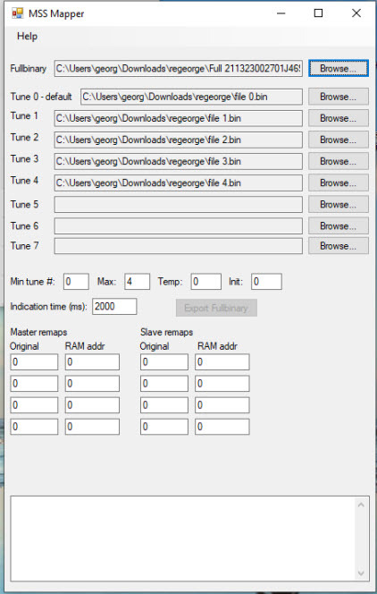

    My problem right now is, i got the tune BIN files, and i add the fullbinary. But the Export Fullbinary button remain grayed out.
    I've been working off and on with Paul, and has been bit of challenge to get replies from Paul.
    Maybe we can learn from each other.
    Unfortunately my tuner has pretty much given up on this product so i'm kind of stuck in rock and a hard place, so to speak...
    I was going to create a new thread in this forum but saw your post so decided to just piggy back on it.
    My other option was to ask in E39 M5 board, at m5board.com space.
    Click image for larger version  Name:	SNAG-20552.jpg Views:	0 Size:	71.5 KB ID:	125694
      PSA: please restart the app after register... Paul helped out. Thanks.
        My main question is this... Is this something really as simple as you have a full binary and then several different variations of tune files based off the full binary... And all you have to do is just load up all of your different variation of tune files and the full binary into MSS mapper And that's it once it flashes it's as simple as just using the cruise control buttons to cycle through your tune files?
          Is this something really as simple as you have a full binary and then several different variations of tune files based off the full binary.. ----- basically
          And all you have to do is just load up all of your different variation of tune files and the full binary into MSS mapper And that's it once it flashes it's as simple as just using the cruise control buttons to cycle through your tune files? ---- correct, unless you are remapping any K_* constants
          Here's some stuffs thrown in mainly to help me with big picture,
