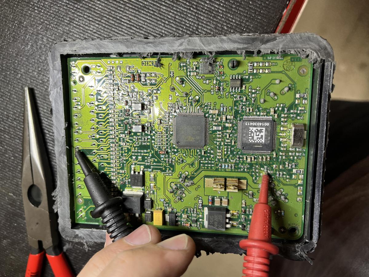

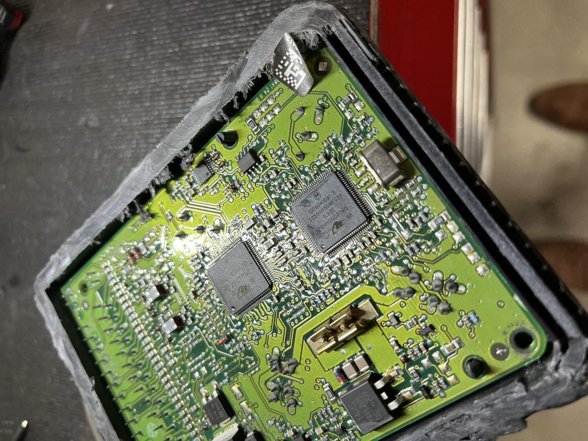

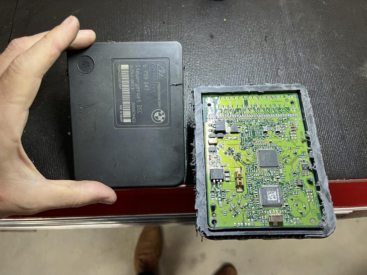

                    Well folks,
                    If the m-track button is indeed pin 38, I can confirm that it does appear that the non-M MK60 has resistors populated to make this a functional circuit. The circuit is very similar to pin 39 for the regular DSC button with different values in the resistor network. I’ll try my hand at a PowerPoint schematic shortly.
                    in the mean time, can anybody ID this Motorola IC?

                      The main processing IC is made by Texas Instruments for ATE Teves so I reached out to a friend who used to be a senior electrical engineer at TI during the period. He doesn’t know of the chip and believes it’s unlikely that we’ll be able to get any sort of data sheet for it. Search continues, I should have known that wouldn’t be an easy win for figuring out how to flash.

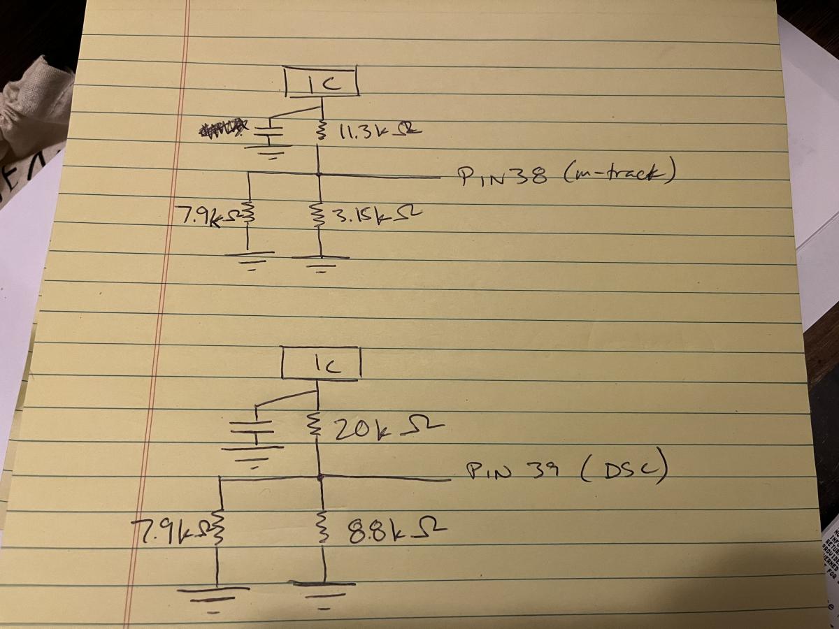

                      Can anyone with a CSL/ZCP unit measure resistance between pins 37 (common ground, along with many other pins) and 38? I get 3.15k ohm from 37-38 and 8.83k ohm from 37-39
                      edit: hand schematic attached. I need to go re-measure pin 39 as the math doesn’t add up as sketched. I’m sure I messed up in my notes somewhere.

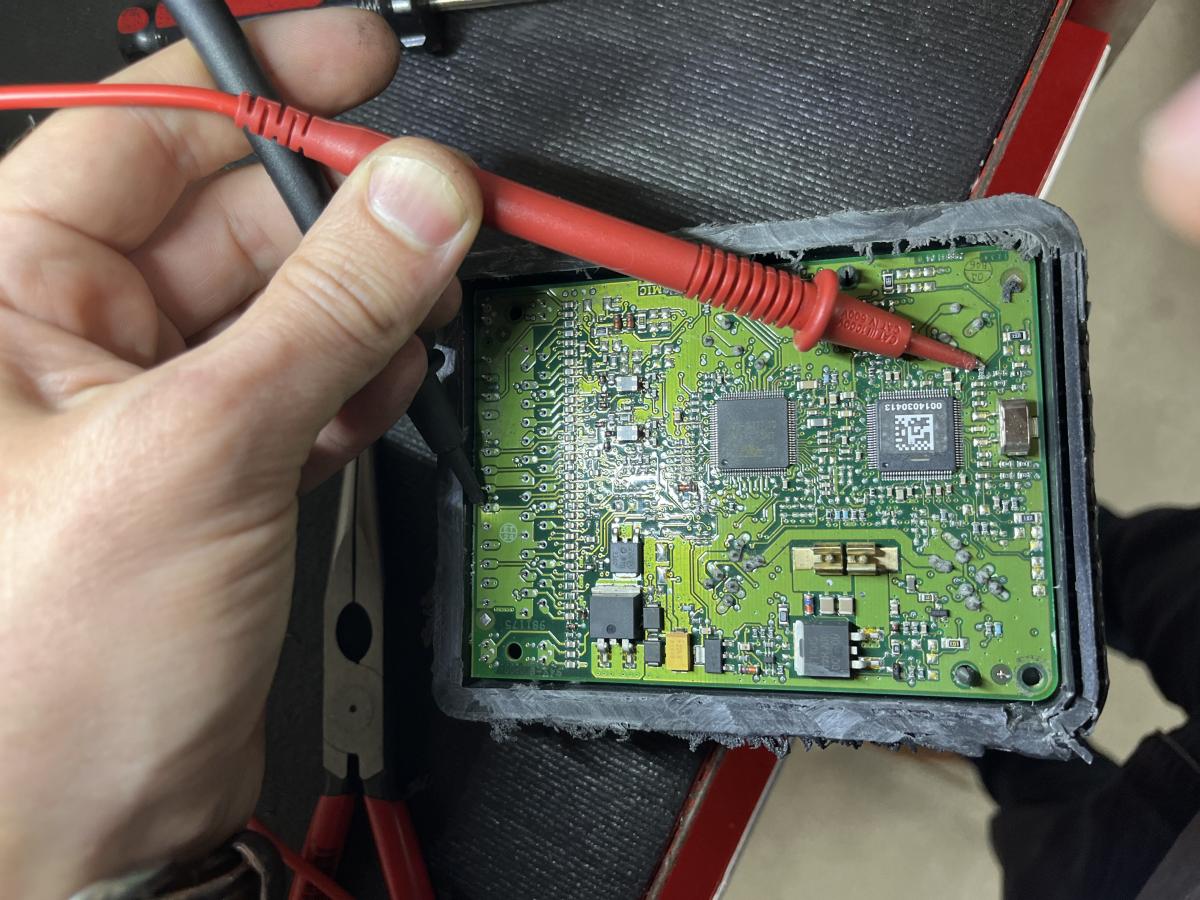

                        Thanks to TropicalM3 who had both a ZCP and M DSC available, we’ve got measurements for both, and the non-M looks to be similar to the M for pin 38.
                        With the ZCP Module and the positive cable on 37 I got on 38-14.1, on 39-8.7 and on 40-18.4. With the Negative set on 37 I got on 38-16.2, on 39-8.7 and 40-19.8.
                        With the Non-ZCP positive on 37 I got on 38-3.2, 0n 39-8.8 and on 40-19.5. With the negative set on 37, on 38 I got 3.2, on 39-8.8 and on 40 I got 22.5.
                        I noted that on my non-m module, pin 40 (the TPMS pin) is shorted directly to ground as that was the only other difference I knew of that might be hardware related.
                        In summary, measured to ground at pin 38 for m-track:
                        non-M: ~3.2k ohm
                        M3: ~3.2k ohm
                        ZCP: ~14.1k ohm
                        this may imply that there’s not enough resistance in the M and non-M units to pull down the IC pin when grounded. Fear not, this is measurable.
                        Next up I’ll power up my non-M unit on the bench, measure voltage at the IC pin associated with pin 38, then pull pin 38 down to ground and measure what happens at the IC pin. The IC likely has an internal pull up resistor of some value that can be calculated after this experiment.
