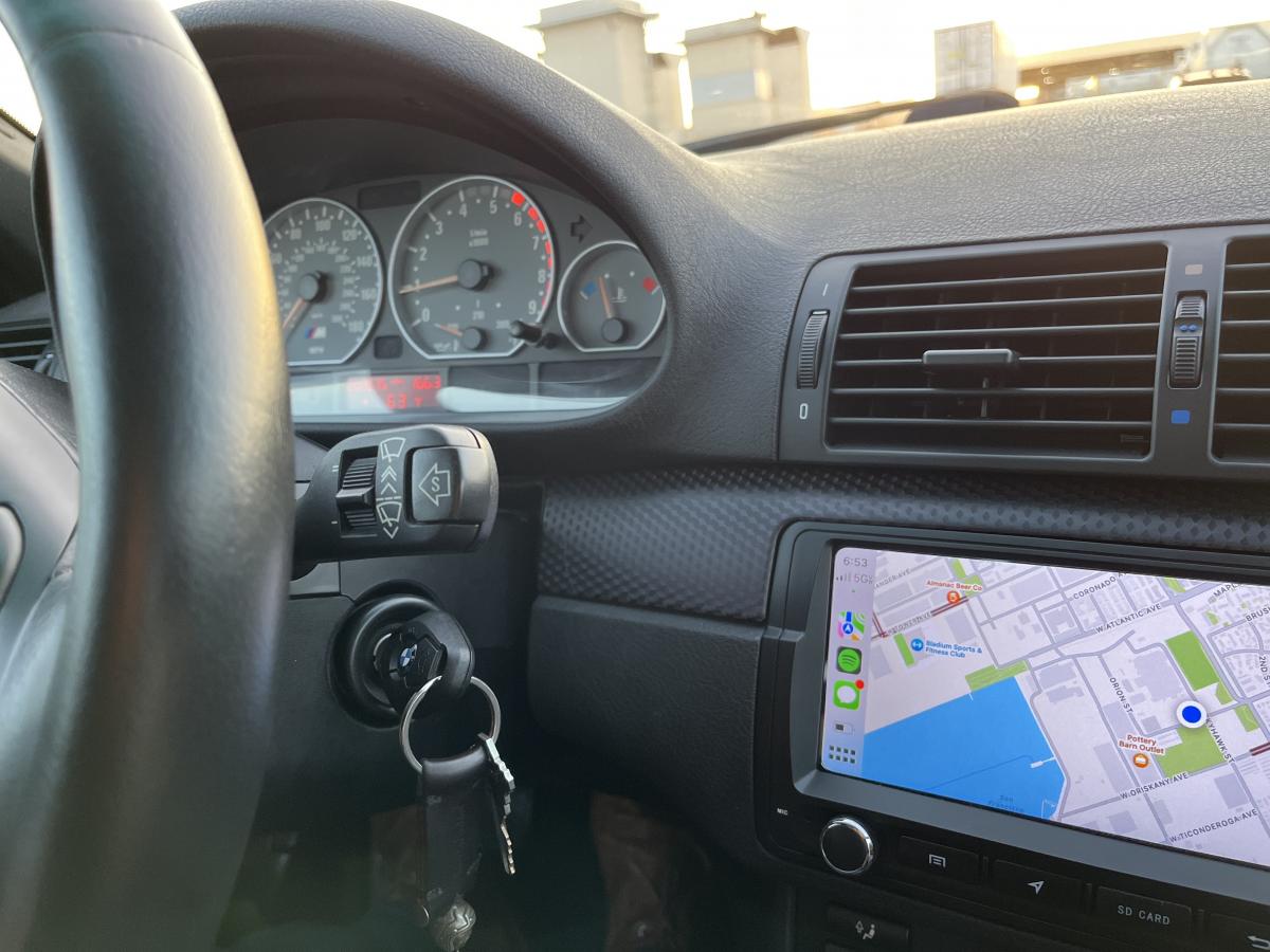

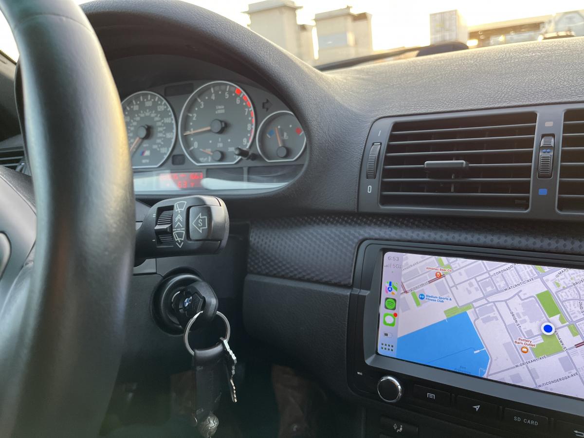

            I’ve been slacking on this one, instead focusing on converting my interior color, refreshing everything in the suspension and doing the CSL treatment to the engine. For now, I won’t be of too much help until I’m through the last of that work. A good winter project
            In the meantime, I installed an intensive washer wiper switch to make triggering the existing DSC much less painful
