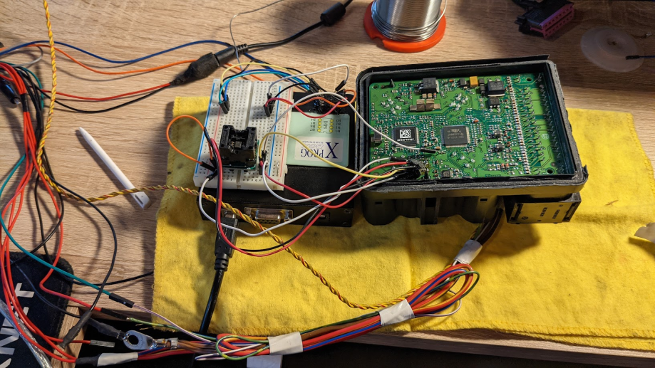

              Back in 2021 I also tinkered around with the MK60 and started with simply checking the EEPROM. Turns out, that even that is encrypted. I changed the VIN from BV71030JZ45078 to BV71030JZ45079 and a lot of the memory content suddenly changed.
              MK Motorsport Flash is the legitimate ATE/Teves Motorsport Flash, as the guy he sends it to was working for them back in the days. The unit is NOT opened during the flash, so it has to happen over CAN or K-Line.
              I know that there was a Mini part number for a cable that came with those units to flash them.
              Also there is a Discord for MK60e5 development, but lacking a racecar, i didnt bother to follow this in depth.

                    Hey sda2, quick question.
                    I managed to modify the cruise control gear logic and successfully flashed it to the unit. The actual flash process completes just fine, but after the flash, when the pump's chip boots up and runs its self-verification, it throws an RSA signature error.
                    Did you ever pull a full BDM dump off that main Motorola MCU while you were tinkering with it? I need to dig into the base firmware to locate that exact RSA check routine and see if there's a vulnerability or a way to patch/bypass it.
                    If you have a raw dump you can share, it would be a massive help. If I manage to crack the bypass, I’ll definitely post the solution for everyone(BMW-ATE-MK60E5-8TH-gear-cruise-control-patch/readme-en.md at main · mem0rz/BMW-ATE-MK60E5-8TH-gear-cruise-control-patch​).
                      #70
                      I don't think any of us have managed to figure out how to BDM the MCU, nor do we even know for sure what type of processor that MCU is.
                      I think most feasible strategy at this point would be to see if the MCU responds to any CCP protocol commands -- my suspicion is that is how the various guys who flash these things are doing so, since by all accounts the ones who know how don't open the things up, but the KWP2000 commands seem sufficiently locked down.
                      Since you managed to modify code, I guess you've figured out how to disassemble it? Any hints there?
