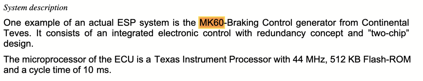

    So I came across this document. Perhaps the TI IC is the more significant one for our purposes (but would raise the question as to what the heck the Motorola/Freescale controller is for?)

      Take with a grain of salt since the MCU is motorola / freescale branded in all examples I've seen, but I came across this document:
      https://www.scribd.com/document/3525...xOnPage:0,best Match:false
      Very interesting! The other chip is certainly a TI chip. Interesting that that link also notes a “2 chip design” for redundancy. Could it possibly be two different MCU types are used to deliver that redundancy?
        #48
        Yep I just realized that looking at the photos again.
        Could be, though seems a bit convoluted to use two different MCUs altogether for redundancy. My other that is it could be that one handles the ABS / stability control stuff and the other handles the communications with the rest of the car?

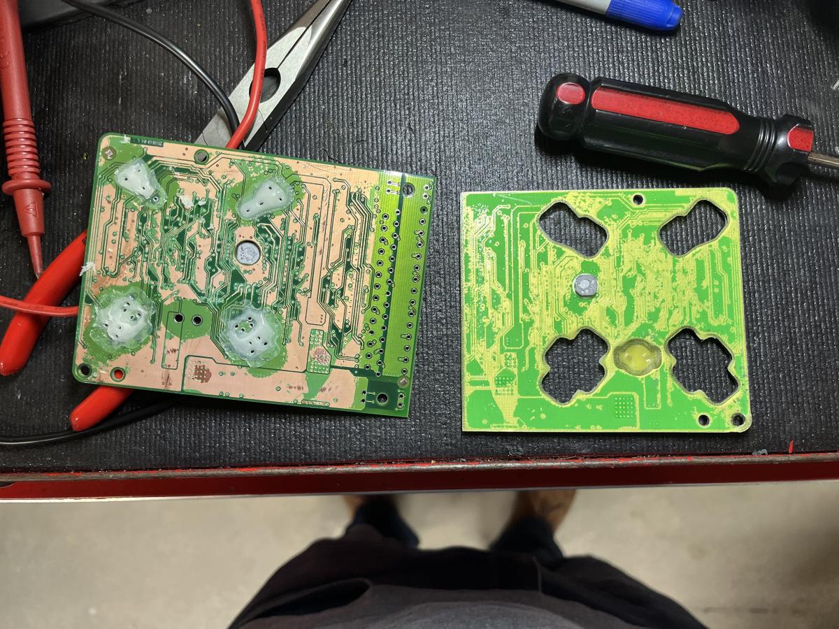

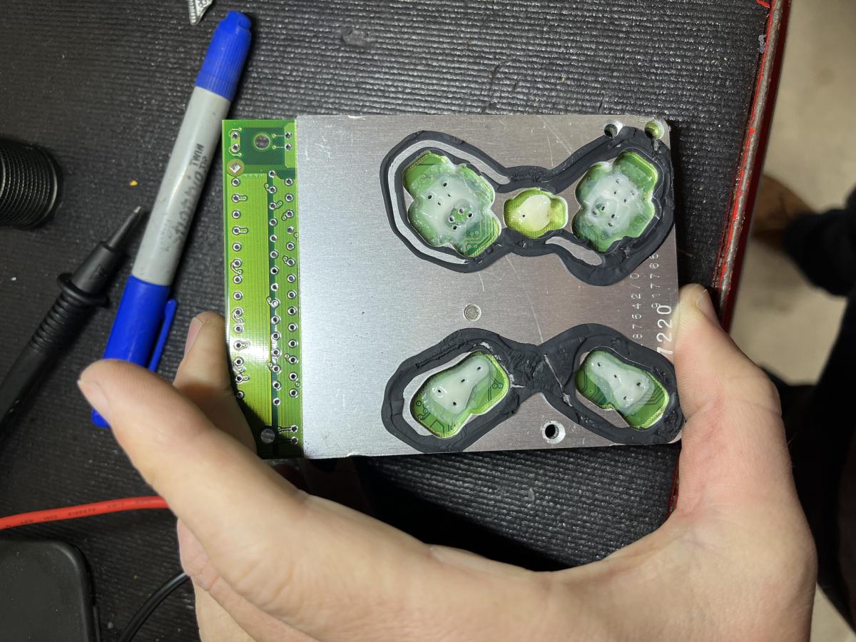

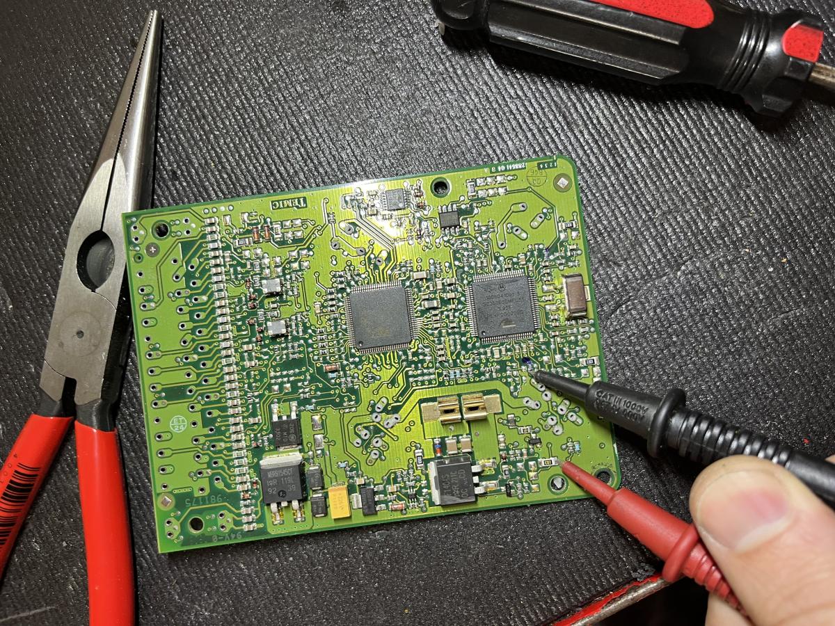

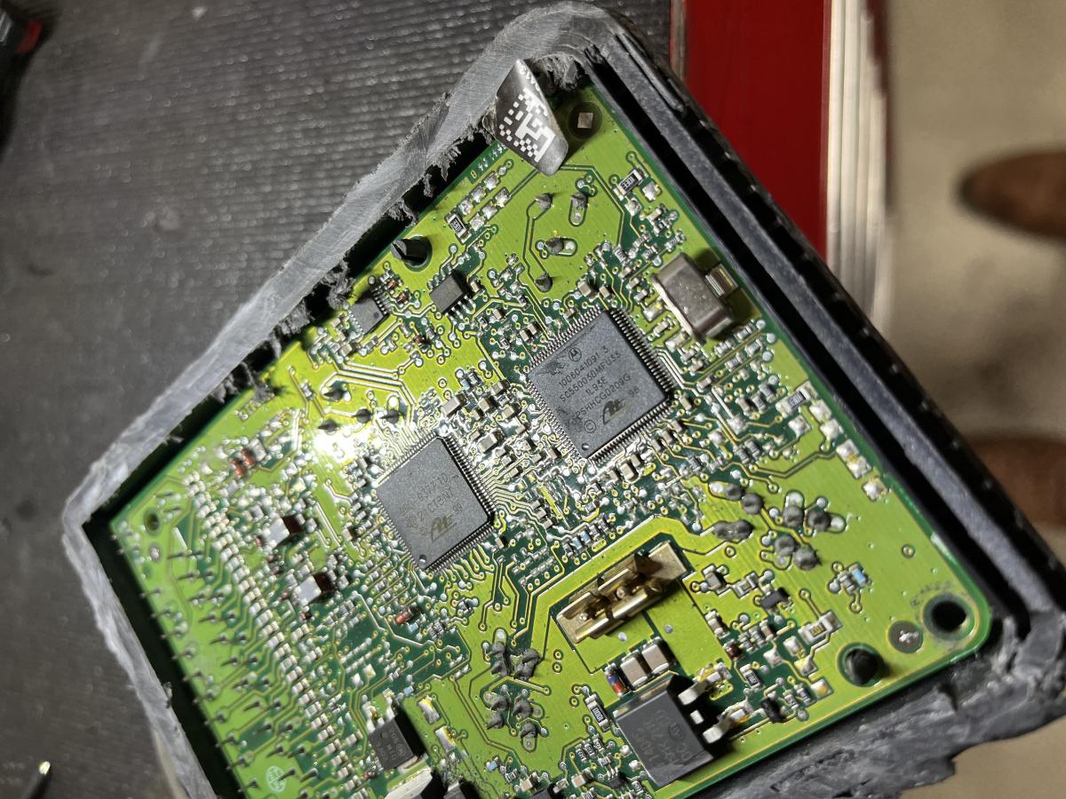

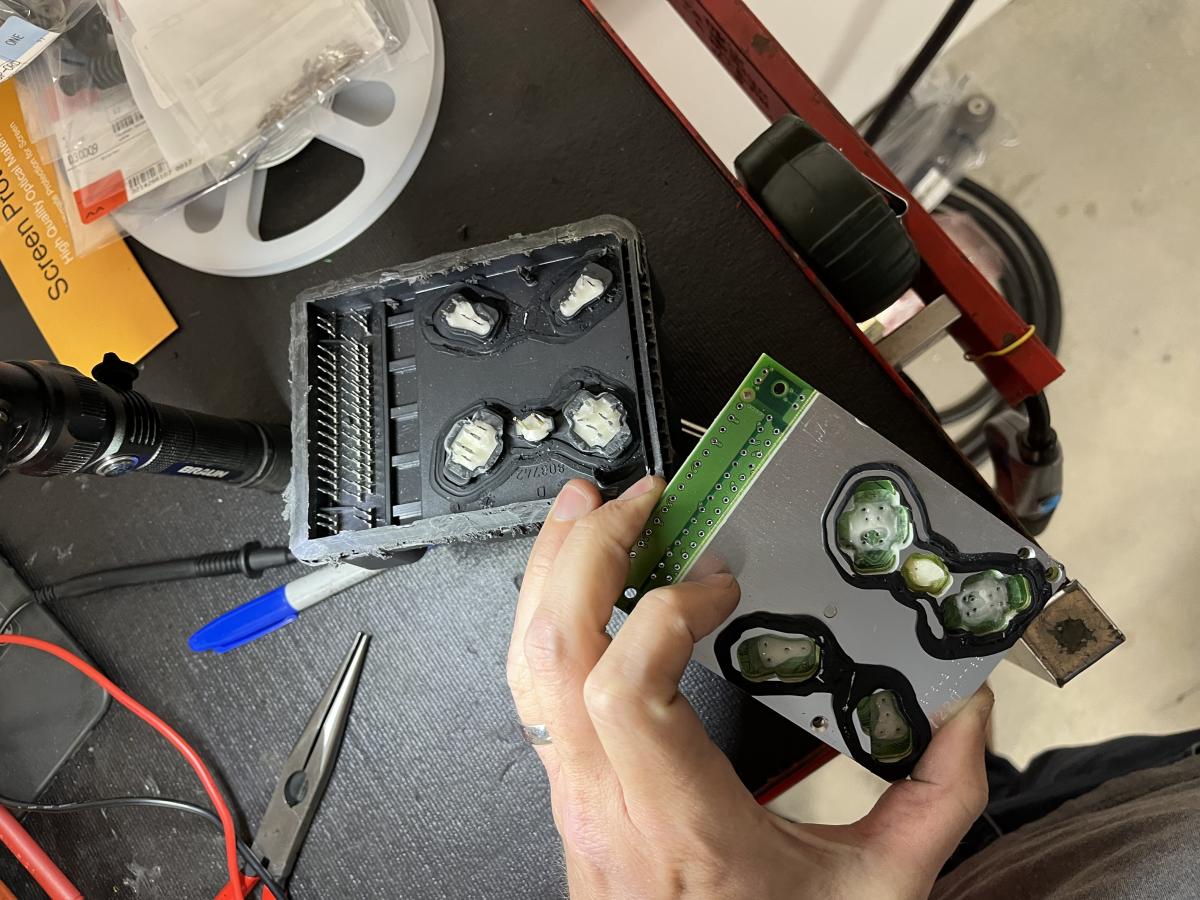

                Bare PCBA for the record. Guess I never posted these

                  Yeah I agree it's definitely an MCU and perhaps more relevant for our purposes anyway. But does seem to be more custom than most of the other MCUs found in various modules of our cars. The mask (1L93E) doesn't seem to correspond to any publicly available MCUs.
                  Perhaps should take another crack at disassembling some of the winkfp files that correspond to the E6x generation MK60s. Presumably they'd use similar microcontrollers and would help narrow things down.
