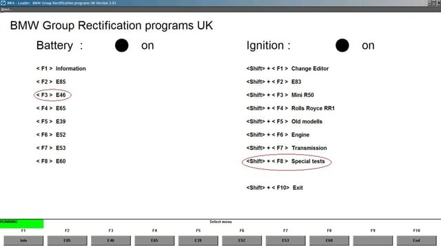

    Depending on which version of INPA you have it might not contain any of the SMG utilities. If no one else answers I will look and see what menus they fall under when I get home as I can't remember off the top of my head.
    With the full suite of SMG utilities there is only a handful of things you can do as everything is read-only or set via running the adaptations. If you want to make this easy order the software from these guys: https://www.pss-autosoft.net/alt-order.php
    You get everything with a point and click install including DIS packed up in a virtual machine. I highly recommend this if you aren't computer savvy and it is stupid cheap. Some spend hundreds of dollars on shiny engine bits but don't want to spend $45 on software to make their life easy.
    1. Bleed.
    2. Run and view adaptations.
    3. Watch pump pressure
    4. Watch temperature.
    5. Shift via the software.
    6. Read/Clear errors
    7. Test accumulator
    8. Other miscellaneous settings and run-time values can be read.
    For CSL 255, here is the link:
    https://www.ecuworx.co.uk/how-to/upd...-255-software/
      Your version might not have it, which was the situation I was in. I started a thread and eacmen helped me out: https://nam3forum.com/forums/forum/m...t-inpa-version
      17 iO1 i3
      16 F22 M235i
      08 E93 M3
      04 E46 M3 Carbon Schwarz - SMG II - Discovery Automotive tuned - AFE Stage 2 - SS Stepped - SS Metallic Cats - Eisenmann X-pipe - SS Race - 4.10 - ACS CF lip - 6000K Heads & Fogs - Tein S
        Under mine the SMG Adaptations are under shift+f7 while Mike's that is referenced above it was under Shift + F2. I've also seen them under the "Older Models" menu.
          For me I use shift+F8 to get e46 special functions
                My software is FROM the UK (www.Bcables.com) but my laptop screen doesn't say UK on it anywhere when I pull up any of the software. IDK if I have this page. I will check. Thanks.
