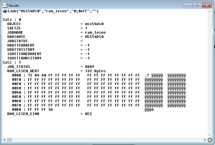

    RAM_LESEN just seems to work without any address respectivly a very low one and I just receive 3 start byte and then FFs up to a total of 128 followed by an end byte:

      You have to use as adress:
      0x01FF8248
        Thanks a lot - this helps. But does not work for all RAM adresses, right? Could you shed some light into the logic of accessing higher addresses? e.g. "ZUSTAND_MOTOR" should be on 0xFFE8E2 but I just got an error by RAM_LESEN, 0x01FFE8E2, 1
          use 0x01FF8044 thats the same as ZUSTAND_MOTOR
            Thanks again. Is the pre number related to a register? e.g. a2 is addressed by 0x01xxxxxx, a3 by 0x02xxxxxx?
